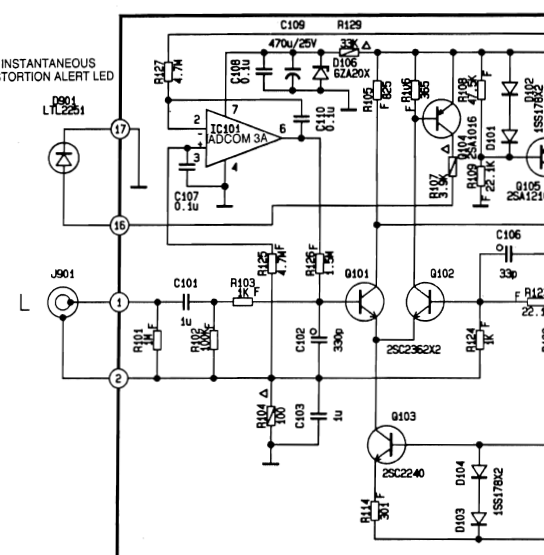

I have had the input board in and out several times now, testing each component and re-checking all traces and solder joints, trying to figure out why the distortion alert indicators are glowing (not at all 1st 30 sec., then dim glow after) with no input signal. I've tried it with shorted and open inputs, no change. Using 8 Ohm dummy loads, the amp biases fine (replaced bias pots with multi-turn sealed). DC offset is 0.2ma left channel, .8ma right channel.

The input differential pair runs at about 2 mA total current. It should split 1 mA each side (Q101, Q102). If the audio input get so high that on the peaks all the current ends up in Q102, then there will be enough voltage across R106 to turn on Q104. Turning on Q104 turns on the LED.
Under idle conditions, you should see about 0.4 volts across R106 and about 8 volts across R105. Same should be true for the equivalent components on the other channel. Measure the voltage across R114 and we can calculate those drops more precisely.

Looks like there is a bit of imbalance between the currents in the input pair. The input side is drawing 1.33 mA, and the feedback side is drawing 1.47 mA. That imbalance is pushing the distortion sense circuit to detect early. The total emitter current is 2.85 mA, and that should split evenly between the two transistors in the differential pair. Ideally, that would give you and idling voltage across R105/R155 of 1.18 volts and across R106/R156 of 0.52 volts.

Q103 cannot cause an imbalance. The two emitters are connected directly together to Q103's collector. However, the amp is sensitive to the match for Q101 and Q102. If you can find my transistor matching jig (Adcom 565 thread I think), you should use that to get tight matches. You can't really use a meter hFE test as the transistors must be at identical temperatures for the numbers to be useful. If you're careful you can use a meter hFE tester to pre-sort the transistors.
R105 is across the base-emitter junction of Q107, plus 2 * Vbe for the distortion lights to come on. Your normal voltage should run about 0.75V as a rough guess (given 1.83mA tail current for 0.91mA through each side * 825R). So it does sound like you have some kind of imbalance in the circuit.

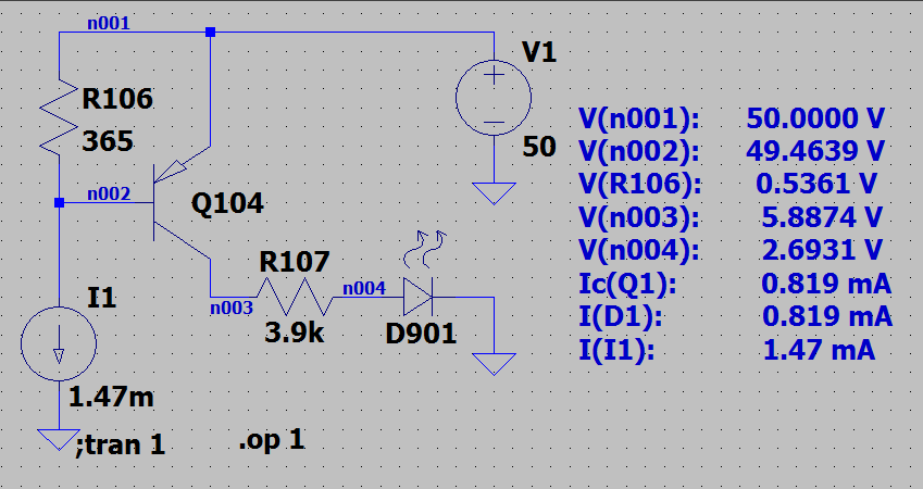

Did a quick sim of the distortion detector circuit using the quiescent values of I(Q102 collector) we determined earlier - 1.47 mA. That gives 0.536 volts across R106 which agrees with what you measured.
Under those conditions (no input signal), the LED is getting about 0.82 mA of current - depending on the LED probably enough to see it lit.
IC101/151 are sitting there open loop for DC. There is really no way of adjusting the balance of the input pair, the feedback is going to push it to where it is no matter what you do. I suppose if you wanted to play, you could force an offset into IC101/151.
I'm going to go back to something I suggested earlier, and that is to reduce the value of R106/156 to 301 ohms. That reduces the quiescent LED current from 0.82 mA to 23 uA.
