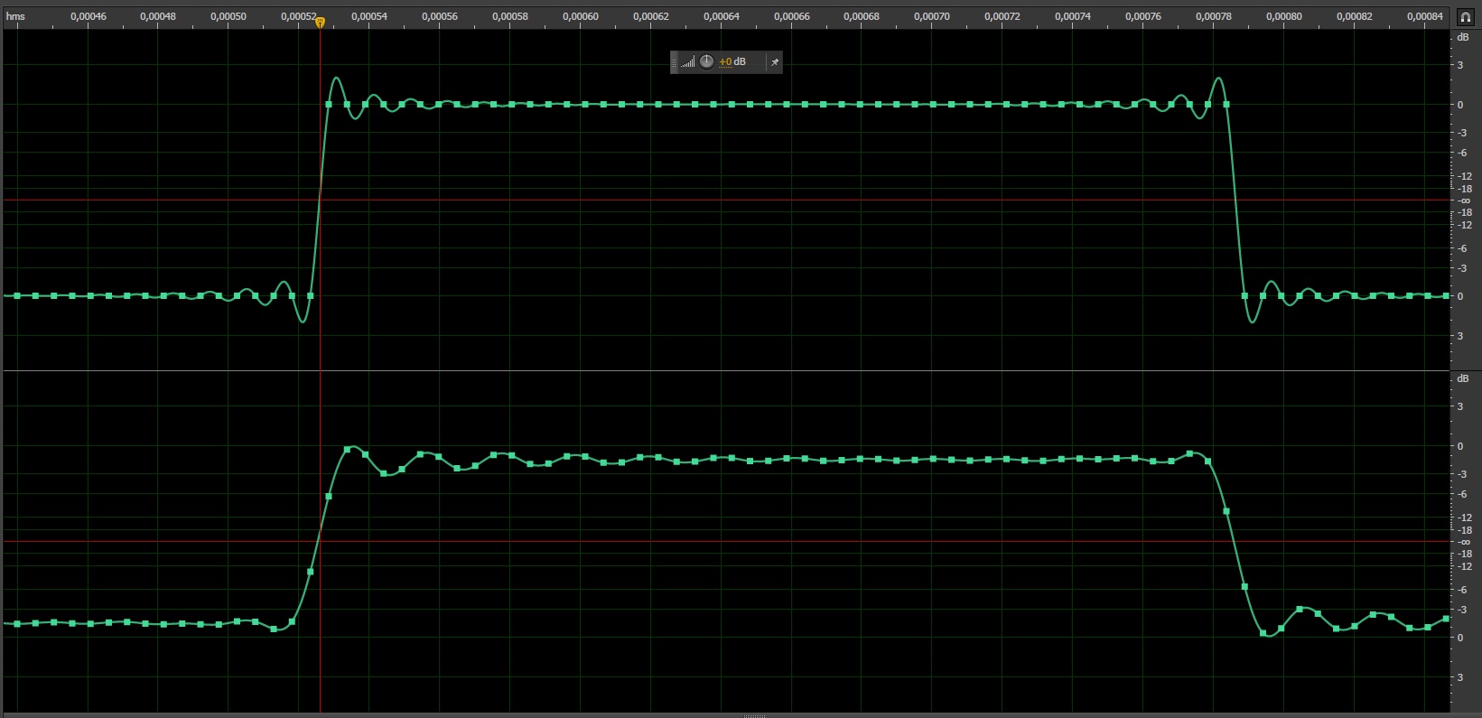

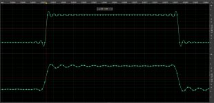

There is measurement. Up wave is original and sampled bottom.
Dominant distortion is done by DAC`s and ADC`s digital filter.
For signal chain between DAC and ADC is used 7 cm wire only, no other parts.
It is modified Asus Xonar Essence ST card.
Sampling is 192 kHz, original signal is 1920 Hz 1:1 square.
I don't see anything from this picture besides the effect from a bit of additional linear-phase low-pass filtering. The ringing is actually already present in the "original" waveform, as the interpolation of your software shows; that the samples happen to lie all at the zero-crossings of the ringing is just a degenerated case because the square-wave is synchronous to the sampling rate. I think you're trying to change the laws of physics, which is not a promising thing to do... Using a higher sampling rate will mitigate the effect, but not eliminate it.
Samuel
Samuel
You understand exactly. Low-pass filtering is that enemy which i want to eliminate.
And yes, ringing in original signal is software interpolation for bandwidth 96 kHz with low- pass filter. It is only for user`s imagination of sinus wave.
