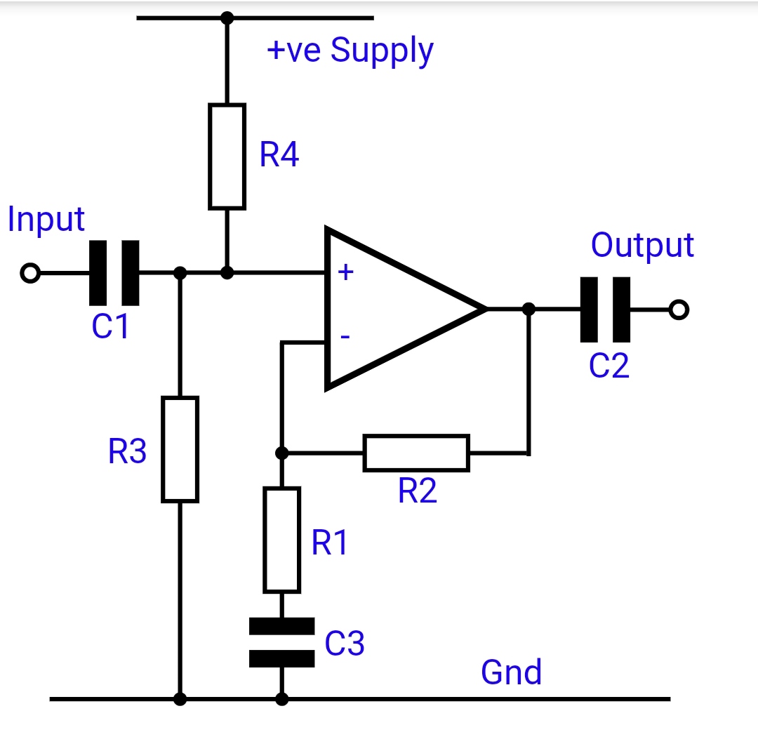

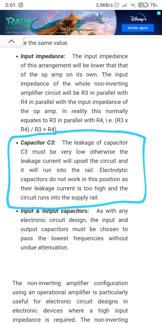

I looked and saw that are several non-inverter configurations. One of them is mine, but there is one that left me with doubts...
My configuration is with symmetric source (+/- 15v). However, I saw that the non-inverting configuration I am using should be for simple sources (just +15v), because of capacitor C3 (C36 on my board).
Should I remove it? Or swap? What can he do badly on my circuit?

Your suggested circuit will amplify the noise contained in positive power rail. So I like to do this way.My configuration is with symmetric source (+/- 15v). However, I saw that the non-inverting configuration I am using should be for simple sources (just +15v), because of capacitor C3 (C36 on my board).

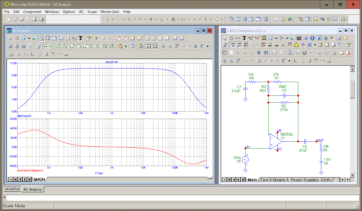

The C36... 100uF is enough? Or too much? I tried calculate the equivalent resistance in the R32-R34-R33-R35 node to put in your formula to calculate the BW, for then calculate the capacitor, but I failed.

Hello again icarovps,
The simulation result says 2.2uF for C36 is minimum. 10uF is more than enough, 100uF is too much.The C36... 100uF is enough? Or too much? I tried calculate the equivalent resistance in the R32-R34-R33-R35 node to put in your formula to calculate the BW, for then calculate the capacitor, but I failed.
