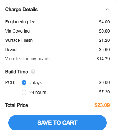

I 'only' managed to squeeze 16x17 to stay below the 100mm ceiling for cheap PCBs. 1360 will last for a while 🙂
- Adaptor PCB 2SK2145GR as 2SK170BL Substitute
