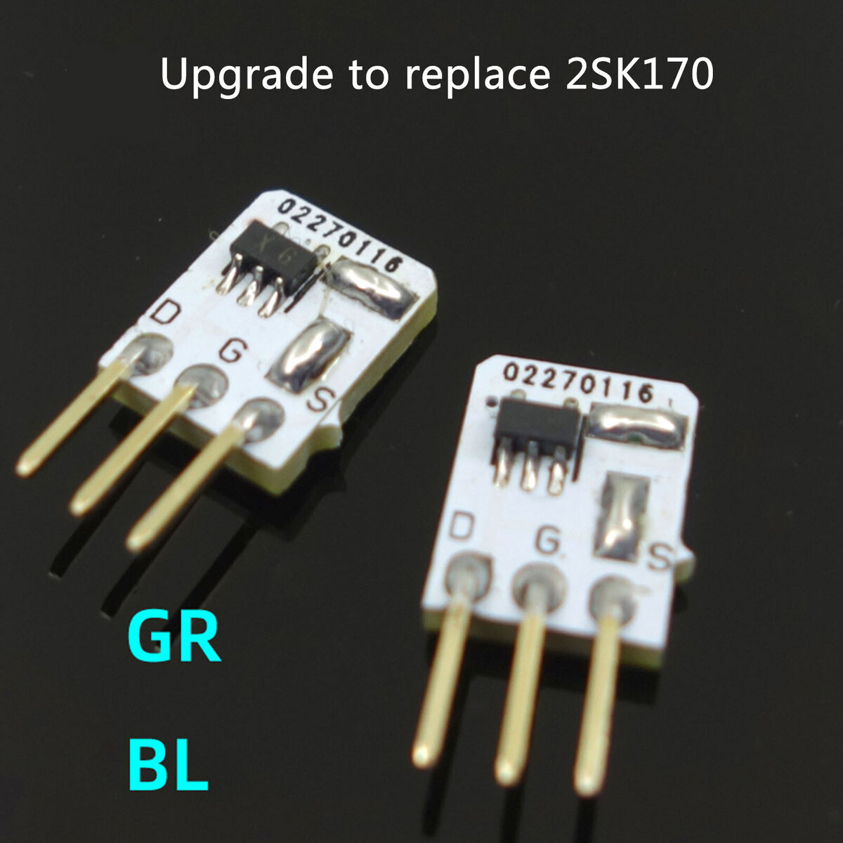

There have been endless discussions about 2SK170BL replacement.
I have already published data indicating that 2x209GR in parallel would be a good replacement in all respects.
https://www.diyaudio.com/forums/pas...source-follower-applications.html#post5582425
Of course you can also use a single 2SK2145GR, which is in principle 2x 2SK209GR.
They are not guarantee to be a match pair, and from experience some 10% are poorly matched.
So the best is to measure the Idss of each JFET and select only the good ones.
But for those who just want to save money and don't care about performance,
no one will stop you from using the 2SK2145GR without any selection.
Here are the Gerber files of a small 5x5mm conversion PCB.
Both size and pin assignment correspond to the 2SK170BL.
Plenty avaiable at Mouser, etc.
What more do you want ....

Very nice. Thanks. Is it much effort to create a 20 x 20 pcs 100mm x 100mm panel? This is a standard size for JLCPCB. I would be willing to place and order and distribute some in the USA.

I was offering to manage a group buy. I have very limited PCB design experience. That said, I looked at tools for panelization and there may be something open source that could do it.
My thoughts about your little PCB began when I first read Zen Mod's usage of the 2SK2145. I looked into adapter PCBs but did not find anything I liked.
Way back then, I purchased two different clamshell fixtures for SOT pars. So, I have the capability to perform curve tracing and matching of the 2SK2145 parts.
As to usage, I think lifting a couple of legs of the 2SK2145BL and using them as a single would be helpful for some DIY projects. Also paralleling the halves of the GR part would be useful.

Or buy them from eBay :
Patrick
Thanks Patrick....Or buy them from eBay :
Do you have a link??
My Ebay search returns nothing :-(
I did..... Only showed sensors and like stuff.You can do image search with Google using the above picture.
Never mind... found link in another thread.
Thanks anyway 👍
