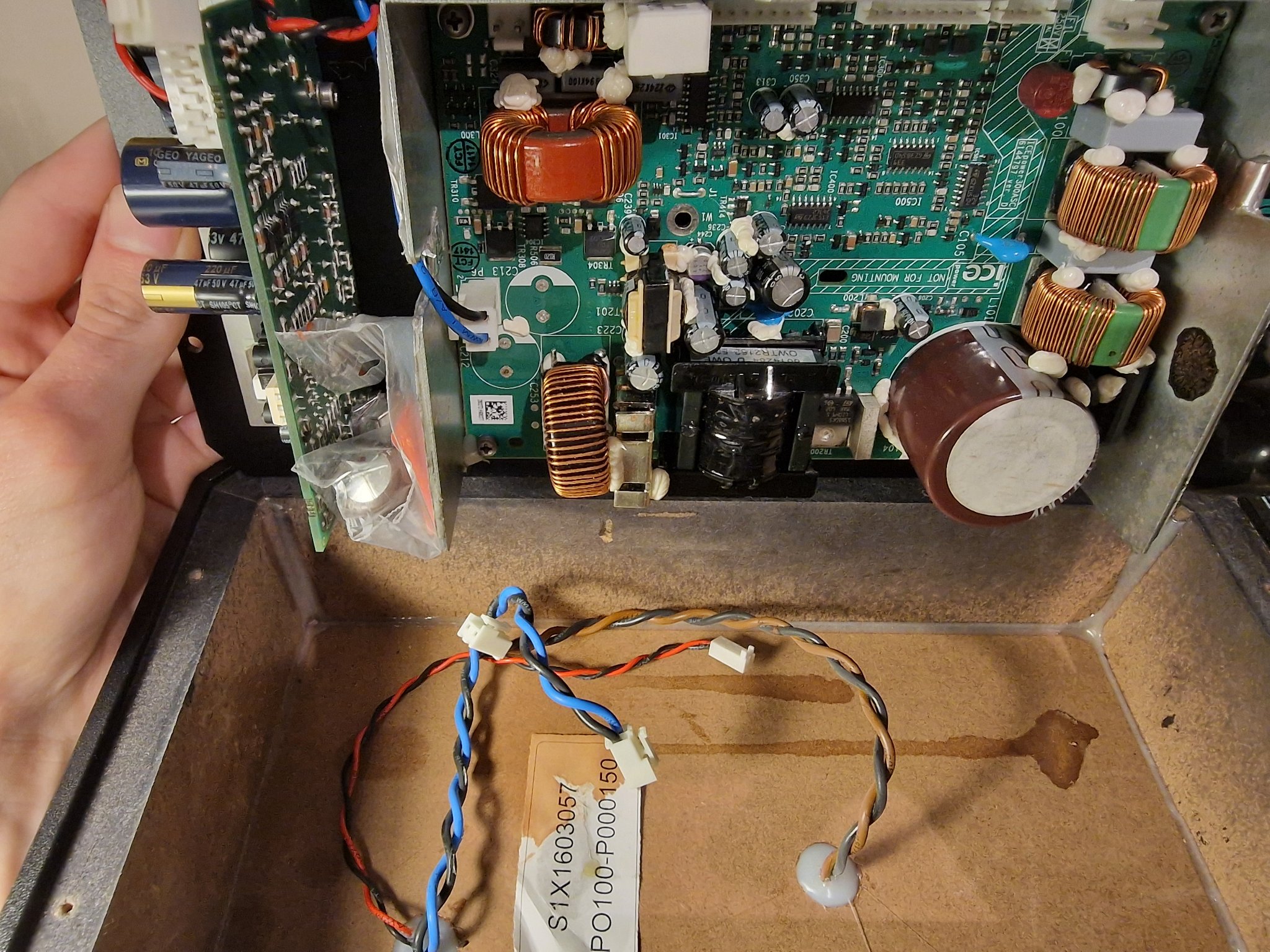

Hello
My Adam A77X stopped working recently.
Both speakers are having the same issue.
They create a popping noise like a metronome. Audio ist still Pasing through them though.
I have a friend who could repair them but he told me he is helpless without schematics.
Could anyone provide schematics for this speaker? Would be highly appreciated.
Thank you
A small update:
I have bought the speakers. One of the 2 is completely in working order. The other is not.

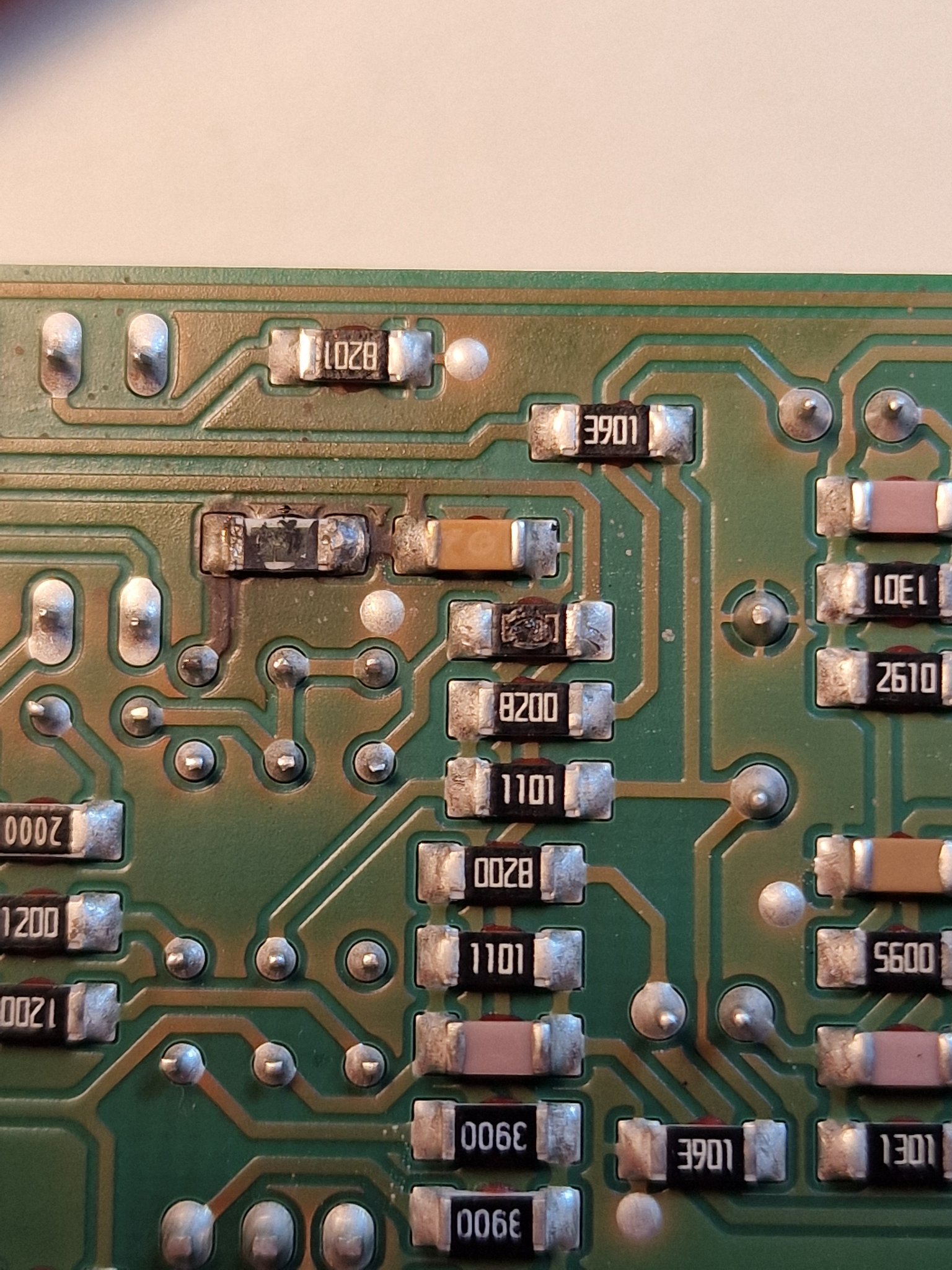

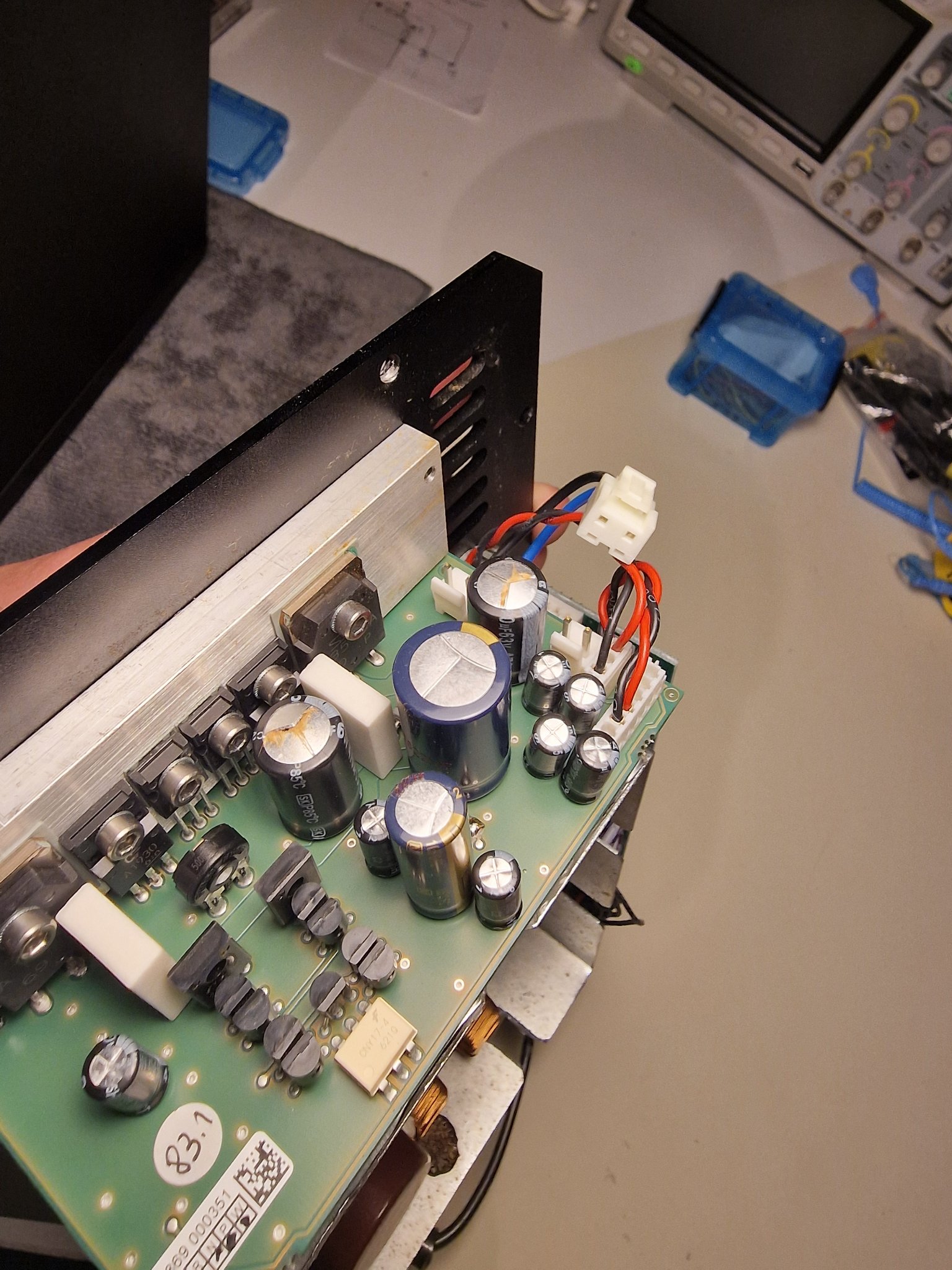

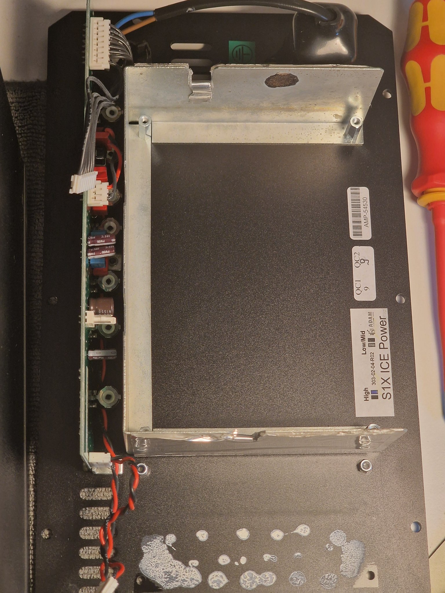

After opening I learned someone else must have attempted a repair but didn't succeed. Inside is a power supply PCB from ICE power. Namely the ICE Power 300ASC. I will attach a datasheet as well. This unit is still sold as well so that's good news if this needs to be replaced.
On this PCB I have to replace C419 for the correct size (100uF 35V). (Current one is too big size wise) So that indicates it has a different type of dielectric. Might not be an issue but just in case. And also 2 1000uF 63V capacitors that are removed but not replaced.

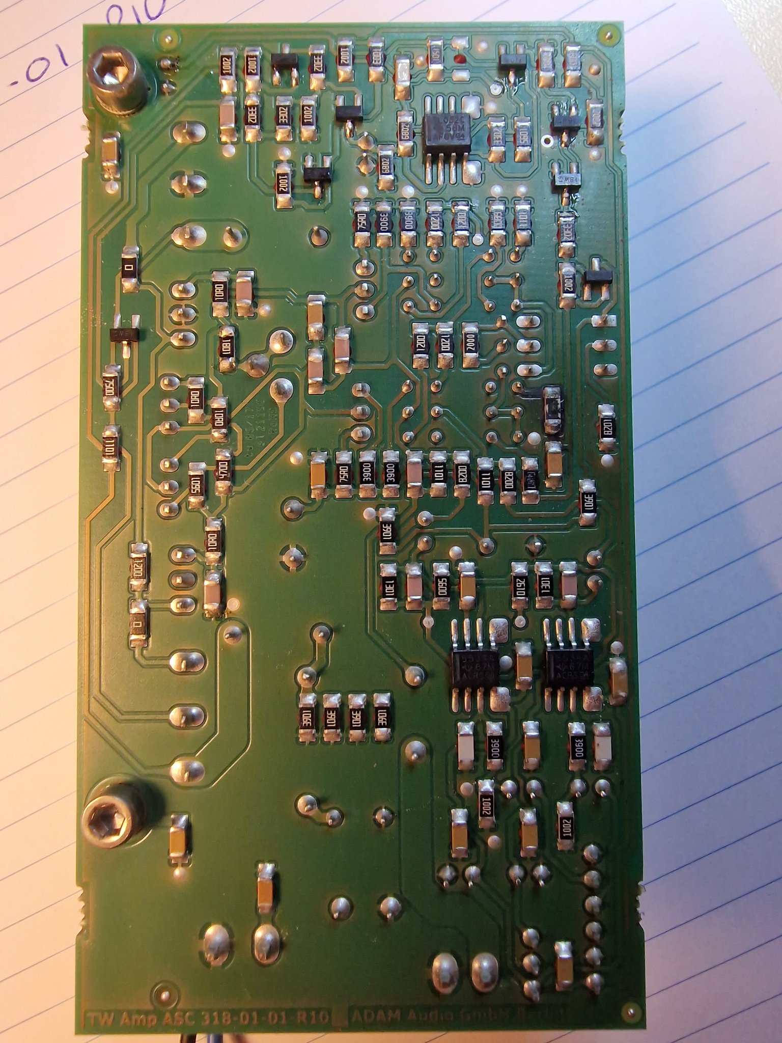

Then the amplifier board has the following subscription: TW AMP ASC 318-01-01-R10 of which I have not found schematics yet.
It has 2 blown caps of 470uF 63V and the same trace on the back side 2 resistors are charred. From the working monitor I learned this is supposed to be 680R and 1k1.
So far this is all I could find that is wrong. I will order the components in the future and report back with an update if it works or not
