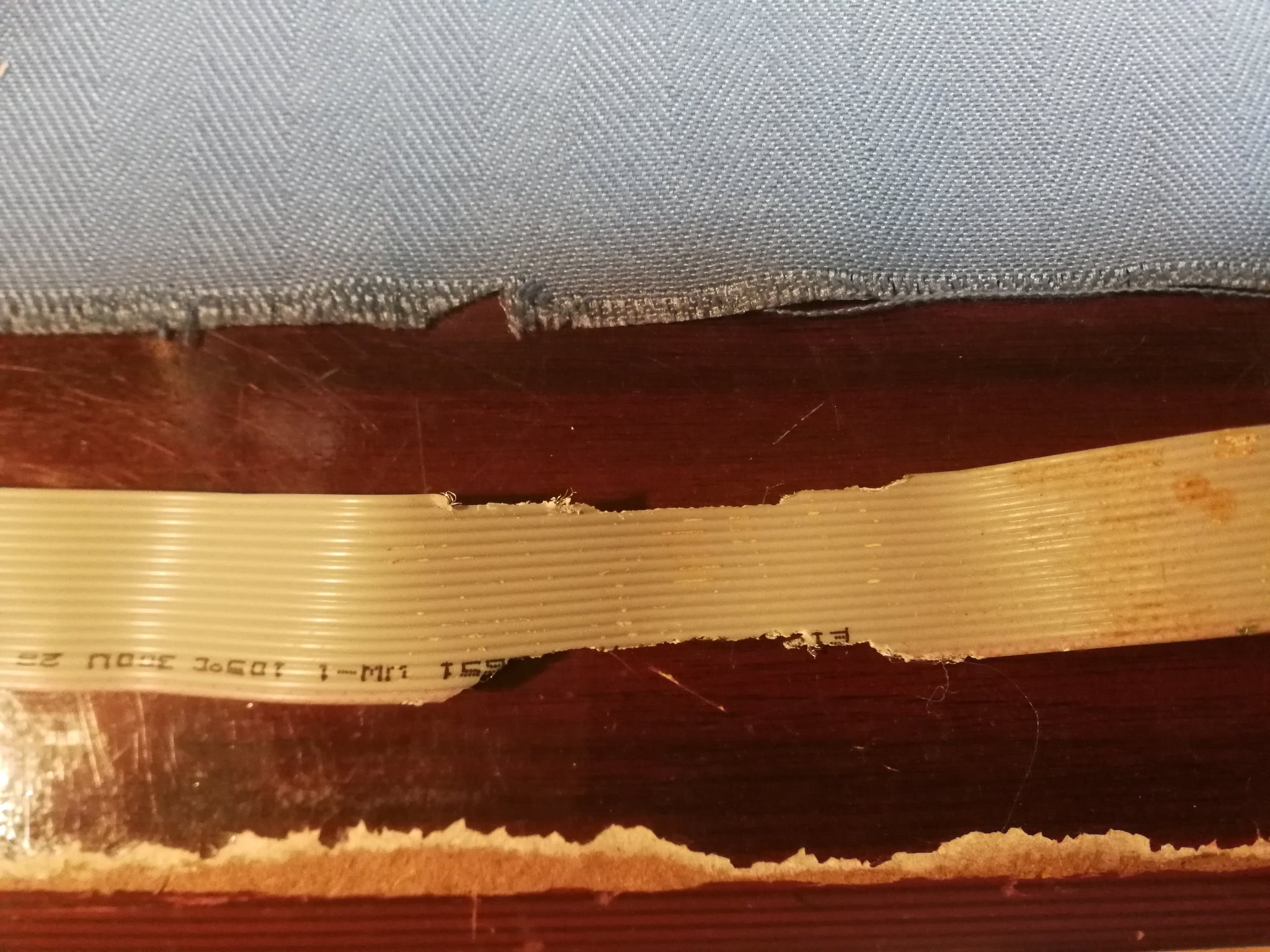

As soon as I got the schematics I opened the back of the monitor for a visual inspection. All looked clean. Then I rigged it to play some music : no sound at all. That was surprising because, prior to that, there was at least some sound coming through. So I started to wiggle around with the wires and connectors to find out that one of the JST connector, SV11, was damage (see schematics on post #218). The spring part of one of the crimp terminal was broken. I just replaced it. Then I was back to the conditions described on my first post.
Next I tested the ribbon cable that passes through to the control panel (SV1 to SV6), since the controls were not responsive at all, except for the standby switch. Only the middle part of the wire showed continuity. That's after I removed the speakers that the source of the problem revealed itself.
MICE!
The monitors had been stored for a years. Definitely the best architecture for mice house! And they love to eat wires.
So I ordered the parts to make myself a replacement cable, then reconnected the system (out of the box). Everything is working good. Now the problem I'm left with is to replace the cabinet damping material. I hoped I could somehow clean it and keep it, but, frankly, it is definitely ruined. I also inspected the other monitor and it shows traces of rodent life, although nothing has been damage, apart from the damping material.
It's the first time I have to shop for that material. It's the white fluffy stuff. It's 2 inch thick when not compressed. I am really not sure what to look for. From my search, I understand it is either poly-fill or Dacron (or is it the same thing?).
Can someone point me in the right direction? What to buy and where? (I am located in Canada)

Speakers with reflex ports should always be stored with fully covered holes,
otherwise it is an invitation for small animals. I once had a subwoofer in for
repair which was only used occasionally and stored in a garage. Mice went
in and used the inside as dining area. The cabinet was filled with nutshells.
The original complaint from the owner, a local wedding DJ, was bad sound.

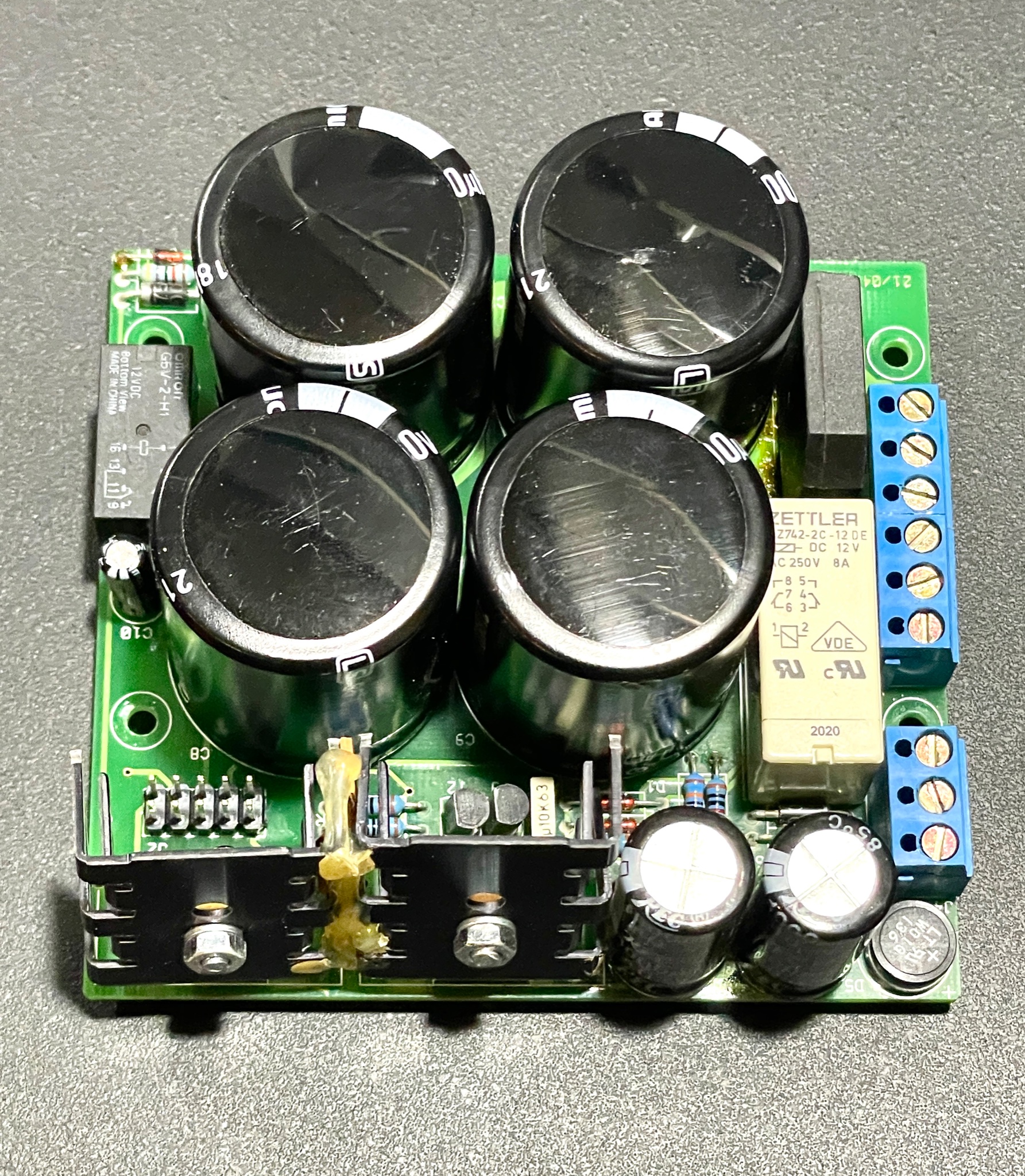

Hi everyone!
I am having an issue with an older Adam S3A. s/n is P3267 and it is the version that does NOT have the heat sinks on the back - just a smooth plate.
The issue was with a low level low frequency sawtooth sound - very quiet. Once I had some down time I switched the power supply board with a working unit and the problem did not repeat - so the PS board. I replaced all four 10,000uf caps on that board.
(Image of power board attached below)
Now the problem is that there is a pop on startup and the o/l red light comes on (very dim audio does actually pass through but very distorted!)
I removed the caps and checked the PCB trace connections and they seem fine. Put them back again but no good.
I cannot find a schematic for this particular version of the PSU (I found the one in post #90) but regardless, I just need some guidance in trying to fix this. It would be great if I could trace power through the PCB to isolate the problem.
Most of the components seem to be fairly generic... rectifier, relays diodes a couple of FETs. In theory it shouldn't be too complicated.
Any help is very much appreciated 🙂
Phil

...a little follow on...
So the power supply on this provides two rails with a common ground.
The block connector has a BLACK, a BLUE and a BROWN wire that goes to the main amplifier board.
On a healthy supply the BLACK is the negative rail, the BLUE is at +42V and the BROWN is +84 V (with an obvious pd of 42V between the BROWN and BLUE)
On this defective unit, there is only 42V between the BLACK (-ve) and BROWN (and also the same 42V between the BLUE and BROWN) .
Additionally there appears to be a short between the BROWN and BLUE connectors, which might explain the same voltage on both, and the overload light staying on, if one rail is shorting somewhere.
I wish I had a schematic!

You should measure +42V and -42V with respect to ground. Are you sure wire colours are correct ?
Was a "through hole connection" of the pcb damaged by desoldering ? Have a look at the lugs of the
old caps. More pictures are required.
Thank you for the response as_audio 😊
The ground is the blue wire, center connector terminal 2 of the J4.
And yes, my bad, the good unit shows +42v and -42v on terminals 1 and 3 respectively.
The bad power supply:
1) there is no connection between terminal 3 to the rectifier (or the +ve side of C2 and C8)
2) there appears to be a short between terminal 1 and terminal 3 of the J4 !
I believe I have the wire colors correct. It is possible that there was damage to the PCB when I de-soldered the old capacitors. I am pretty good at this and very careful, but there may be some damage which I will have to check.
Assuming there is damage to a “through hole connection” would you have any good tips or suggestions for a repair? I suppose I can use small jumper wires.
The rectifier seems to be testing good and so at this point, maybe damage to the PCB might be the problem?
