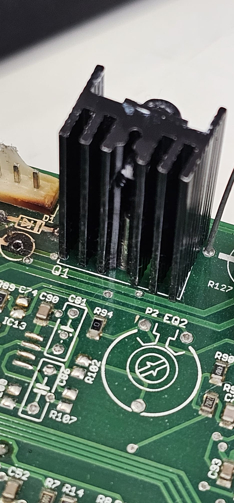

With a good, perpendicular and sharp picture of the crossover board

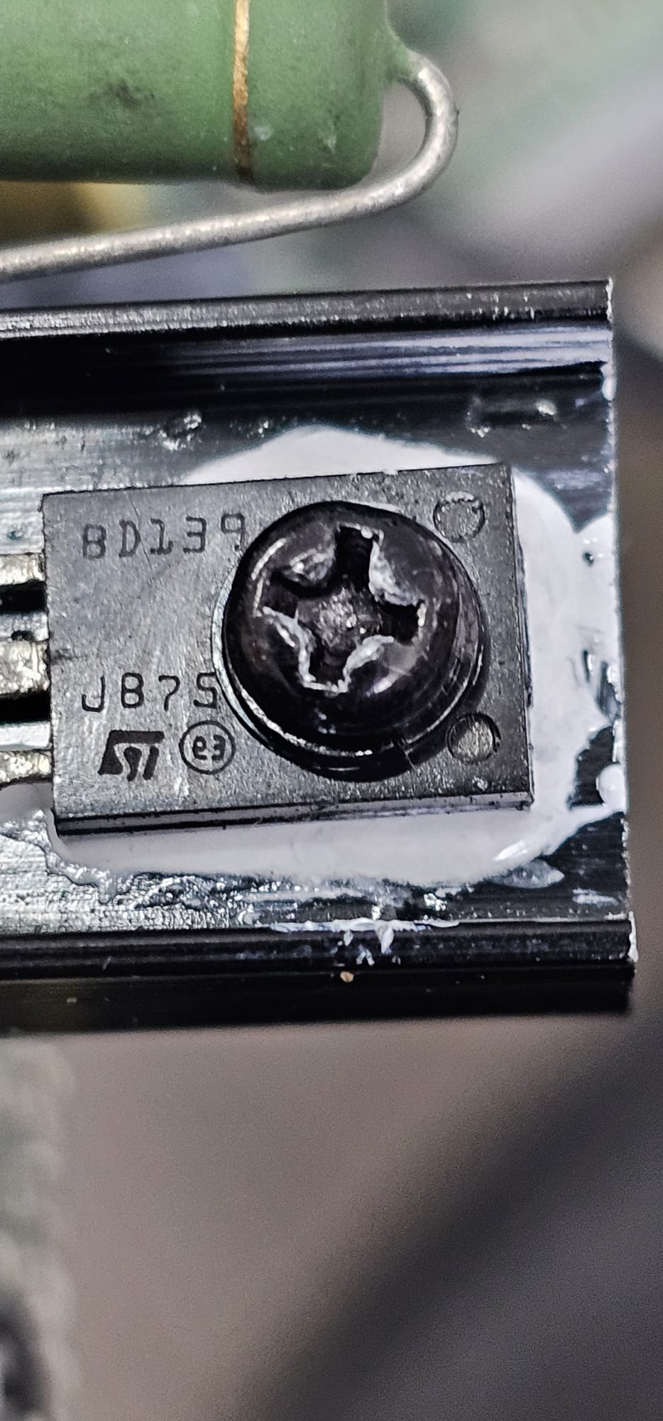

it may be possible to define test points. Which type is Q1 ?
