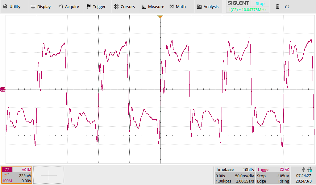

Here some measurements on my differential amp-probe (AD8129) and I need to consider your writings!
While I simple expected, that there are any new & better AD8129.
Also an issue IMHO, is the harmonic phase shift (s), as looking on the square signal as may distorted by the phase shifts f (freq).

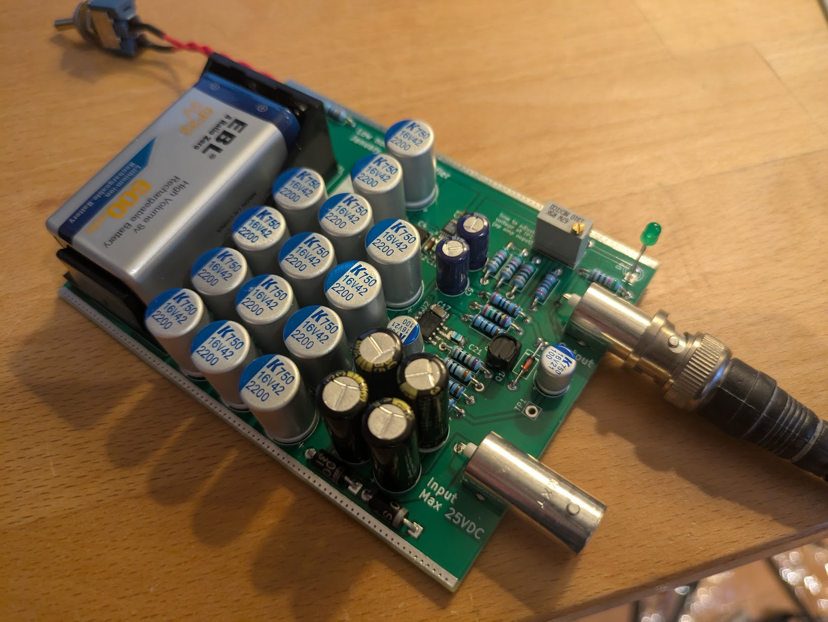

After a year of frustration with the AD8428 design, I took a hint from @JensH's design as well as from Dick's website. The design isn't suitable for very low frequency measurements, which was the initial goal, but is more robust than the AD8428 and delivers repeatable measurements across the audio band. I'm thrilled. Thanks to everyone for sharing your expertise and pointing me in the right direction.
The below measurement was taken with the board in a Hammond 1455K1201 with neither end bolted on. The board is designed to slide right in, but I did not have the chance to mill the panels yet. So shielding is a far cry from the legendary cookie tin.
I attached the schematic with build notes and gerbers for anyone who may be interested in building one. Of course, feedback is more than welcome.

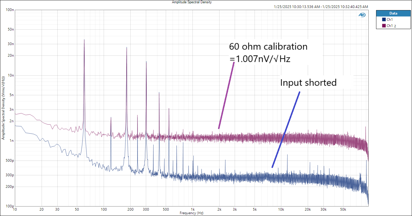

Some interesting learnings from initial prototyping:
  • I initially built it with an LT1806-- I had a bunch. It is an RRIO op amp and I suspect the open loop gain just isn't high enough. I only got 56dB of gain. Switching in an OPA132, which was also in the drawer, got me to 59.8dB. I'll say that's close enough. If I were to build another, I'd try an OPA1655 or similar, which has much higher open loop gain.
  • I also used Kemet A750 al-poly input caps. Bad idea. The noise with the inputs shorted was about 3nV. I believe this is because of the caps' high leakage current. Switching in some plain old aluminum electrolytics brought tghe noise floor down to 300pV/sqrt(Hz).
  • I'd like to try it with a couple of ZTX1051As. The boardband noise is higher, but the noise at 20Hz seems to be lower according to Dick's measurements.

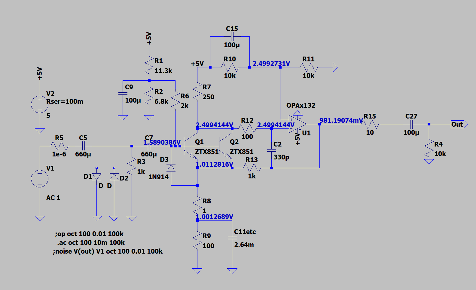

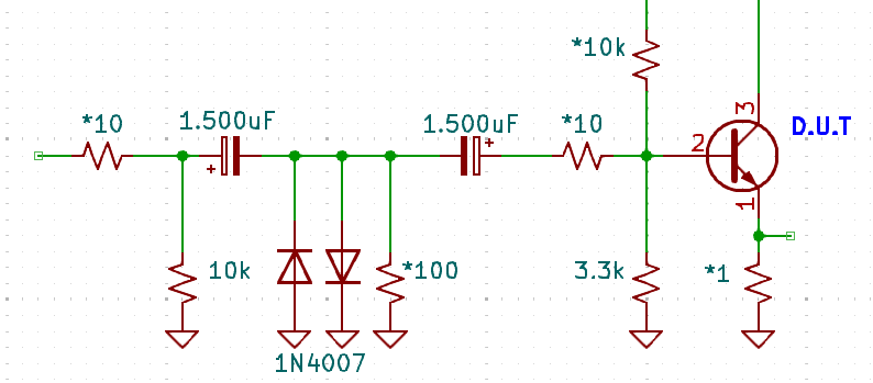

What PN of D1&2 ?.
The problem I see that there is no input protection. Simply connecting input to +5V and BJT 'd blow due unlimited base current.
Diodes help somehow if resistor 22 Ohm (from init post) returned, but still 1V jump at the base with emitter hardly tied to big C destroy B-E junction - guaranteed.
Not sure what you are referring to with infinite base current. The schematic shows that the input is AC coupled. Do you mean the 5 V from the DC supply? that is fed via a 2 K resistor in series with a pot and another 10 K resistor and yet another 100 R resistor at the emitter, so even if one of the transistor B-E junctions shorts out, worst case scenario the current will be limited to roughly 300 uA.
" what you are referring to with infinite base current. The schematic shows that the input is AC coupled."
660 uF charging current at the moment of connection to DUT. 10V decoupled reference via ESR=100 mOhms or so provides 100 A impulse current spike.
Indeed, it's a tradeoff. Any series resistance on the input decreases the impulse current spike at the expense of increased noise. I'm using SB2H100 schottky diodes, which are rated for 75A peak forward surges because I happened to have exactly two. I didn't want to specify it on the schematic, because I'm sure there are better options. For what it's worth, I've tested multiple 9V power supplies and am pleased to report that the amp lives.
There's some more discusison on input protection starting at post #2.
Best practice would no doubt be to charge the cap through a resistor before taking measurements. A lower value input cap is no doubt fine, too, considering 1/f noise kicks in around 100Hz.
A 100 A spike to what? To the base of the transistors as you mentioned? No way. The example you gave is if you have a capacitor from input to ground with an ESR = 100 mOhms. That is not the case here. Because D1 and D2 are before the base of the transistors. Those diodes also have equivalent resistance, small, but they have resistance, so the current spike will be lower and they seem to be able to handle it, as the OP mentioned they have a 75 A rating. The voltage also gets clamped by the diodes to say 0.7-1.2 V. Again, far from unlimited base current, although I grant that it will stress the BJTs. So, yes, some extra voltage protection wouldn't hurt. Perhaps replacing the diodes with some Schottky's that can handle the current and produce a lower voltage drop?
I see a lack of imagination here.
"A 100 A spike to what? To the base of the transistors as you mentioned? No way. The example you gave is if you have a capacitor from input to ground with an ESR = 100 mOhms. That is not the case here. Because D1 and D2 are before the base of the transistors. Those diodes also have equivalent resistance, small, but they have resistance, so the current spike will be lower and they seem to be able to handle it, as the OP mentioned they have a 75 A rating. "
You don't understand that dynamic resistance of diodes makes situation worse, voltage pulse increasing over diodes. In next step this voltage pulse (over diode) via C7 680 uF generates base current - almost unlimited. In stationary condition C7 pre-charged, so 1-2 V over protection diodes summ up with 0.7V base-emitter to 1.7-2.7V. Now find low noise BJT that can handle 2V over B-E junction. If it's survive, it 'd not be low noise anymore.
I'm thinking splitting 22 Ohm in two, than 1-2V over diode generates only 100-200 mA.

Aside from the insults on your side, I am having a hard time understanding what you are trying to say, as you do not write very clearly. I get it that extra protection is needed, as I have already mentioned it in my previous post, I granted that point. The schematic you posted does help ameliorate the problem, but it is useless. As this is supposed to be a very low noise amplifier. Having 20 ohms of series resistance at the input wreaks havoc on the noise figure. What good is to have a protected amplifier if it doesn't work for the application? The OP has already mentioned tests and the fact that he will be measuring voltage references not "Unlimited current" voltage supplies. How many voltage references do you know that can provide "Unlimited Current"?

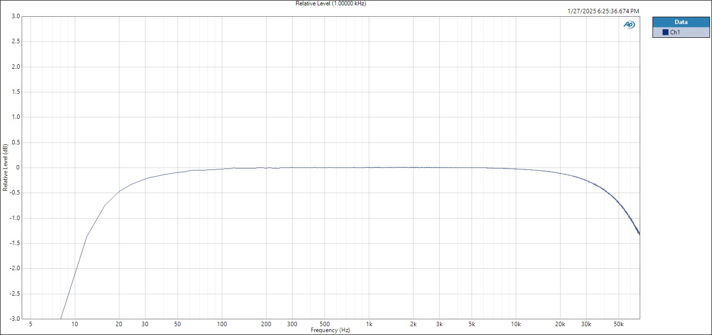

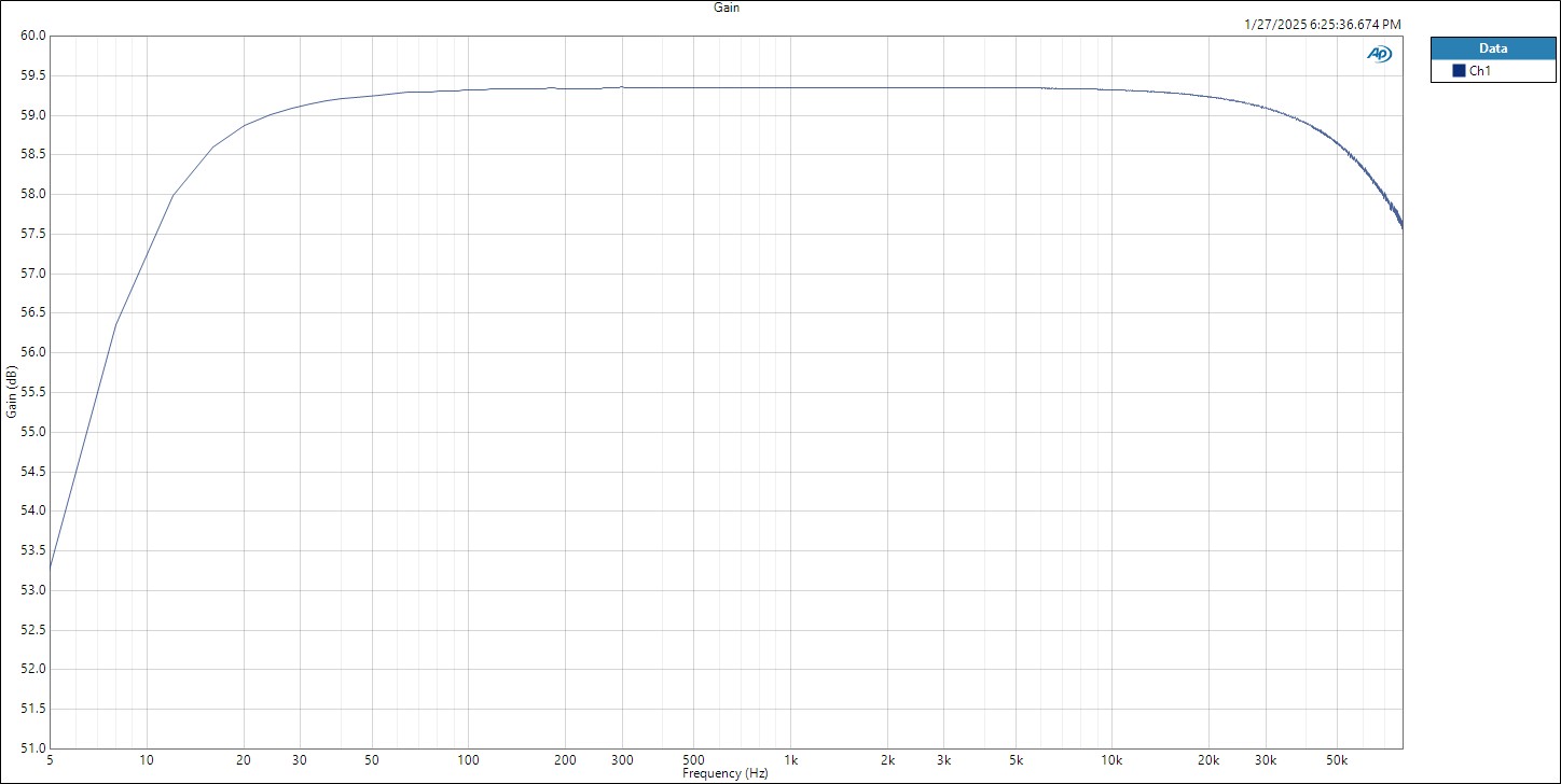

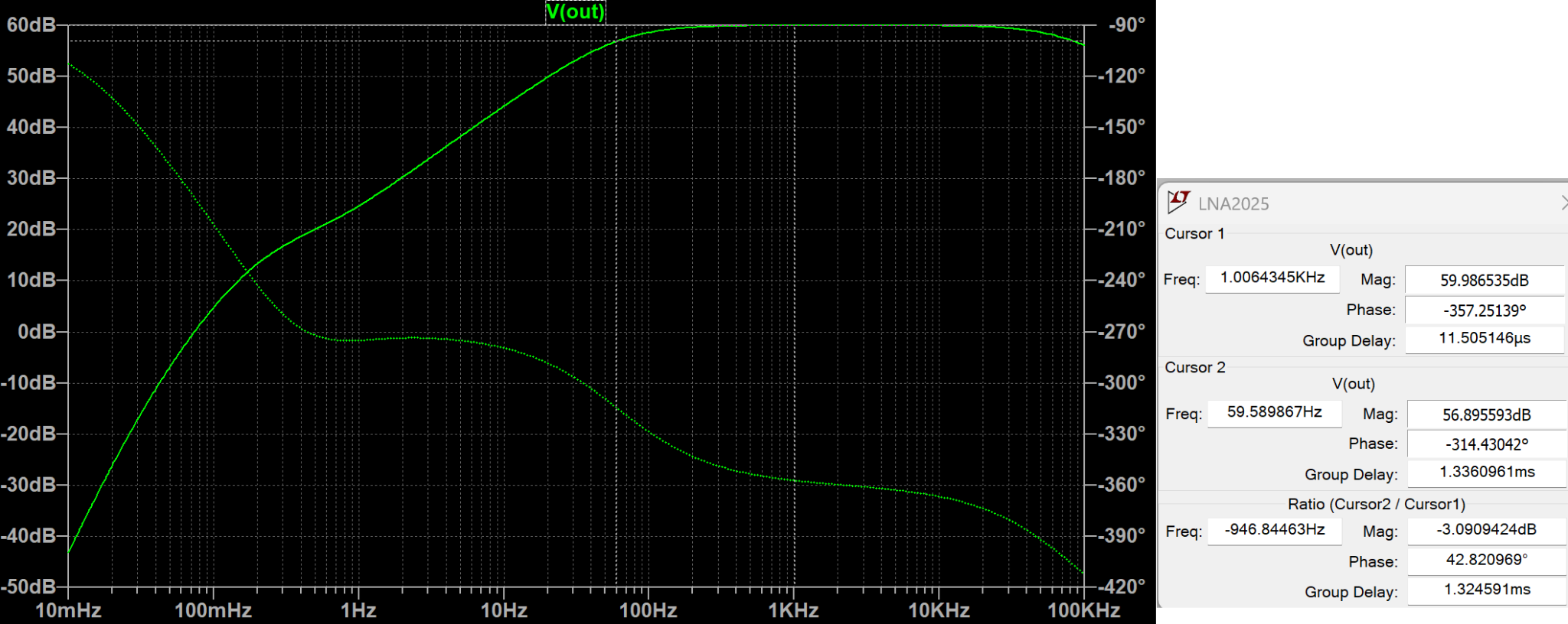

Thanks for sharing your sim! Here are some gain measurements using a 1mVRMS input signal.
I think you may have shifted a decimal on C11 in your sim; it's a dozen 2.2mF caps, which works out to 26.4mF rather than 2.64mF. This capacitor is what limits the low frequency response of the LNA, as it increases the amount of feedback as its reactance approaches 1 ohm (R8).
My measured f3 is around 8Hz. Increasing C11 should result in a lower f3, which is why I'd encourage anyone considering building one to look into those 4700u caps which fit the same footprint. I'm not sure if the ZTX851 has a low enough 1/f noise for it to be worth pursuing.
Also note that, while it probably won't matter for yourt sim, the op amp runs right off of the 9V battery rather than off of the regulated 5 V supply. You may also wish to increase the value of R2 to center the output of the op amp around 1/2 of its supply voltage.
