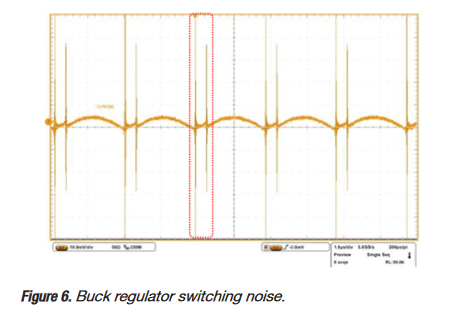

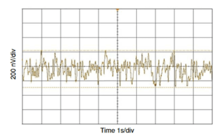

As good TI resource as "Simplifying Power Architectures, With Low-Noise Power Devices" shows the issues very clearly:
Some figures of this document
- Low freq. noise; as low freq. LNA required
- Switching noise, caused by the ADC/DAC power(s) and other parts; as high freq. LNA required at xxMHz or even xxxMhz.
New 12 Bit DSO & averaging & ERES to16bit on xxMHz may help to show this switching noise.

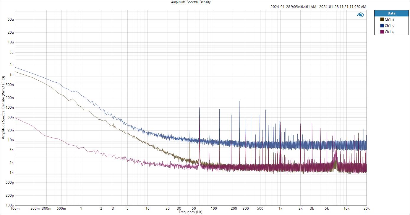

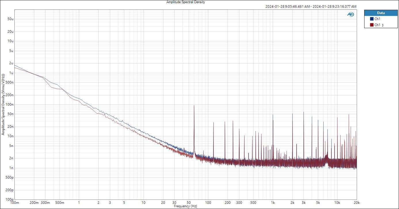

Time for an update. I ended up building the AD8428 LNA as I found a couple of chips in the stash. It is not the last word in performance, but I wanted to share some preliminary findings in case anyone else chooses to go down this road. All measurements are taken with shorted inputs, and with a -66dB offset to obtain RTI noise readings, and a single AD8428 (no parallel parts) and +/-6.8V rails after regulation. Other settings are visible in the screenshot.
The first round of measurements was disspointing. Unfortunately I did not save the graph, but the 1/f corner was around 100Hz-- much higher than the datasheet 1/f corner. I suspect this was the input bias current working into the 500k input bias resistors, and generating a noise voltage at the input. I ended up replacing the input cap with a 25uF Kemet film cap, and the bias resistors were dropped to 50k. This creates a lowpass with -3dB at 0.13Hz, and brough the corner down to about 30Hz.
I then performed a few other modifications and tested to see how they impacted the measured response. The input ferrites are Fair-Rite 2512061027Y1s. Replacing them with a short didn't impact the noise performance.
I tried increasing the capacitance across the LT3045/3094's Rset by piggybacking 4.7uF caps. The results are a bit too close to say 3x 4.7uF (blue trace, topmost) performed worse than 1x (red trace, bottom), but it did not measure better. These are 1206 Murata GJ8s, X7R, 50V. Perhaps the leakage begins to matter when you have that many, or maybe the flux that crept between the parts created a new leakage path. Perhaps the AD part's PSRR is good enough that none of this matters?
Next up, I cleaned the boards with IPA. This also gave a small, but measurable improvement (tan trace, middle in below graph). Another interesting observation is that cleaning the boards reduced the output voltage offset by a few microvolts, suggesting that there was indeed a leakage path that got cleared up. The topmost blue trace in the below graph shows the APx515 SE input shorted-- so if nothing else, this will be useful for audio band measurements.
Finally, shorting the input coupling caps (such that the in-amp's + and - in are effectively shorted) brings the 1/f corner to about 4Hz (purple bottommost trace). This seems a bit too good to be true? Certainly better than the datasheet. I'm sure I'm missing something, but I'll continue to explore the bias current noise theory as well as any leakage effects the BAV199 input protection may be contributing.

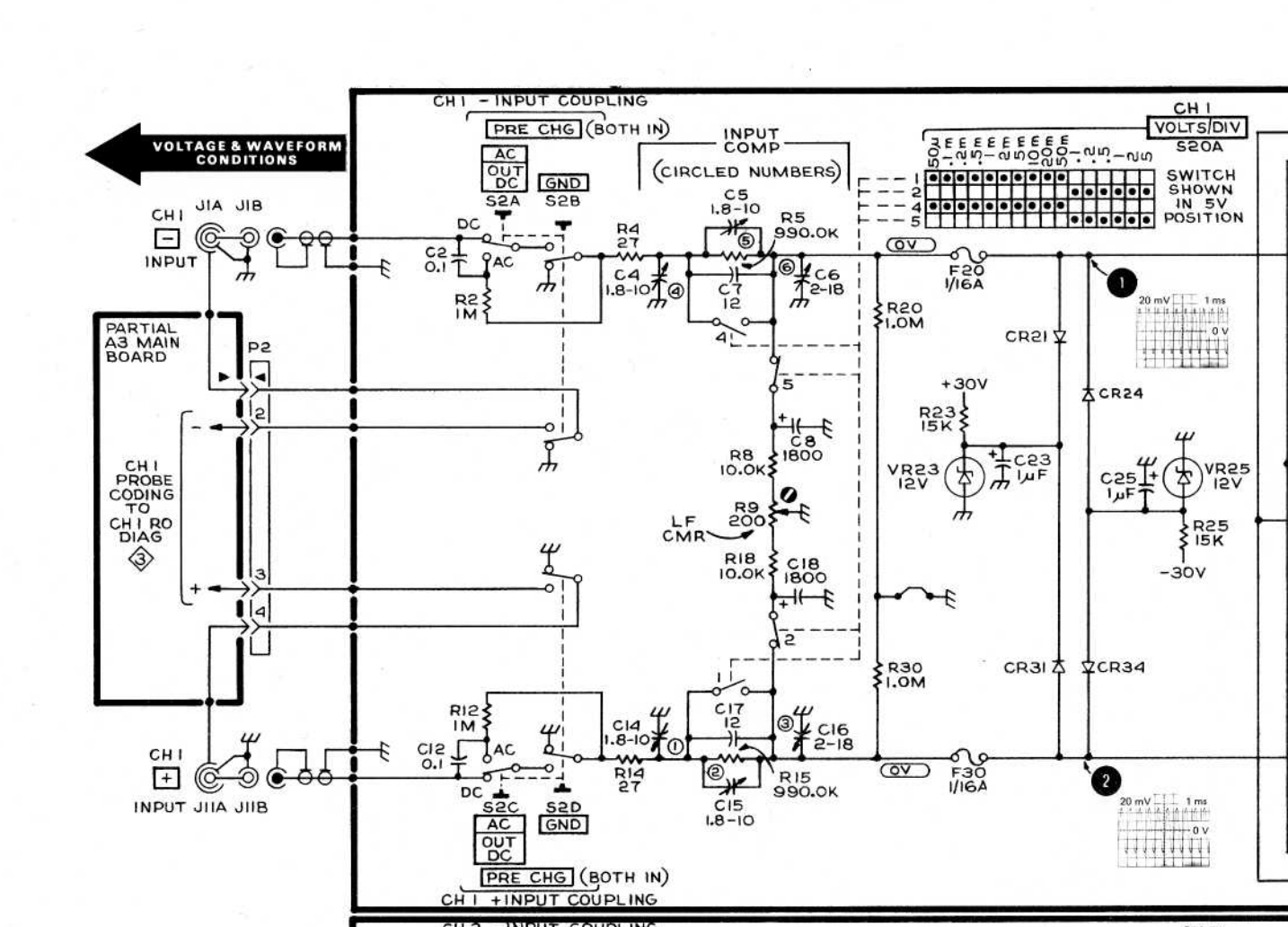

Hi, interesting work! This may have been a preliminary schematic, but I noticed C1 & C2 do not have a charging path. A resistor to ground prior to these capacitors will prevent them from suddenly charging when a source is connected with the preamp turned on. If it’s been addressed already, disregard!My implementation is very close to that of the datasheet. C1/C2 are input coupling caps in a footprint that accommodates up to 25uF (Kemet C4AQLBU5250M12K). With 1M resistors to bias the in-amp's inputs, fc can be made as low as 0.0064Hz.
In my LNA's I provide a low impedance path to short the amplifier input to ground, draining C(in) -- it's via a 3 pin 0.100" Molex header and SPDT switch. The Tektronix differential amplifiers shown below both have this type of input protection with push-buttons.
It's helpful to be able to switch 60 ohms onto the input -- you have a 1nV/Rt Hz reference for sanity testing. 390R will give a 2.5nV/Rt Hz reference.
Also include a screenshot of the 5A26N input protection.
