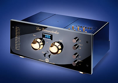

The real MBL-6010D is a 77 pounds beast of a pre-amplifier costing $100,000 ten years ago.
MBL 6010 D preamplifier | Stereophile.com
I have no illusion that you can clone one for $400 (including AD797 upgrade). However, it is very interesting to see how a full function line level pre-amp at affordable cost using the AD797 can sound.
MBL demonstrated that discrete circuitry is not the only way to achieve sonic quality. I fully understand that the op-amp is not the only factor, but MBL showed that they are NOT the limiting factor. It is interesting for the DIY to explore what we can do.

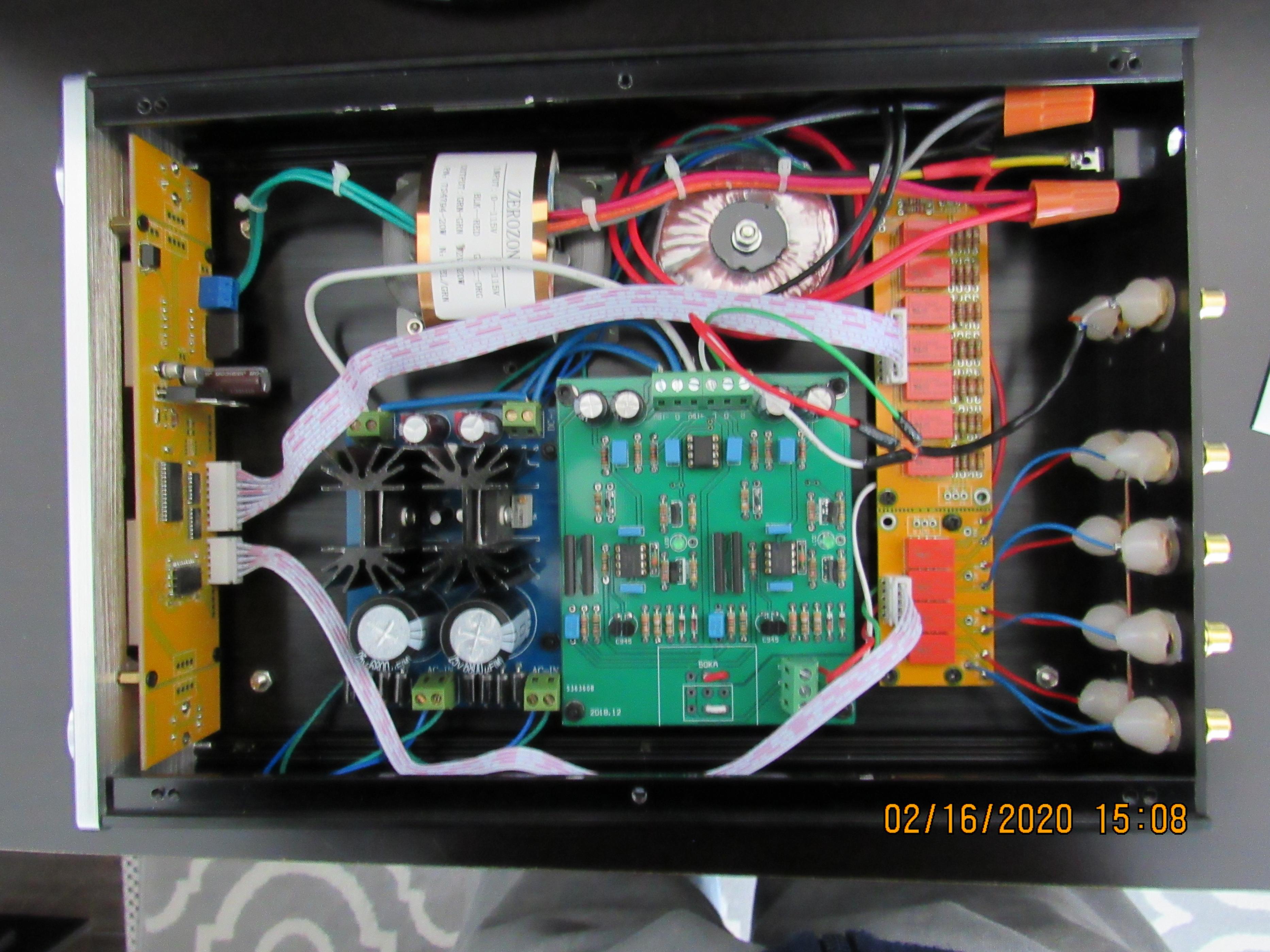

If it sounds better than the JC-2 with only the NE5534, it has potential.Well I received my built up board last week, with the JRC5534DD (presumably fake) op-amps fitted.
I fitted it to my case that previously had a JC-2 in it. I am still waiting for my AD797 op-amps to arrive so I will not do any serious listening until I get them
Anyway after a couple of days of burning in I decided to give it a listen though my Pass H/P amp & AGK701 cans, How did it sound, well not bad at all, certainly better than the JC-2 that was previously being used.
Will give a further update when the AD797's arrive.

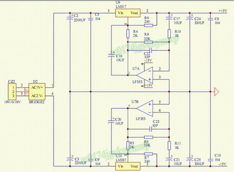

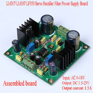

Did you consider replacing the regulator circuit with an outboard low noise PSU? You can get this board using 317/337 with an opamp de-noiser for about $10. See this post at the power supply forum.
What is this opamp doing in this power supply schematic?
For instance if panel sockets were not important there would not be market for high quality panel sockets.
And yet your picture shows some very durable but average sounding rhodium sockets 🙂
I will take all active components (opamp etc.) off the socket before surgical operation.Hi, Yes I have thought about that & also upgrading what would be a fake Alps Pot.
However the board shown, which I had not seen before) outputs DC, So I take it I would need to locate were the DC output from the build in board was. Or can you just wire in a +15 / -15 DC supply to the place where you would normally wire the transformer to?
Cheers
Remove the rectifier diodes, main filter caps and anything else between them. Make a red jumper from one of the AC-in (use the rectifier hole) to the positive hole of the positive filter cap and a black jumper from the other AC-in to the negative hole of the negative filter cap. Leave the small caps and other components after of the main filter caps in place.
Check continuity from the new +DC in to the opamp + supply pin. Any of the opamp will do. Check continuity from the new -DC in to the opamp - supply pin. If good, you are ready for action.
Rhodium is a soft metal meant to improve electrical contact. It needs to be on one side of the plug or the socket. The very, very thin layer of rhodium should not have any sound of its own. It may not be exciting, but it is neutral.And yet your picture shows some very durable but average sounding rhodium sockets 🙂

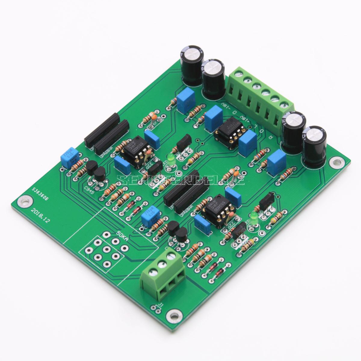

For a simple board with 4 NE5534 and 2 NE5532, the $60 price tab seems way too high. Did you check AliExpress? It seems to be unbalanced in and out only. No balanced port!Hi, Just spotted this for under $60, From what I can tell, this may be suitable for the power supply you suggested
HIFI MBL6010D Preamplifier Preamp Board Tone adjust Fit For NE5532 NE5534 OPA 228243292918 | eBay
Cheers
What potentiameters and how many does it include for the tone control?
Hi Keilau, Great suggestion, Yes same board on Alliexpress without fake op-amps, (which I do not need_ for $36. I do not need balanced, so single ended is fine for me.
Lusya HIFI MBL6010D Preamp Tone audio Board Pre signal Buffer Amplifier Board T0047|Amplifier| - AliExpress
Cheers
When it cannot use the AD797 opamp, how does it relate to the MBL6010D? It must have a different circuit topology than the MLB6010D. However, I do realize that AD797 is not the optimal choice for line level preamp. The confusion just deepens.Lusya said:The board is suitable for the NE5532, NE5534 and OPA series op amps.
The AD797 cannot be placed in the front position. You can use the reverse output at the back to replace the different op amps. The sounds have different changes. OPA series op amps to adjust the sounds you like. The three-stage balance, the density of the sound is good, the treble is strong, the vocals are sweet, and the low frequency is deep.
