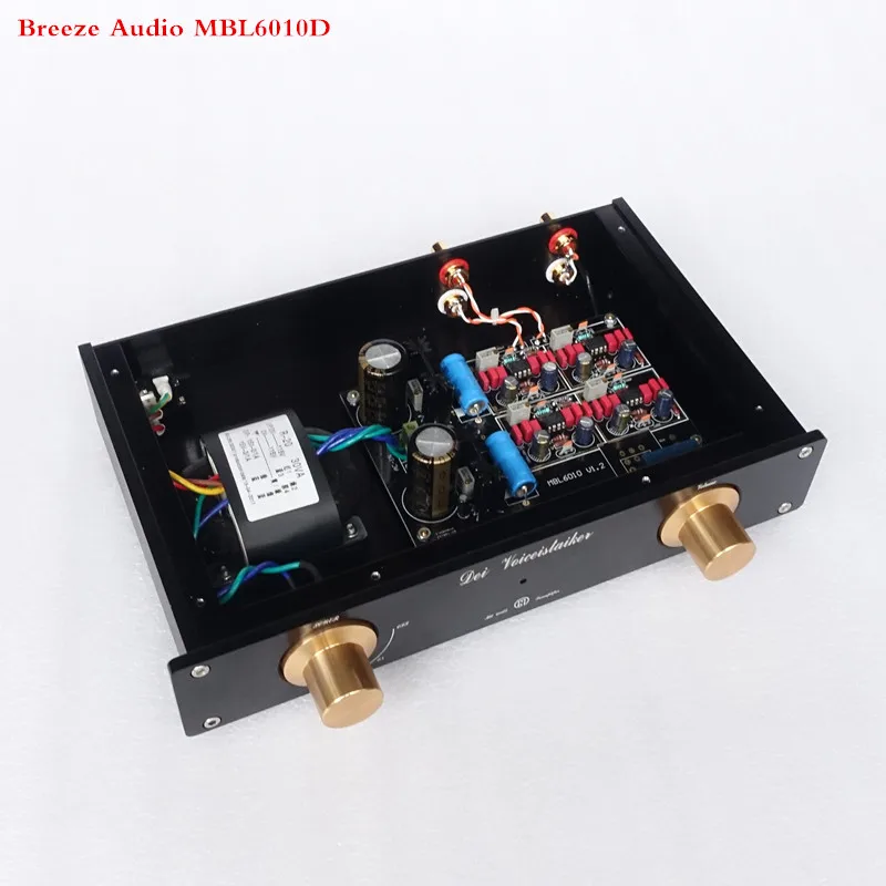

What is everybody's opinion on the following 6010D clone:
Full Balance Remote Version Preamplifier Full Port Based on MBL-6010 W/Chassis | eBay
These "modern" clones on e-bay are not AD797 based which makes the world of difference. Otherwise, the op-amp IC's will worth more than the whole unit.Some golden ear should try out this pre. The upgraded version looks interesting:
Fully Balanced/Single-Ended Preamp Audio XLR/RCA Preamplifier MBL6010 Circuit 325646489324 | eBay
Zero Zone said:* OP-amp: 4PCS NE5532 as input buffer/ 4PCS NE5534 as main amplification, 6PCS NE5534 as output buffer
The unit seems to be well layout and well constructed. The op-amp are all socketed, thus can be substituted with high end op-amp. The problem is that the number of AD797 will cost way more than the clone unit. It is hard to predict the result until someone do the substitute and audition it.
The NE5534/5532 may sound OK if they were genuine IC's. Even so, it is nowhere near sonic quality of the AD797 based MBL-6010.
Update clone MBL6010 with high end op amp
I am wrong. The AD797 and LME49720 are more plentiful and much cheaper than I checked last time.
From Mouser, you can get 10 AD797 for $122 and 4 LME49720 for $8 plus shipping. The MBL-6010 clone can be upgraded for $140. The big question is whether ZeroZone implemented the clone well enough to take advantage of the high end op amps. 😕
It is always my position that active devices must come from reliable sources in the US to avoid chance of getting fake parts. Mouser and DigiKey are good company to deal with.

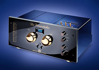

The real MBL6010D pre-amp
The real MBL-6010D is a 77 pounds beast of a pre-amplifier costing $100,000 ten years ago.
MBL 6010 D preamplifier | Stereophile.com
I have no illusion that you can clone one for $400 (including AD797 upgrade). However, it is very interesting to see how a full function line level pre-amp at affordable cost using the AD797 can sound.
MBL demonstrated that discrete circuitry is not the only way to achieve sonic quality. I fully understand that the op-amp is not the only factor, but MBL showed that they are NOT the limiting factor. It is interesting for the DIY to explore what we can do.

Here is a snapshot of the preamp internals:
Weilliang Audio is one of the more reliable shop in China. They provide good value within the constraint of China manufacturing in term of parts sources. Weilliang used to be on DIYAUDIO, but had not returned for many years. If you get genuine Analog Device AD797ANZ, the IC's, Japanese ALPS27 potentiometer, R-core transformer and case alone are worth what you paid for. Let us know how it sounds to you when you get it.
