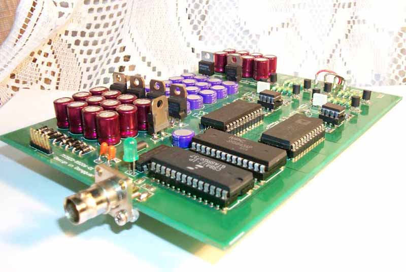

Re: The AD1864NK good than AD1865
Beautifull DAC I wish I had a couple of AD1864 but they are no longer available as Haly point out.

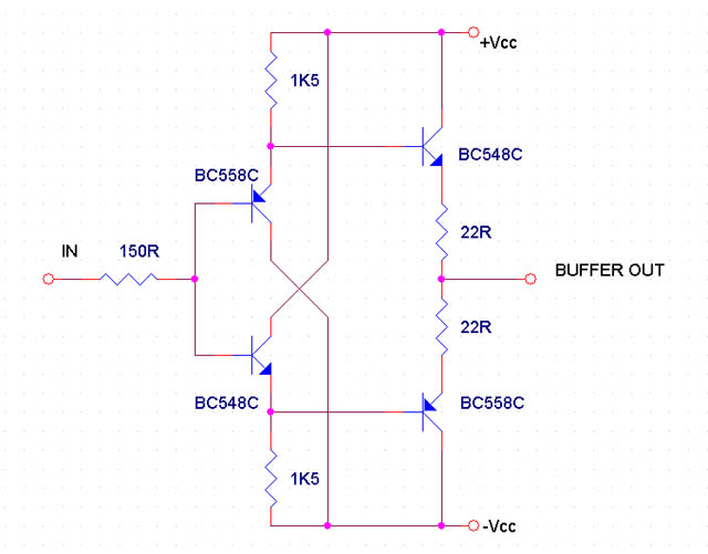

Could you show the schematic for the high speed transistor buffer?
kello said:Using IC Bellow
DIR: CS8412 IS
Digtal FIR: NPC5843
DAC: AD1864 N-K x2pcs
GIC FIR: ADCOM7
Buffer: HighSpeed Transistor Buffer

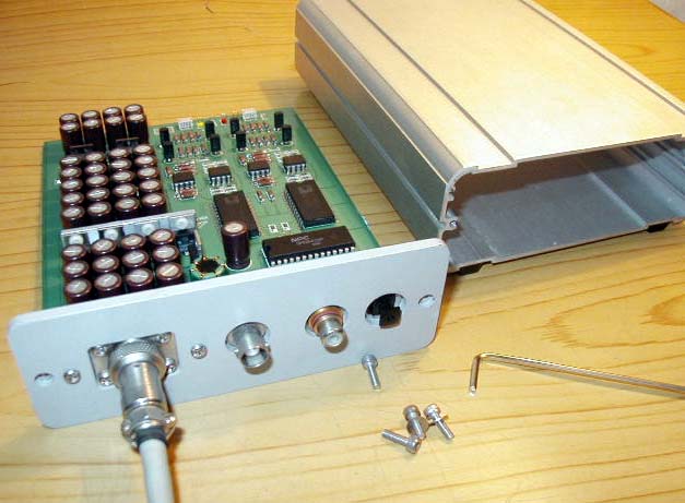

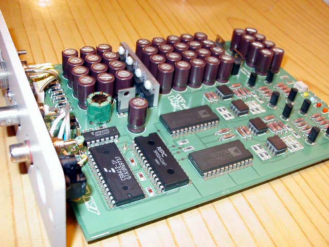

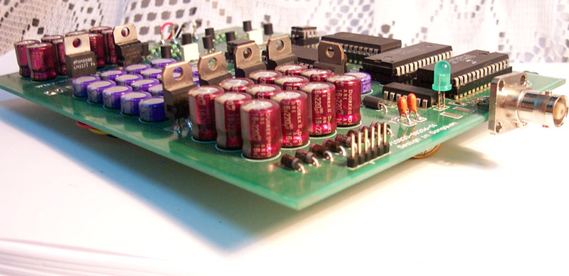

Hi! My fan.
for you quition:
I using array Cap for power supply, is think about the sound quality type balance and control.
All the supply is separate,7805 one for DIR and DigitalFIR.two and two 7905 for DAC +5V digital and Analog.LM317T/337T for GIC FIR and analog buffer out.
20pcs ELNA DuorexII audio serial 16v/220u Cap,6pcs for Digital and 6pcs for Analog. other 8pcs for analog buffer supply (+/-12V)
20Pcs(4 x 5 pcs) SAYON OS-CON SL serial 150u/6.3v solid Cap for DAC supply.
In all the supply path, every one have a high quality 1208type SMD cap in the pin contact( in bottom,very close the IC supply pin)
All the supply path is short and not too long send for all uint with wide wire in bottom layer.
all supply design think about the audio quality and better SN peroformance.
in the DAC board, the SN performance is very good,Can't hear any
noise in high output (- infinity digital CD single test). in test record good than -102dB about -106dB, test show one channel is difference 2~4dB
(using HP8903B audio analyzer)
the sound type of this DAC is shape, Clear than PCM63K, but Voice the PCM63K is good than.
Re: Re: The AD1864NK good than AD1865
See....just like this.

Re: Re: Re: The AD1864NK good than AD1865
Kello,
Nice and simple buffer, congratulations...
I see you don't use output caps, How do you manage to zero the output?
Don't you have any drift from zero with temperature variations?
Kello,
Re: Re: Re: Re: The AD1864NK good than AD1865
Yes, My DAC without any output caps.the DC voltage is -2/+3mV in normal operation temperature range. normal time, many preamp or Poweramp have the DC cut Cap, so DAC the cap can remove no problem is OK.
for the DC output performance, I control accuracy of all component is very important ,the power regulate out unbalance <0.1V, the resister <1% and transistor HFE<5% too.
