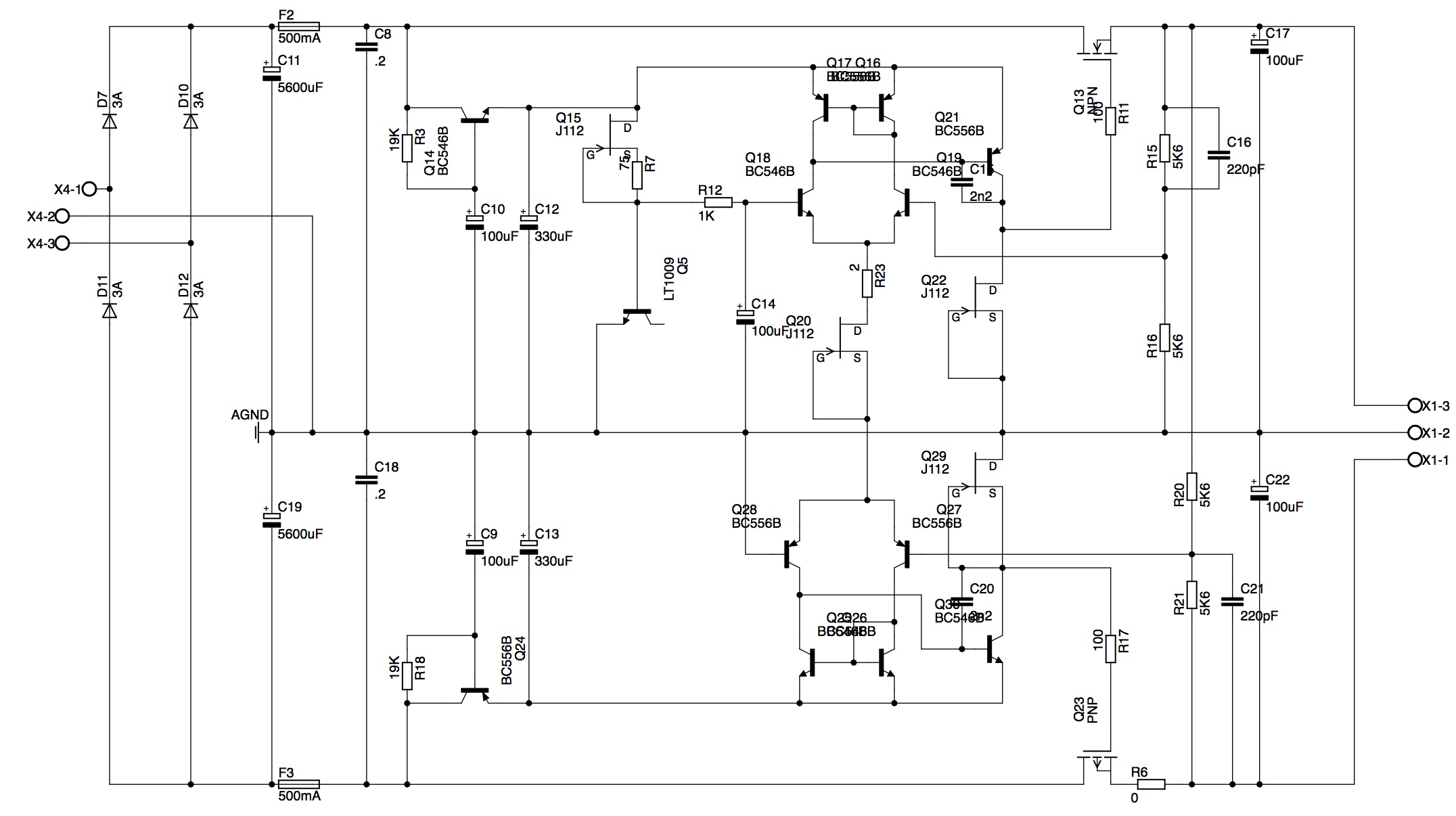

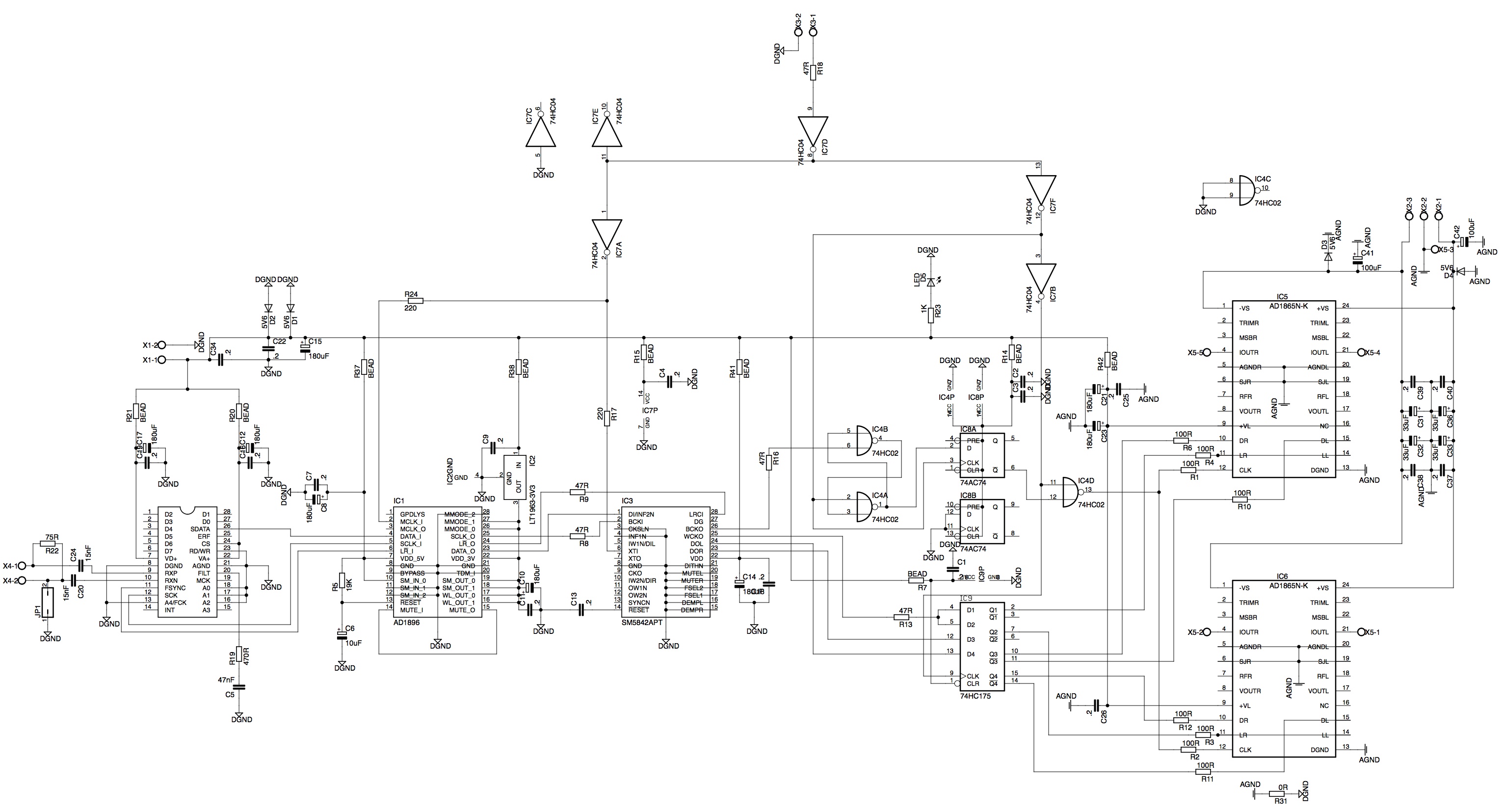

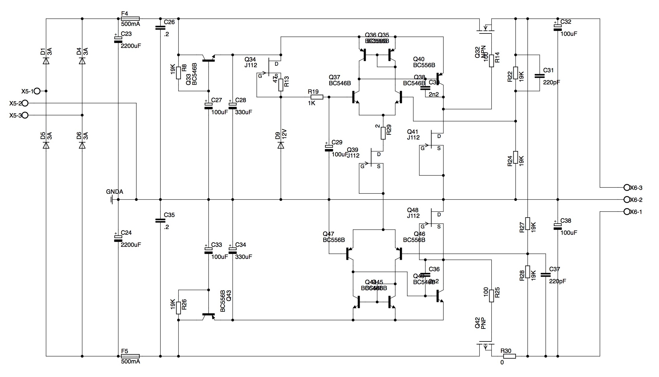

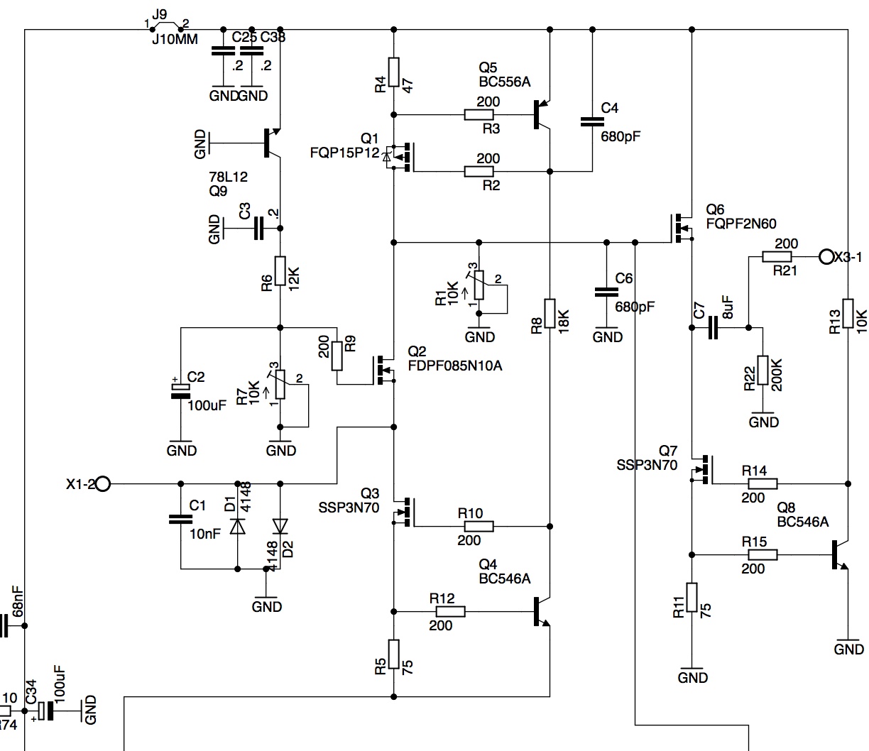

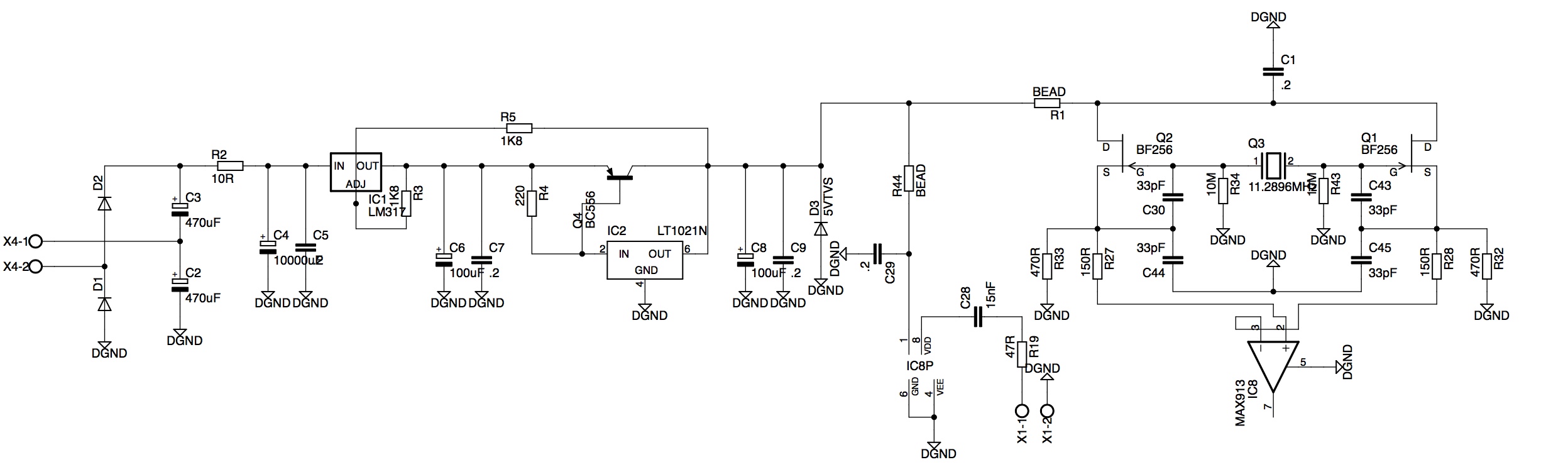

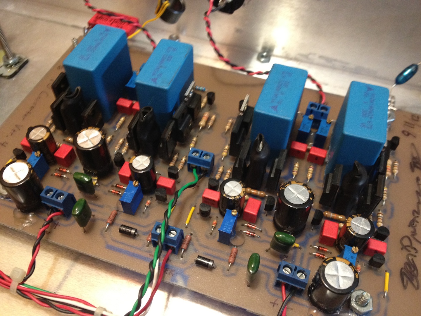

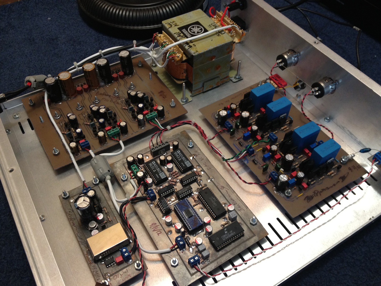

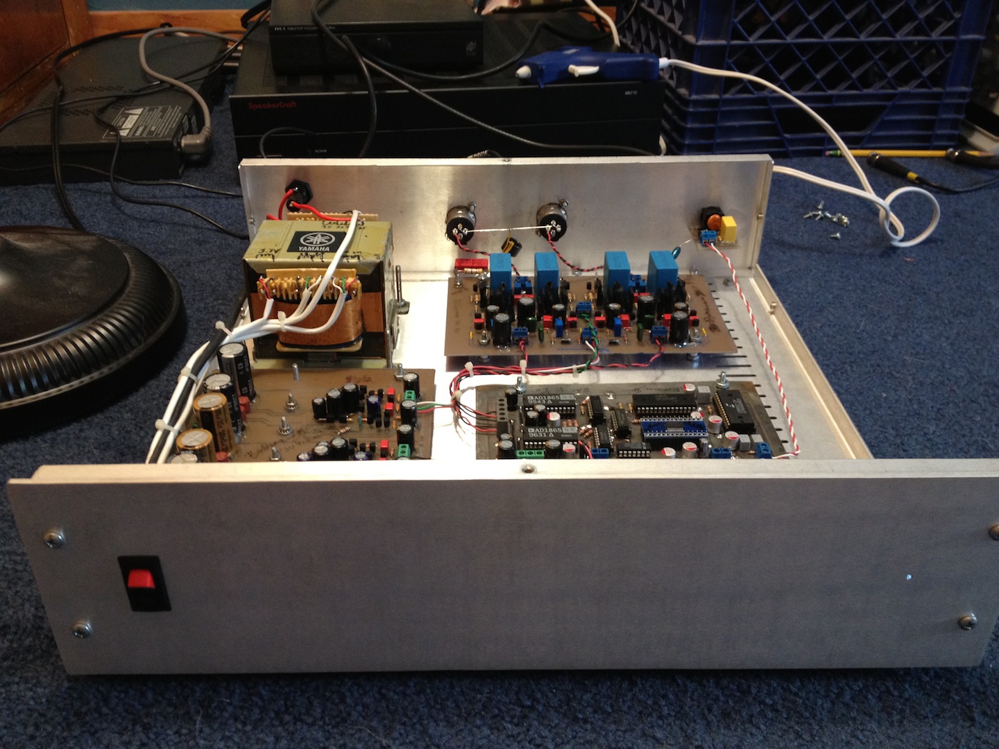

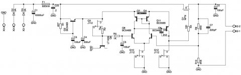

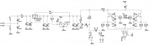

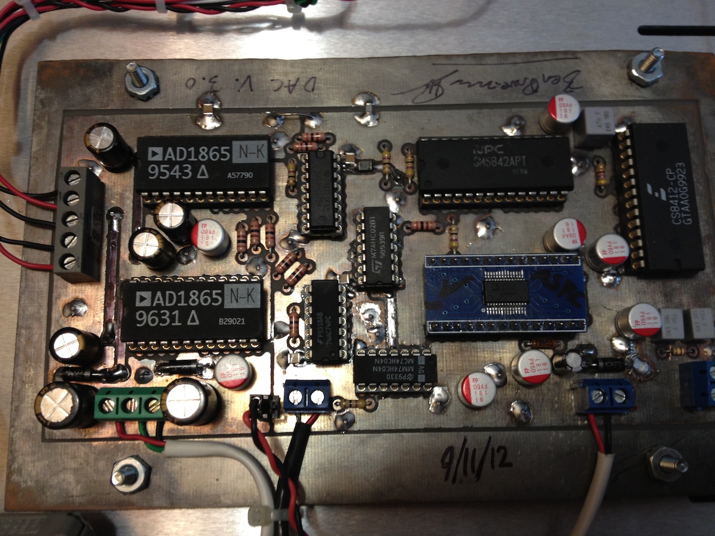

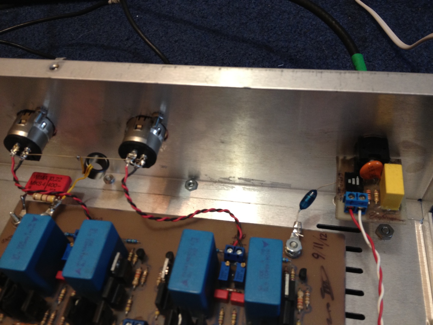

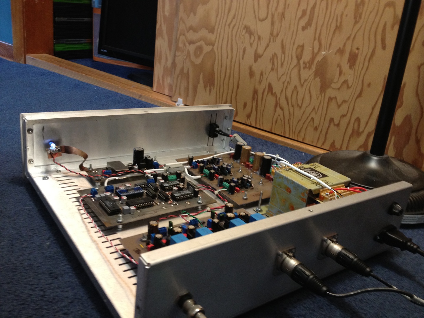

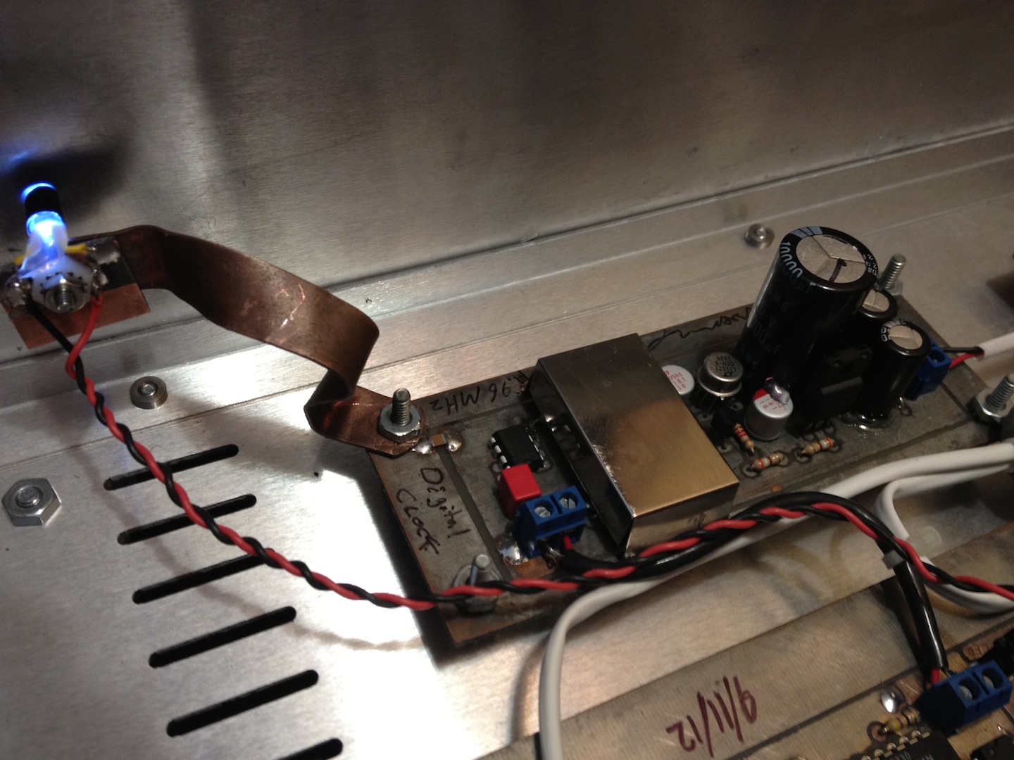

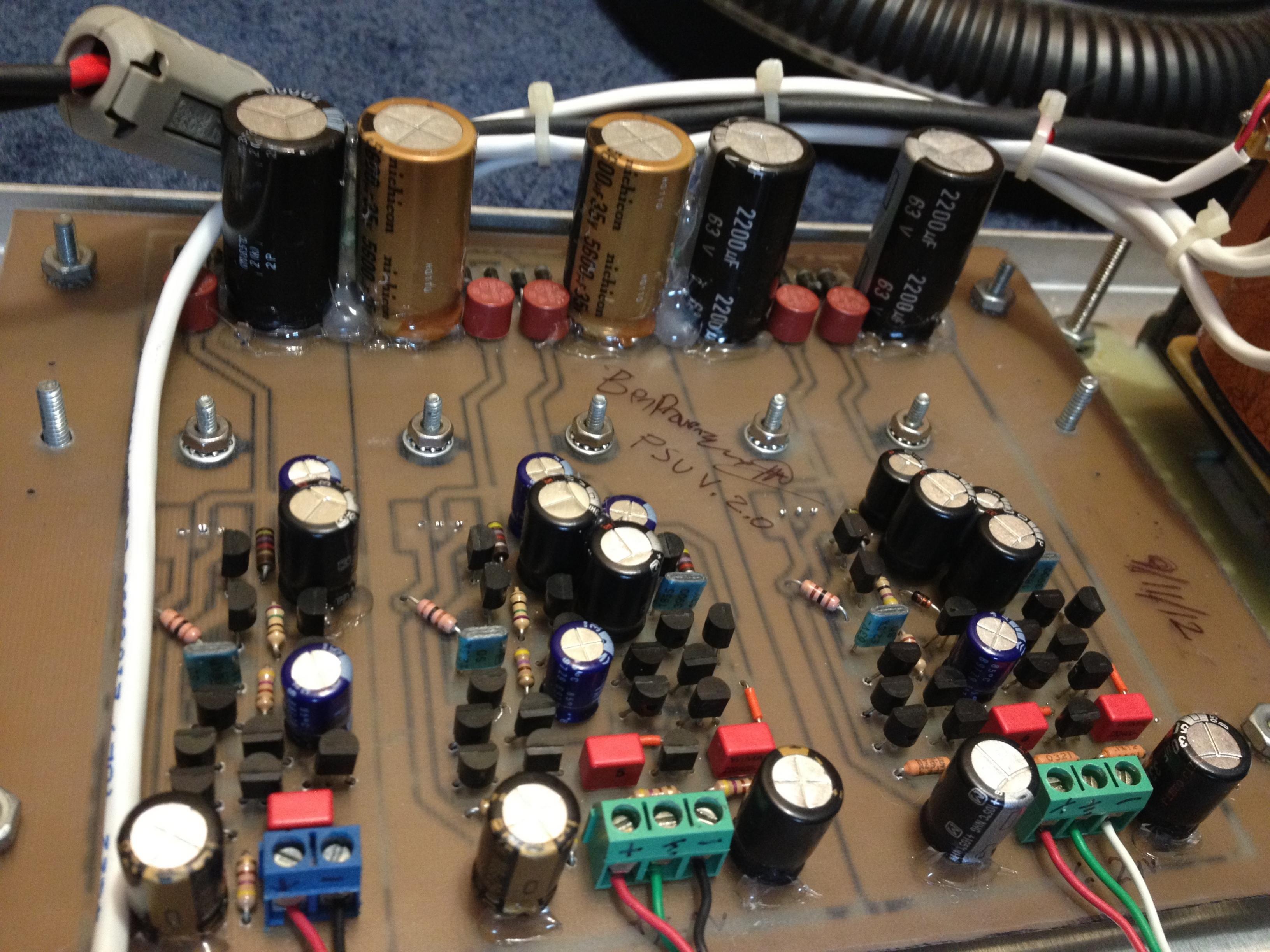

These are the schematics for all of the PCB's in the DAC, excluding the input PCB which is just the NEWAVA pulse transformer on a PCB with a BNC connector. I included the EAGLE CAD files in a zip folder.
The JFETS in the PSU's are actually PF5102's matched to 4ma for DAC,IV PSU and 6ma for Digital PSU.
In the IV stage the transistor labeled 78L12 is a 12V regulator not a transistor (I could not find the symbol for a TO-92 7812)
The rail voltage for the IV Stage is +/- 24VDC
