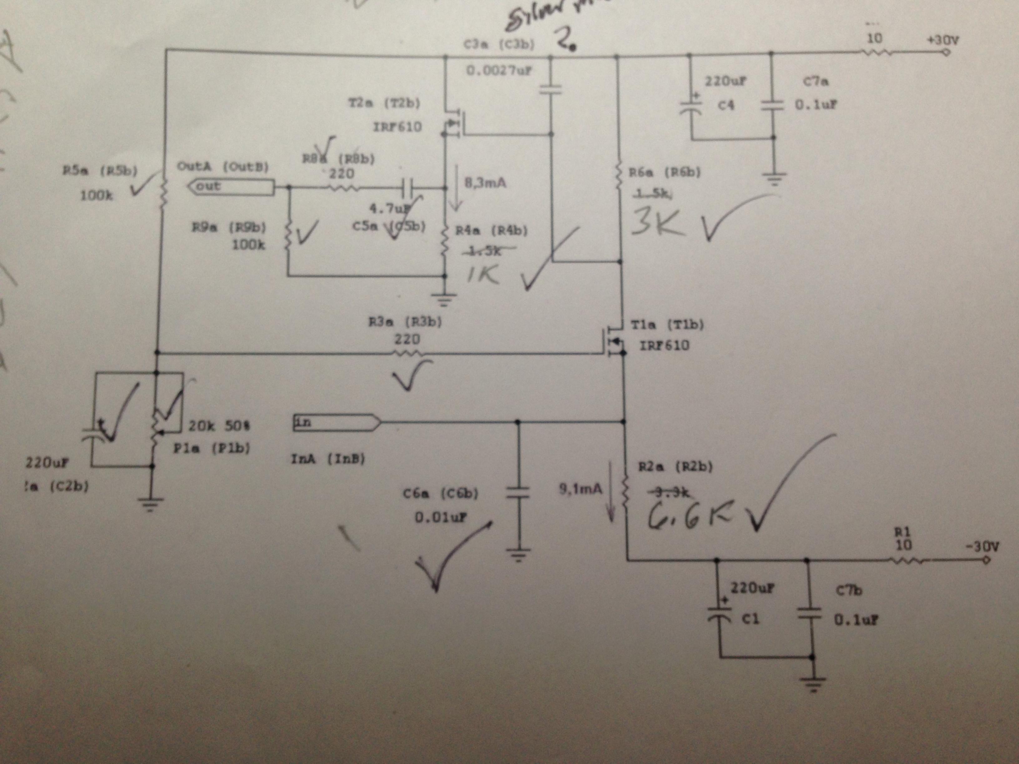

For the life of me i can't find the exact thread I was looking at. but here is a start..
DIY D1 I/V STAGE
the original D1 was designed to follow a BB PCM63 which I believe had twice the Iout of the AD18XXs. There is a thread out there where it was simulated and some R value changes made it run perfectly with 1ma Iout.
....then there is the ZEN I/V
Zen I/V Converter | Pass DIY

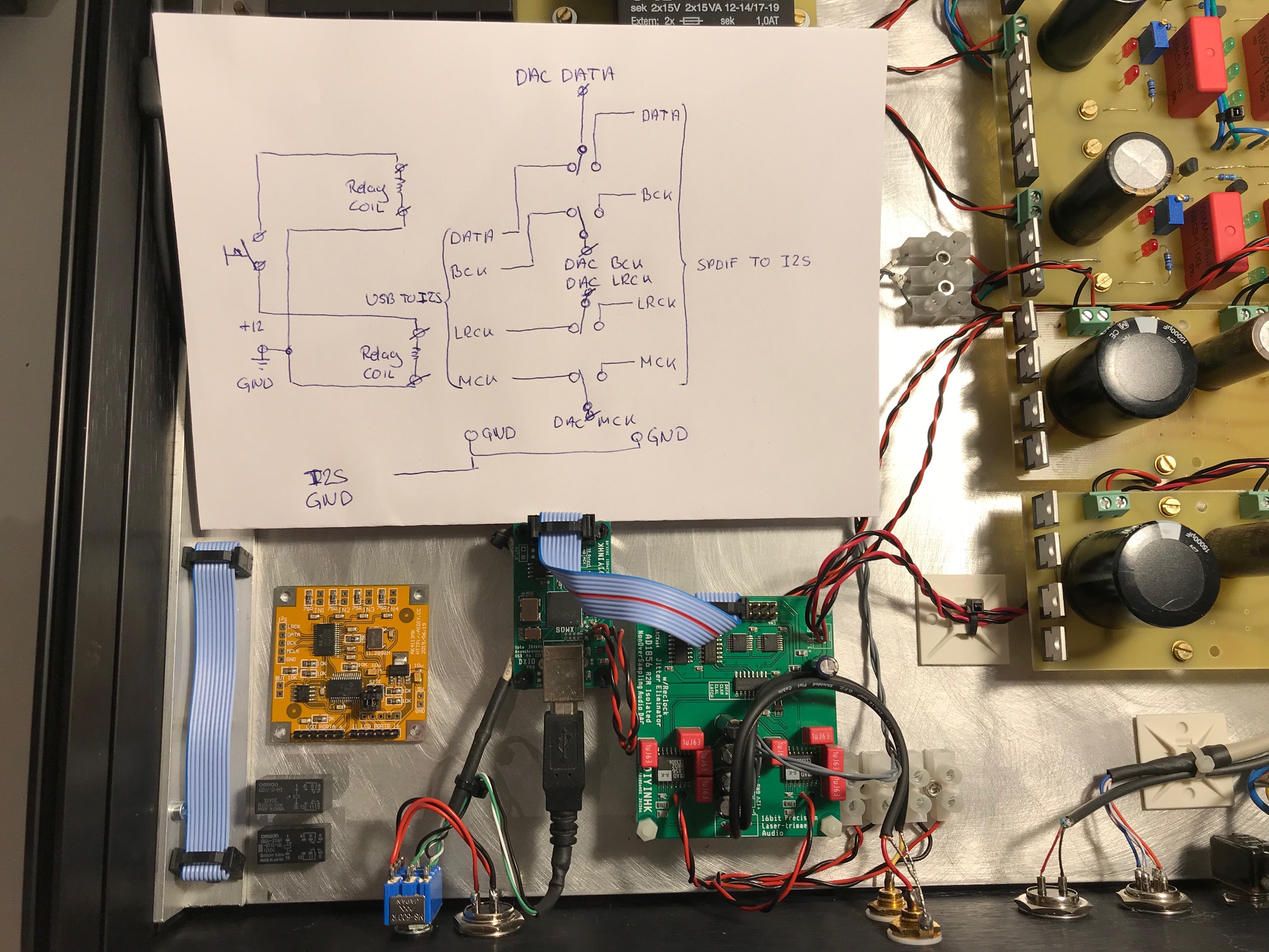

SWITCHING between spdif and usb inputs
So while still in progress with figuring out which kindoff i/v i will try out, one of my colleges would like to try this DAC with some CD-player with spdif-out; so i bought this cheap spdif to i2s converter.
Quistion is, if it's okay to relay-switch the 4 lines, letting the "i2s-gnd" just pass through.
Anyway look at the attached picture, for better explanation.
The picture shows the spdif to i2s converter, the usb to i2s and the DAC!

Looks like you're getting pretty brave switching that data around - please let us know how it works out! I personally don't think I could pull it off.

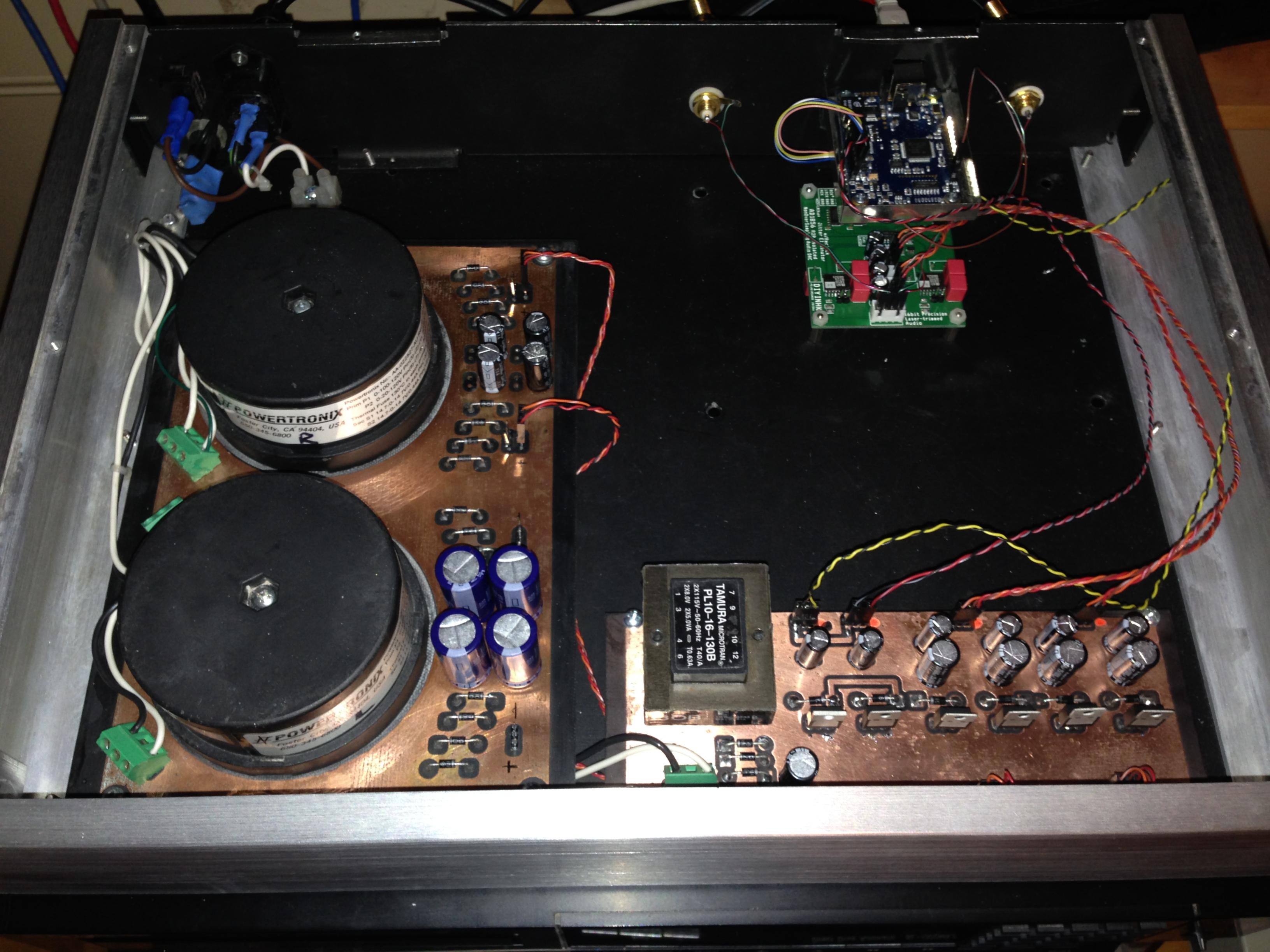

Anyway, I got my board in, and it's running on V out. Using JLsounds I2SoverUSB (recommended for the support alone. Nice guy)
Sounds better than anything I've had here, not that I've had great stuff. Clean, 3 dimensional, quiet, etc. Looking forward to doing the Pass D1 I/V circuit. have amps to build first though 🙂
