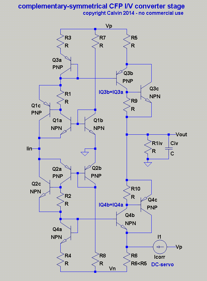

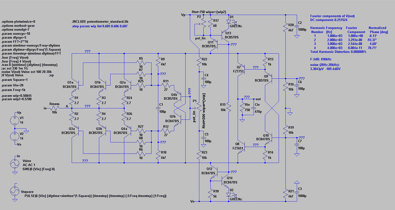

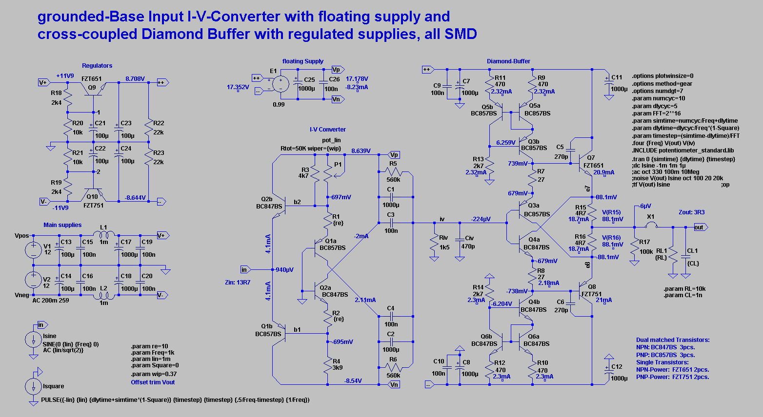

found the principle circuit and a couple of other grounded-base IV stages 😉
Shown inthe first pic is a complementary CFP-Input working on current mirrors with CFP output legs.
Of course can the CM input legs (Q3a/Q4a) be CFPed also.
The third pic is a folded cascode with paralleled input transistors for reduced input-impedance and/or high-current DAC-outputs.
The second pic shows a bipolar IV-stage Sen/Zen-style (after EUVL) with floating supply and bipolar buffer.
The floating supply for the IV-part could be generated from the symmetrical Buffer-Supplies with an DC-DC switcher (with low coupling capacitance ... XP-Power for example)
Attached also is a AES-Paper by Smedegaard (11/1996) that deals with the Q of low input impedance for IV-converters.

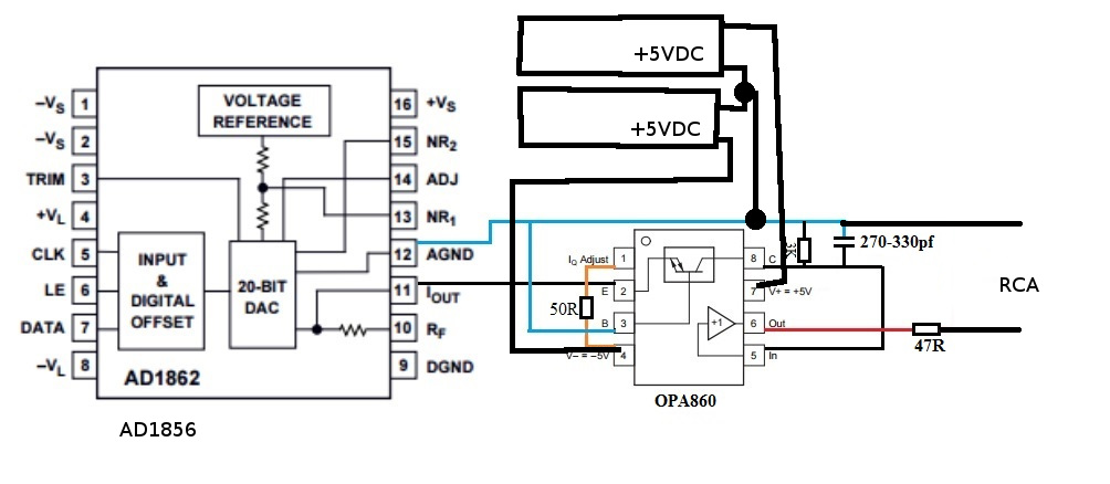

Hello here!
I found another thread, where OPA860 was suggested as i/v stage for the AD1862.
See eventually post #38 in this http://www.diyaudio.com/forums/digital-line-level/299414-i-v-analog-output-stage-ad1862-4.html... Where Calvin is explaining a lot 🙂
As i understand the OPA860 is good, when no buffer are used after opamp, and the OPA861 is when one like to roll his own buffer?
Right ? 😉
I have "corrected" the circuit, and maybe i can try this for a start?
It look's like the AD1862 is much like my AD1856, but havent been studying it closely yet through.
Jesper.

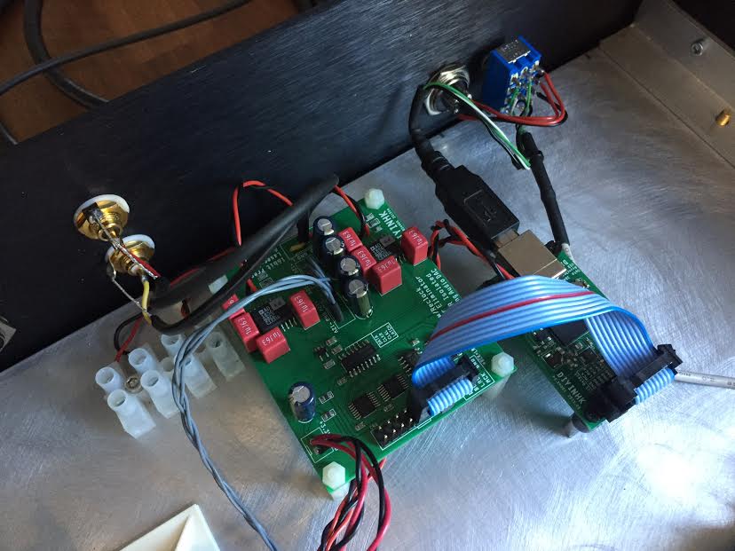

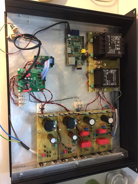

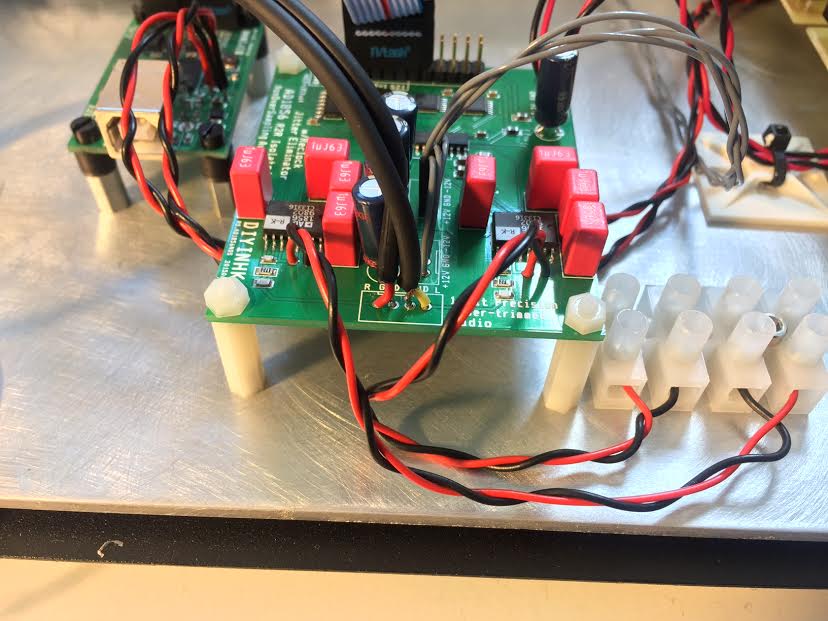

Hi here.
I am in progress of building my little DAC, with the giant's PSU's 🙂 into a chassis.
But i am i doubt howto connect the GND connection from the DAC to chassis.
I have soldered in two RCA's on the DAC-pcb (See picture), and this setup is working without any hum or noise at all; but i have to attach the GND line from maybee the end of the RCA cables, or is it better i do it at the PCB end? or maybee somewhere else? -Any suggestions?
The DAC is feeded with +/-12vdc in the middle of the pcb, with the grey wires.
Also the DAC is feeded with 3.3vdc (right top on picture) -I think this connection is isolated from the DAC chip themselves, and only used for the "stop-clock"... The last psu is feeding +5vdc into the xmos-pcb.
Hoping someone can tell me a good spot to connect gnd to chassis?
You'll want to ensure that common-mode currents (carried by your interconnects, both digital and analogue) find their way back to mains earth without passing through sensitive circuit nodes en-route. However you also want the common-mode currents which enter via your transformers' inter-winding capacitance to resolve to earth without passing through sensitive nodes.
Trying to satisfy both gives something of a conundrum - if you resolve the interconnect currents optimally this means a 0V-chassis connection close to where the interconnects enter. However may well mean your transformer currents pass through your PCB to get to chassis which is far from optimal.

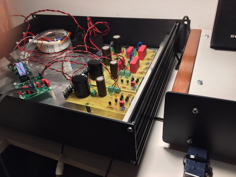

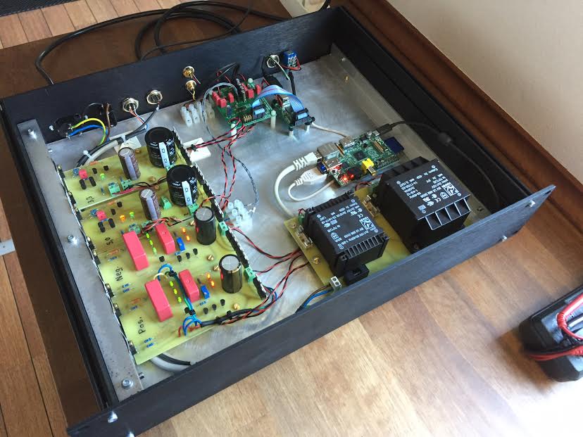

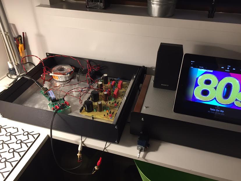

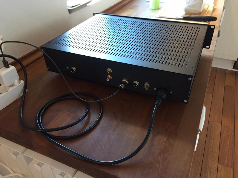

🙂 Morning folk's!
Today i finally got my DAC packed all up in this brandnew hifi2000/modushop chassis.
Going to make some "long"-term test before it is going into my main system.
If one look carefully at the pictures, you can see that i after many hours of struggling with this finally got a USB switch to work proberly. The switch can choose between USB cable input or "internal" RaspberryPi player.
As for the I/V conversion, Calvin has been so kind to calculate and send me some schematic, but it would be some time before i can actually make it through.
*Have a nice day out'there!
Jesper.
🙂 Morning folk's!
