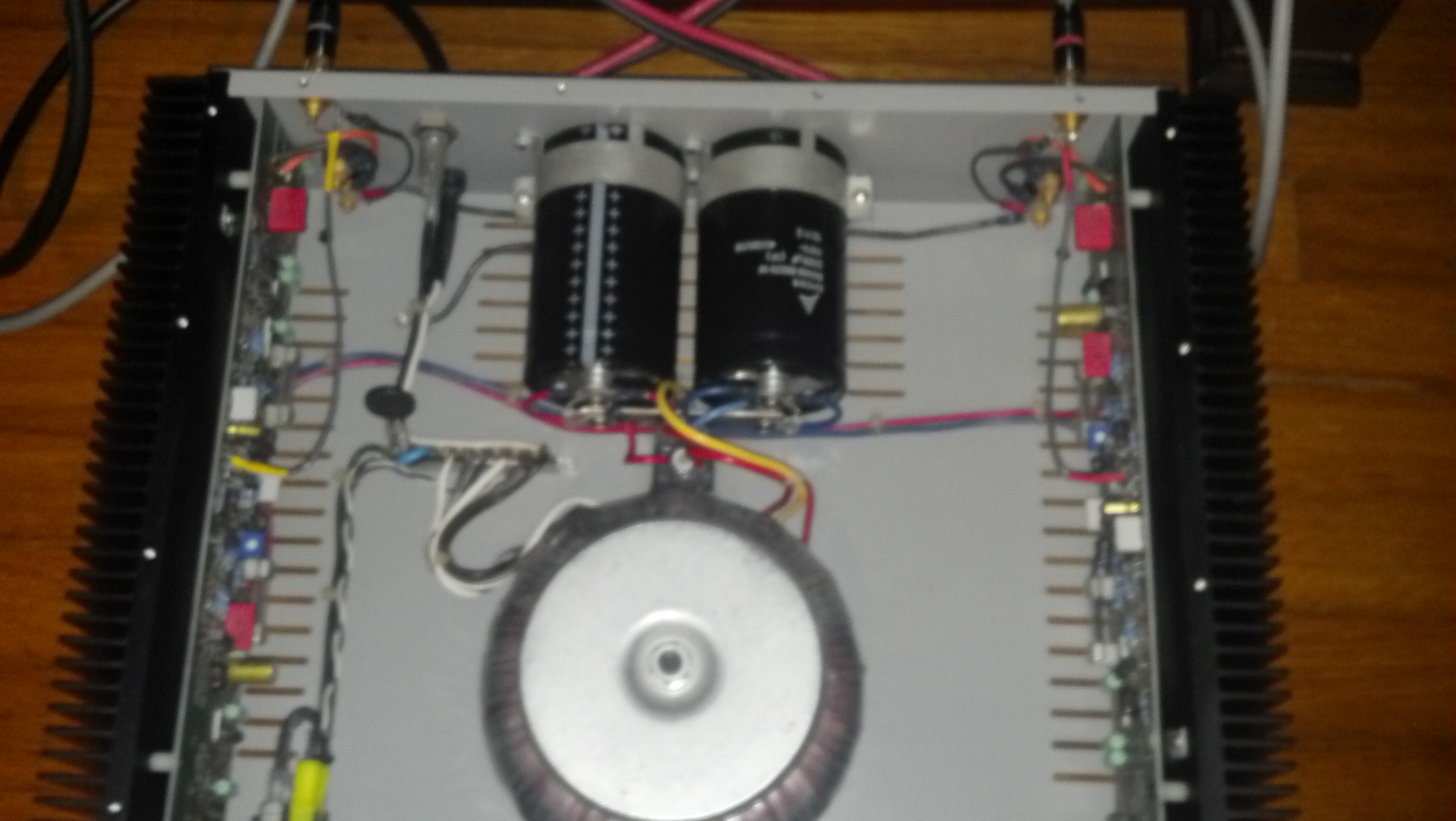

I have found a couple options for power supply caps and was wondering what you guys might recommend.
1) epcos 22,000 mf 100v $59.0ea. These have really low ESR (5 typ and 10 max @100hz) Ripple current 17a @ 100hz @85 deg or 45a @40 deg. They are almost 3 times the price on Mouser. I would like to up grade to the 33000 mf unit but Digikey does not have them and like mentioned, mouser is too much coin.
2) kendeil K02 22,000 mf 100v. $155 pair. These have an ESR of 10 typ @100hz. Ripple current 16.5a @ 100hz @105 deg or 46.2a @40 deg. Very similar ripple but higher ESR than EPCOS. They are normally 3" base but seller has them in 2.5" which fits factory mount.
3) Kendeil K01 33,000 mf 100v $165 pair. ESR 10 Ripple 23.1 Based on 85c
Is it worth upgrading to larger Mf. I have to change mount but there is room. Can't find the 33000mf Epcos for a good price. Digikey does not list that size. Could by 4 22000 units but is it really necessary. what would I gain?
Mike
got my Epcos caps installed. Just dio fit. Raised the bias as well. Sounds much smoother on top end. Caps that we in it were from 1992. Also bought some Elna Silmic II caps to replace the old input and feed back electrolytics. Haven't installed them yet.

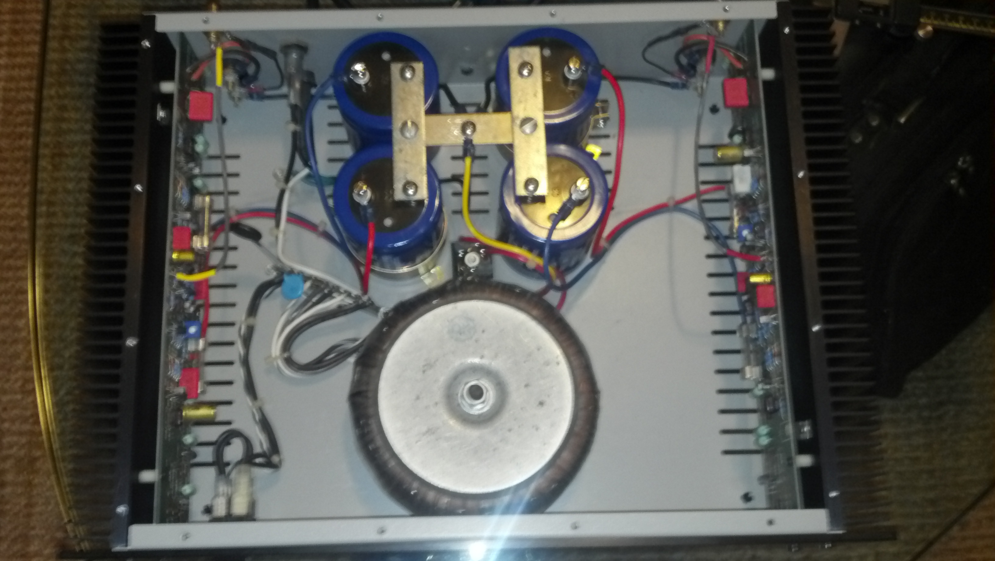

Just for curiosity, I started mocking up a layout in my other A250 using the spare two caps that I just pulled from the 1st a250. I now have 4 22,000 mf caps installed in a very clean setup. The original caps are short enough to stand vertically. I wonder why they didn't do it this way. Very easy to fit all 4 caps in there. Now I just have to figure how to power them from the rectifier. I can double the positive and negative leads I guess or add a second rectifier. The one that comes stock is a 35a diotec.
heres some pics

Not an engineer. If by LTP you mean bias, I have already raised it to 6mv. I have not done anything else other than swap to new PS caps. There is no audible hum or his with patch cords disconnected. I do get hiss with patch cords connected but I know this comes from Acurus act3 pre/pro. I have no bypass caps, no snubbers, no soft recovery diodes. Just stock PS setup. If I don't hear hum, is there any reason to further bolster power supply.
