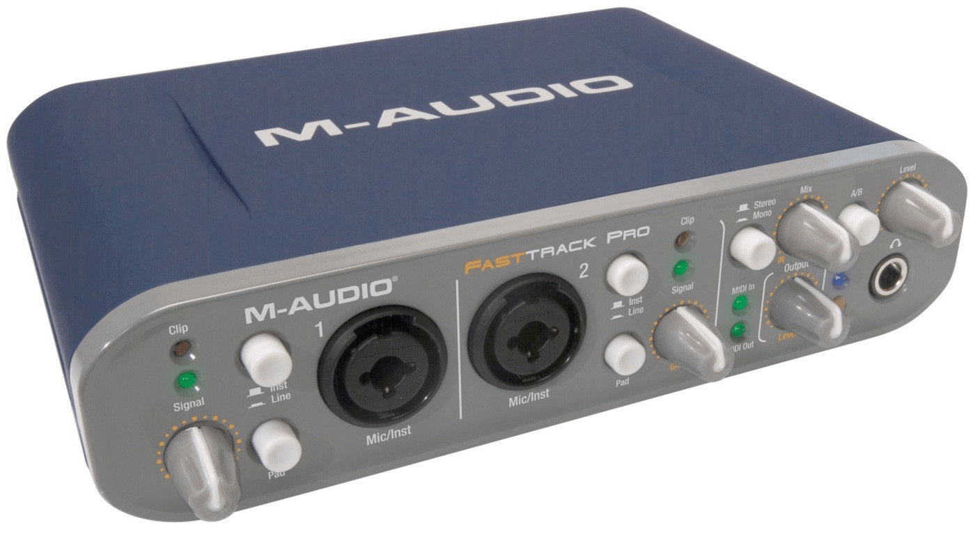

For two outputs I'm using an old M-AUDIO interface, Debian Linux v 12 and CamillaDSP. My goal with this was learning how to use this program.
Crossed channels @ 250Hz or so, buffers and full ranges. I have a more recent focusrite scarlett 2i2 gen 2 and I read somewhere that it's hard to control the two channels but I still haven't tried.
I like this approach. If I get the CamillaDSP input from the interface so that I use the computer for EQ I'll add some latency, not sure what the achievable minimum is but not a problem for streaming.
