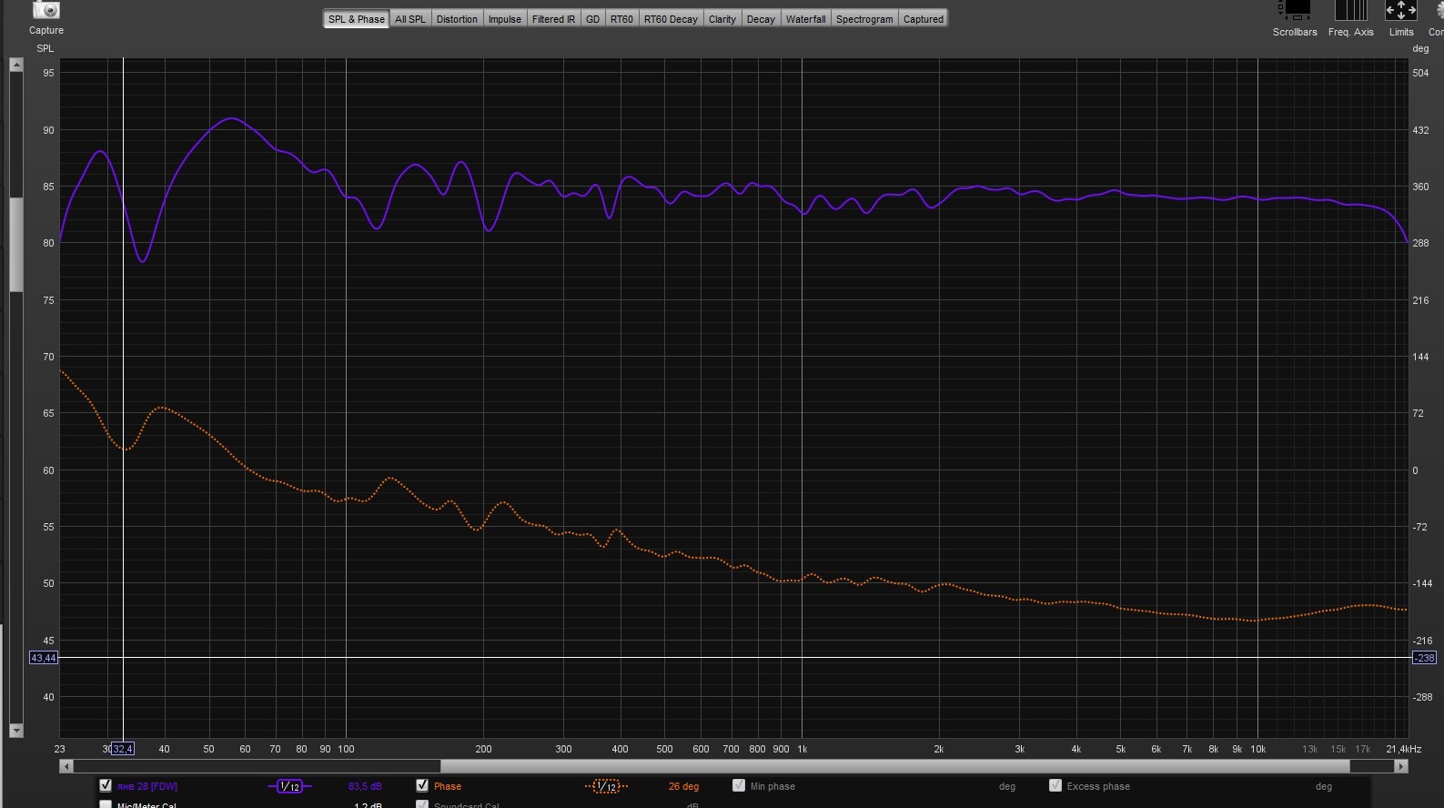

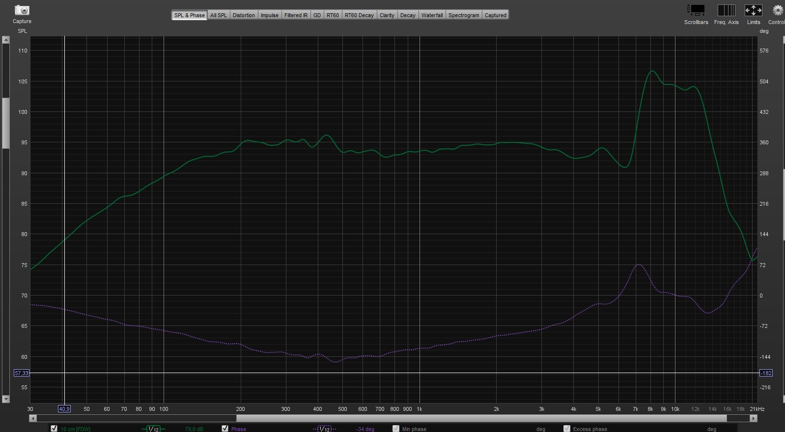

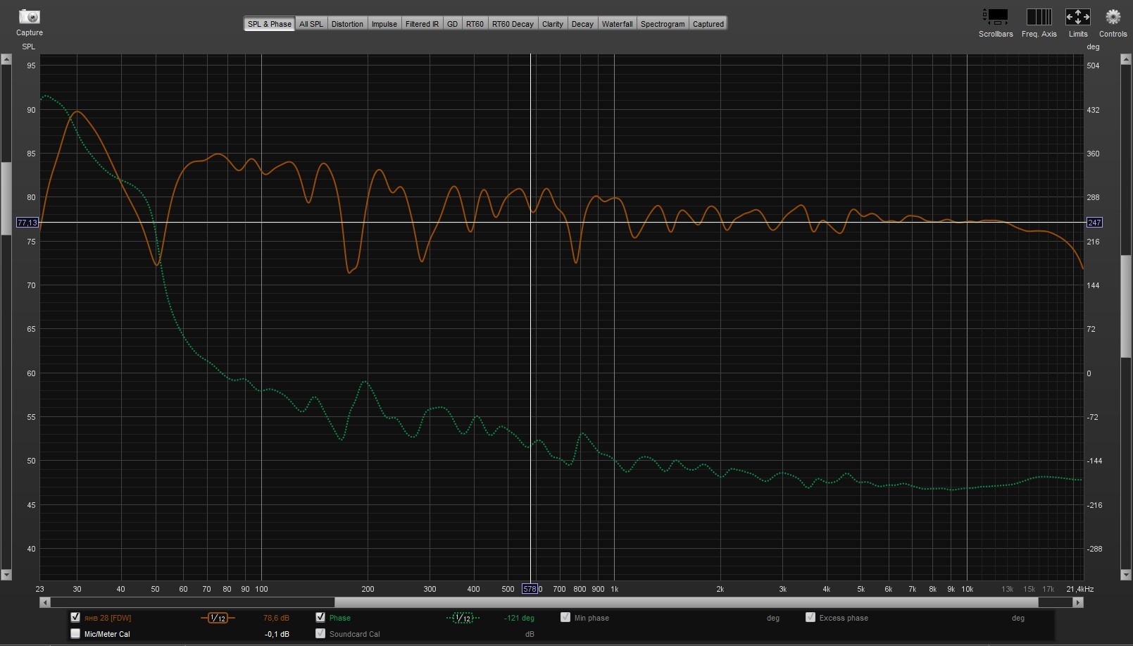

Can someone check my measurement? Did I do everything right? Since I have a 2nd filter order, the midrange of the driver is in antiphase, right?
Why is it that, judging by the measurements, there is no need to set a "delay" for the low-frequency driver, that is, the delay of the mid + high driver? The impulse is improved to a certain value, but any delay degrades the phase of the low-frequency driver. Or is the 30 degree phase increase not as important as the delay setting? Indeed, in fact, delay for MF + HF driver is necessary.
Looking at the measurements, in order to straighten the phase even more, I must, on the contrary, set the delay for the low-frequency driver
I set the "delay" for the bass driver. According to mathematical calculations, it turned out to be 0.5 ms. According to measurements, 0.6 ms is optimal. A delay above 0.6 ms starts to make changes in the pulse to 0 on the time axis.
It turns out:
LF 0 ms
MF 0.6 ms
HF 0.69 ms
Probably, the impulse is not the "fastest", but this is most likely due to the size of the 12" driver and the cheap amplifier

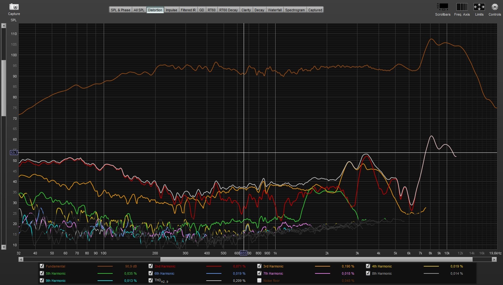

1. 1x Kartesian Wom120_vMS, in cabinet, 10 cm distance
2. 30 cm distance distortion, 0.2% average in the operating range (from 0.1% to 0.22% and one peak 0.34% at 853 Hz). I think it's a good result. With a more expensive amplifier and DAC, the result would be even less.
I must say that I have a feeling that I lack the sharpness of the voice in the music.
Unfortunately, I don't have any other speakers to compare with. When I finish the second cabinet, I'll take my old speakers from a friend to make a comparison, maybe it seems to me.
Probably, if I had the opportunity to do everything differently, I would make 3-4-way acoustics and put a dome speaker on the midrange, such as the new BlieSMa or Morel EM1308.
