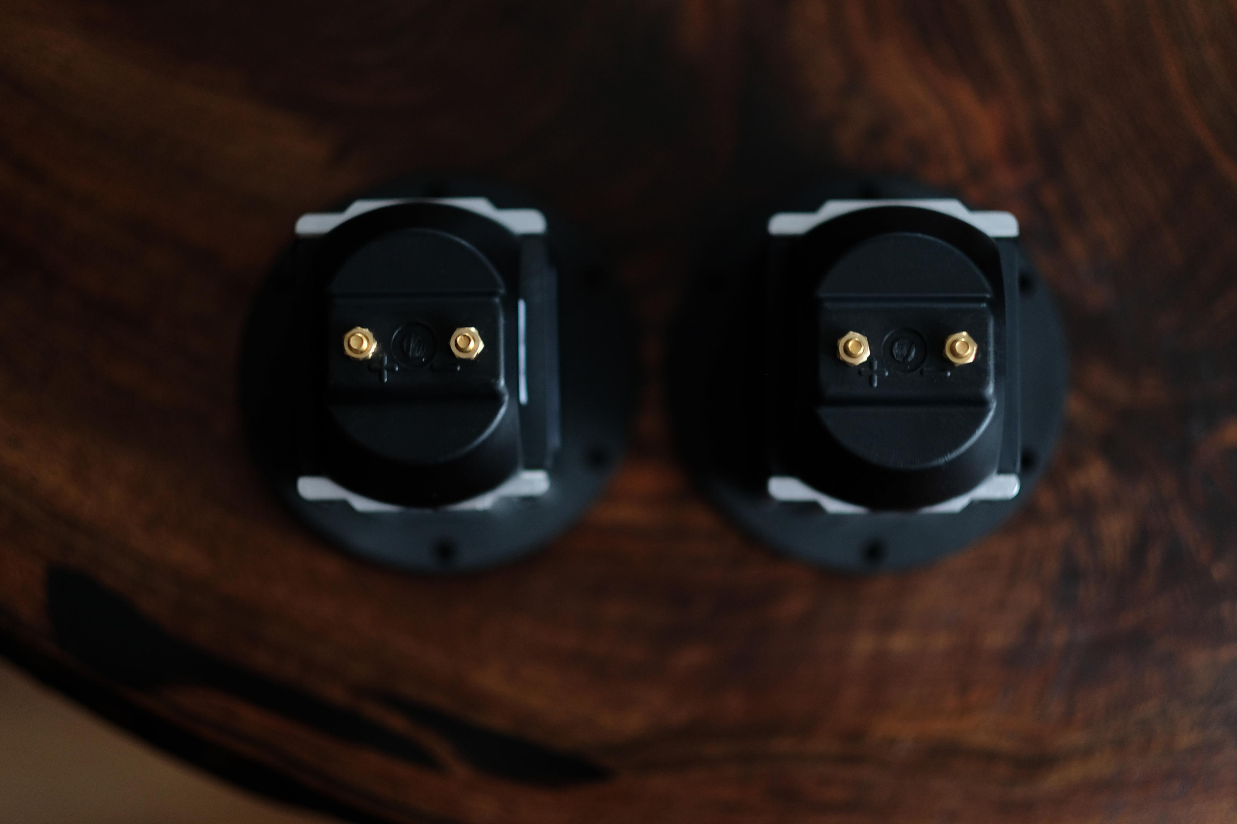

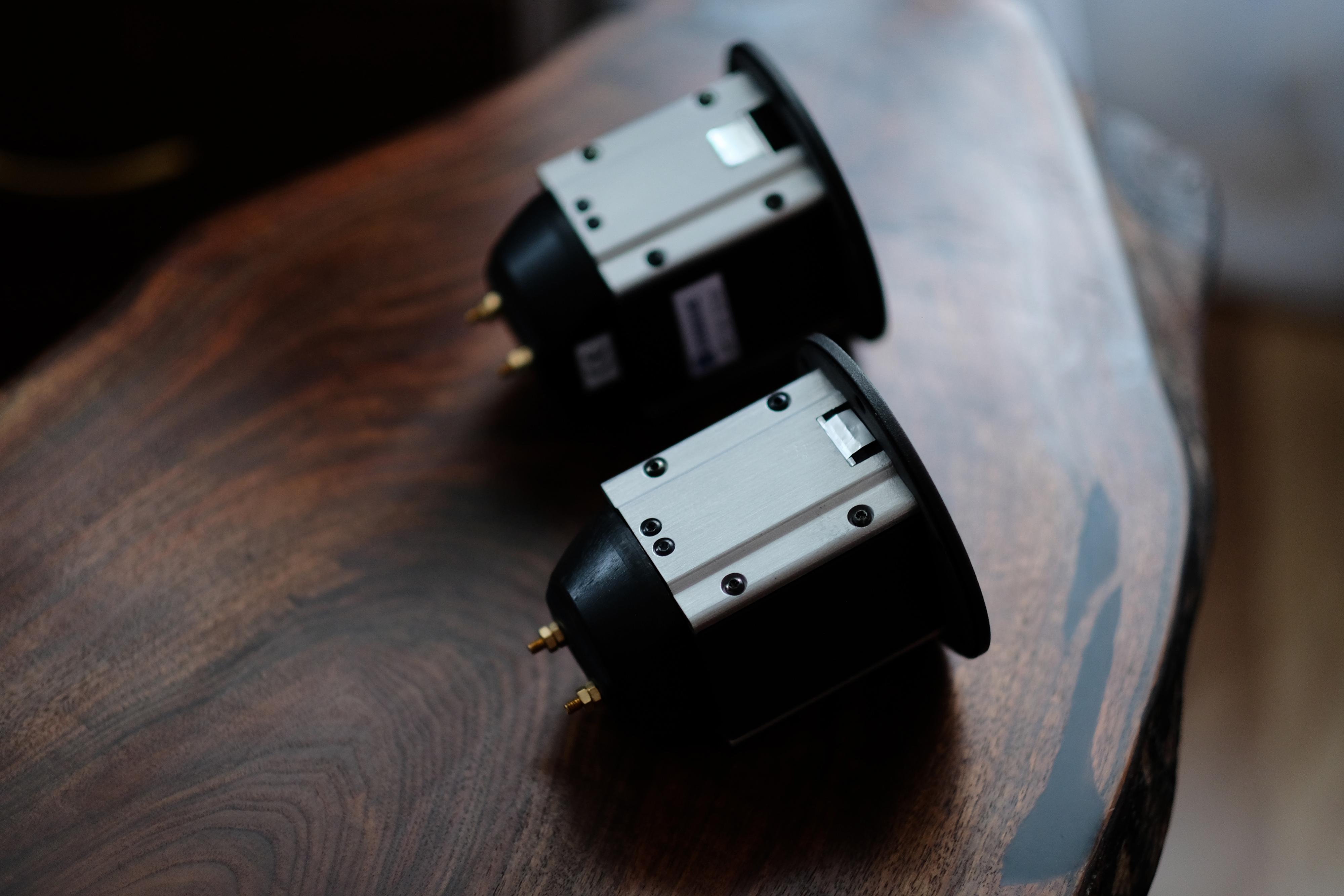

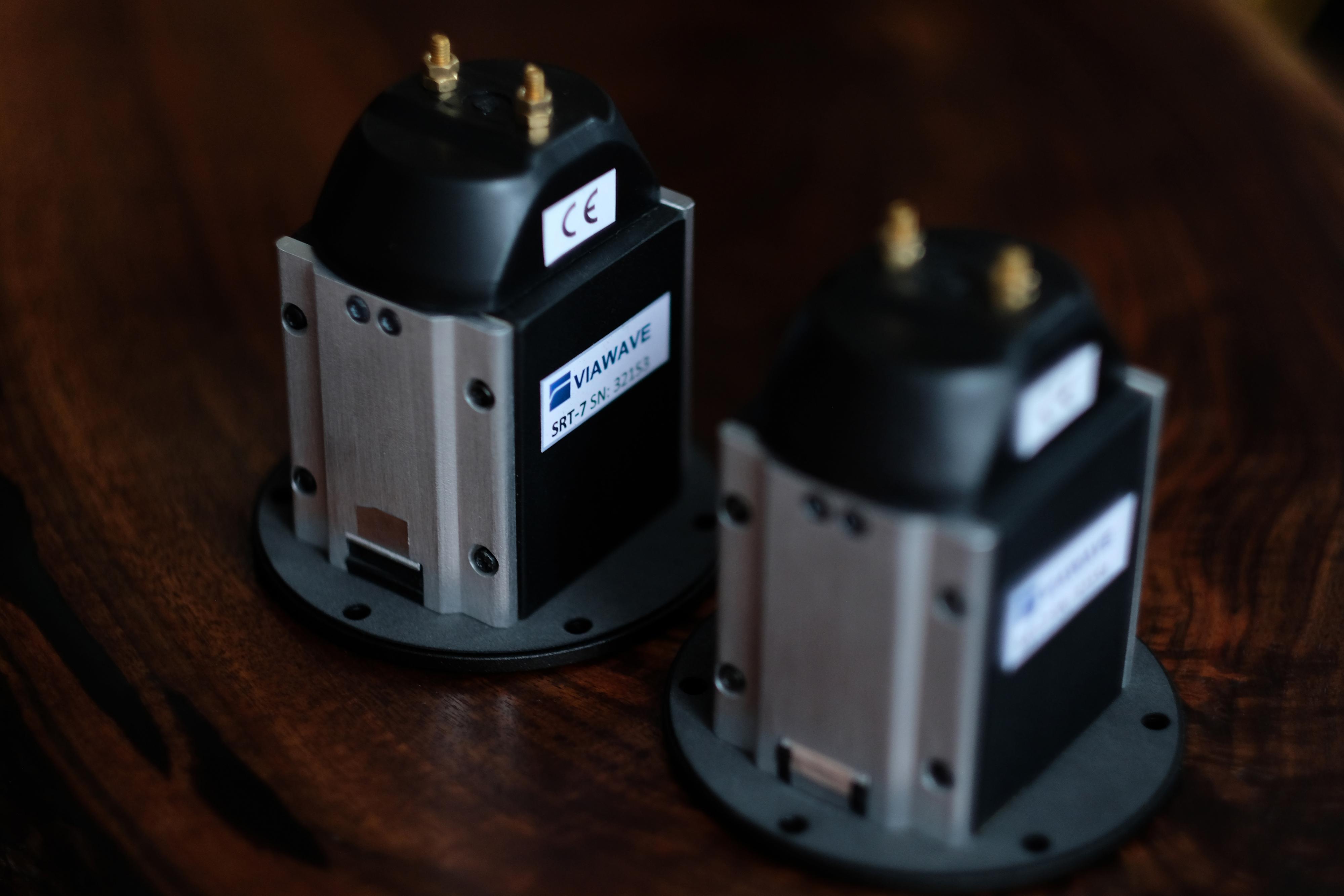

I'd remove the SRT-7's face plate and integrate it into the baffle (..though "suspended"/de-coupled so that baffle vibration doesn't affect it).
IF you do that - then you can get those midranges closer together and reduce vertical combing effects.
I kind of heard that you shouldn't take it off yourself.

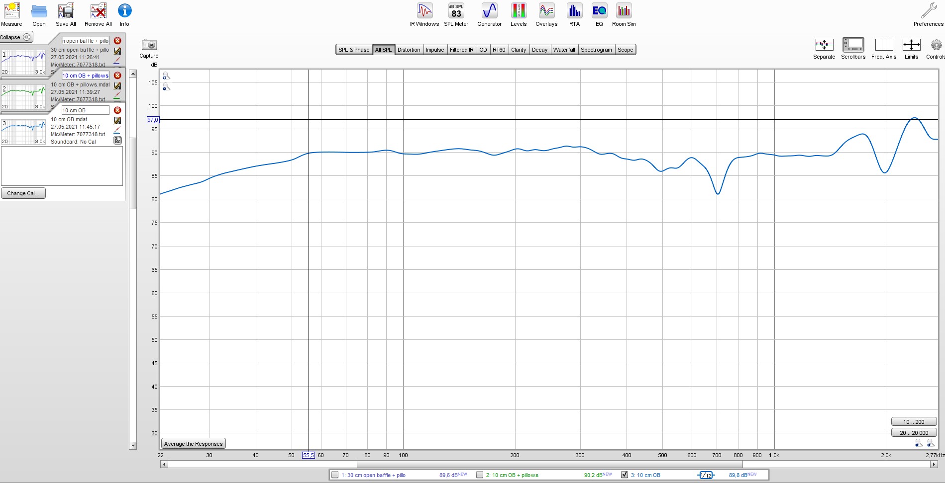

Could you present the future measurements on a 50 dB scale?
I don't quite understand what this means?

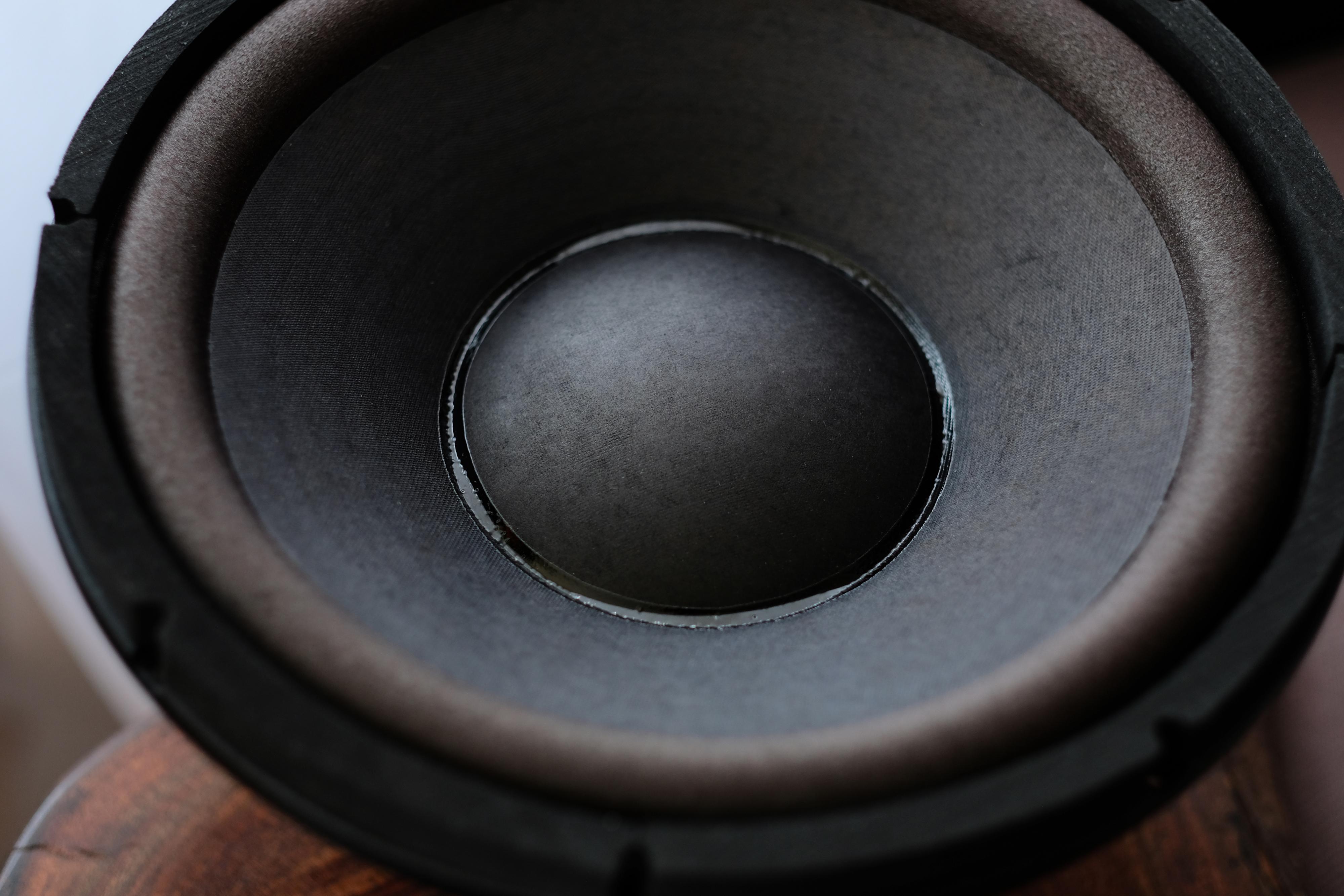

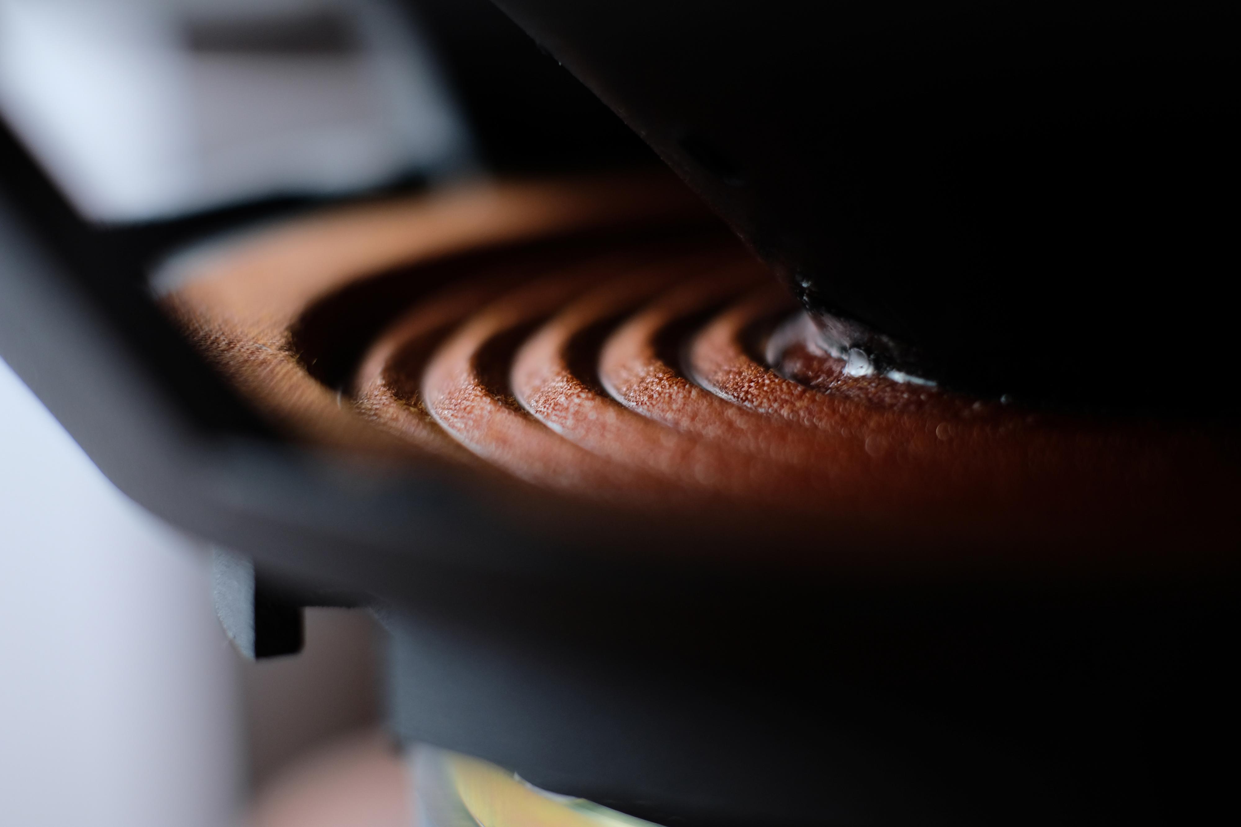

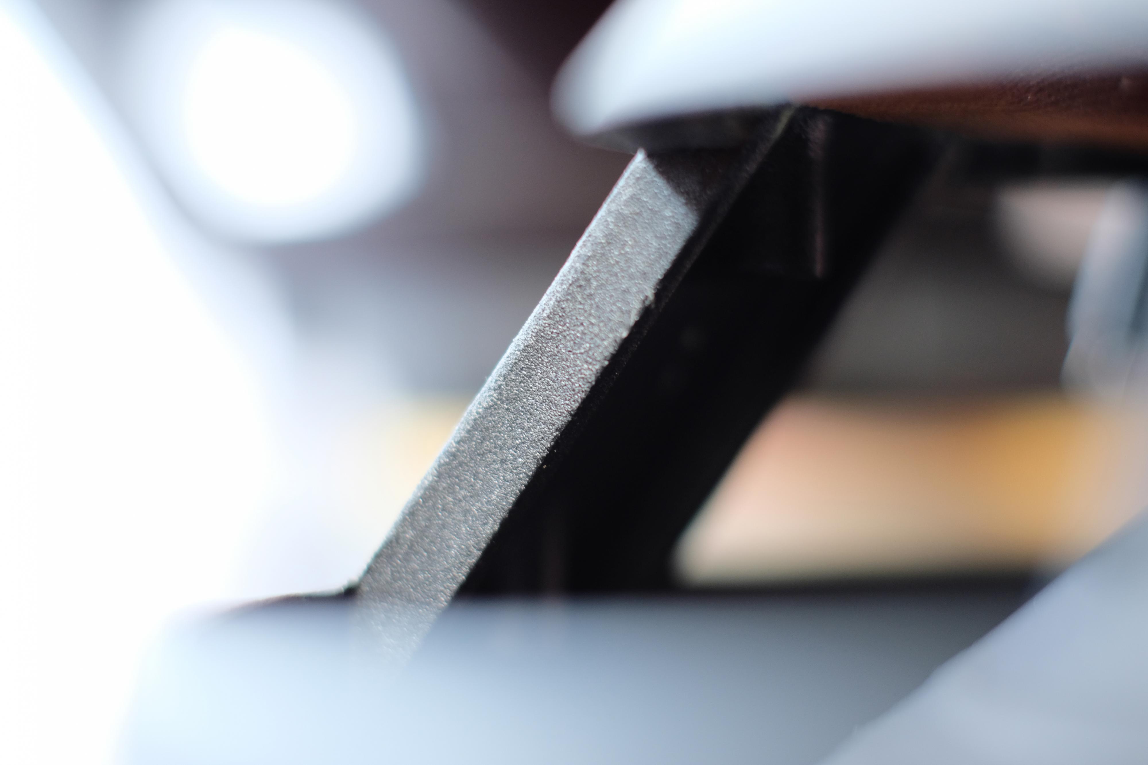

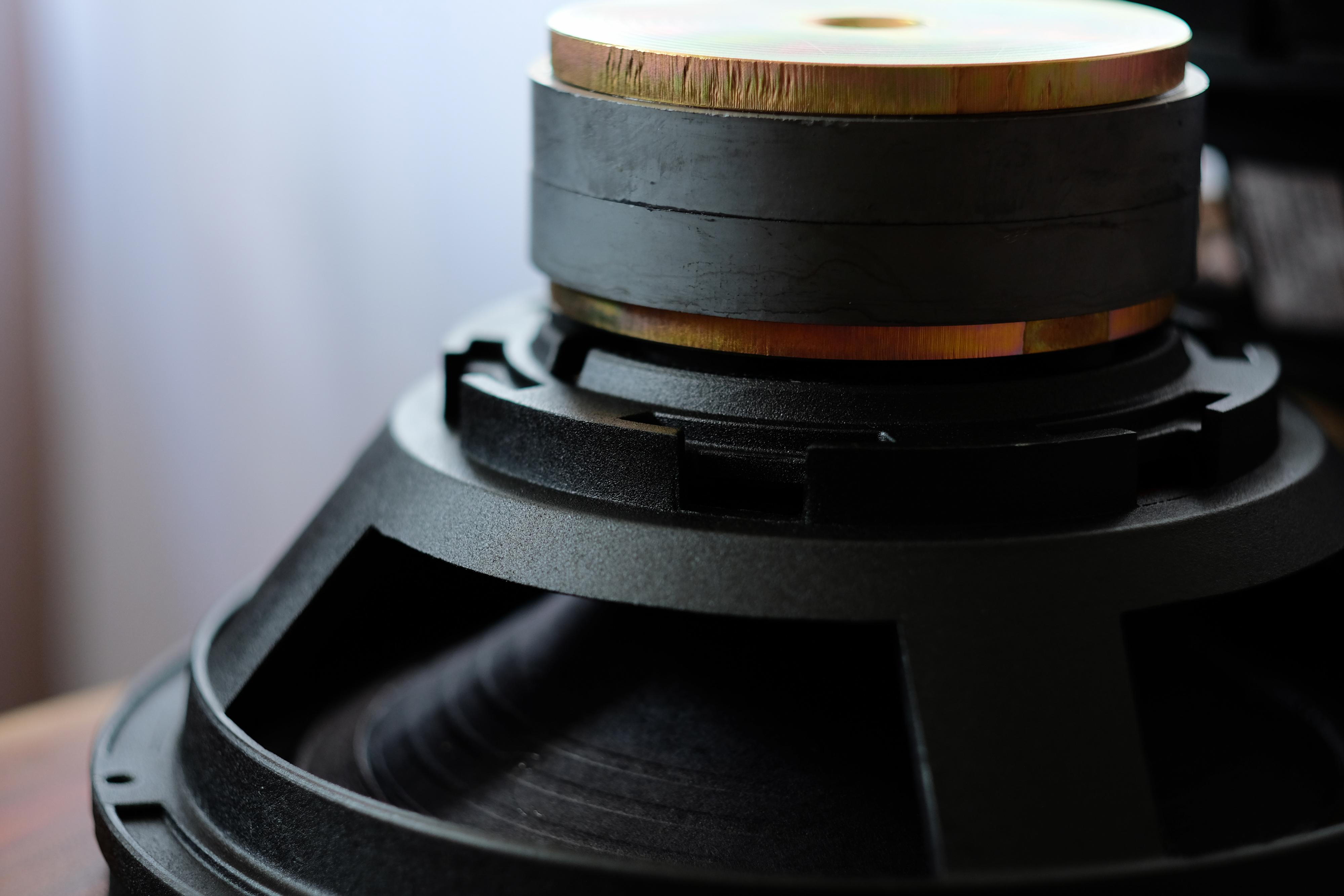

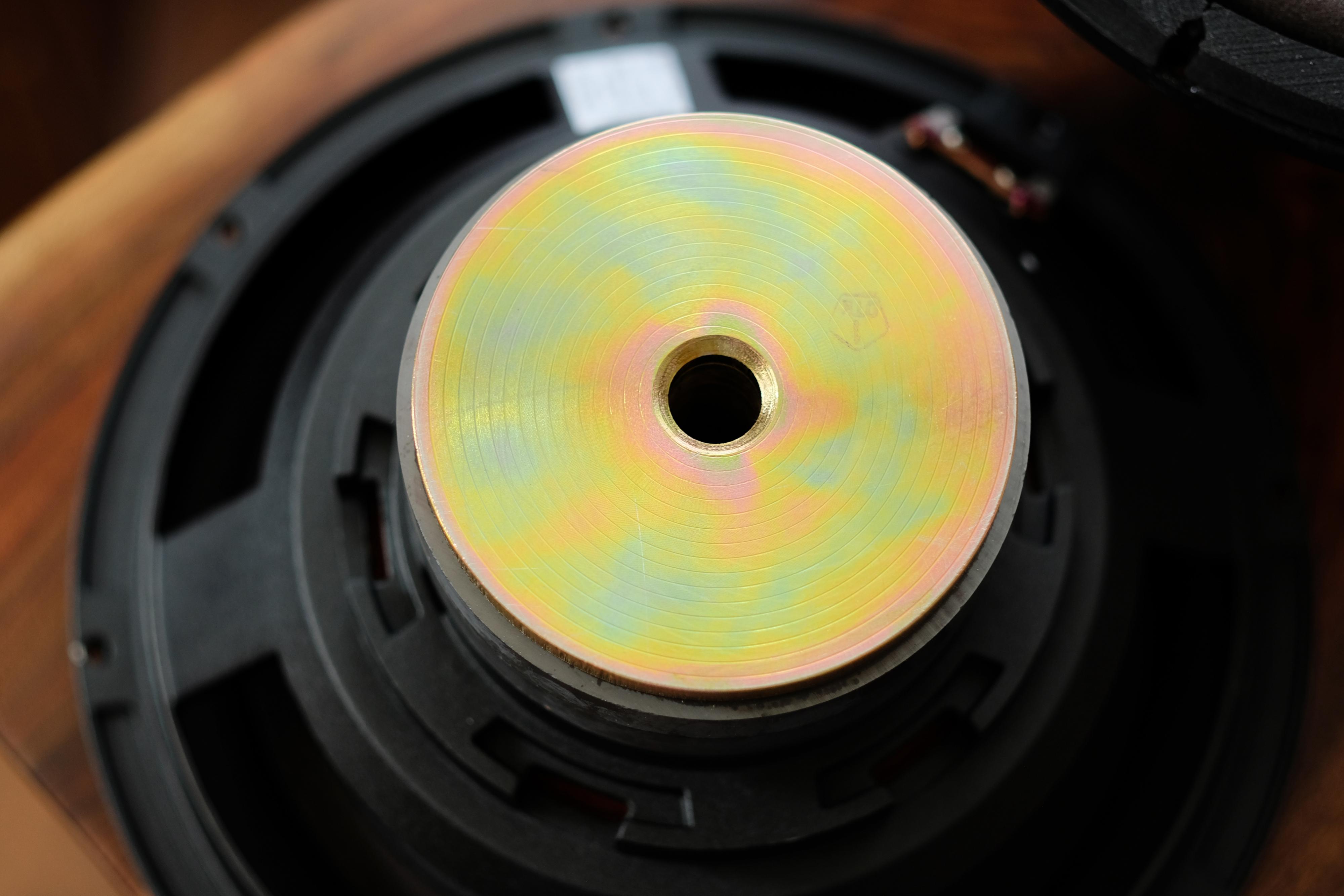

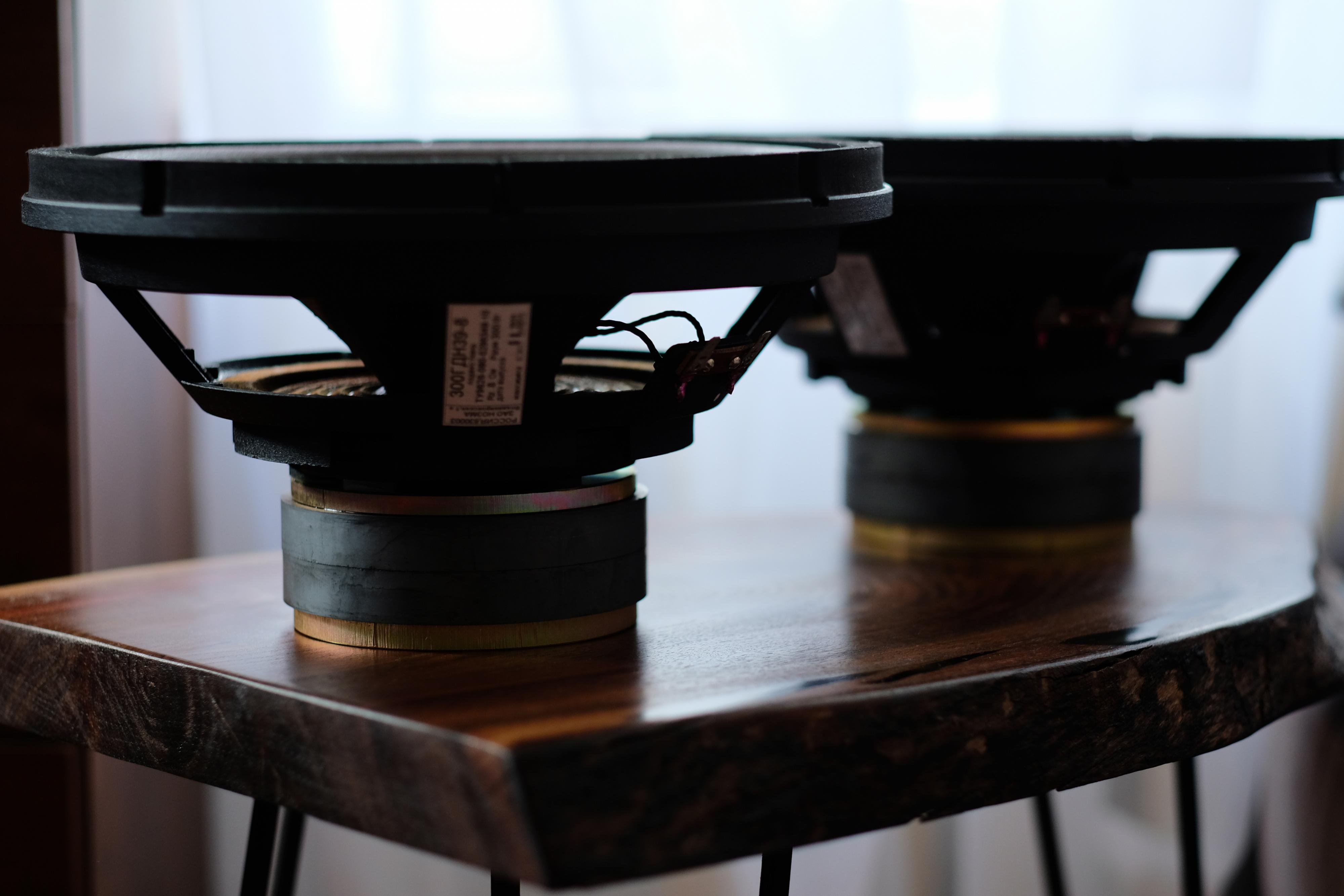

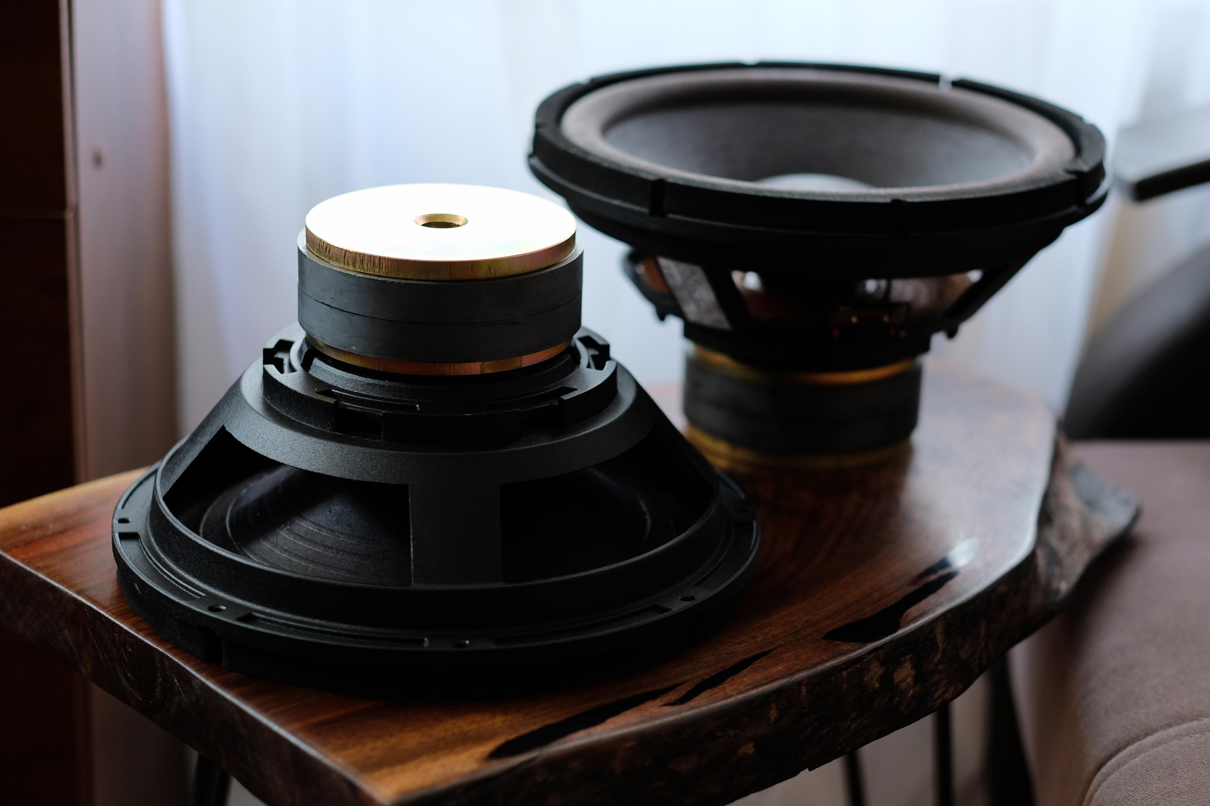

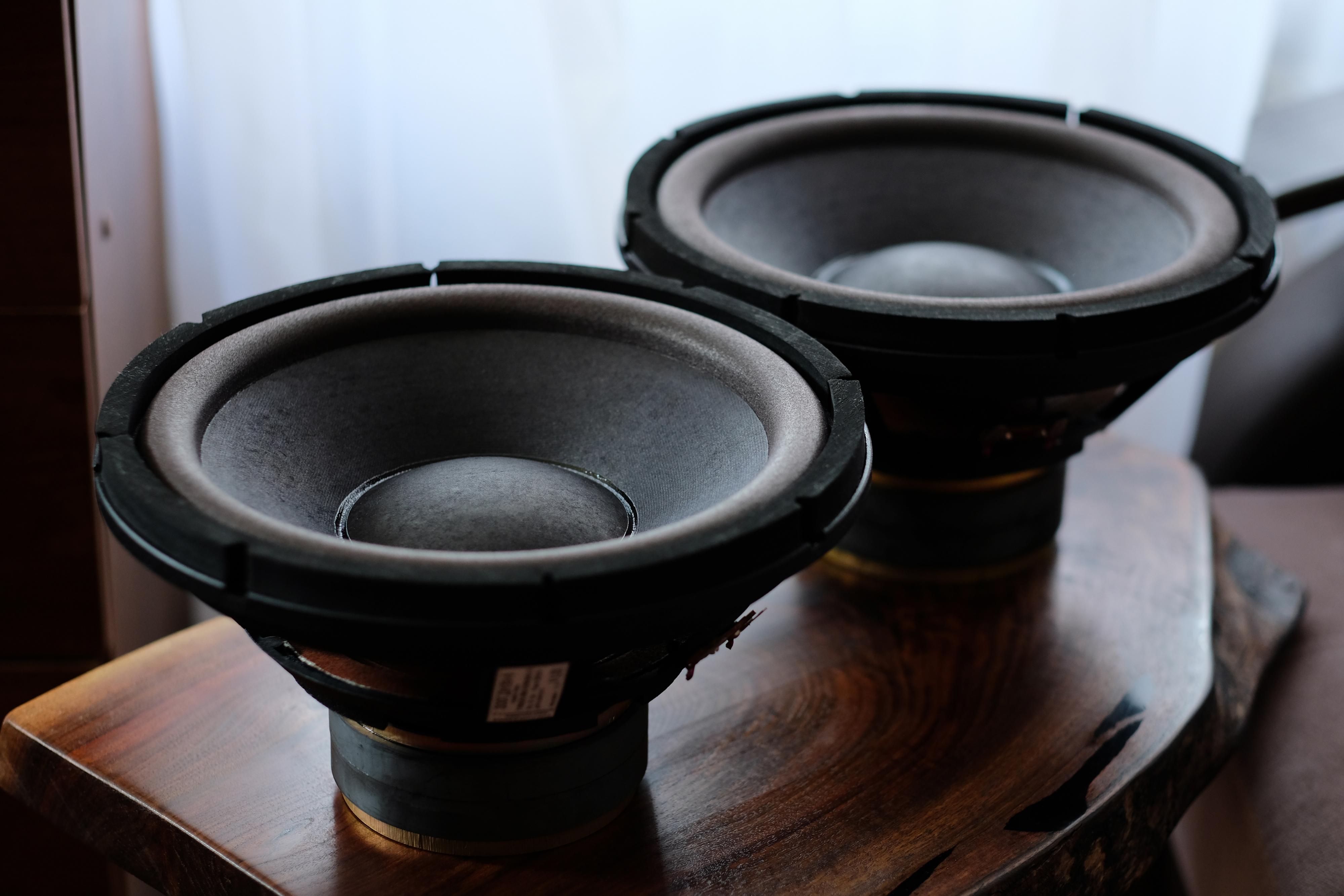

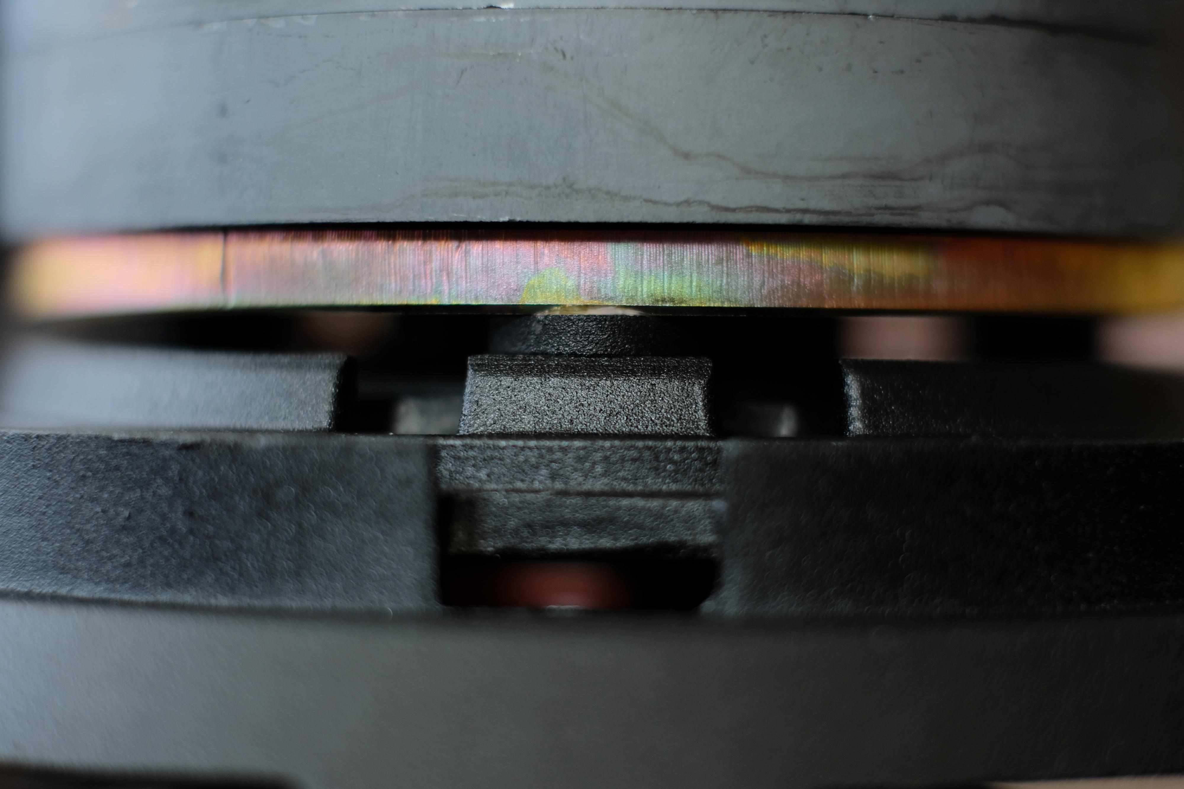

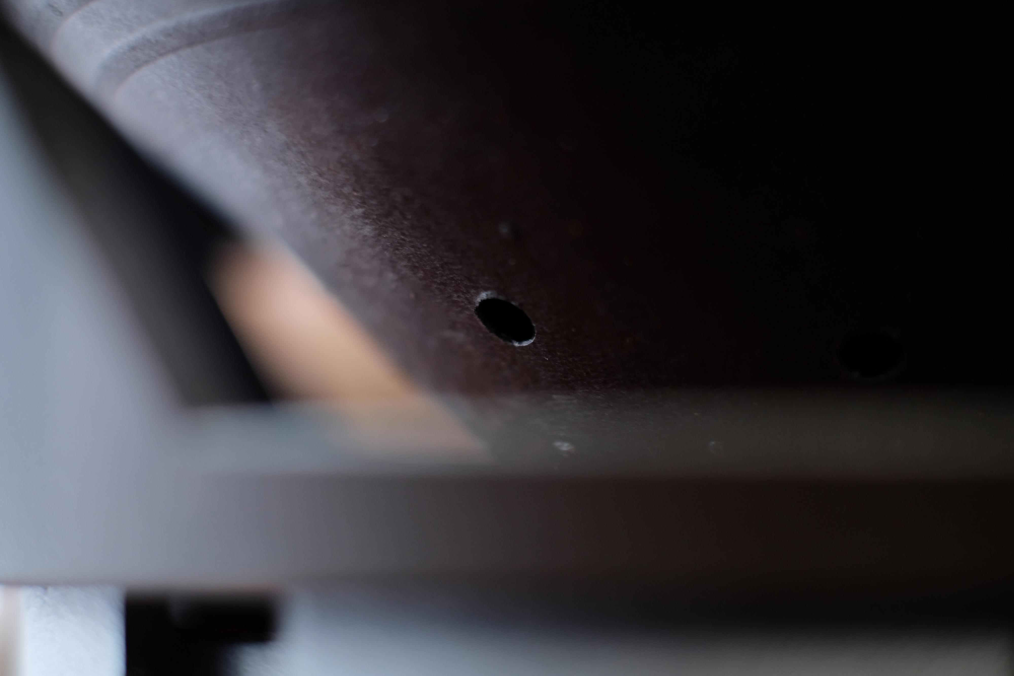

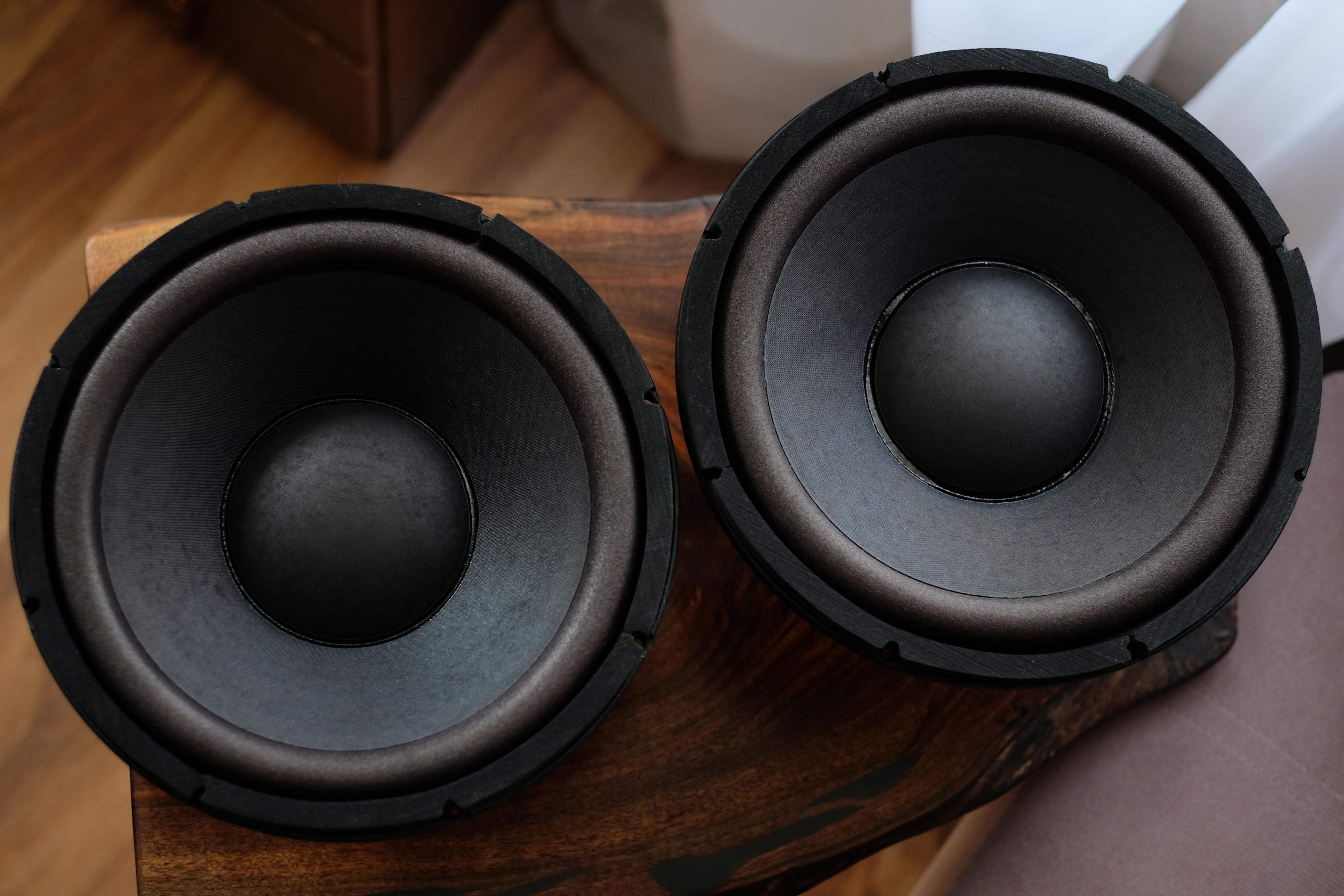

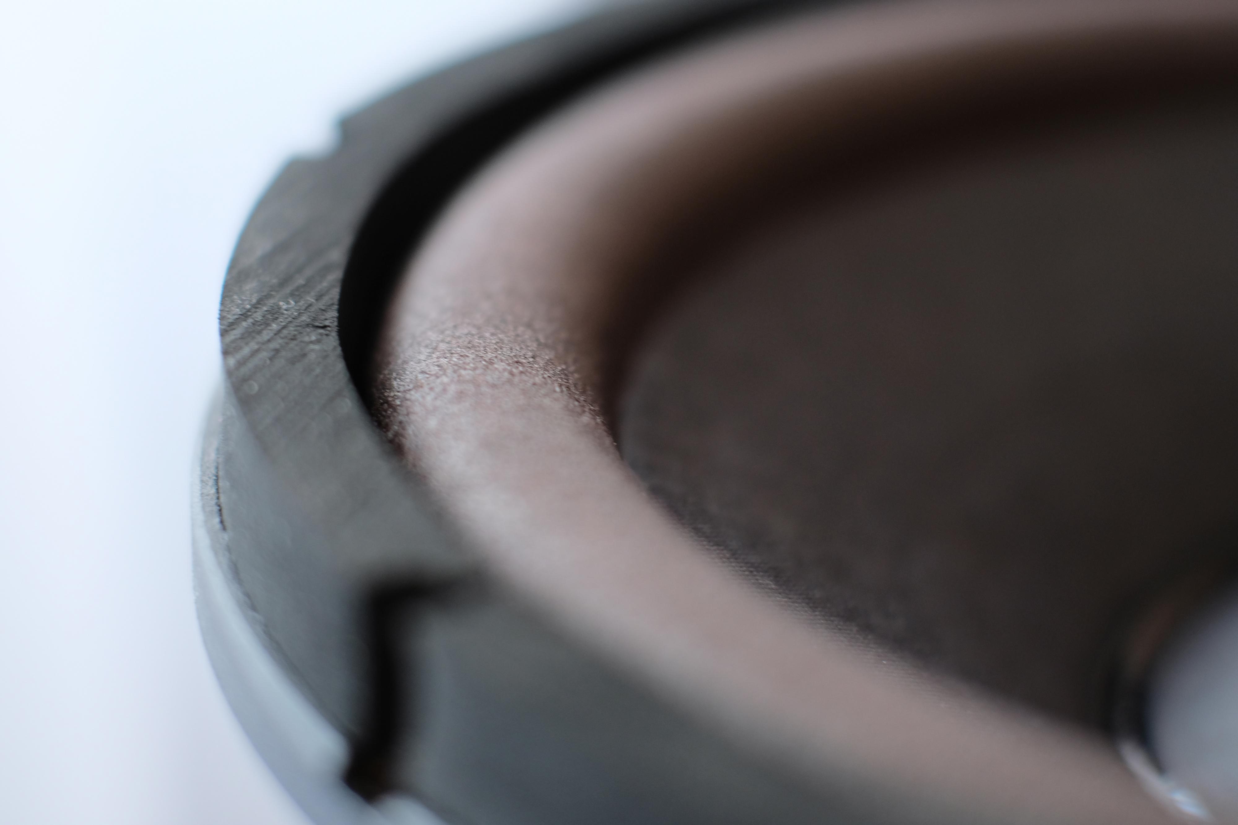

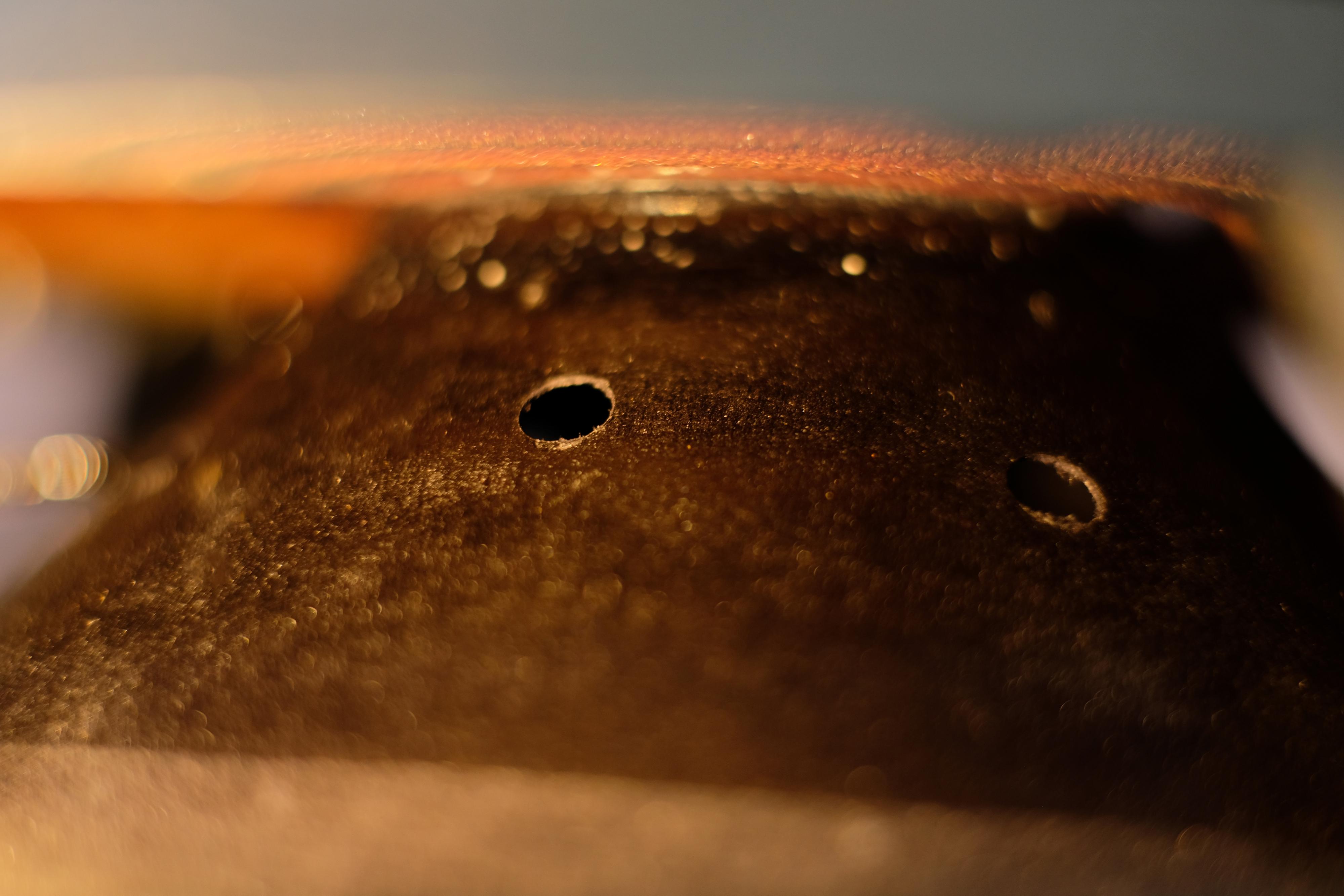

I got the driver. I like that there are so many vents.
For $ 100 / piece 12" I have no complaints about the quality.
But I really do not like polyurethane foam or rubber pads on the front flange, which are glued directly to the surround and tear off along with it 🙁 They can be peeled off, but you will need to order a wooden patch and paint it or glue it with veneer.

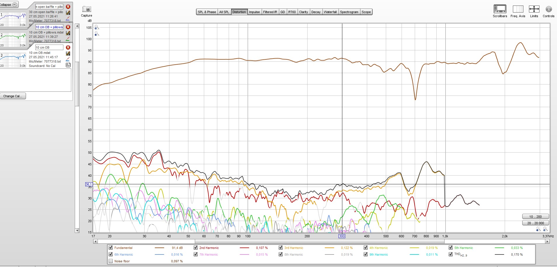

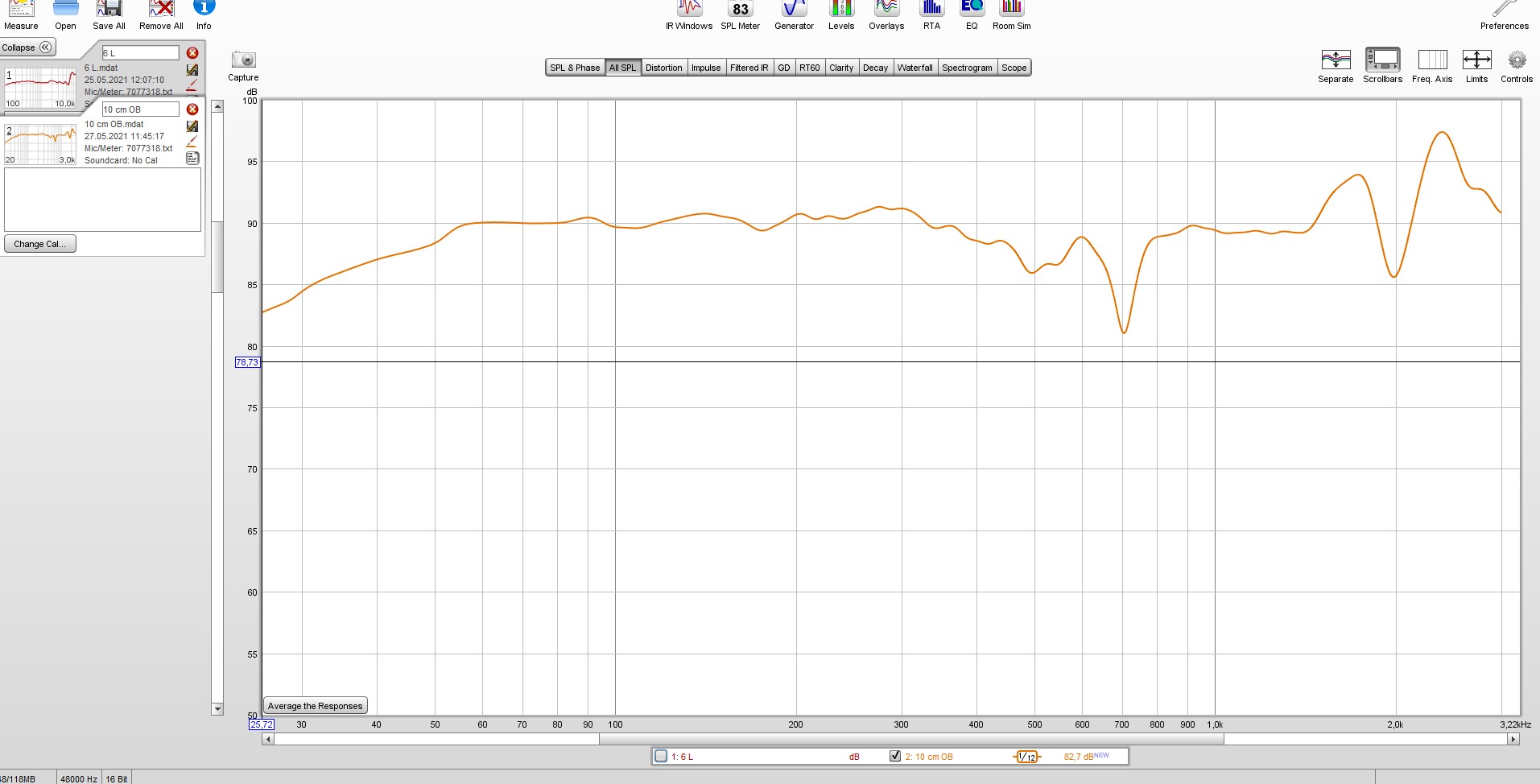

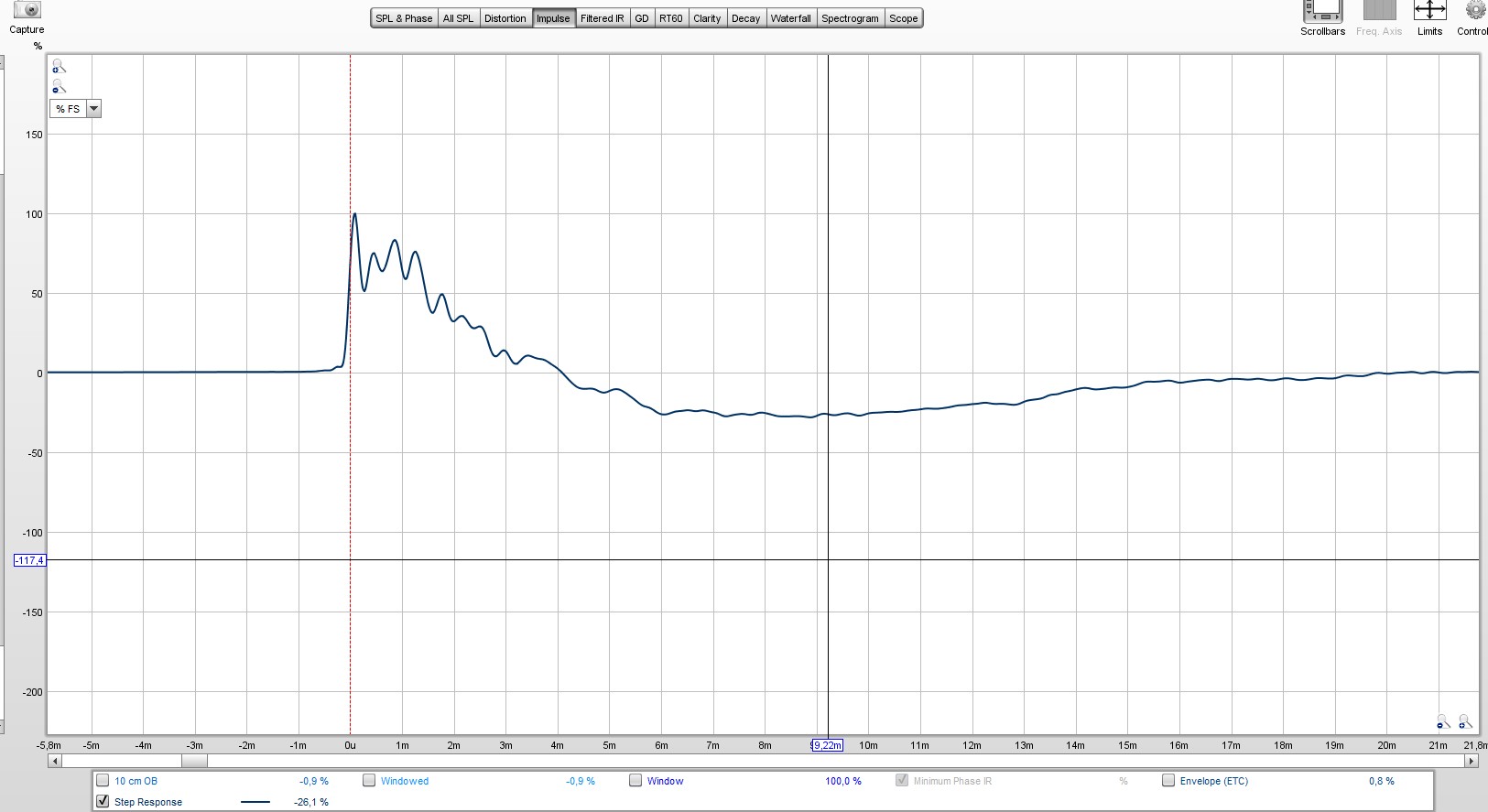

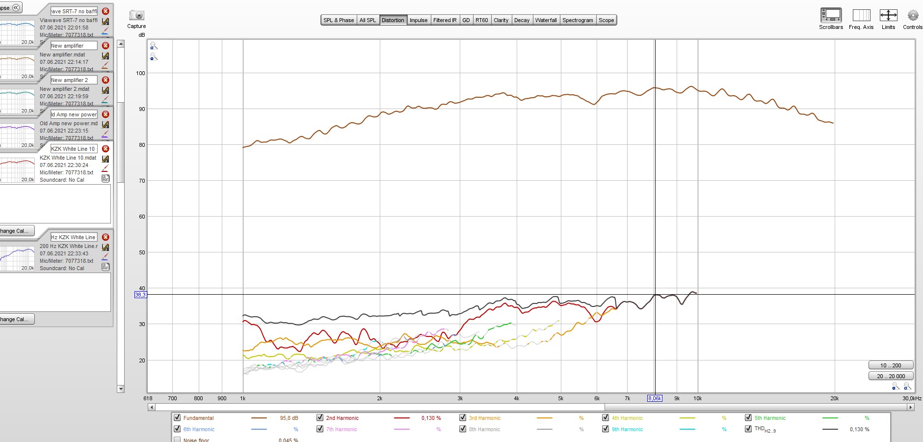

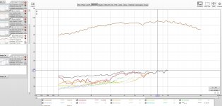

Measured from 10 cm in an open baffle 70 x 51 cm (27.5"x20")
REW files: Noema 300GDN39-8 - Google Drive
It is an unwritten convention, an unofficial standard if you like, to present the FR measurements on a 50 dB range scale. Yours are on 100 dB+.
Set for instance, the top SPL level in REW to 100 dB, and the bottom to 50 dB. Use the "Limits" tool.

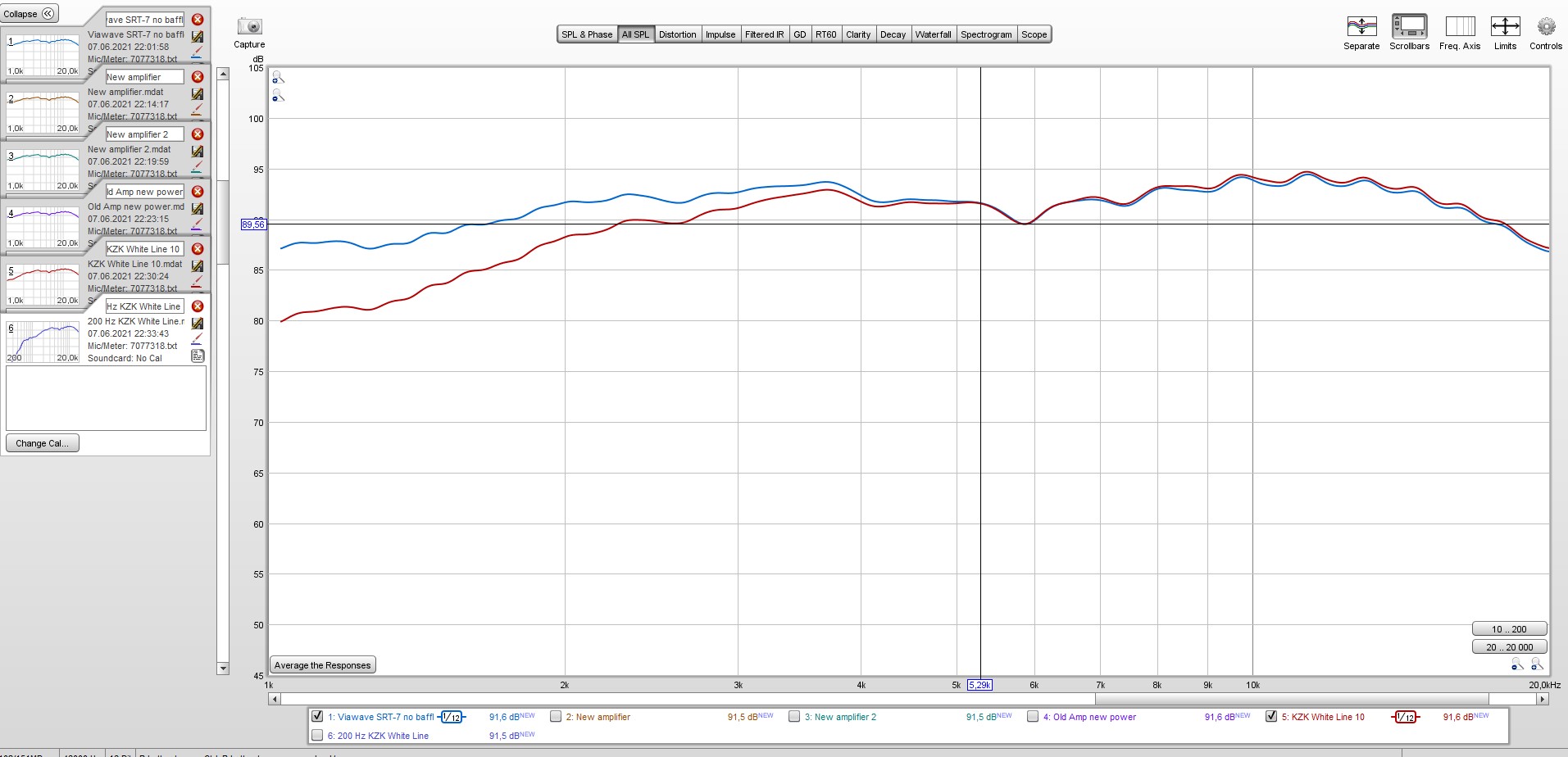

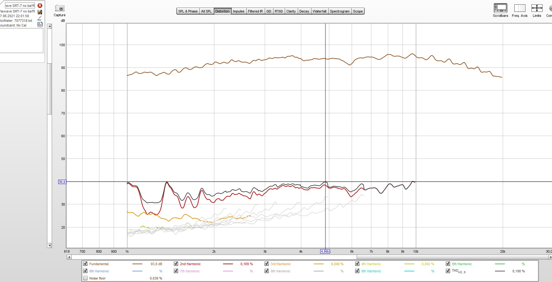

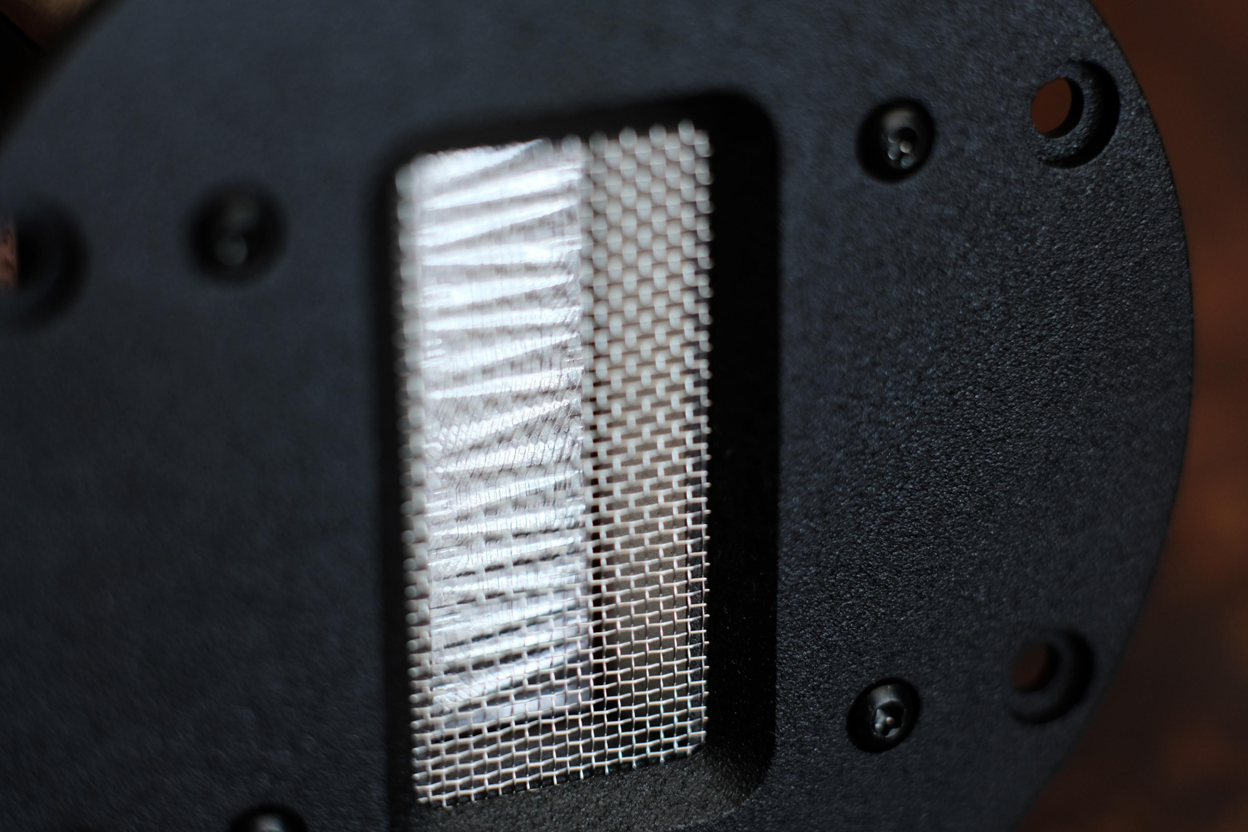

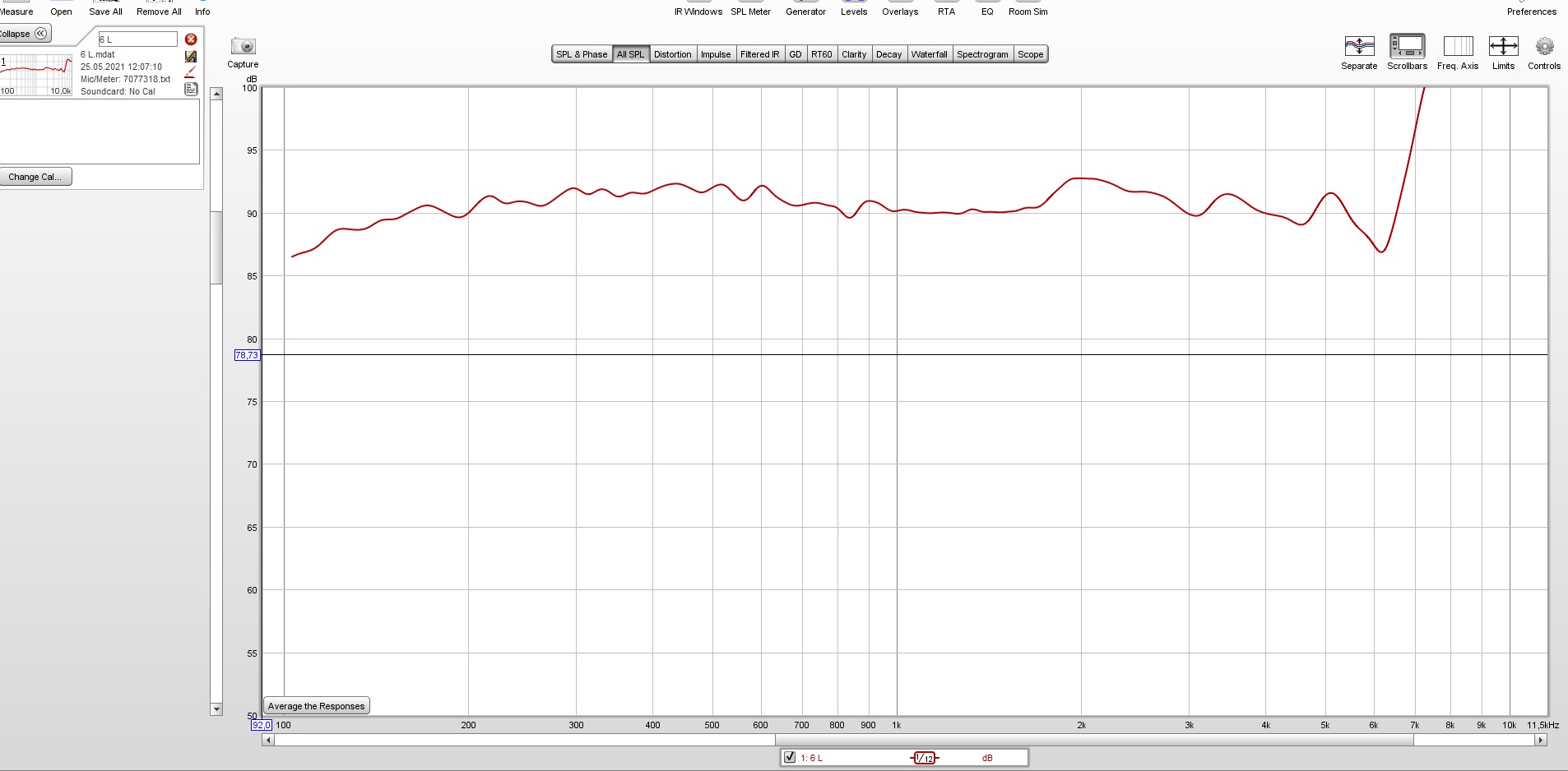

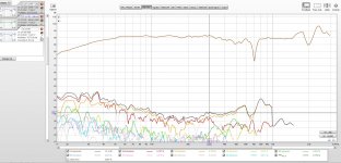

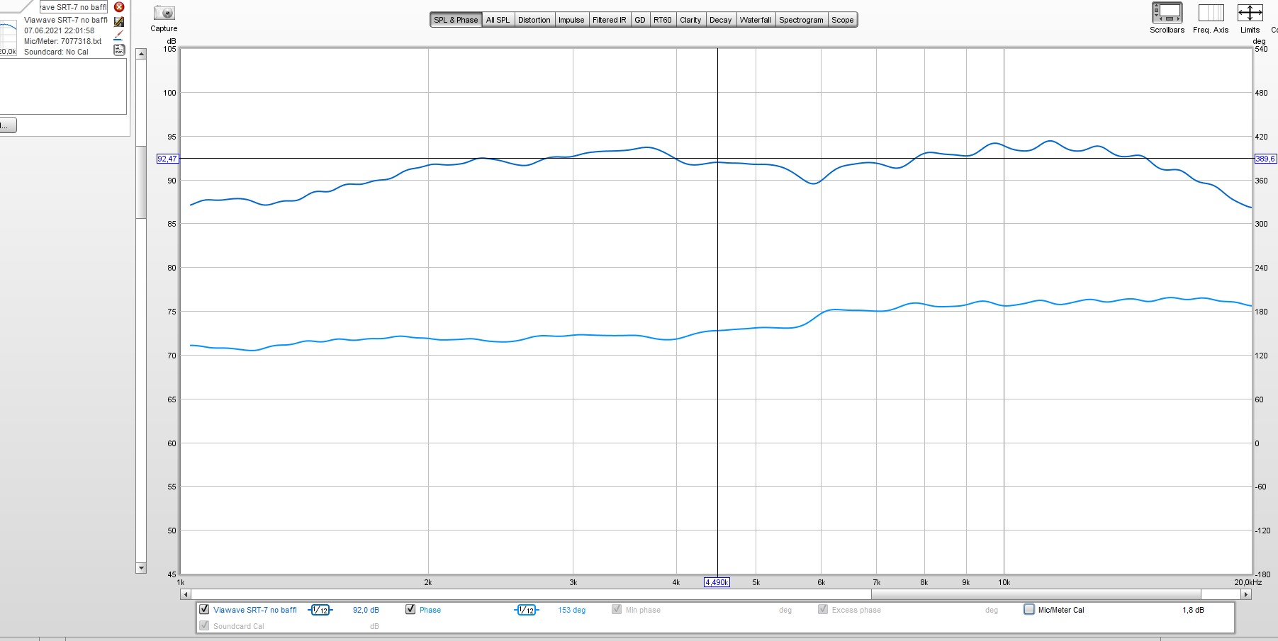

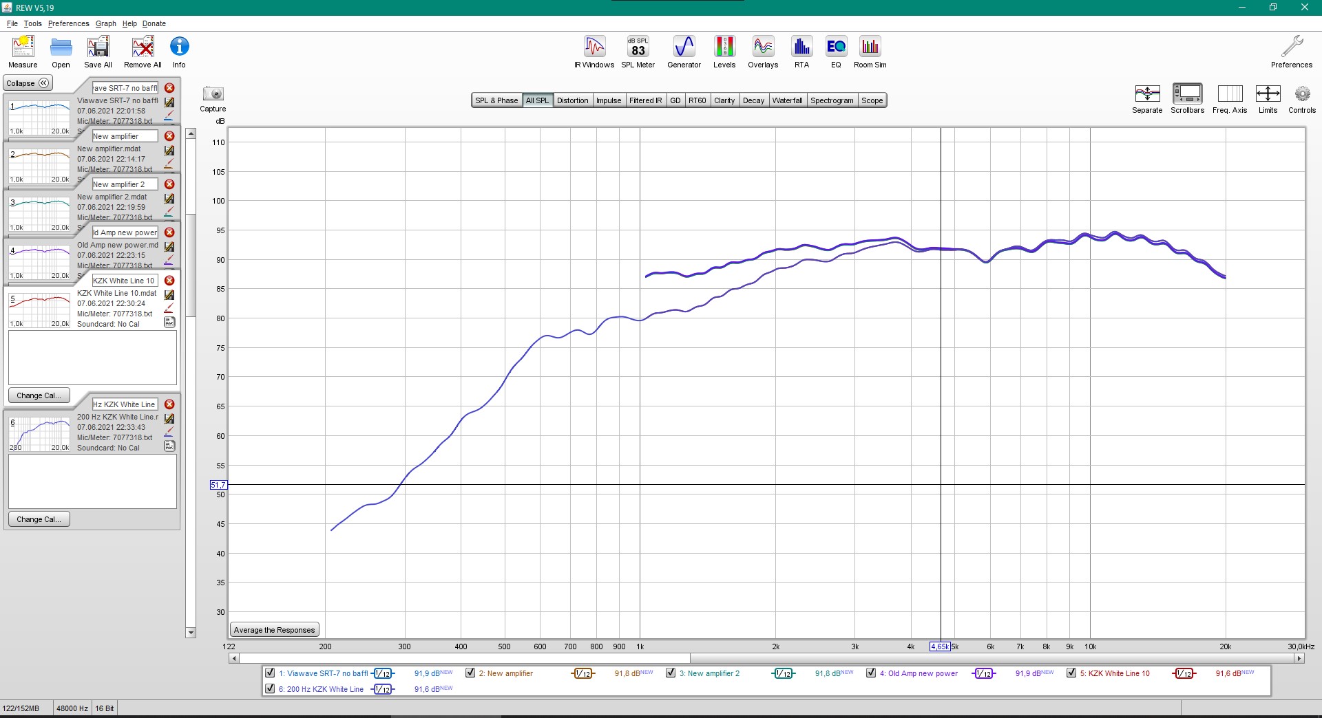

Measurements with 10 cm (4 ") no baffle:

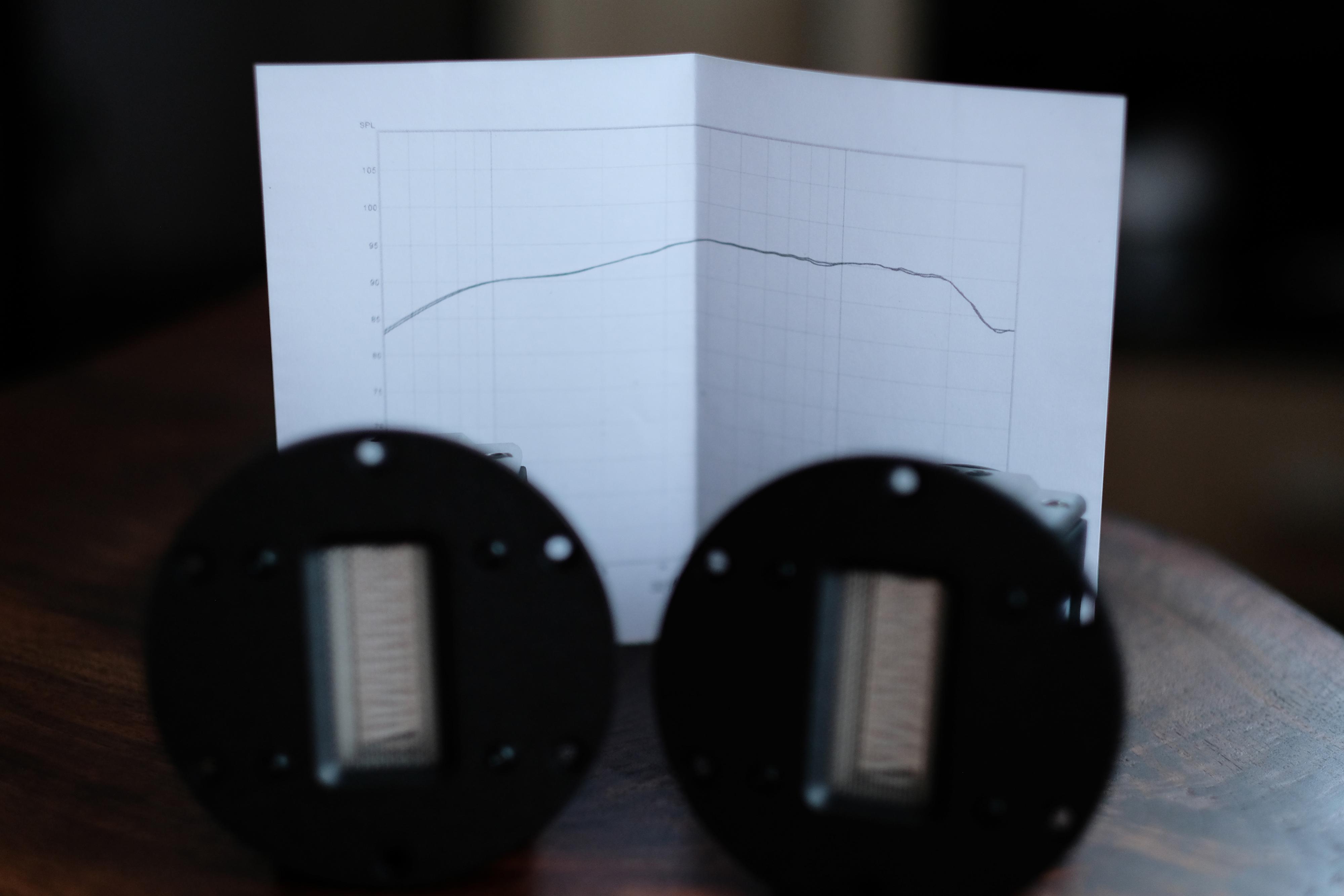

Viawave SRT-7 - Google Drive
I do not have such a flat frequency response as the manufacturer, the unevenness of 4 dB in the range of interest to me. I hope that the frequency response in the cabinet will be smoother.

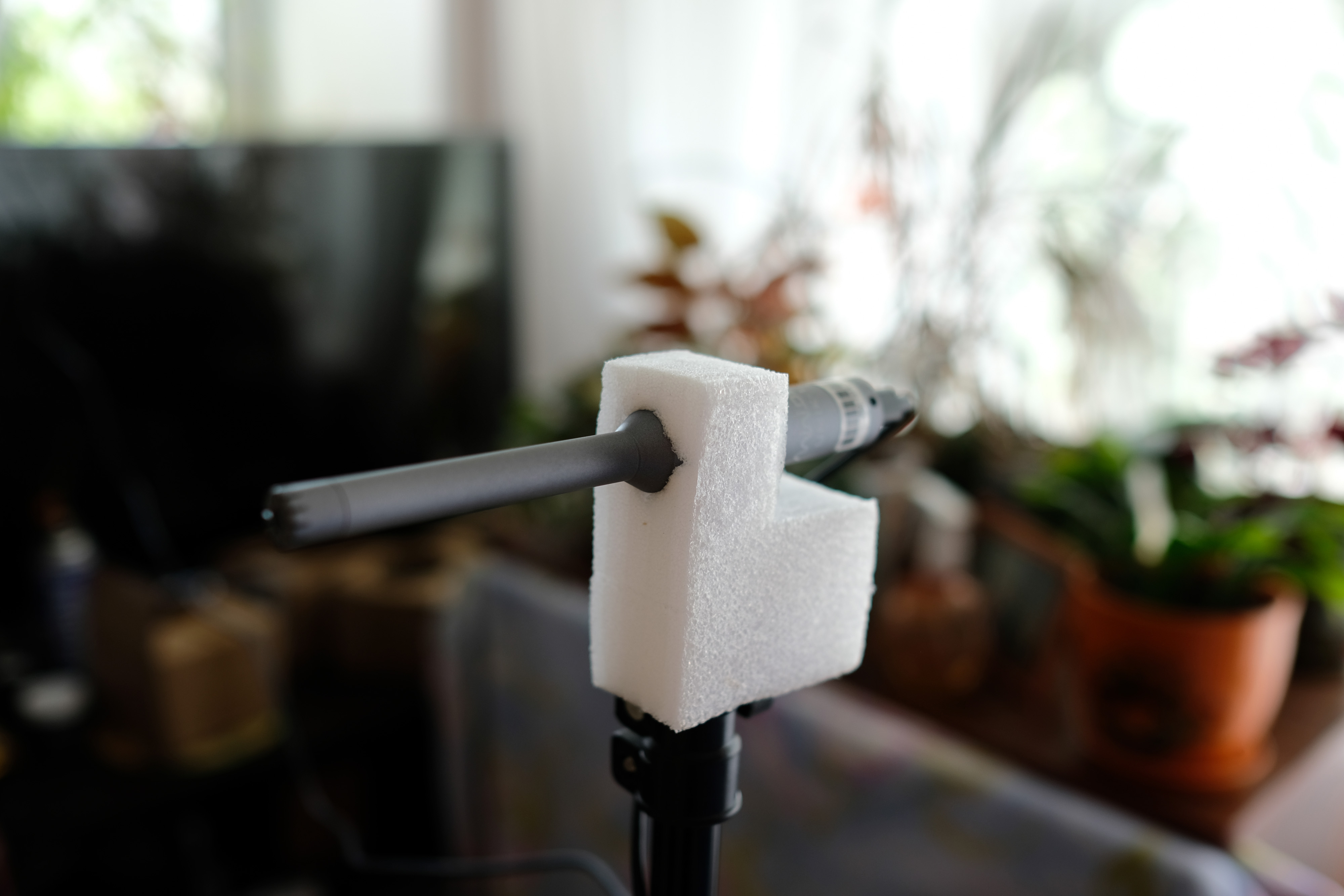

You can just buy a cheap microphone stand.I was told that the differences in frequency response at 6 kHz due to my way of attaching the microphone, i need to mount it on a stick so that there are no reflections
The measurements will need to be redone.
