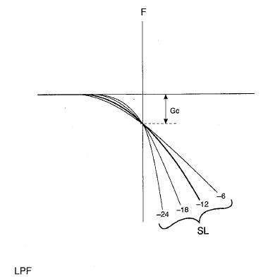

When you have a 1st order crossover, there is more overlap, thus when each band adds the overlap part, you get more energy. When you increase the order of the filter, there is less overlap. So even if the gain of each band is the same, the total energy over the spectrum is reduced.
There are also other things about the driver that needs to be understood to technically make the right active crossover design. These are normally discovered when you are actually able to conduct some acoustic measurements instead of rely on ears.
That's ridiculous. I don't what what the answer is but that isn't it.

Soongsc's explanation actually does make sense. Take a look at the energy spectrum for different slopes (pic below), you'll find that the total energy decreases as the slope increases.
