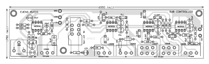

What i need is filter, ofcourse. I've ended up with these two:
P48 Sub-Woofer Controller (Rev-A)
Low pass filter - Subwoofer :: circuit diagrams
And i'm not sure, which one i should choose. Seems like 1st one has phase and gain controls, while the other has freq cut-off and gain controls. Which one would be better for sound quality(meaning nice low freq), or should i make both, and compare them 😕

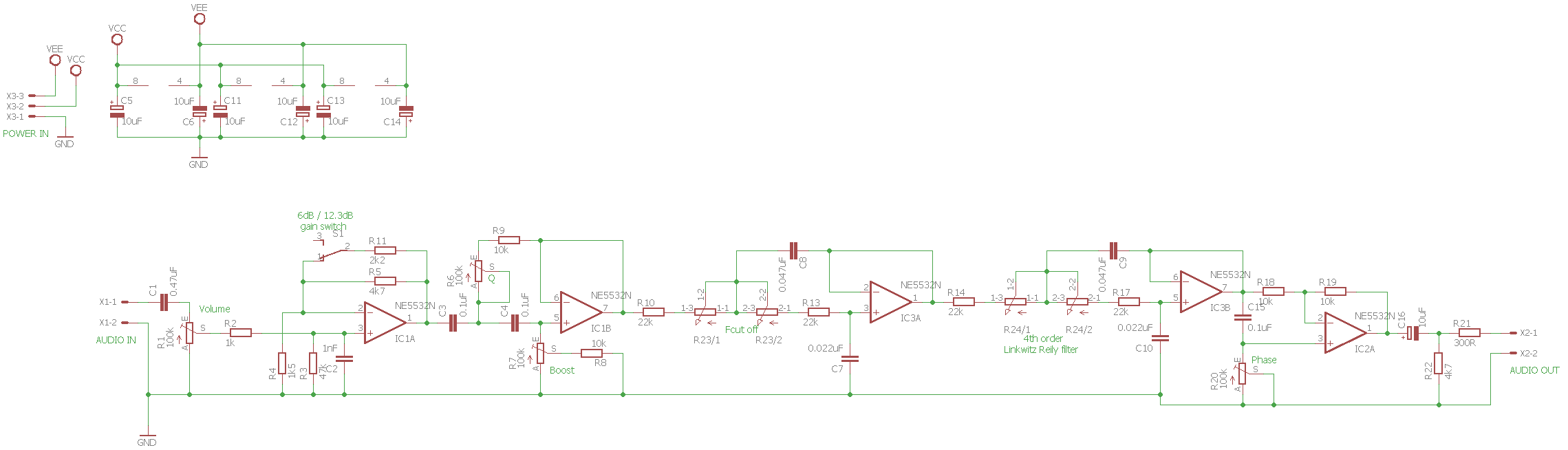

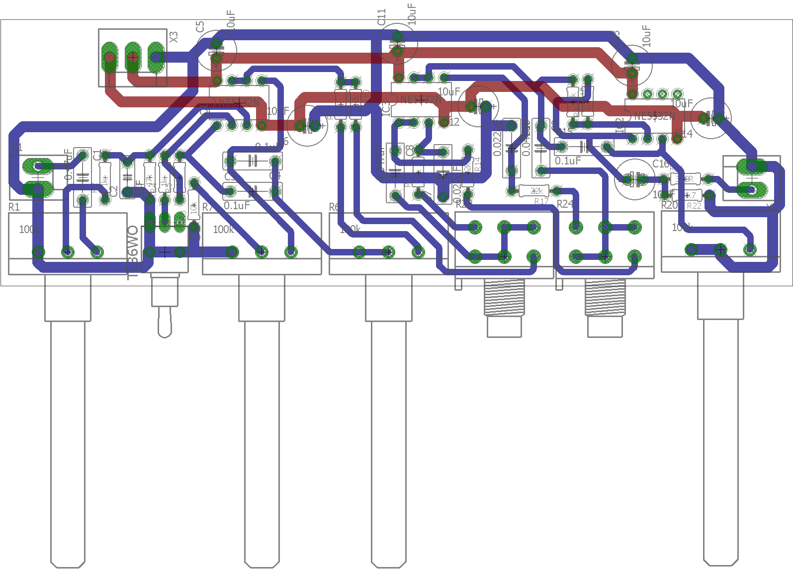

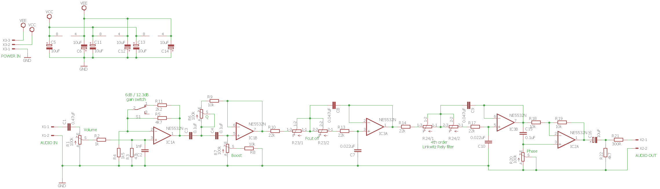

Alright, so i've redrawn it in eagle and made pcb.

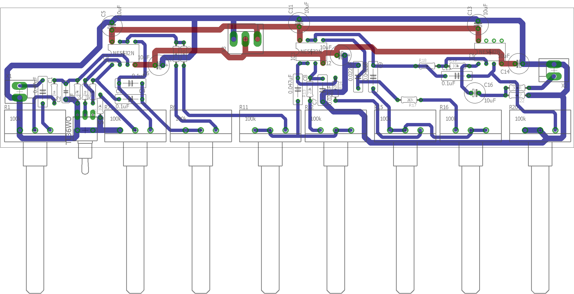

Yeah, seems like i should go with 4-chan pot, since now there is too many of them... And it takes space.
Anyway, any recomendations about pcb design? I might make this as 1-layer pcb, power lines would have 'jumpers' at some places.
When the gain switch is closed, the NFB loop is operating and you get a gain = 4k7/1k5 + 1 = 4.13times (+12.3dB)
When the switch is open the NFB loop is not operating and the opamp acts as a Follower/Buffer. Now the gain is +0dB
If you also add in a plugable 2k2 parallel to the 4k7, you get a gain of +6dB switchable back to +12.3dB, when the 2k2 is opened.

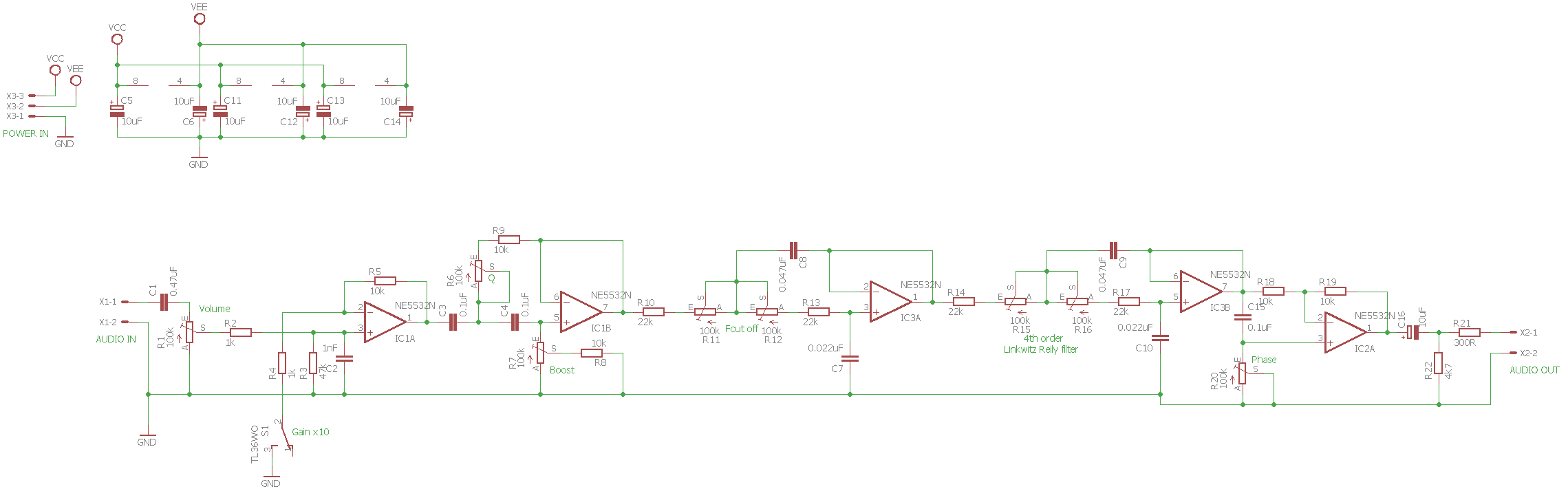

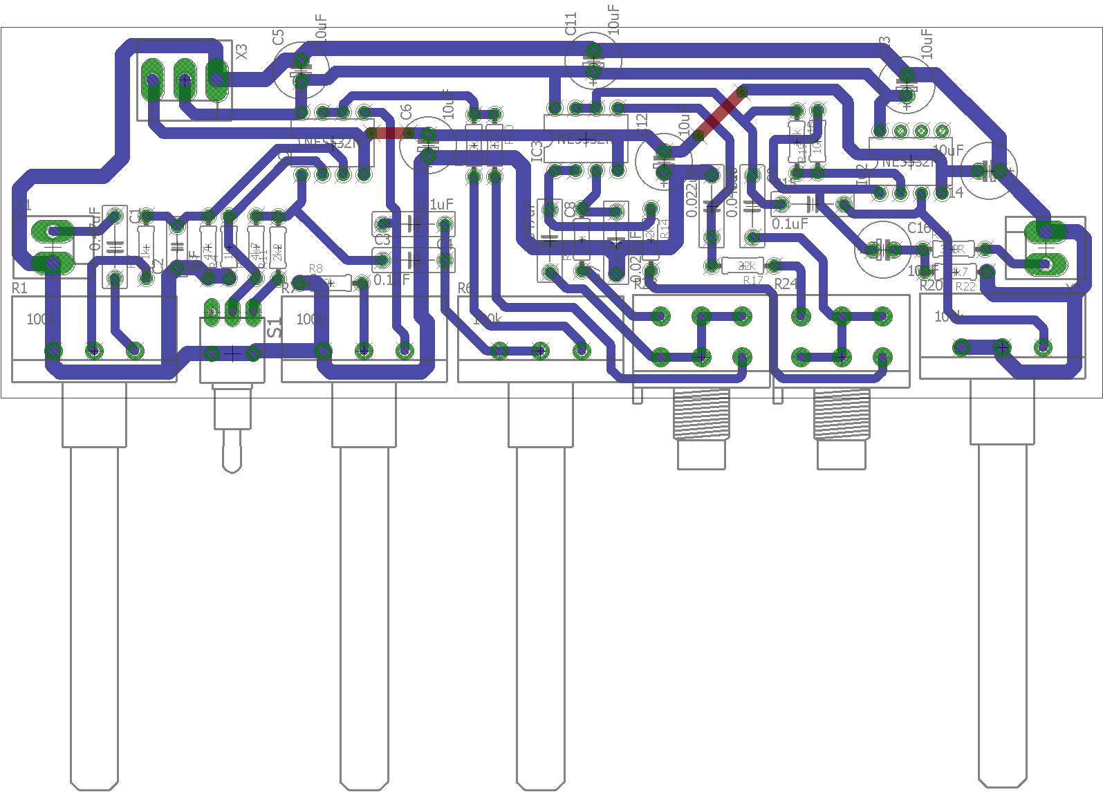

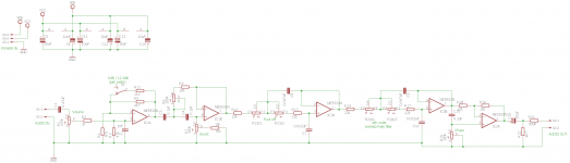

So you mean like this? Well thats better than 0dB / 12.3dB gain switch.
By the way, what's the purpose of Q (R6 in schematic) ?
R6 & R7 vary the roll off frequency of the high pass filter. This protects the bass driver from over excursion when you apply that +6dB or +12.3dB gain stage that you probably don't need when you already have +6dB from the bass summimg channel to input to your bass only speaker.
