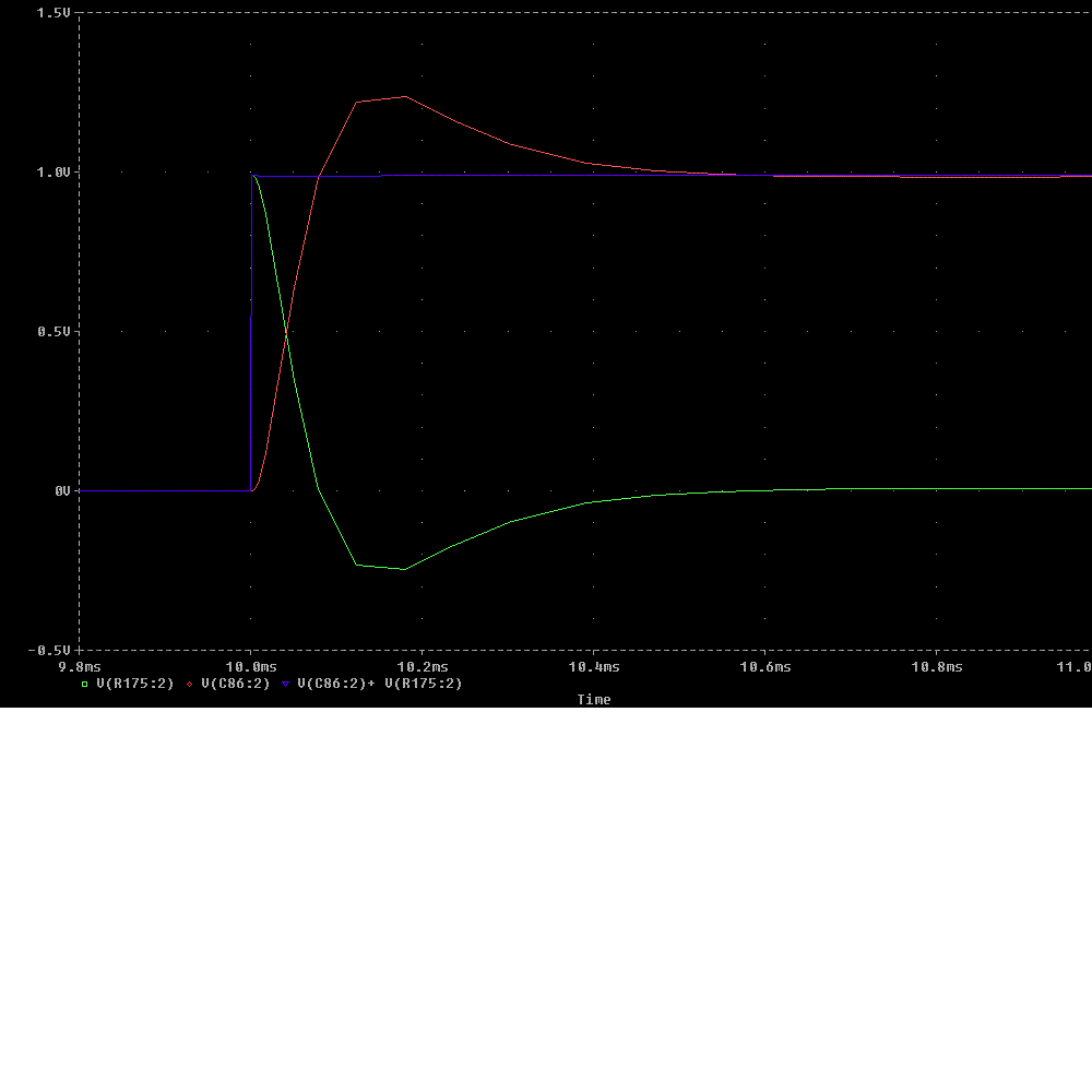

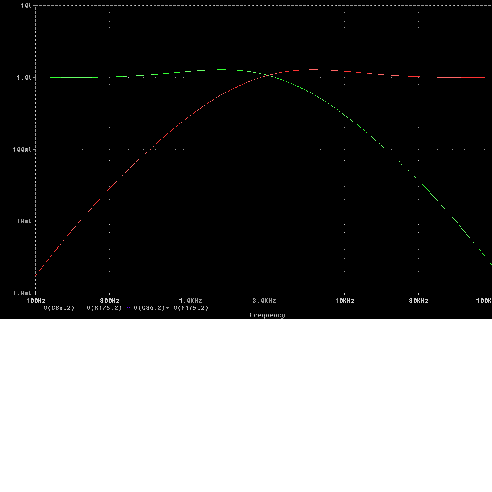

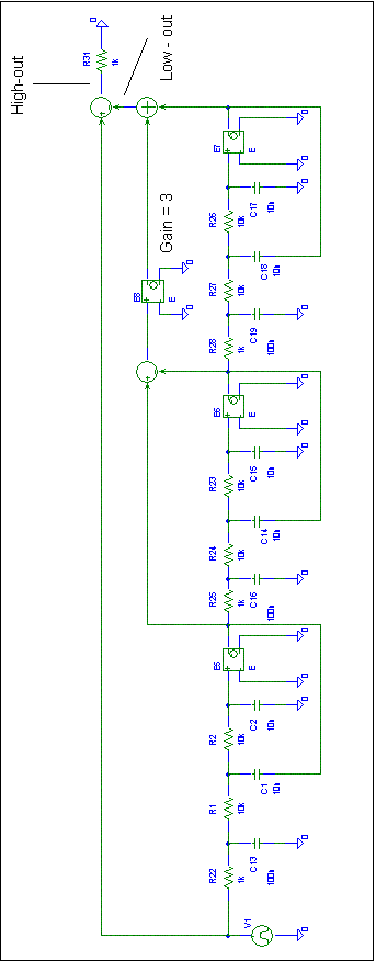

I once mentioned that it is possible to build symmetric 3-rd order subtractive crossovers. They come at a price though: Increased complexity, increased overlap and larger humps (though they can be made a little flatter by using a "flatter "3rd order filter type).
Below you will find the circuit. Simulation results will follow.
Regards
Charles

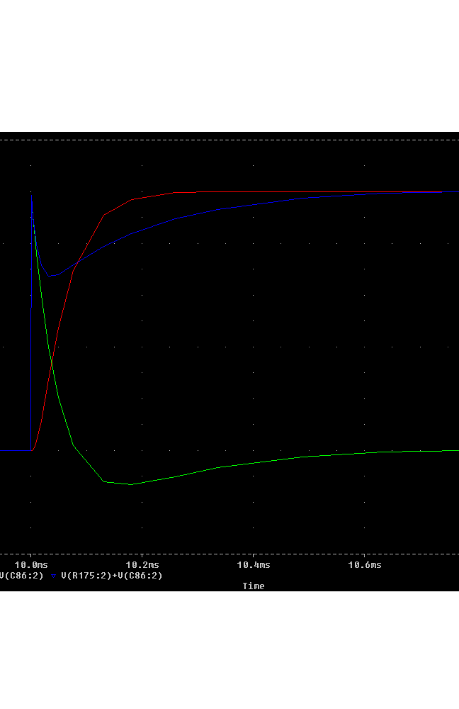

Although the following type of x-over isn’t actually subtractive I will post the info here because their main target is the same: Perfect signal summation in time- and frequency- domain.
A while ago I stumbled upon a patent that was taking NFB after the various branches of a passive crossover in order to improve temporal and frequency-response behaviour. The main trick hereby is to NOT OVERDO IT. That means filters shouldn’t be too steep or have too high an order, they shouldn’t have poles with too high a Q value and they should overlap significantly.
Or in other words: Summed phase- and amplitude- behaviour should be fairly decent from the beginning, otherwise the following could happen:
http://www.diyaudio.com/forums/showthread.php?postid=347173#post347173
One patent that uses it is the following, it is obsolete BTW due to non-payment of the annual fees:
http://v3.espacenet.com/origdoc?DB=...212696&DOC=ce973ee58c45feb66f2ceca97118bf8f36
Another one is from ABAKUS rieder (http://www.abacus-electronics.de/) and is basically the same thing:
http://v3.espacenet.com/origdoc?DB=EPODOC&IDX=DE4418360&F=0&QPN=DE4418360
I then thought why not apply this to active filters in order to achieve phase- and amplitude- linearity of the summed signal ? I did some simulations with this topology and the results look useable. These filters still have the humps that we know from the subtractive filters. They show first-order behaviour in the crossover area but approach the steepness that we expect from their order as we move further from the crossover point. One can’t build filters that are as steep in their crossover area as 8th-order LR or whatever by using this topology. If one wants really steep AND phase-accurate crossovers then he must definitely resort to digital FIR filters.
But the x-over-type in question would still allow some room for individual driver EQ-ing (which isn’t easily achieved with the nth/1st order asymmetric subtractive crossovers because most of the necessary EQ-functions are of 2nd order at least). The general requirements regarding out-of-band -behaviour and -capabilities for the drivers are still the same ones as for other topologies (that are trying to achieve transient improved behaviour) but they are a little relaxed compared to other solutions.
It would even be possible to EQ-out driver errors with such a topology, by using filters that emulate driver behaviour in the NFB branches. But as always: DON’T OVERDO IT !!!
I think this is enough to make some of you curious. I will post a simulation example of a third-order crossover later on.
Regards
Charles

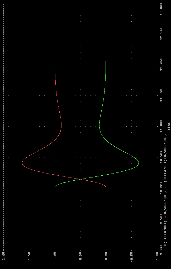

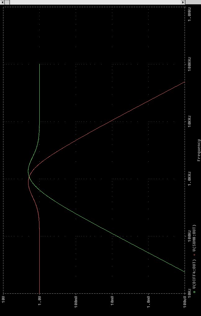

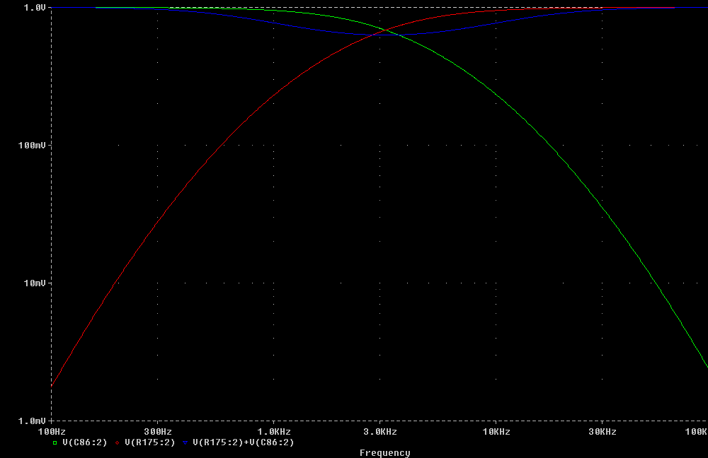

The filters I took for this simulation are both third order with a gradual rolloff. Feedback is done with a summing inverter with an open-loop gain of 100. In real-life one has to be aware of OP-AMP phase-shift of course when doing such things.
This is the FR of the bare filters:
And last but not least the step response. One can see the almost perfect summed response. Comparing this filter to the third-order symmetric subtractive one that I posted before one can see that the heighth of the humps has decreased significantly at the cost of a less steep drop around the crossover frequency. With any type of transient-perfect crossover one has to trade the height of the humps against the steepness of the filters.
Regards
Charles
