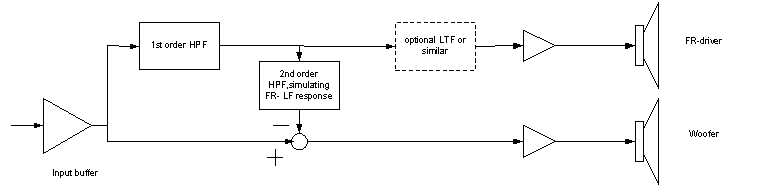

Something for the FR guys
There are always discussions about taking the driver's response into account when designing crossovers.
This can be done with subtractive crossovers as well of course but one has to rely on drivers that are suitable for 6dB filters.
One possible proposal you can see below. The task was to extend a FR driver's response at it's lower end.
The FR driver is high-passed with a first order filter. If it is mounted in a closed box this will amount to a total transfer function of third order (in an open baffle this might be exchanged, i.e. 1st order for the driver and 2nd for the crossover filter).
Another highpass following the actual FR crossover emulates the acoustical behaviour of the driver.
This signal is now subtracted from the input signal, leaving a 1st order lowpassed signal which can be fed to the woofer.
There is no doubt that the woofer has to be usable up to frequencies significantly higher than the crossover frequency (as already mentioned).
Another drawback is the polar response of the arrangement. This can be dealt with by the use of crossover frequencies placed at large wavelengths (compared to the driver sizes, which is quite often the case when FR drivers are used) or d'Appolito configurations (or both !).
It is still not an ideal crossover (which doesn't exist in practice anyway) but it is one possible solution for a transient optimised crossover that takes a driver's response into account.
Regards
Charles
P.S: I also did the maths for symmetrical subtractive crossover and will post it soon.

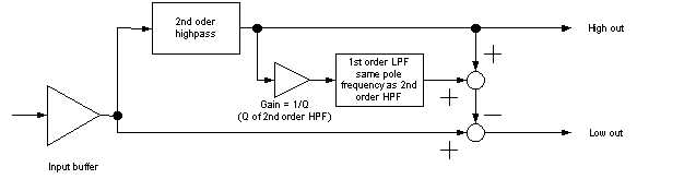

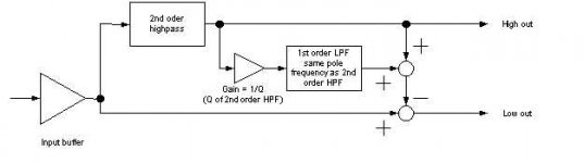

As promised
Here is the symmetrical subtractive 2nd order crossover. I mathematically derived it from the one I called "advanced filler driver". I once read in a book by John Watkinson that symmetrical subtractive crossovers should be feasible but failed to find any decent info, so I did it by myself.
It's output looks the same as the one from the NS APP note mentioned within post #40.
There is one difference however: This one here takes less OP AMPs. If one uses an inverting 2nd order filter topology, it could be implemented with only two OPs (input buffer not counted).
It could also be implementded with a filtered lowpass and derived highpass by using a 2nd order lowpass and a 1st order highpass.
If the pole frequency of the 1st order filter and/or the gain of the intermediate stage is/are changed, the symmetry can be varied (din't do the maths for that).
There are also 3rd order symmetrical versions possible (slightly different topology) but it comes at the cost of larger humps and increased overlap. Even 2nd/3rd asymmetrical should be possible but I haven't done the math for that so far.

this is a very elegant filter phase ac., no question about that...
1st: I don't mean to be irritating anyone with my sayings here and i'm quite open to be convinced by you guys, but i'm still not....
If I look at the HP output, it has the normal 2nd order phasechange (compared with he input) around the crossoverfreq. and under that... If you sum the LP/HP outputs together and there is a flat line (flat summing amplitudewise) this means that the LP output also has the same phasechange , otherwise its impossible to get the flat line right?.
If the 2 outputs both have the same phasechange, there is phasechange in the acoustically summed signal, or if you like after summing the signals electrically this is visible/measurable.
But it is true that the phasechange isn't disturbing the amplituderesponse, what is your goal, but a good symmetrical filter isn't either, if you stay on axis.
Only off axis of the drivers, the lobing with your subtractive filter is broader and so vertical (if the drivers are placed so) it will behave much better because the outputs doesn't have to compensate. With a normal symmetrical filter changing vertical listening-angle means changing the compensating mechanism by varying the vectors... So the vertical lobe to the listener is smaller (only around the crossoverfreq), and in that way the subtractive filter seems more right to me.
However as long as the physical distance between drivers compared with the wavelength is small, this lobing (around the cross.) of standard symmetrical filters is much less, and not a problem to me.
But I must say its a very interesting topic, and it sure changed my feelings about the subtractive filter..... it is quite elegant, but the story about the transient respone seems untrue to me, because there is a common phasechange on both the outputs. But if you change for instance the low-end eq of your amp (wonder if any of you hififreaks have any 😉 ) you'll get the same effect. they say its inaudible, and i believe it.
cheers tonite guys, happy new filter 🙂
Not at all !
The end result is the vector sum of the two signals i.e. for an LR4 where you have a phase difference of 360 degrees (i.e. NOT zero as some believe !!!) both signals add to unity at the crossover point because they are both 6 dB down.
With all the subtractive filter topologies there is a phase shift in the 100 degrees area (even for the symmetric 2nd order one) and significantly less decay than 6dB (most often even less than 3 dB) summing again to unity. The difference between the LR and the subtractive x-over is that the latter is phase_accurate (at the cost of less steep slopes and increased lobing).
