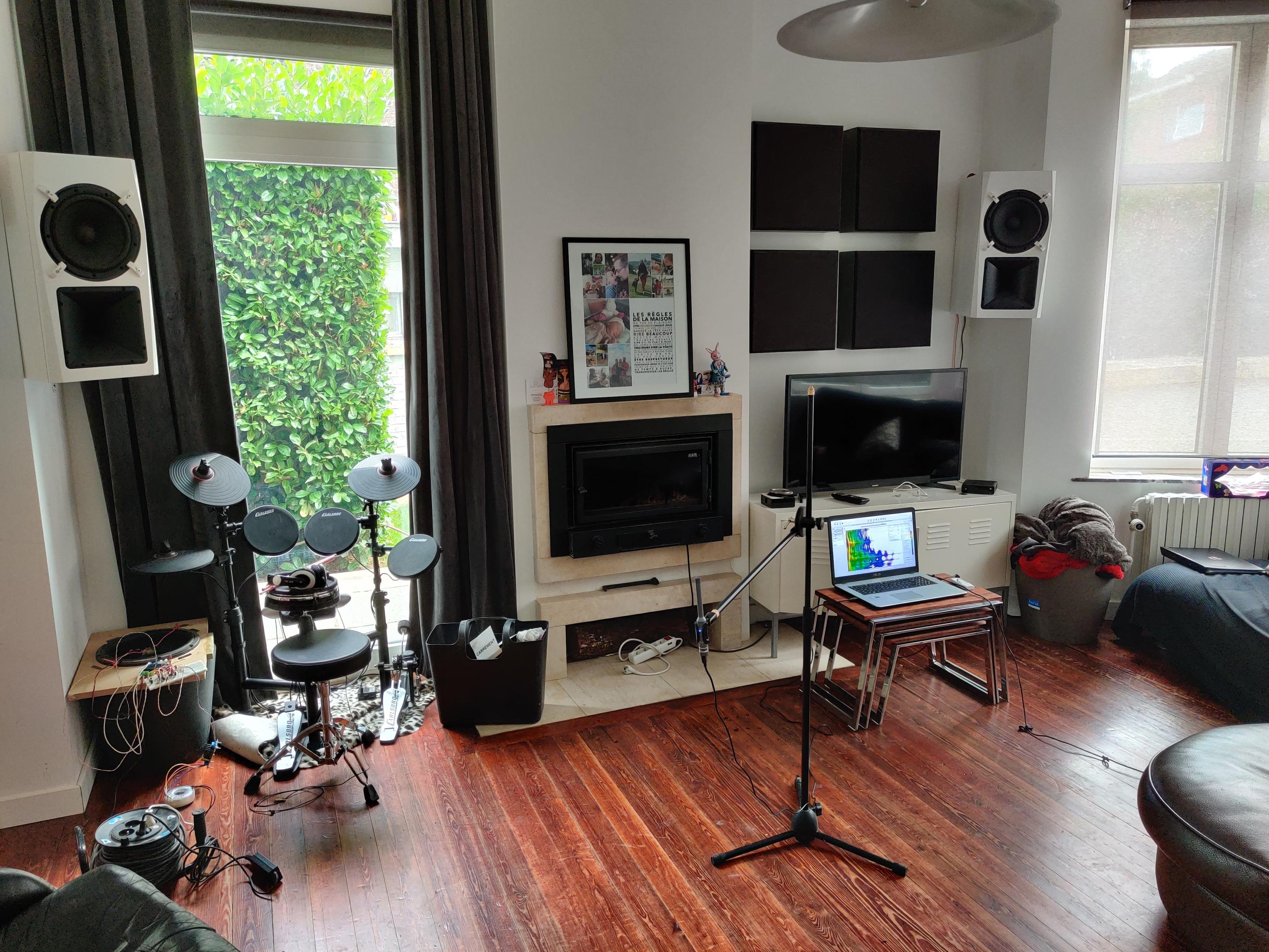

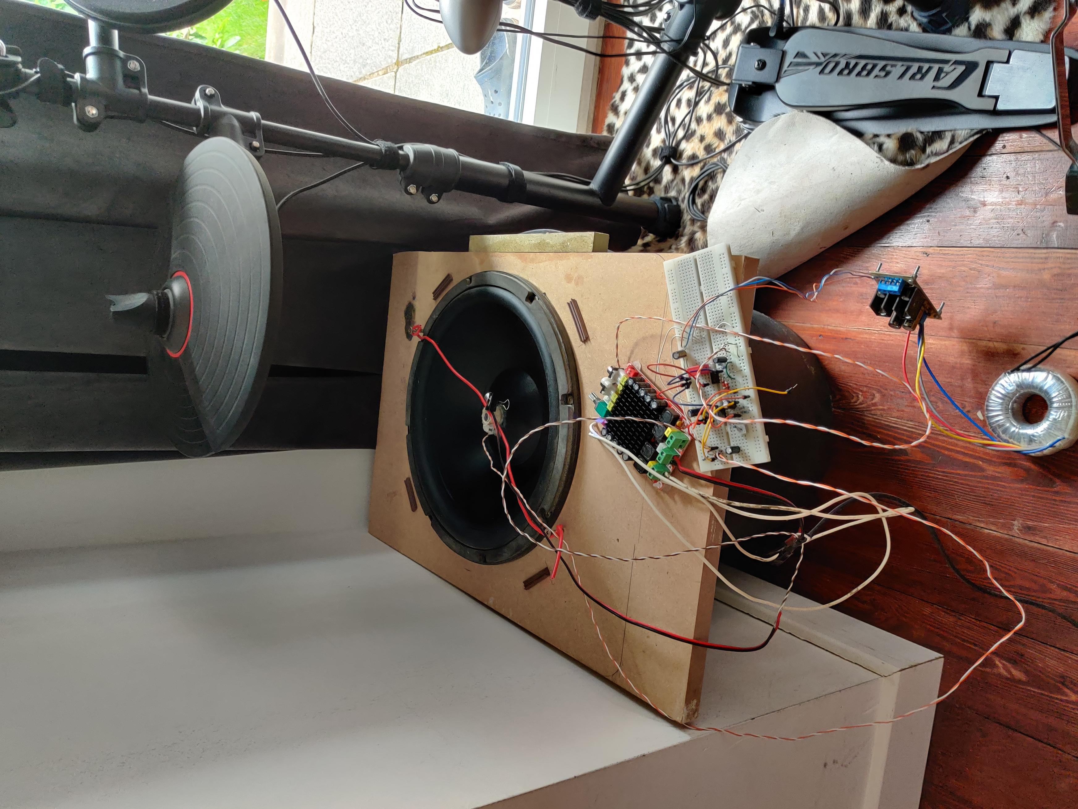

some measurements
#1 : active bass trap prototype with feedback loop voltage amplifier and first order low pass filter with phase lag compensation. Cone treated with PVA glue.
# 2 : please notice windows acting already as bass traps. The ceiling is made of drywall also acting as bass trap...

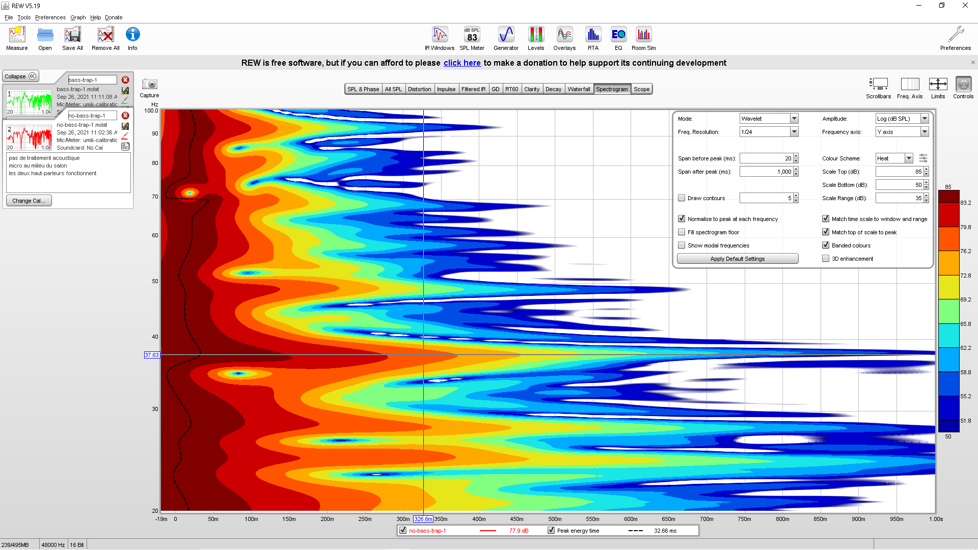

# 3 : measurement with bass trop off

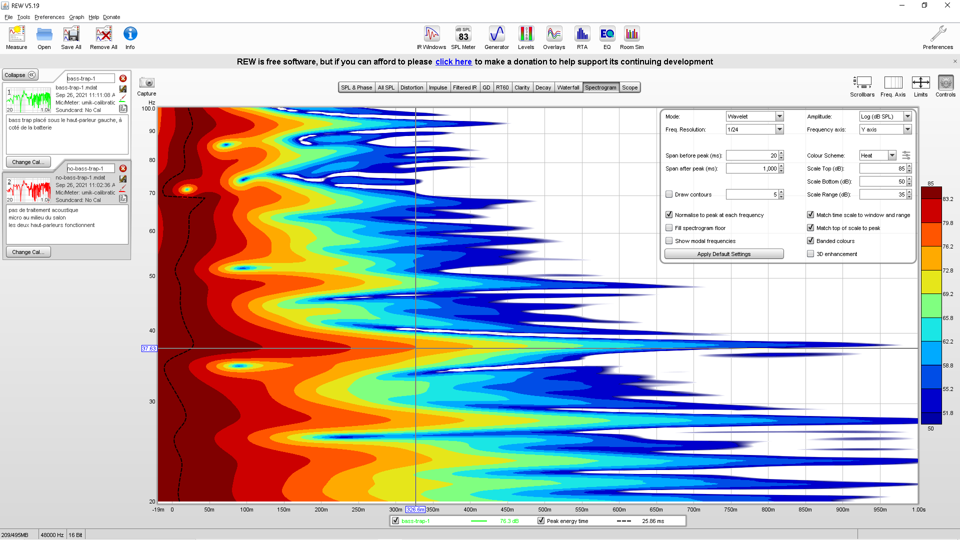

# 4: measurement with bass trap on
I did measurements when prototype placed in several corners in the room, #4 is the best I could get, it is when it is placed in the corner next to the drums.
#3 & #4 demonstrates a measurable effect 🙂.
For my room I think I will build at least 3 of them, I will place those in the corners above the speakers and one next to the drums.
Any thoughts?
