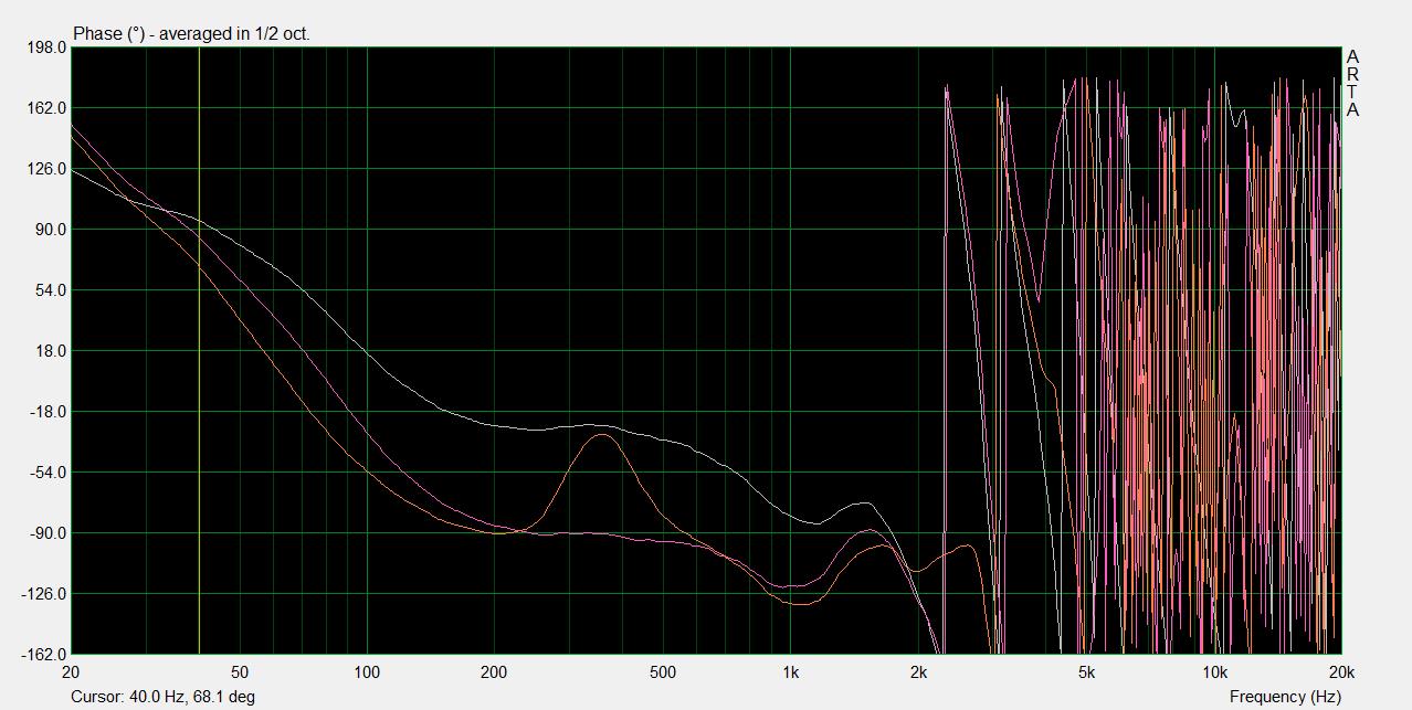

First I was looking at the phase of the 'system'. I fed a 10" sub with another amp, and measured the signal coming from the class D amp I used to drive the sub normally. You could say, I broke the loop at the speaker terminals.
This graph is with 100Hz LP, 10Hz LP and added weight to the speaker cone. I used a pretty heavy weight, a ball race from a big ball bearing I found in the garage that I stuch to the cone, 50g or more.
The weight caused a 'hump' around 350Hz, not sure why. But the phase at LF got better with each change.

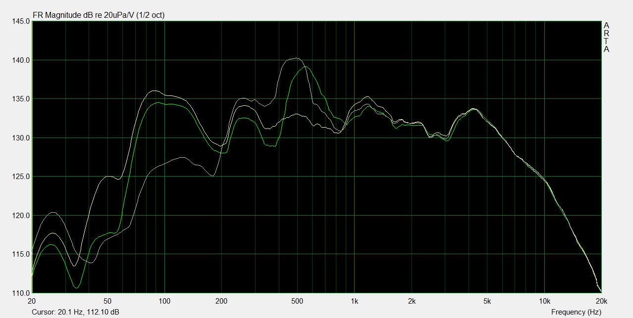

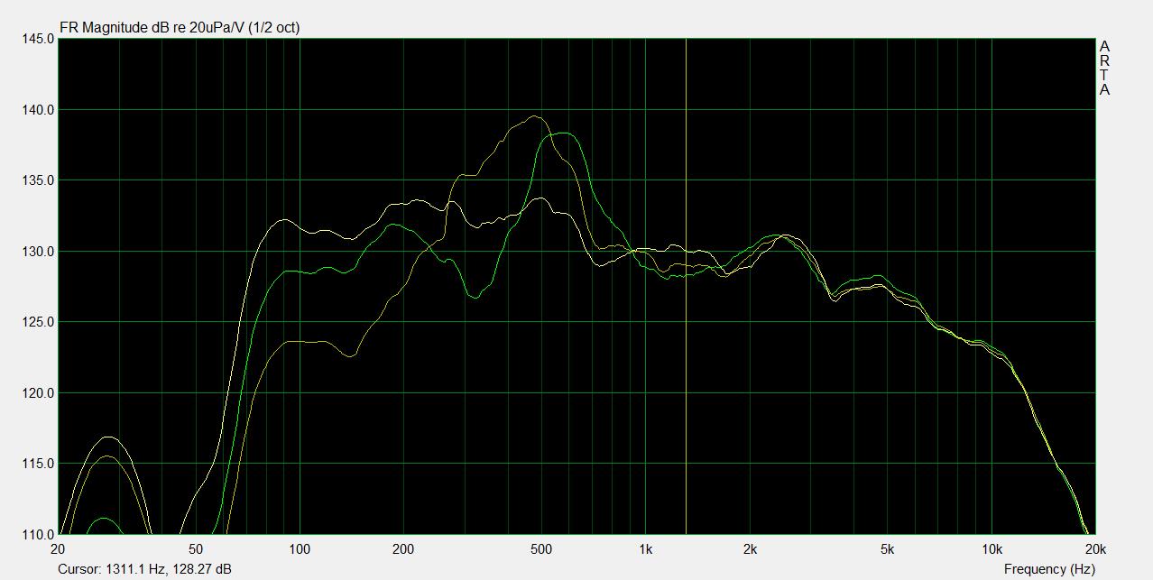

Here are some tests with the sealed 10" sub and weighted cone.
First with mic in front of the woofer, and second with the mic a little bit to the side at the edge of the woofer, and angled away. I could turn up the gain more with this position.
Not optimal placement or anything, just free standing and with the measurement mic next to the 'feedback mic'. Just to see where it's canceling or boosting.
One reference curve, and one with the system connected.
This one looks promising for LF, but the 'boosting' at higher frequencies is a bit annoying. This is the same in all cases..

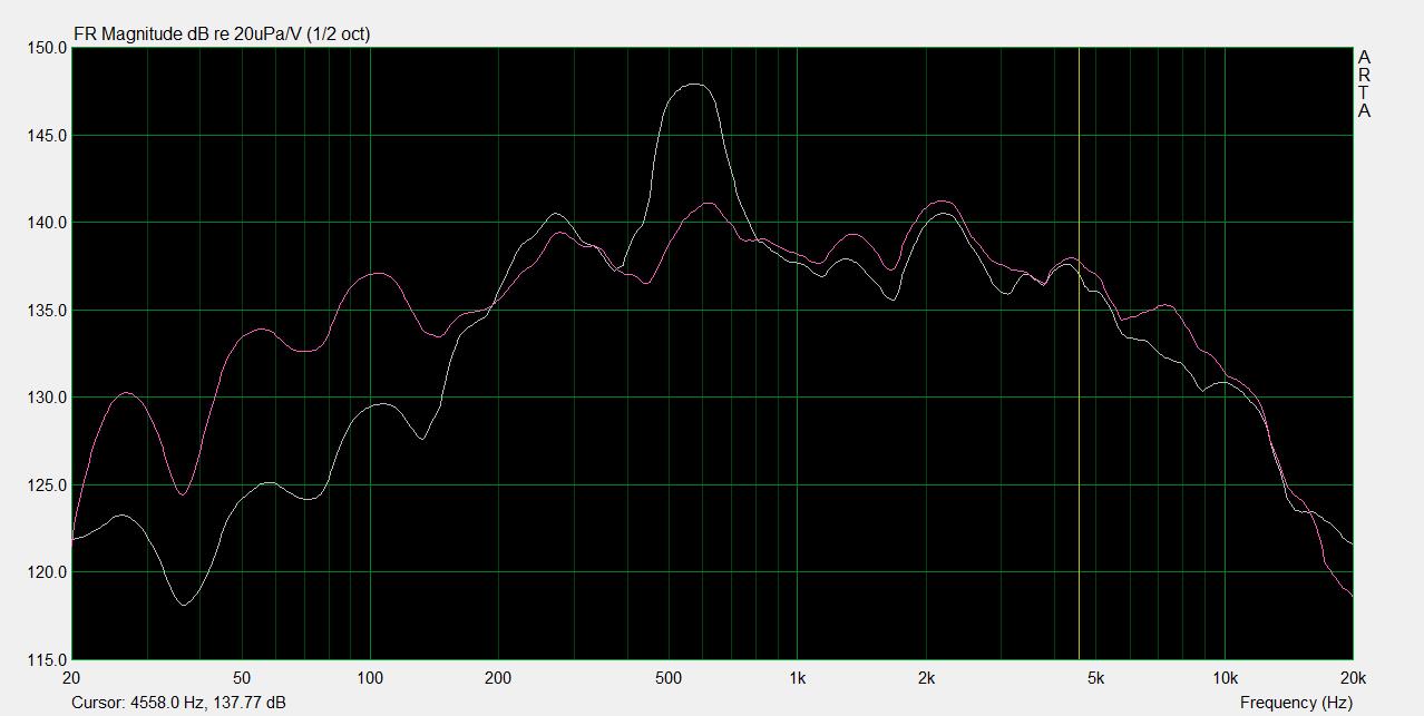

Here I tried a cheap 8" in a sealed box. Mic to the side of the woofer. Disconnected, active, and with added weight to the cone(green). It really 'dies' with the added weight. Not sure why, but maybe because the woofer has a weak motor. Not so good..
Here is a Peerless 8" poly 'hifi woofer'. Baseline, std and added weight. Mic at the side of the woofer.
Added weight helps a bit in the LF, but kills it higher up. Weight is probably too heavy for the weak motors, but works better on the sub with a heavy cone and strong motor.

Adding weight seemed to improve LF phase in the feedback loop since it's moving the woofer resonance lower. You can see that in the graphs too, adding the weight improves the cancellation at low frequencies. But it also has a lot of negative effects higher up in frequency.
