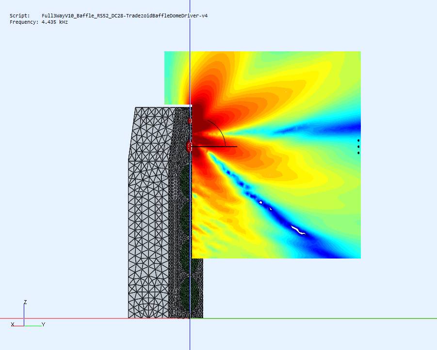

One benefit of the LR crossover is that the main lobe points straight ahead, if you tilt the baffle you will also tilt the lobe.
It is about here I get lost when it comes to the effects of baffle tilting.
My understanding of lobes is that the effect comes from having the same signal sent from two sources with a (in this case) vertical distance between them. The lobe direction comes from the timing between the elements, and will be straight ahead if the two sources are in the same vertical plane, or in this case if one of them is delayed so that the signal reaches the listening position simultaneously.
This is another way to say that the phase is aligned (at the listening position) in the crossover section where sound from both elements is heard.
It is the timing, i.e. phase, that determine the lobe direction, not the baffle angle.
With this background my understanding is that it is the phase alignment that makes the lobe point straight ahead, and that the lobe angle "straightness" is improved with tilting the baffle, not reduced.

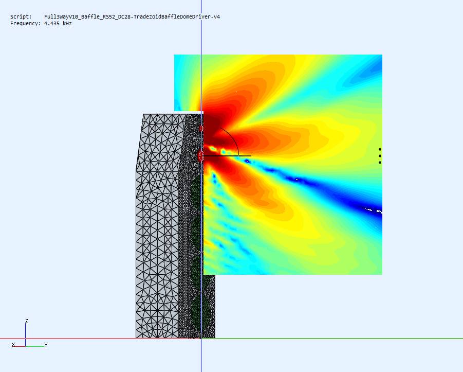

This speaker uses an active LR4 XO. The first pic is for the M+T drivers in phase and the center lobe points straight out between the drivers @XO. The second pic has the tweeter reversed (ie. 180deg phase) and you can see the axial null between the drivers due to interference. It also has more lobes that are no longer pointed at the listener.
At some frequency, away from the XO point, each driver will be dominate and will radiate straight out axially. So it makes some sense to have the same behaviour at the XO point when both drivers are active.
I would think that adjusting the drive level of multiple "in phase" drivers would allow you to steer the beam. As long as the total power was constant so that the FR remained flattish.
That lobe pattern follows the driver's axis which are fixed to the baffle (as per @fluid).

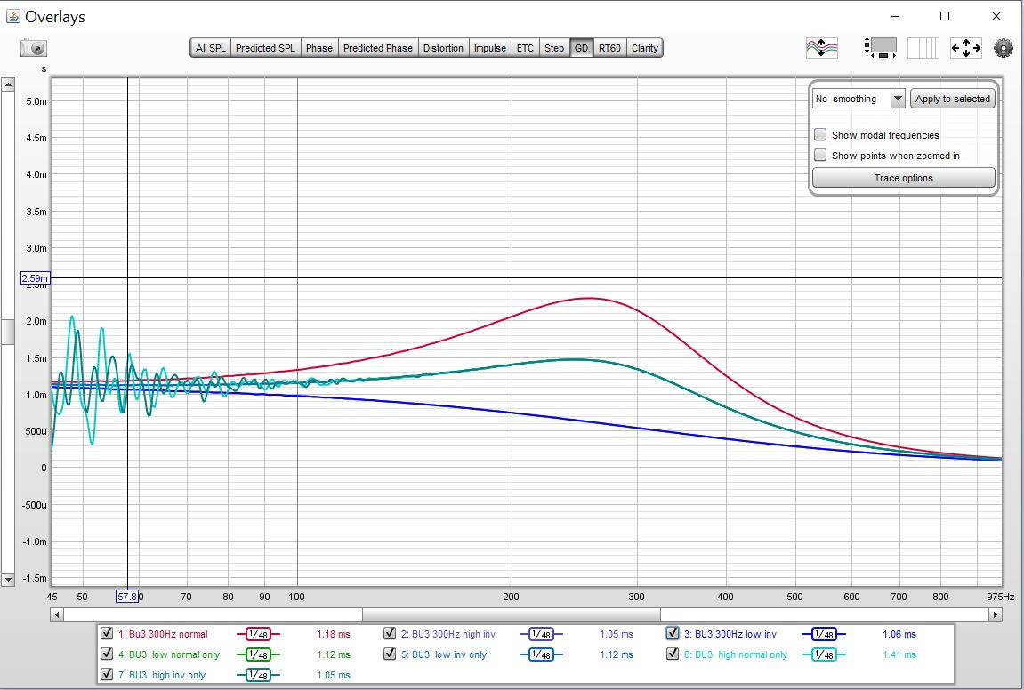

Yeah, it would seem plus or minus 90 degrees is an accurate description, but it's not. It really is 90 vs 270.
It's a highway to disaster to think every 360 is equal phasewise.
The difference in group delay curves we've seen is about polarity, not any timing pulled out from group delay.
On graph below:
Red curve is #1 trace alone, which is both sides of a Bu3 @300Hz summed with normal polarities.
Blue curve is traces #2 and #3, which are the same, where both sides are summed, inverting each side one at a time.
Those two are the same as fluid showed, just shown again for extra perspective against what follows.
Now for the group delays of the two sides separately.
#4 is low side only with normal polarity; then #5 the same but inverted.
#6 is high side only with normal polarity, then #7 the same but inverted.
If you couldn't pick them out it's because they are all the Green curve... #4-7 are all the same.
No differences.
Which is why polarity matters to summed output.
When both are normal, the same group delay curves appear to become somewhat additive, and give trace #1.
When one side is inverted they appear to become become somewhat subtractive, and give traces #2 or 3.

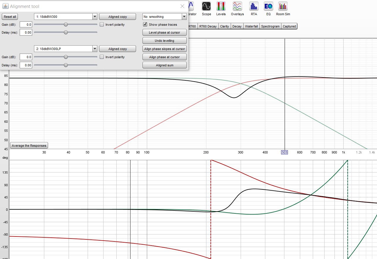

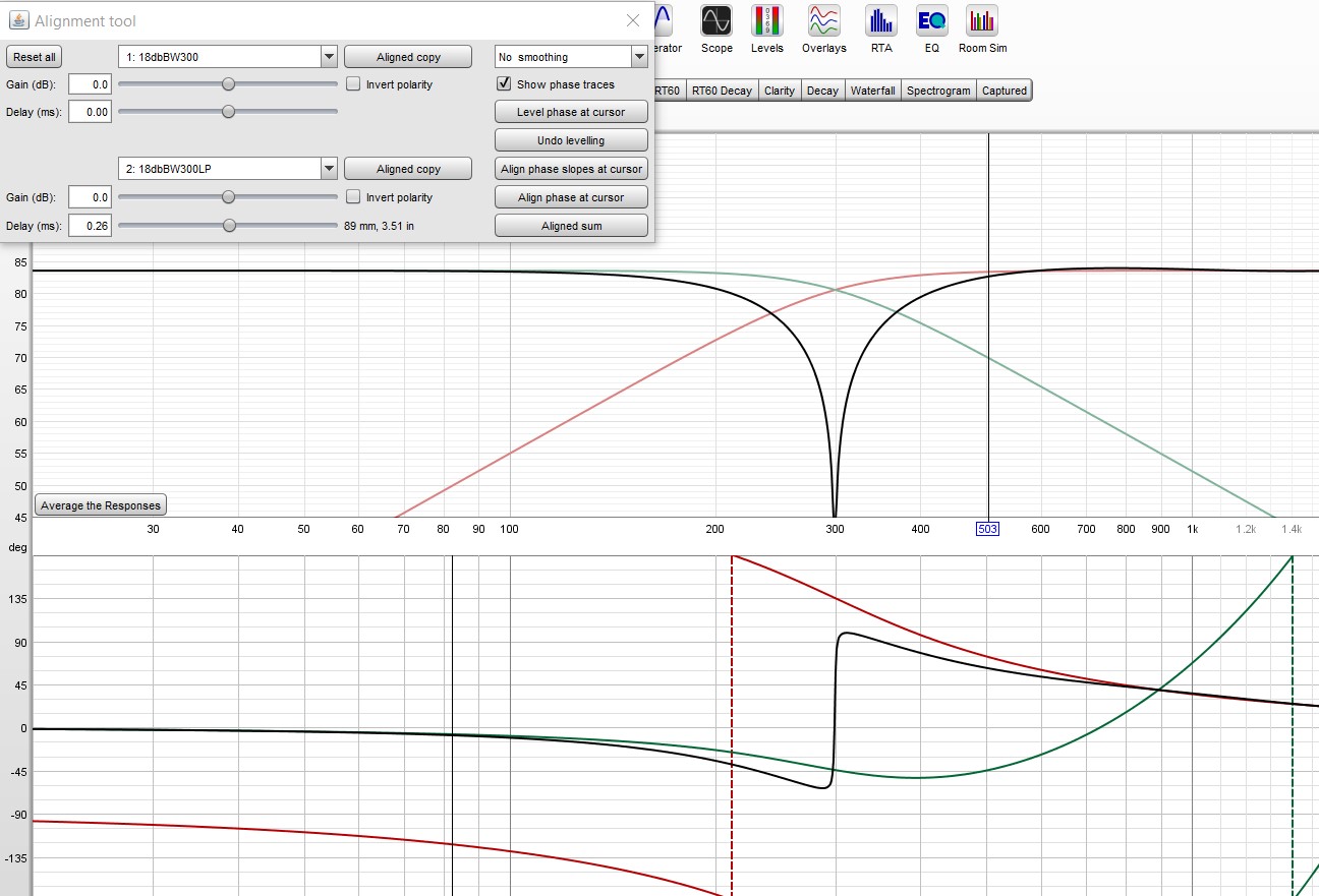

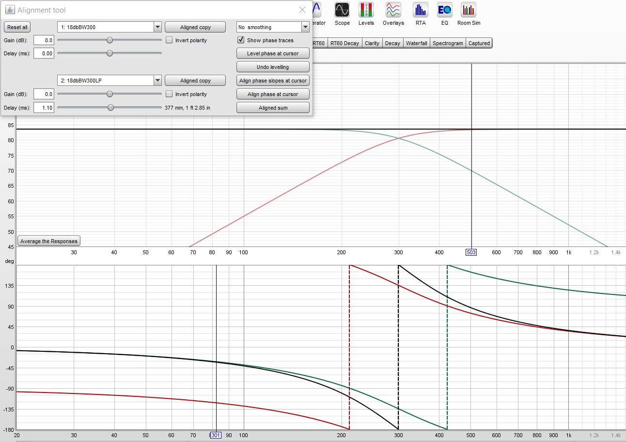

Plus or minus 90 degrees? Isn't the difference in group delay due to the 1.1mS delay?
No same delay for both mark answered the why in his posts.
I don't know anything about REW, I've never used it. I thought the delay had been added
It had, you are right there.
It may be when building/exploring synthetic xovers, perhaps via imports from rephase, that alignment is needed in REW?
Dunno...and don't want to speak for fluid.
Yes the delay needs to be added to ensure the phase is aligned and you get the sum you want. In a real speaker the offsets will be different and you might get lucky or design it so there is no extra delay added.
Here are some graphs from the alignment tool in REW to show what happens when the relative phases are changed. This is using the 'both drivers in phase' version. This is why I say the slopes need to be aligned, the phase matched option in REW gives the maximum peak, so I suppose the terminology can be confusing but the graphs show what is happening. The only thing changing is the delay / relative phase between sides.

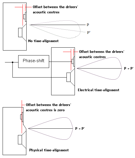

That can be the case and is shown graphically here, but if you have a straight polar lobe then tilt the baffle the lobe will tilt with it too
attachment.php
All odd order crossovers have a tilt baked into them scroll down to the bottom of this page for some graphical examples
Power
They can be tilted back up but it is just another thing to consider as to which is the best compromise for the application
