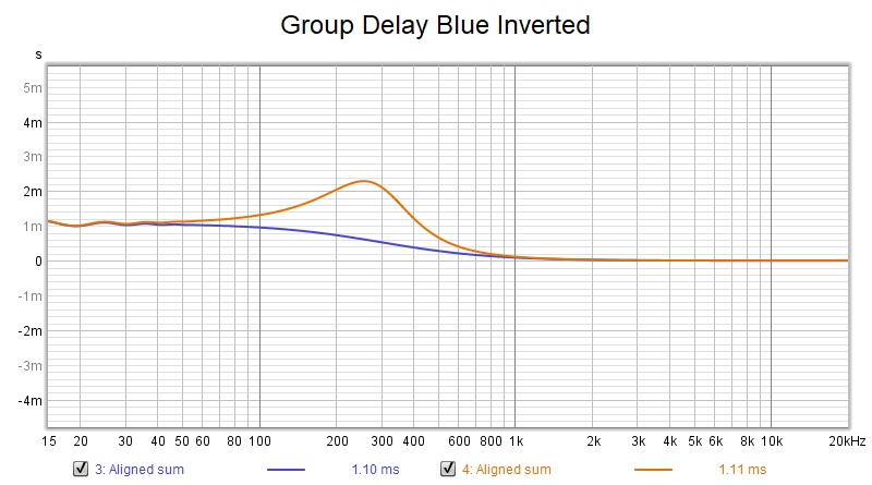

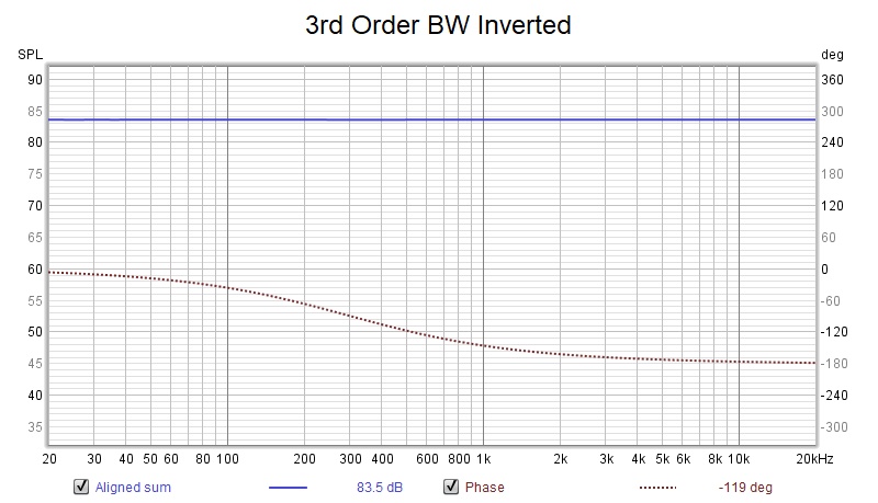

3rd order Butterworth seems interesting. Flat voltage and power but with a lobe tilt. Flat whether inverted or non inverted giving the opportunity to change the all pass phase response. Inverted avoids the group delay peak.
This is synthetic 300 Hz BW3, phase slopes aligned in REW with a 1.1ms delay, anything else gives a dip, a peak or ripple. I suppose a dip or peak could be used to get a flatter summed response from non flat drivers.
