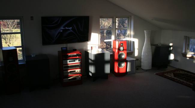

Hi all,
The new system in my living room...

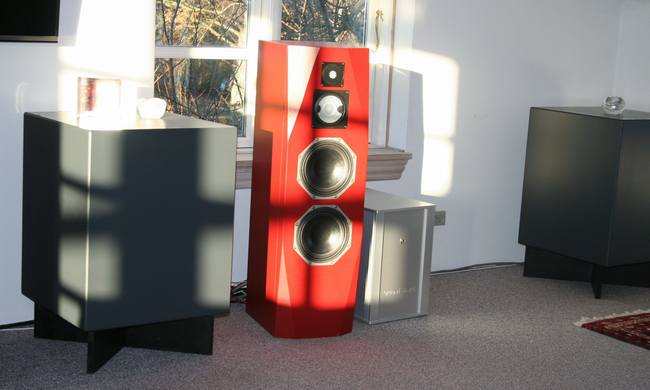

So how do they sound? What are your crossover points? Did they meet your expectations? Thanks.
Goose bumps and entertaining as one of my friends said and I agree 😀
XO points are 80Hz, 500Hz and 3kHz

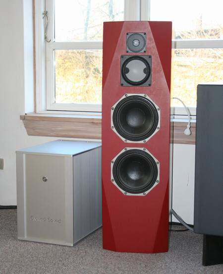

The system is actually better than I expected as I had feared that using the Accuton drivers could give problems that I have experienced in many other loudspeakers using these ceramic tweeter and mid drivers. They really outperform anything that I have had this far. Nothing "sticking out" - very clean...
And the Oberton 8" drivers nice precision (good choice)....

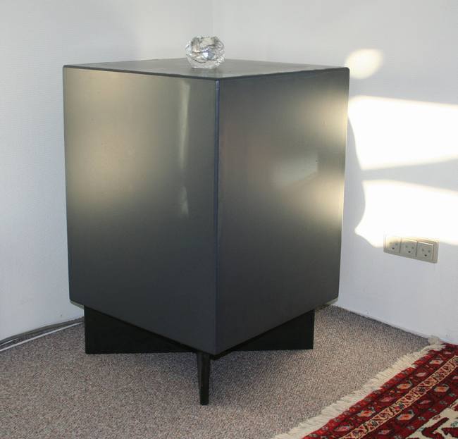

And the 4 x 15" closed Dayton subs.... very nice indeed = control at every bass node.
The amp blocks are only temporary as I will build a "Coolback" with the exact same amp modules into red enclosures. I use in each side 2 x PA3CC at +/-63V rail (tw+mid) and 2 x HPA2K at +/-63 and +/-125V rails (bass+subs) 🙂
Do the maths ~ 200W (8ohms) + 200W (8ohms) + 1200W (4ohms) + 2kW+ (2ohms)
