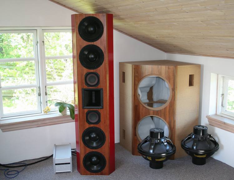

Active high dynamics/SPL & high performance loudspeaker system for my living room…!

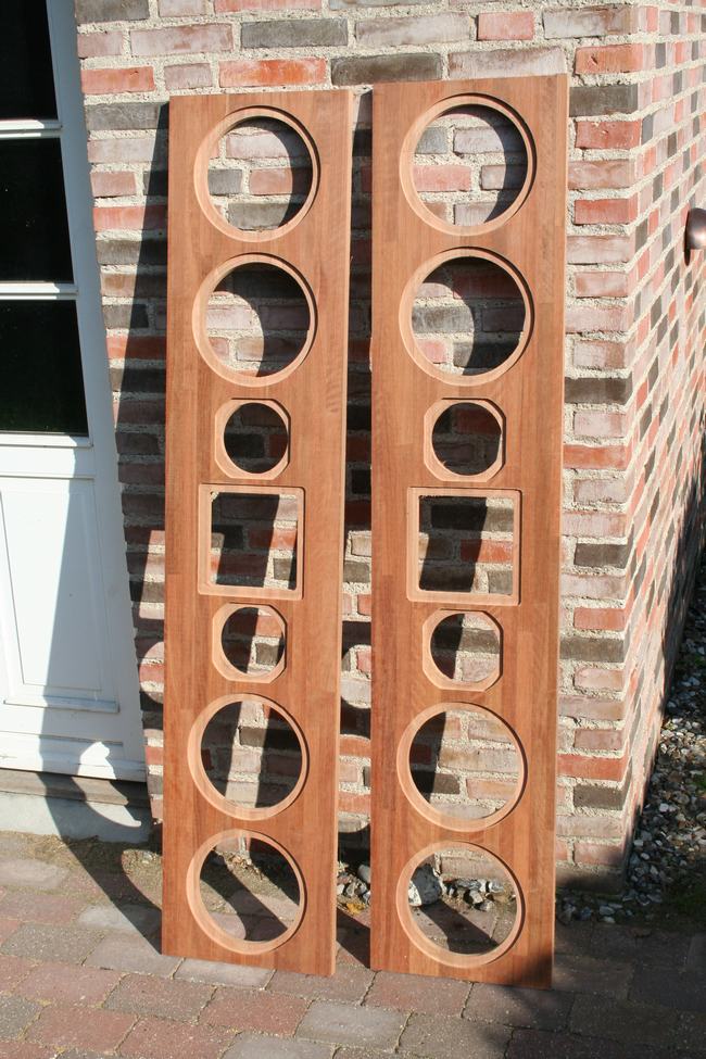

Way passed August - but finally I got the front pieces back from the CNC guy.
And the drivers fits perfectly 🙂
Now it "only" up to me to finish the loudspeakers 😛

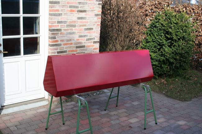

NO NO - they are NOT finished, but I managed to lacquer the front panels 😱 - that's all. Maybe I will have a little time over between Christmas and New Year...

There is still a lot of paint job to be done - not my favourite hobby 🙁

Seems as if the TPL-150 likes red! Very nice project BTW.

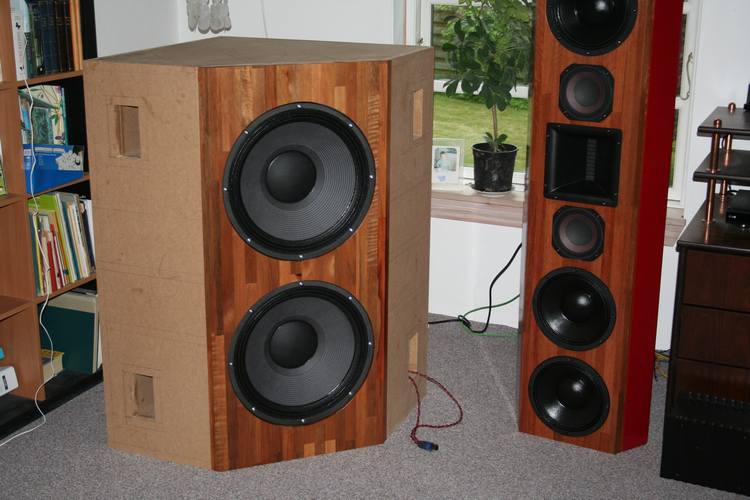

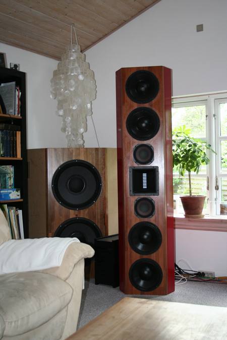

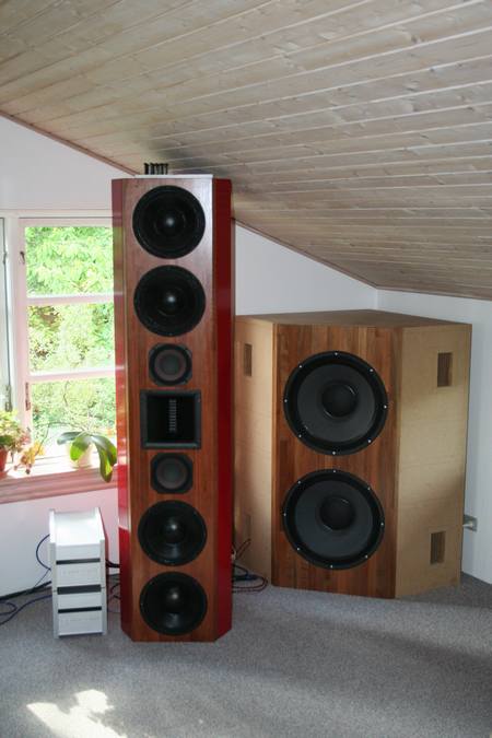

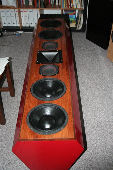

Well – I have been listening to the nearly finished system for some time now 😀
The corner subs aren’t painted yet – reason later…
See the attached pictures for the latest developments.
The system has been measured and setup via the XOverWizard II advanced software and this has resulted in a reasonable (some will probably say excellent) sound, but I have some issues….

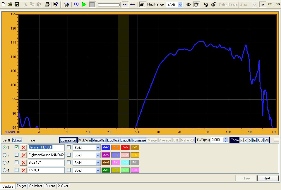

I feel that I have to tweak the TPL-150H some more – like there are some nasty frequencies without being 100% sure what it is. The TPL-150H measured on-axis without filtering - see attachment.
What do you think – has anyone measured the TPL-150H? and close and above 20kHz? What do you think?
Overall the sound and response of the 6” Eighteensound drivers seems to be very good and I have no direct complaints here.
The choice of the Sica bass drivers might be a bit off or maybe NOT. It results in a very nice tight punchy bass and they might have been enough if the enclosure for them had been bigger and ported... Sure would have been 😎
I have actually tested the system without the subs for some time, but it proved that the enclosure volume for the 10” were too small – also seen in the measurements that I made.
Well – I wanted the dual 18” corner subs to begin with – now I am not 100% sure because they sound right but this is totally overkill – when my ears begin to bleed, they barely move and they extend down to 20Hz 😛 A year ago I actually tested with a tone generator at 20Hz - scary the wall of my wooden house moved many millimetres at high but not at all full level…!
I have even been thinking of replaced the corner subs by two ported folded front-loaded horns, because this is what I really like the very best when it comes to bass reproduction. Each horn would “only” use one driver and one box in each corner, BUT NO NO NO – this will never happen I want to keep my house standing.
AND my living room is way too small – it can’t absorb the energy, so at high SPL level the room is simply flooded. I have been thinking about damping, but I can’t really come up with a decent solution which will be acceptable to me and my family. And on top of that the system makes many things rattle at the levels where the fun really starts. 🙁 Am I getting old…?
I am contemplating to just let the new high dynamics system go 😱 and reinstall the ScanSpeak towers after a few upgrades – maybe replacing the ScanSpeak dome with a Mundorf AMT1908C and definitely a new more potent Coolback without a digital crossover using the DCN28 to it’s full potential. The current version of the ScanSpeak tower really makes my day and they probably are more forgiving to more music material / quality – so that the overall sound is more like – “easy listening”…. I am getting old – aren’t I ?!?!

Nice red boxes - I really like the deep red colour for loudspeaker boxes...
Maybe I have to repaint the ScanSpeak towers if I go ahead reinstalling them 😉

Cabinets turned out real nice.
Hi Robert. Excellent project!
Comparing the manufacturer's spec to your own measurement of this driver, there seems to be a discrepancy up above 10kHz: their plot is flat, while yours has a dip. I find that equalising such deviations can introduce problems, rather than solve them. DSP tools are very powerful, but one can over-compensate or, rather, mis-compensate.
My suggestion: do some off-axis measurements and see whether that dip also exists off axis. Alternatively, try smoothing your measurement to 1/3 octave before applying equalisation.
I find that exercising constraint when equalising the tweeter yields good results, usually.
