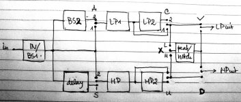

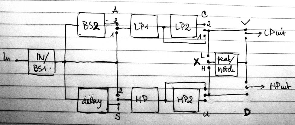

I might also have a hard wired 2way bread board with
- input amp with possibility of baffle step (as this approached the desired transfer function better than a 1st order baffle step)
- possibility of 2nd order baffle step
- 2 2nd order LP filters (order 1-4 to be selected with hard wire and jumpers)
- 2 2nd order HP filters (as LP)
- 2 delay functions (1-2 to be selected with hard wire)
- a peak/notch filter (can be inserted in LP or in HP filter)
Everything with multiple R's (easily changable and selectionable with jumpers).
See attachment of block schematic of the board.
Anyone interested? (I can send photos and a more detailed description).

The offer of the bread bord will have to be postponed for (probably) months. Nonetheless I include a picture of it (sorry for the small size but the forum doesn't allow a better picture. Mail me and I'll send a better one).
Dick.

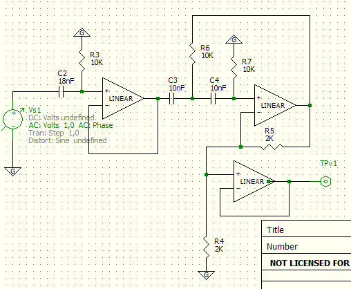

Sorry, my mistake. I didn't see the second page of your attachment.
With that taken into account you'll get a 4th order filter.
I see though that IC4 a and b occur twice (even three times!). If you delete the first one altogether you'll have a 3rd order filter.
Delete R6 and feed your input directly into C4.
IC4B (the first one) can be bypassed by feeding the following section directly from the output of IC4A.
Like this:
