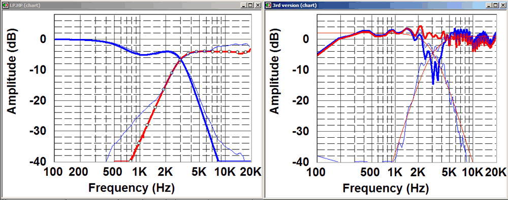

Hurray, I finally got around to stuffing one of the boards.
After lots of boardscratching and correcting mistakes I got it to work as calculated. Everything works within .5 dB of the transferfunction I designed for!
Now I can start building it in the chain and start listering.

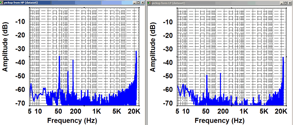

As I reported earlier: the filter behaves as predicted both electrically and acoustically (even though I eliminated all the buffers (!)).
One problem though: when implemented in a preamp-amp-speaker setup it starts oscillating at unpredictable moments mostly within a few minutes after start. Until that moment it sounds fine but listening to a oscillating (screaching) setup with the power amp fully blowing is not a pleasure.
I must admit I only used a test setup (the filter is bare, not build in a shielded case). I suspect that the filter (either input or output) is picking up signal from the speaker cables.
Anyone have experience with this problem?
Will casing help? I would rather experiment first before finishing the thing in a case.
Dick.
Dick.
dick van nierop said:As I reported earlier: the filter behaves as predicted both electrically and acoustically (even though I eliminated all the buffers (!)).
Dick.
Do you use EQ sections or just the HP/LP filters?
If you use EQs with +gain you must also mount a capacitor acrosst the top resistor in the FB path... you problem could be missing this.
What opamps do you use?
\Jens
Hi Dick,
I don't think the lack of a shielding case is your problem.
Are the speaker cables near the crossover? Move them to miss the crossover.
Are there mains electrical cables UNDER the floor where your crossover is laid? Lift the crossover.
BTW,
your 19 Jan post had no attachment.
BTW,
Thanks for you reply.
I don't use equalizers, just the LP and HP (without output buffers of IC9, so directly from IC8A (which I have rebuild to form a LP-filter) and IC5B.
My opamps are OPA2134.
I measured crosstalk and found that in the frequency range I can measure with my soundcard (up to 20 kHz) there should not be a problem.
With the speakerleads laying on top of the xover i measure a cross talk of -30 dB max. This can not cause the oscillation as it would require a crosstalk > 0 dB.
The measurement was done by disconnecting the xover from the poweramp and injecting the meaurementsignal directly into the poweramp. I then measured the output of the filter (see attachment).
Can it be that above 20 kHz there is a problem as the signal level seems to be rising rapidly?
So what next?
So what next?
