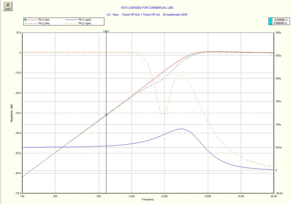

Hi guys
And now for something completely different (I'm a big fan of Monty Python):
A while ago someone made a remark on timedelay. This will work nicely I suppose if the filter has a smooth phase response at crossover.
In my design I have to put a notch filter just under cross over (at the resonance frequency of the tweeter).
This messes up the phase response completely (and the working of the all pass section).
Has anyone experience on this point?
I know I'll have to try and listen but any advice beforehand would be welcome.
Dick.
PS: one all pass section will in most cases not be enough

Dick,
Can you post a picture of what your phase relationships look like before and after the all pass?
Have you tried reversing the placement of the notch and all pass in your signal chain? What is the rest of your filter topology? Assuming that you are still simulating it, does the simulated circuit accurately reflect what you will use on the board? (skipped buffers, etc.)
Hoi Bob,
Here is the picture of the schematic : first element 2nd order HP, 2nd element notch filter, 3rd and 4th element all pass filters ).
Have a look at the delay reponse in next posting: it shows a severe dip at 2 kHz as a result of the notch filter.
I intend to accurately build the filter as designed (no buffers therefore).
Dick.
