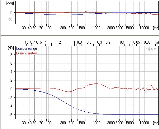

Do a search on the "Edge" baffle diffraction simulator. You can model an enclosure that looks like yours and see where the step is. It allows you to enter where the compensation starts and stops and will show you its impact. Nice tool. The program uses a different topology to handle BSC, but the acoustics are right.
You can also use BDS (baffle Diffraction Simulator). It is a bit more powerful than the edge, but the learning curve is so steep it makes speaker workshop seem intuitive. (I've looked at it a few times, but haven't figured out how to make it work for me)

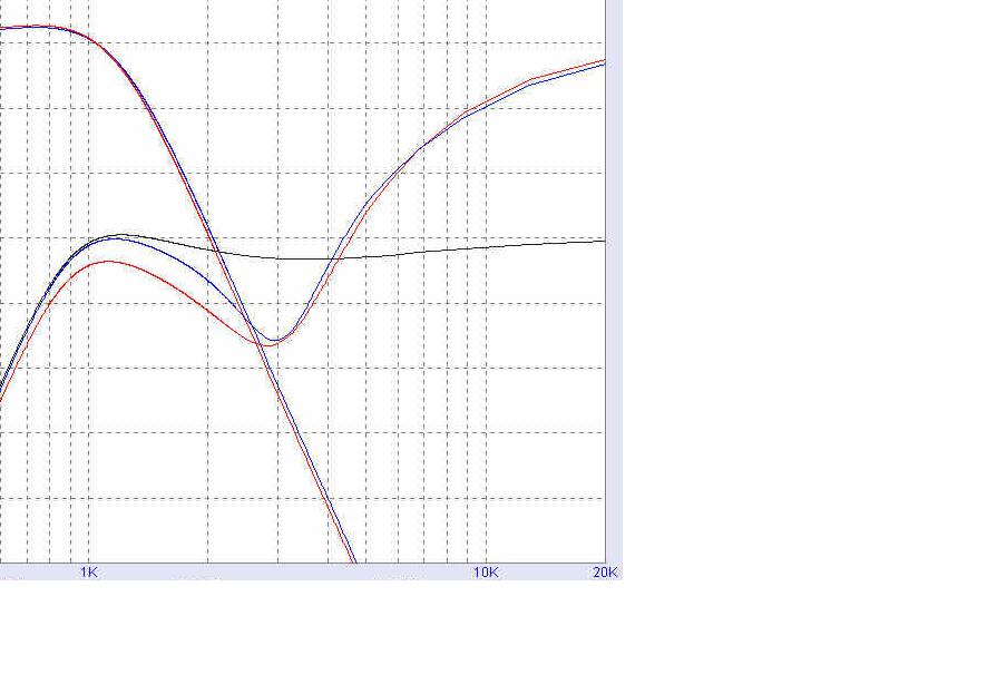

I am going to be running a set of Tannoy coincident 12's actively. The tweeter is going to require a notch at about 3k and a rise starting at about 5k all the way out to 20k. Do you think I can achieve something like this with this Xover and its eq abilities. I hope so or it's Berhinger for me (I keep saying that

I have no curve to post
just info from other tannoy users. From what I understand it's very similar to what would normally be needed for a CD horn..the need for a rise???!?
Thanks..the 20k boost may be a starting point🙂
actually. here ya go: black is un-eq'd. The others are what I'm after. Those are 3dB steps...

That response looks like the 3 KHz notch is doing it all. Model it in a circuit simulator and you'll see that a notch affects quite a wide range. A combination of notch filter and attenuation and you should achieve your goal.

Good observation, and now that you said that I can't help but agree with you. I think it could be as simple as that🙂

That looks pretty good, nothing the board's EQ cant fix. Of course working with measured response is better. SW is well worth the time it takes to learn how to use it.
