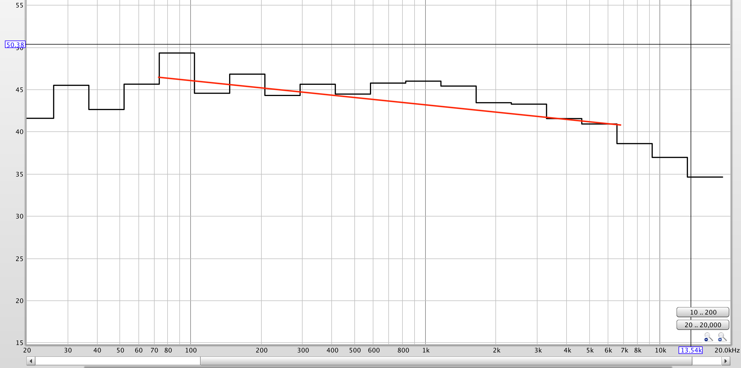

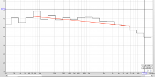

Meas: Line Audio OM-1, Edirol Quad-Capture, REW.
Source: (d) Squeezbox Touch -> toslink -> Ian's re-clocker -> toslink -> toslink active splitter (1->3) ->
Main speaker (LF limited FR) no HP (stuffed ports):
(d) toslink-1 to Left (5 meter) -> DAM DAC in 1 ch diff mode, toslink-2 to Right (5 meter) -> DAM DAC in 1 ch diff mode
(c) All_digital_coefs_1.2 (XL) -> Biquads -> Soekris DAM DAC
LF 45 Hz LP:
(d) toslink-3 (L+R) -> Hypex DLCP
(c) Hypex DSP Filter Designer -> DLCP
So no FIR, only IIR actions. Attachment is from listening position in sofa. Yes, a bit forward but not harsh, just resolved, but probably needs taken down a bit at 1k. Measurements where done using pink noise and REW RTA. I execute a slow change process running over weeks between adjustments. I have actually done one change round to this but have't measured it yet - don't want to know yet 🙂
