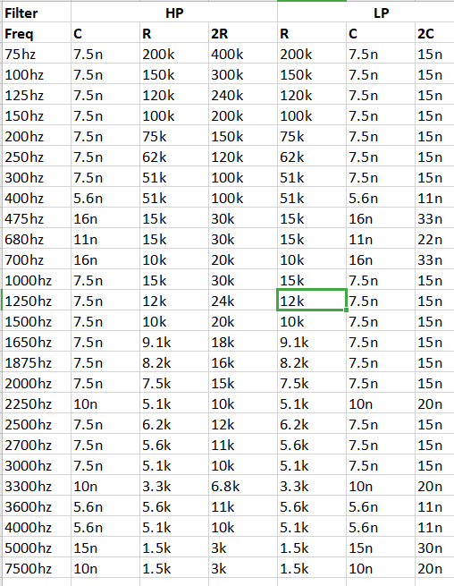

values between 1n to 10n are available in E24, above that we generally get E6 or E12 at best. The PCB foot prints are based on Kemet PHE426 series which are good quality caps and reasonably priced. available on mouser..
Infact, my idea was to buy 7.5n and 15n in bulk and keep changing resistor values, as resistors are cheaper and available in a wider range of values, easy to source x,2x values. Please see the spreadsheet attached.
Cheers.
