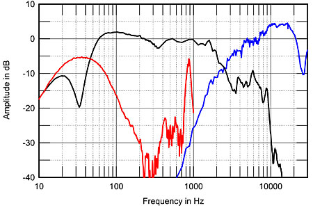

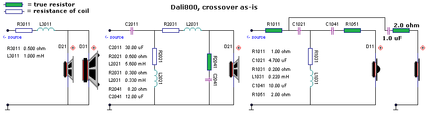

Quick search did not turn up an actual XO, but did find a Dali 800 revised XO by Troels. nHe knows what he is going.
Your speaker is quite different, but if the XO bits here are in anyway representative, you have a first order lowpass on the woofer, the XO for the midrange has more to it.

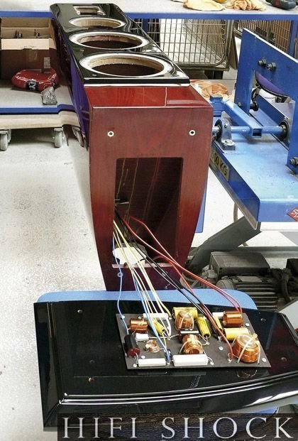

Unless you have 8 amplifer channels you’d have to be part active and part passive. That would mean at least disturbing the passives enuff to measure the relevant components, so that you can recreate the parts of the passive you want to continue to use (i would expect at a higher level of parts quality). Means the XO has to come out if you want to do what you want.

There is no harm in filtering oput frequencies that are filtered out by the passice crossover but make the active filters operate over a wider bandwith - ie not at the same crossover frequencies.
Also, since the passive crossovers will block unwanted frequencies, the load on the amp is reduced outside of each driver's range. I.e no power is wasted or the crossover would heat up (obviously).

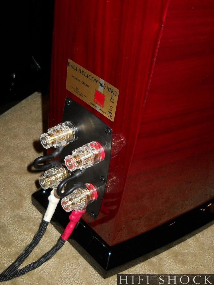

I don't thinkl there are sonic benfits by using active crossers when the speaker has passive ones. (My Naim SBLs have their crossovers mounted externally because Naim intended them to easily removeable and used with their active crossovers)
Seems easy enough to have access to the crossover without any detriment to the speakers.
A simple frequency sweep with a chipamp will allow you to measure the transfer function at the crossover outputs without having to have any knowledge of the speaker chassis.
You can then design the active crossover to emulate that.
Should also be easy enough to rewire.
But you will need 6 Speaker terminals per speaker and 6 channel power amps for stereo.
Easiest is a new plate for the terminals.
Then you can restore it back to original status anytime.
Success,
Patrick
PS Crossover components not particularly high-end, if I may say so.
