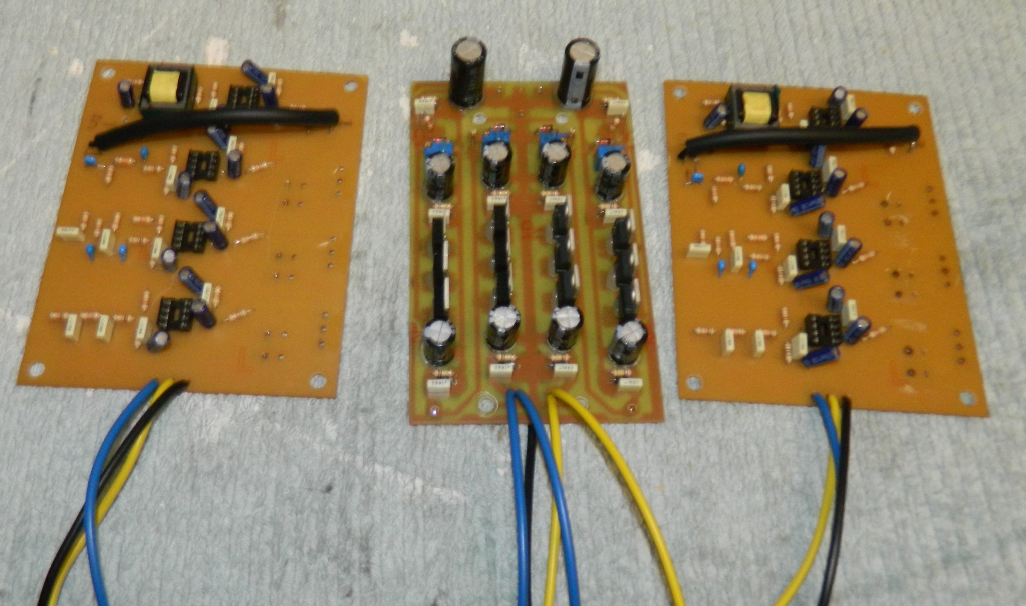

I have built alot of Active Crossovers in years gone by for home equipment & in the PA world learning how they sound & when they blow up due to being over-driven. In the 1990's it was alot harder to calculate the Frequency crossover points, as all I had was the pie formulas, now the are online calculators to work it out for you & each R/C filter is 6db per octave.
If you was going to make an active crossover & you still had the passive crossover inside the speaker then I would choose higher frequency roll off for the bass & a lower frequency for the mid, tops which are away from the the speaker crossover frequencies. I still think it is pointless in doing because of the speaker box crossovers, but the amps would run more efficient with less bandwidth to amplify.
In the picture is one of my older test crossover circuits showing a design layout from above & the only thing missing is the 100k pots, which form part of the output circuit, this incluse a gnd loop isolation transformer as there is alot more ground loops to consider as you add more amps picking up noise...
