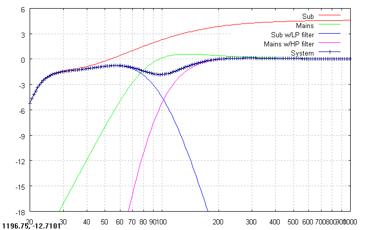

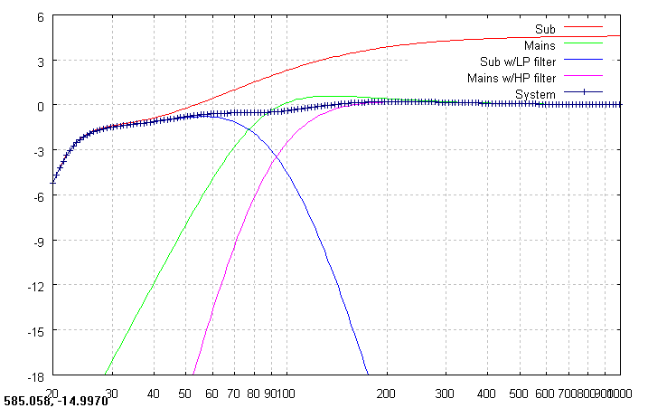

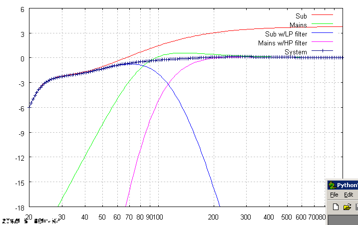

A system I built employs Jordan Jx92s speakers in .28 ft^3 sealed boxes with a subwoofer containing a 10" Peerless XLS driver and 10" passive radiator in a 1ft^3 box. The crossover needs to be in the 90 to 120Hz range. The F3 of the mains is around 70Hz. Theoretically, I get a flatter response when the sub's low pass is 24dB per octave and the main's high pass is 12dB per octave. Or I can get a nice flat theoretical response by using 24dB filters for both high-pass and low-pass, but using different center frequencies, say, 120Hz for the sub and 96Hz for the mains.
The first chart shows the theoretical response with a 24dB Linkwitz-Riley xover at 96Hz. In room, that setup has an actual suck-out at 100Hz of around 5dB, not 2dB as shown. I am compensating for it with a graphic equalizer.
The second chart shows what happens, theoretically, when the high-pass filter is changed to 12dB/octave. Ahhh.
The third chart shows the effect of 24dB filters on both sub and main, but with the sub's filter centered at 120 and the main's at 96.
Maybe it's just me, but... how about different filter orders or center frequencies for the high-pass and low-pass stages of the crossover?
