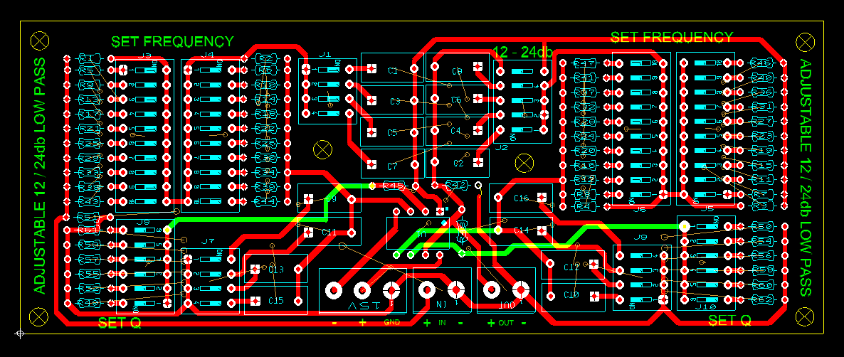

I drew this up about 2 years ago but never got around to building it:
Also a matching high pass (which I didn't finish the layout for).
Uses dip switches and, as can be seen, a lot of resistors.
Ahh the good old switched selection.
I've never tried to do something with that many options but a cheaper way of doing selection is to use 'split circle' solder pads which you can bridge with the touch of a soldering iron. Works nicely in situations where you might want discrete fixed levels of attenuation, but still want in-situ adjustment.
