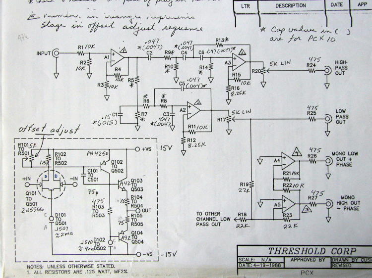

It may be appropriate to post this schematic here, which is an older version of Mr. Pass crossover (PCX). Additional info, with module pics can be found here: http://www.diyaudio.com/forums/showthread.php?s=&postid=37444#post37444

You should have a unity gain buffer between the first order and second order section to prevent tuning one network from
changing the response of the other. Some
of the cookbook component values take in to account the interaction between the first and second order networks in the formulas but I think the intereaction could be a problem when trying to tune the first and second order sections to have different corner frequencies from each other.
changing the response of the other. ...I think the intereaction could be a problem...
For hand-tweaking a filter today, I agree. A buffer sure makes things easier.
But back in 1988, op-amps cost money and good audio op-amps were expensive (see inset in Peter's post; these were discrete hand-built hand-trimmed units). More design pencil was a good trade-off for fewer amplifiers.

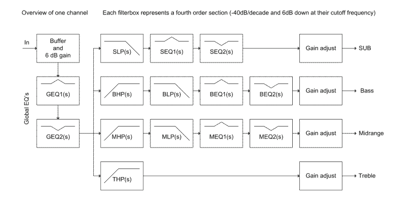

My idear for an active xover
Hi all,
I have made a plan for an active xover, but I need to make sure that I have included all I need for a flexible filter.
Please see the pic and comment on it.
It's a 4 way filter using 2 global EQ's and some EQ's in sub, bass, and midrange.
Thanks for any input.
Jens

Re: My idear for an active xover
Complete -- except maybe for time delay -- but very complex... you are going to have a little city of op-amps (or other active devices).

Delayline
Well, I hope to make a digital version when I get my hands on a DSP eval board.
Here it would be easy to make the delayline.
The transformation to DSP is not to bad once all the analog math is done.
Is it ok to use dual opamps? or even quad?
\Jens
