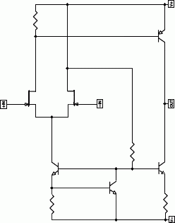

Please don't provoke the Pass person here....
I think Mr. Pass's design is safe for a while longer as this not the basic discrete transistor topology referenced in the manual. The very ambitious can look at the DIY op amps article on the PassDIY website. Correct BJT transistor selection and compensation is a must. A recent attempt to piece together some parts from some Mr. Pass's designs as an "educated guess" as to this op amp design, resulted in an extremely unstable design that looked as if it had never been simulated much less built. You just can't throw together parts for a high bandwith feedback operation amplifier circuit, even if it only has a half a handful of parts. I really recommend building and measuring, and even listening to them before you post circuits, even after you have done a lot of Spice simulation. I have seen some stuff that might work in Spice but that would go nuts driving an actual interconnect of a few 10s to a few 100s of picofarads of capacitance.
As Grataku said
"Hey Fred, what's going on in this thread?
Is an discrete gain stage schematic coming or is this it?"
I could swear I posted such a circuit recently but can't remember just where exactly............
Getting old and foggy is a pain. Maybe someone else saw it or perhaps I imagined the whole thing. Maybe one of you young whippersnappers can figure it out.

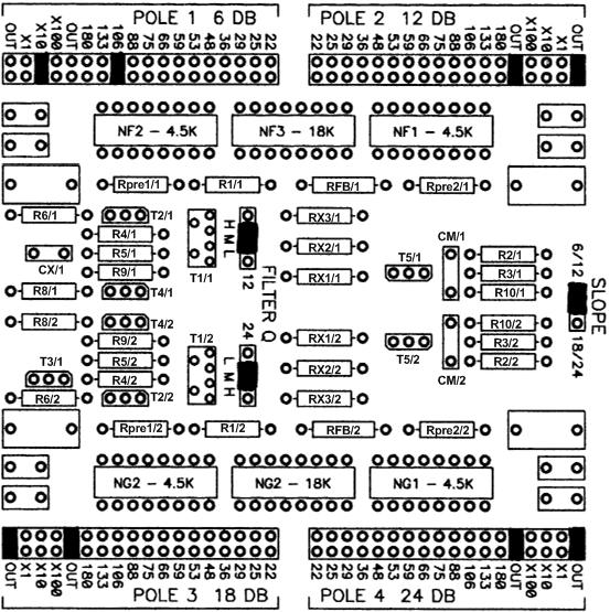

Passing past Pass...
The opamp design I posted here meets two basic requirements: that the number of elements it contains is equal to that shown in the XVR1 manual and that the opamp functions properly based on that design. The picture below shows an experimental implementation of the design, which is a pretty good approximation of the topology that was most probably originally used by the Passlabs. It has been tested properly and works fine (e.g. one of the tests included loading it with a 50m mogami cable that was terminated with 100nF, which showed no partial instability or any oscillations). To avoid any misunderstanding, I would like to point out once more that this is not MY design. It is an educated guess on the Passlabs design as shown in the XVR1 manual, containing an approximate number and quality of the elements that were used in that manual. This closes my reverse-engineering efforts with regard to this particular design as I think I now have a pretty clear idea of how the thing works and have satisfied my intellectual curiosity. Whereas I do appreciate Fred's interest and comments, it seems rather pointless to continue this little 'I-dare-you' game started by Mr. Pass in the first place, since he has shown no intention of giving us feedback as to the validity and quality of our assumptions regarding HIS design and no one else except Fred and myself seems to either comprehend or care about this subject enough to join the discussion.
Regards
P.S. Other designs to fry...
Regards

Re: Passing past Pass...
If you post over in the PassLabs forum, you have a better
chance of getting a response, as I only check here sporadically.
Also, what's to say? The XVR1 owner's manual has the
simplified schematics, and if you can't fill in the resistor values
from there, I refer you to the DIY op amp article, which pretty
much covers the rest of it. As stated before, these are simple
Sallen Key filters with variable everything. How you set up the
variability of the filters and the gain is your decision.

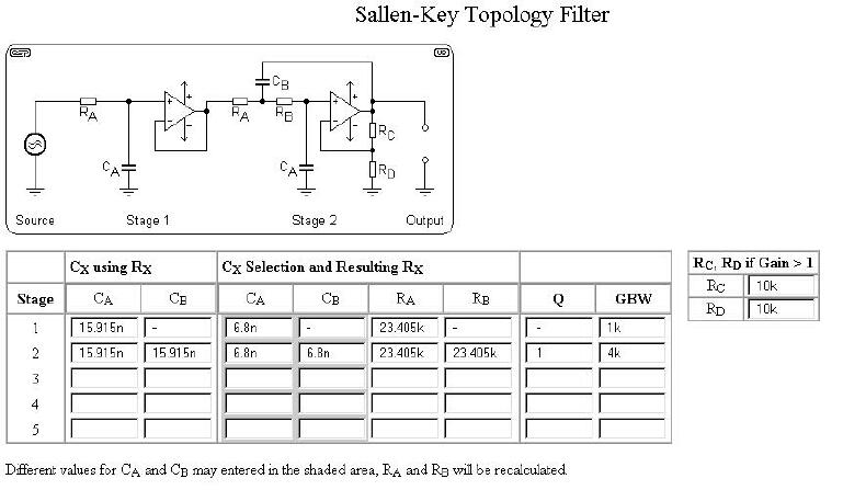

For information on the Linkwitz-Riley crossovers:
http://www.linkwitzlab.com/filters.htm#2
http://www.linkwitzlab.com/filters.htm#3
For those that want play with an online filter design program to do Butterworth filters:
http://beis.de/Elektronik/Filter/ActiveLPFilter.html#Parameter

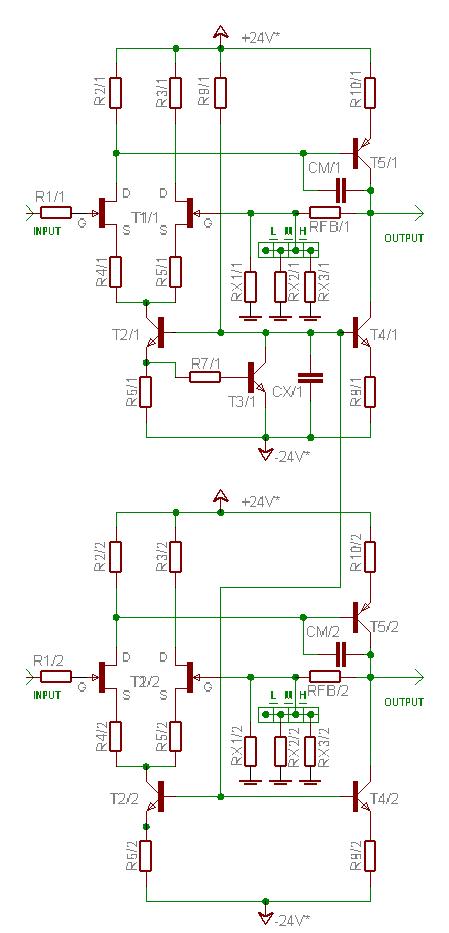

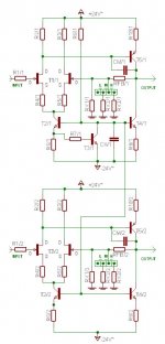

moamps said:
Mods,
would you please replace the old schematic I posted 5 posts earlier with this one. You can then disregard this post.
Regards
Done

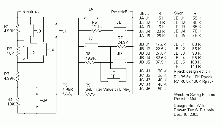

Some guy named Tex sent me this schematic for Yet Another Resistor Network. I think he felt sorry for me after my initial efforts. This spin of the Y.A.R.N. has 26 possible crossover frequencies for each capacitor in the capacitor matrix (actually many more if you parallel two or more caps in setting the capacitor matrix jumpers) It is programmed with two dual row 10 pin 5 position 0.1 inch pin headers and two jumpers*. JA to JE are for the coarse adjustments and J1 to J5 are the fine tuning settings. By changing A to C to D to E jumper positions and then sequencing the J1 to 5 jumper for each letter jumper chance you can go from 5 K to 100 K ohms in 5 K steps for twenty frequencies with a very easy programming sequence**.
If you care to change both the A B C jumper and the 1 to 5 jumper for each step you can go from 15 K to 40 K in 2.5 K ohm increments. The programming for this mode is more convoluted and is only for super fine turning after the simpler 5 K increment sequence. You should be able to dial it in very close to the exact frequency you want with a few values of capacitors in the capacitor matrix.
R9 is a DC path for the gates of the jfets in case all the jumpers get pulled. A couple of terminals across R9 will allow you to temporally wire a pot in place of the resistor matrix if you want to do some quick tuning. ONLY the J1 jumper will be installed. R5 will prevent shorting the circuit at the minimum setting for the external pot. Disconnecting the pot after the desired setting, measuring it's resistance and adding 5 K ohms to the resistance of the pot will allow you duplicate the setting with the resistor matrix where it will stay put and not get bumped by your children. Alternately purchasers of preposterously priced parts can solder the correct value across the resistor matrix inputs if two terminals for this are included in the PCB layout. This will allow one to bypass the resistors and jumpers after the desired setting and corresponding resistor value is determined. R1 to R5; R7, and R9 can be replaced by SMT R packs if space is at a premium in the PCB layout. Several resistors in parallel allow the use of standard values more easily available resistor pack. There are no shared R packs between filter sections and that should ease the PCB layout a bit.
This circuit is public domain
and it's use by anyone who wants it is encouraged (yes even him......) And yes, I am sure about that! Tex told me so in his Email, or I would never post it. He assured me that he has no intent of changing his mind.
* Allowing one to hold the jumper in one hand and count the fingers on the other hand. BTW There is absolutely no truth to the rumor that one must remove both shoes and socks to program the Passlabs unit.
** i.e.. B1 B2 ect. If you have trouble, and you grandma plays Bingo, she can explain it to you if a jiffy.
