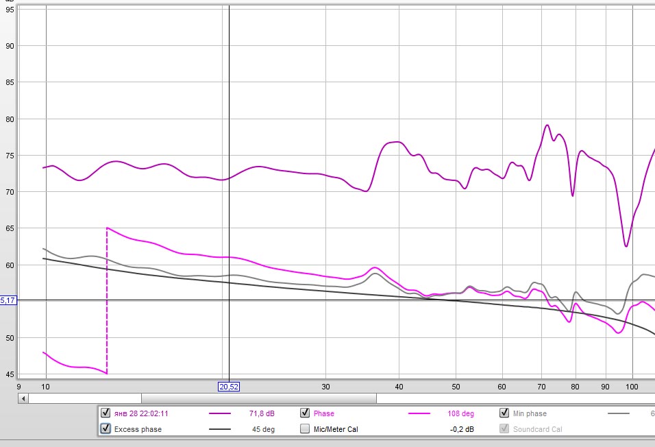

With quick and dirty DBA problem was partially solved.
2 front subs and 2 inverted delayed rear subs. Double bass array Double bass array - Wikipedia
Mic position exactly as in previous meas.
Like this now:

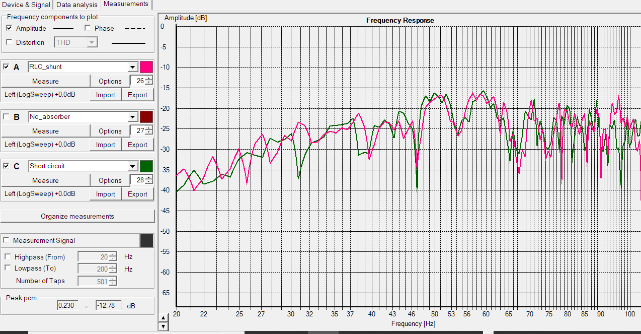

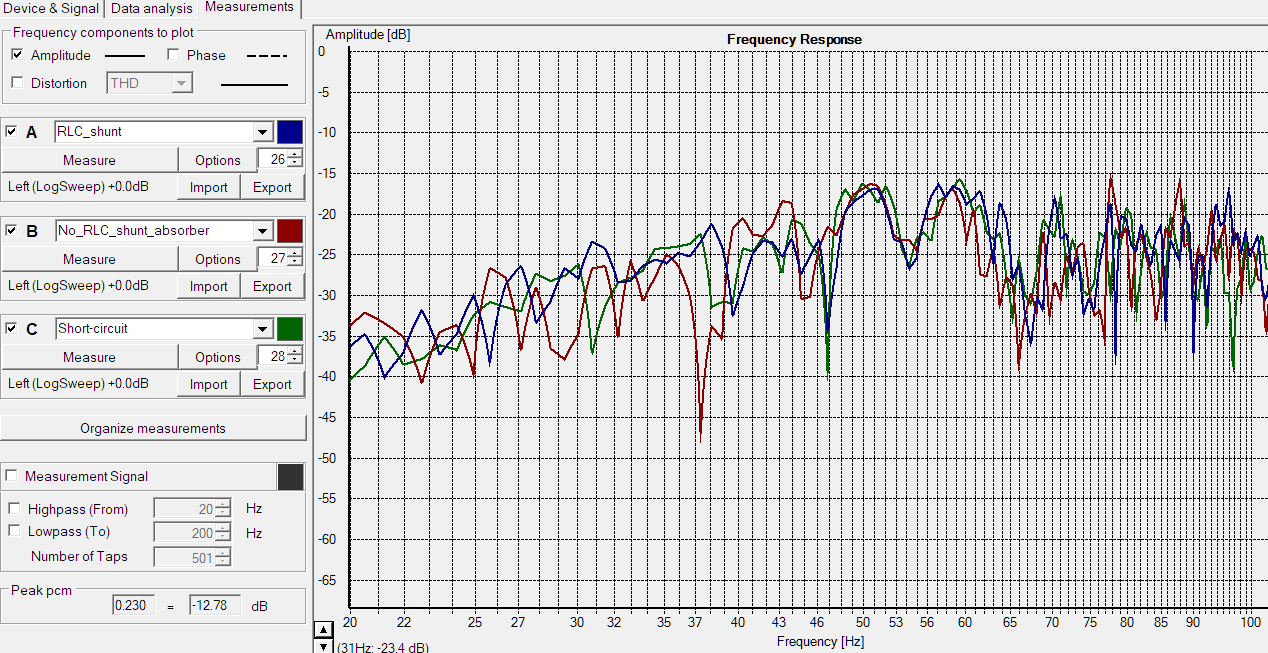

Got L=4.7mH, R=2 ohm, C=470uF and did another set of measurements:
1. RLC_shunt vs. Short-circuit vs. No absorber
2. RLC_shunt vs. Short-circuit (for better visibility)
I would say that both short-circuit or RLC shunt look better than no absorber. And RLC shunt has a little margin over short-circuit as two dips look better. This is only measurement, I will go on listening the RLC thing too see if I can hear a difference.
