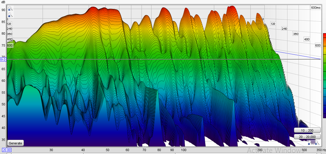

I would advice to zoom in the waterfall between something like 20-350 Hz and use 5 dB increments...
even if it looks not so smooth, it sounds really good. And those two continue "blades" at 80 and 160Hz are just external noise from an UPS generator.

Computers are noisy environments. I've had issues at that frequency. Depending on what I am doing, sometimes it will show high in magnitude, sometimes it will vary from shot to shot as if taking an instantaneous value within a cycle.
