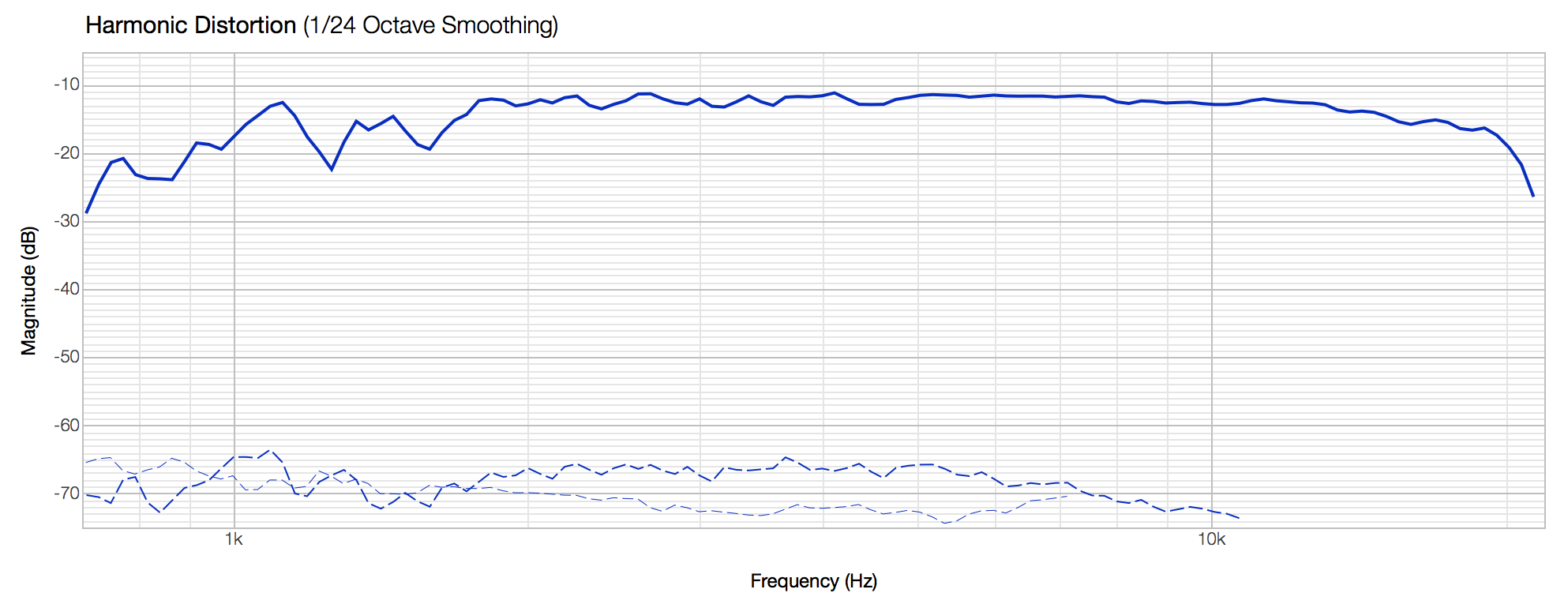

Not too dissimilar from my measurement. This means that filter, original horn in front and large closed box behind is the best loading of this transducer. I was lucky to try that first, but I also gave it a thought (and there is my bias against dipoles for anything except bass)
The horn on both sides look better IMHO.
Above 2khz yes but you lose a lot between 1khz and 2khz.
How low do you cross it?
This is the response of my horn with the back cover that I designed. Similar to open from behind.
Thanks for sharing this. I see your measurement also displays the trough past 2.5 and 7kHz. Mine was centered around 6kHz and yours is around 4.5kHz, so not exactly the same but directionally the same.
By the way, are your measurements indoors & gated?
Your measurement of the double horn & double filter looks great! +/-1dB from about 1.8 to 12kHz. I see you also measure the 4dB drop at 15kHz.
Your last posted measurement shows your horn and filter open back, showing +/-2.5dB from about 1.6kHz to 13kHz. Yours is flatter than my Beyma horn with your filter, but the Beyma is +/-3dB...not bad.

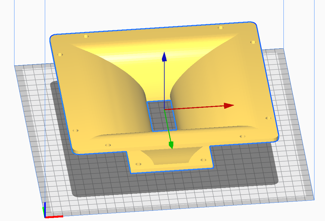

I'm going to start posting the STLs.

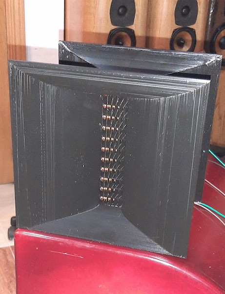

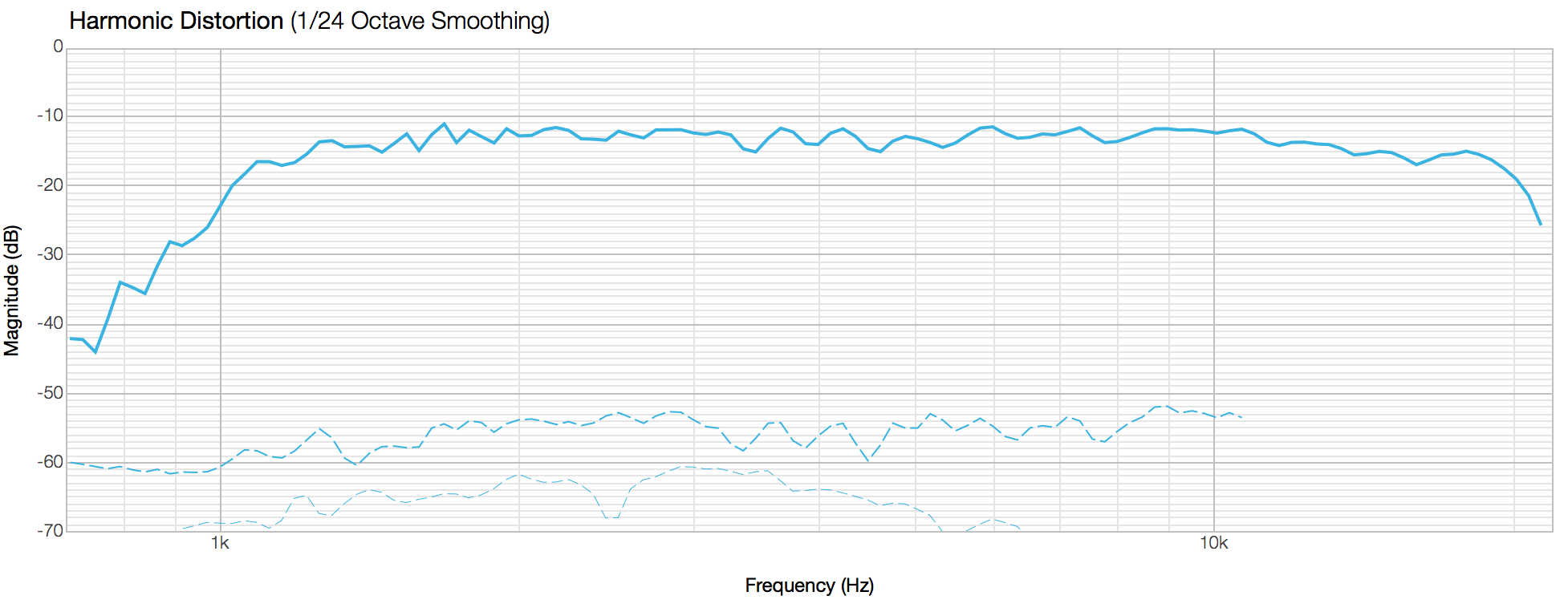

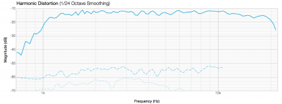

There are 3 optimal options.

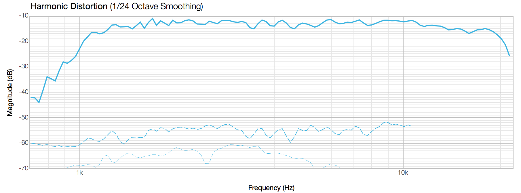

First: The original Beyma horn with TPL-filter. The rear part with a large chamber, similar in dimensions to the trumpet. An enclosure measuring 23 x 23 x 23 cm or larger. This can be valid for active speakers with a 6.8 uF capacitor in series to protect the tuiter.
The distortion values are not valid to compare the different options because they are made at different power and gain of the sound card.

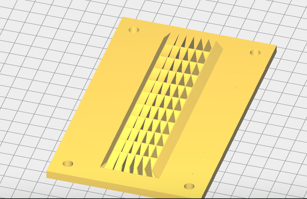

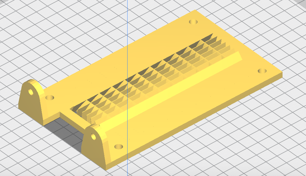

This is the STL of the TPL-150 filter.

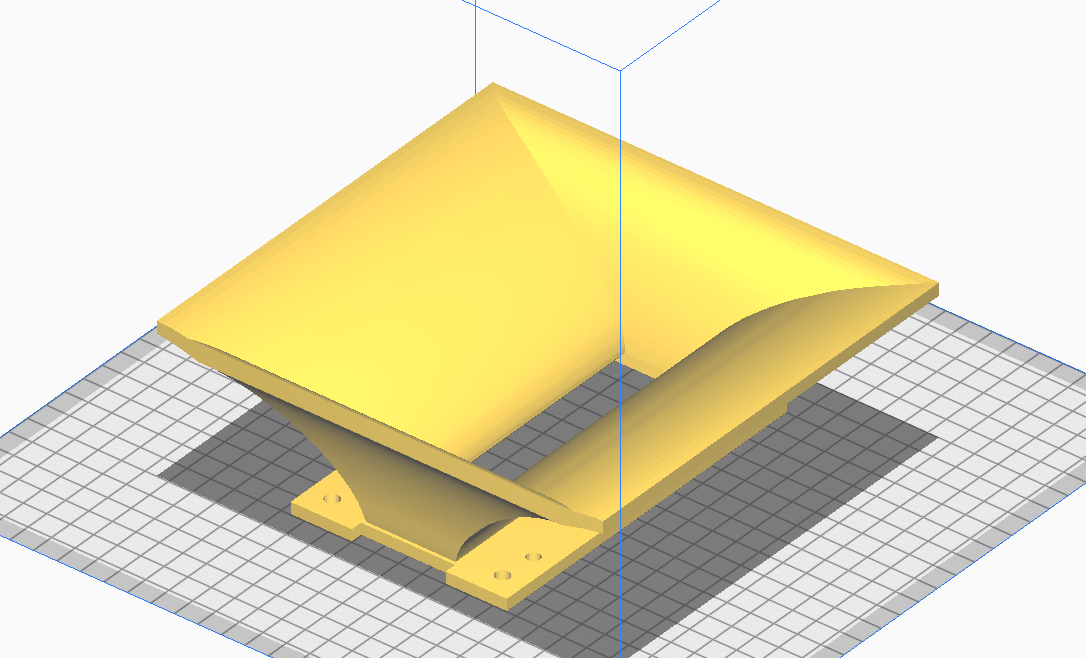

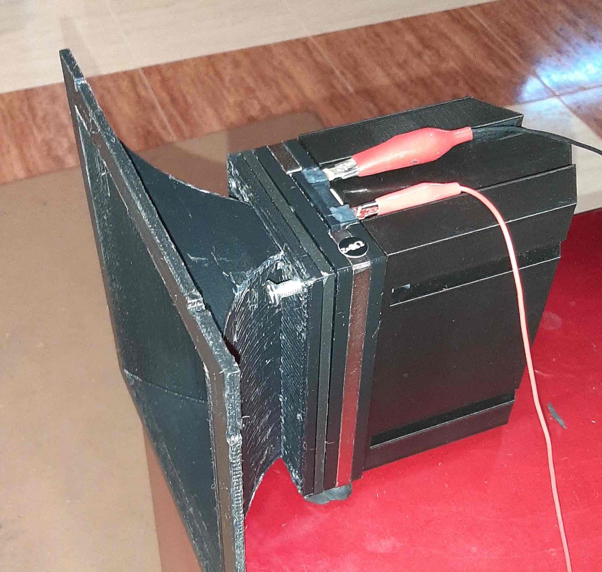

The tractrix of the same size as Beyma horn 23 x 23 cm, with less coloration than Beyma horn, in the same enclosure. This does not need a capacitor for the response to be flat. Is valid for passive filter or active loudspeaker without capacitor.
With the same TPL-150-filter. Complicated to print because it is 23 x 23 cm.
Tractrix to place above the speakers. It can be big 18 cm or small 16 cm. They are similar. but if you want to cut at 1000Hz, Big is better. These are the TPL-150-Rear filters because they allow the terminals to be left free. And allows to hold the speaker.

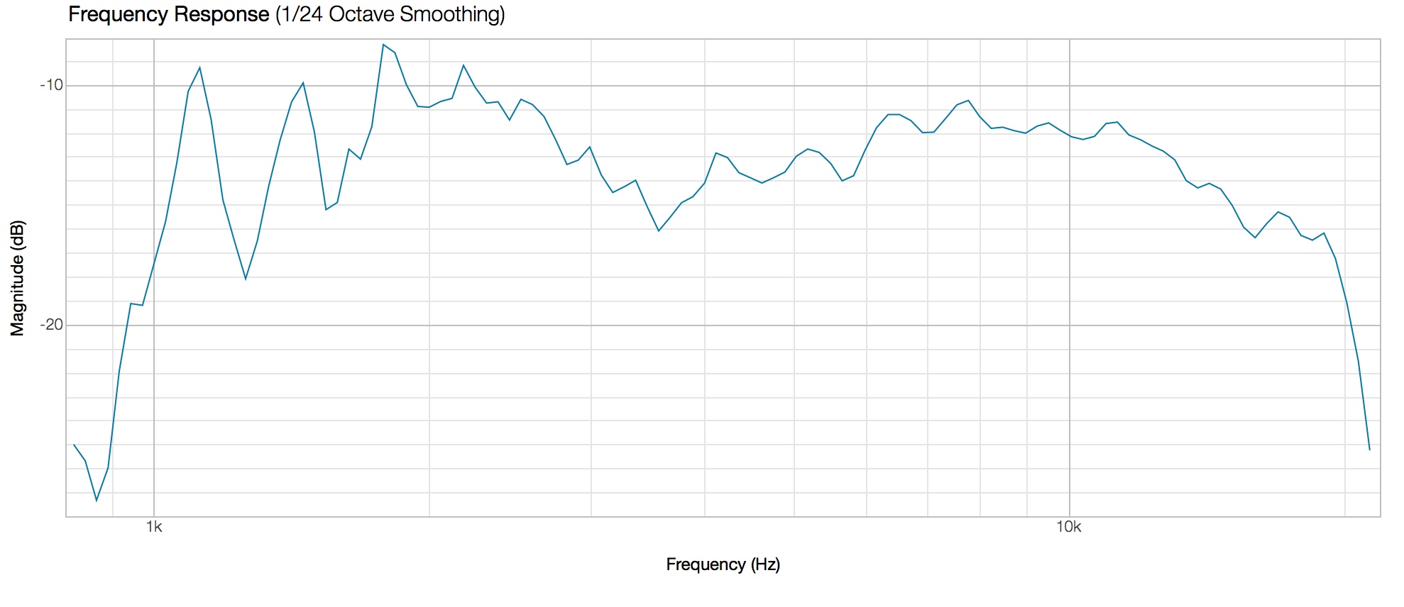

There were some measurements somewhere showing resonances below 2k for the TPL150 but I wonder if these are not audible since many are crossing much lower?
They are not resonances below 2 Khz. They are cancellations. The resonances are when the energy accumulates and is returned prolonging the duration of the response in time, it is audible and annoying. This is not the case.
This case is cancellations because the horn is on top of the speaker and the horn is short for 1000 Hz. Cancellations are not audible. But if you don't want to have those wave cancellations below 2KHz, the tompet should be placed inside the speaker rather than on top. Or if it is on top, you have to put a panel that makes the surface of the trumpet larger, for example 34 cm wide, good for 1000 Hz.
This weekend I will put a panel, take photos and put the measurements. So that you can understand me.

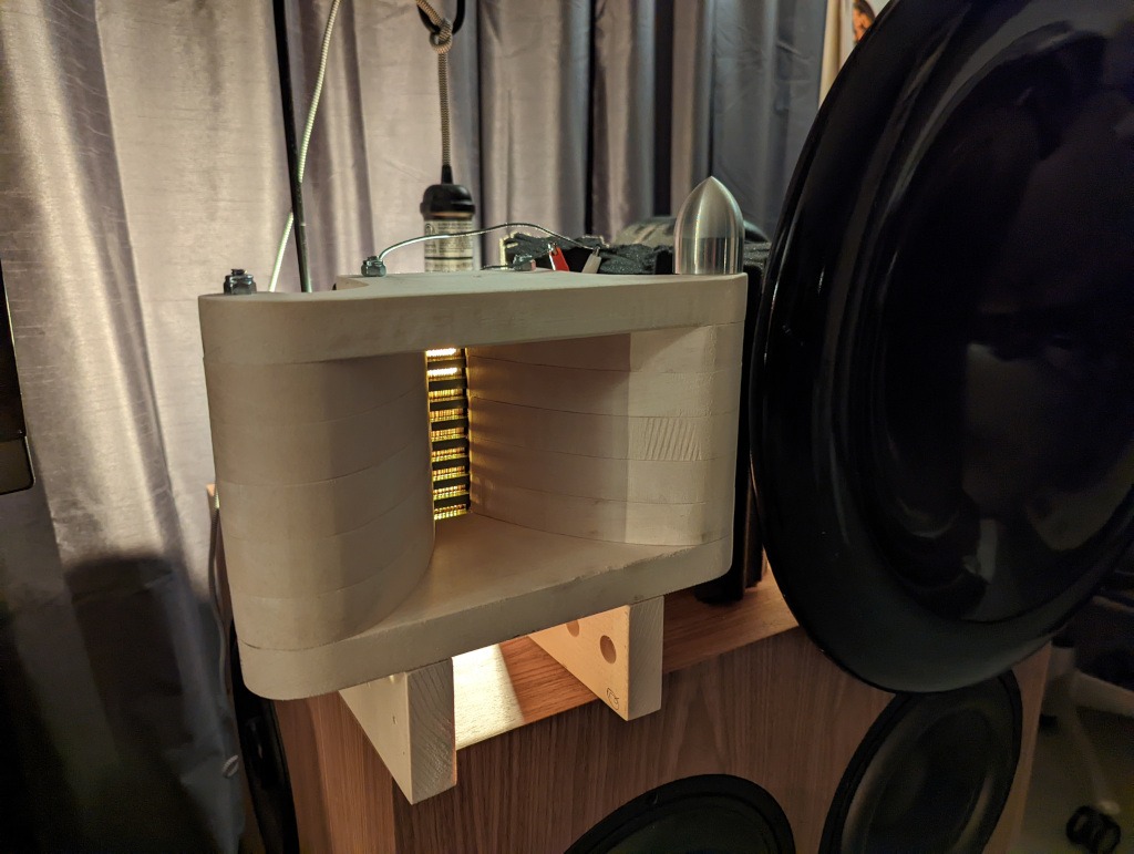

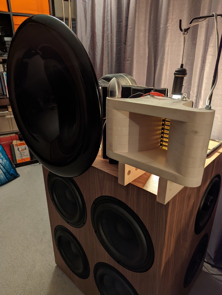

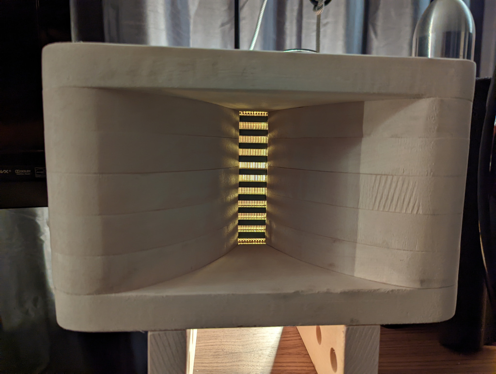

Thanks Oneoclock. The problem I have had with TPL150H is sibilance around 8K. A notch at this frequency helps but I would like to have a proper solution for this.
I have used the tpl-150 in horns for some times in the past and around a year ago switched to compression drivers because there was something bothering me with the TPL. I don't think it's the 8khz peak by itself considering I get rid of it in my active crossover/eq (deqx).
This weekend I reinstalled the tweeters temporarily and tried to find a solution and it brought me to this thread. That acoustic filter caught my attention.
My main concern have been a slight peak of high frequency directly in the axe and a sharp decline when moving couple inches from the sweet spot. This would change the presentation and tonal balance slightly when moving and annoyed me over time. I recently fixed part of the problem removing the back charge (I had symmetrical horns front and back in dipole configuration) while moving the tweeters back from the wall. Removing the rear horns helped a lot, I should had tried this before. Now I have the back open shooting to the rear wall where there is some absorption, seems to work better than absorbing the back wave close to the tweeter.
The other concerns are more about a small feeling of compression compared my compression drivers, the lower efficacy compared to my usual 113db may simply be the cause of that.
I still really like the relaxed and aerial presentation of the TPL with horns and would be interested in finding a solution for the tonal shift when moving from the sweet spot.
Would you say that using those lenses reduced the directivity of the 8-10khz and up a little bit ? when using or not using the acoustic filters, do you get more constant tonal balance when moving from direct axis to off axis, kind of a switch in balance while moving your head left to right ?
I have a hard time describing it, it's not a phasing problem but it's similar to the feeling I had using large electrostatic speakers like my acoustats or quad esl-57. My esl-63 didn't do that, the 57 did it a little and the acoustats were horrible in that aspect. I feel a little bit the same with the tpl-150. I don't remember having this feeling with my great Heil.
My test horns have JMLC expansion and are maybe a little big for the crossover point I'm using. I normally switch from my mid horn, to the tweeters at around 3khz. With the TPL I go as low as 1.8khz without problems, they don't have the energy of my mid horns but do quite well that low.
Based on your experience with the acoustic filters I could be tempted to try it and maybe find a way to return the TPL in my system.

Hello Frank.
I have not found any directivity and side lobe problems horizontally +- 15 degrees. But if it has directivity and lobes when it loses 20 or more degrees vertically.
In photos of your speakers I see that perhaps your TPL points a little low. Simply pointing 10 degrees up would improve.
In my opinion the biggest problem with your trumpet is not making an exponential curve vertically. That will cause problems at 10 degrees or less.
I would recommend an exponential lowering of the wood (2 cm.) at the top and bottom, plus a tilt of the speaker, or a slightly higher position.
If you want, I have several more trumpets that I have tested with and I am going to throw away. I can send for you to test as long as you pay the shipping costs which can be around € 10-15. I would be interested to see your result whit this.
