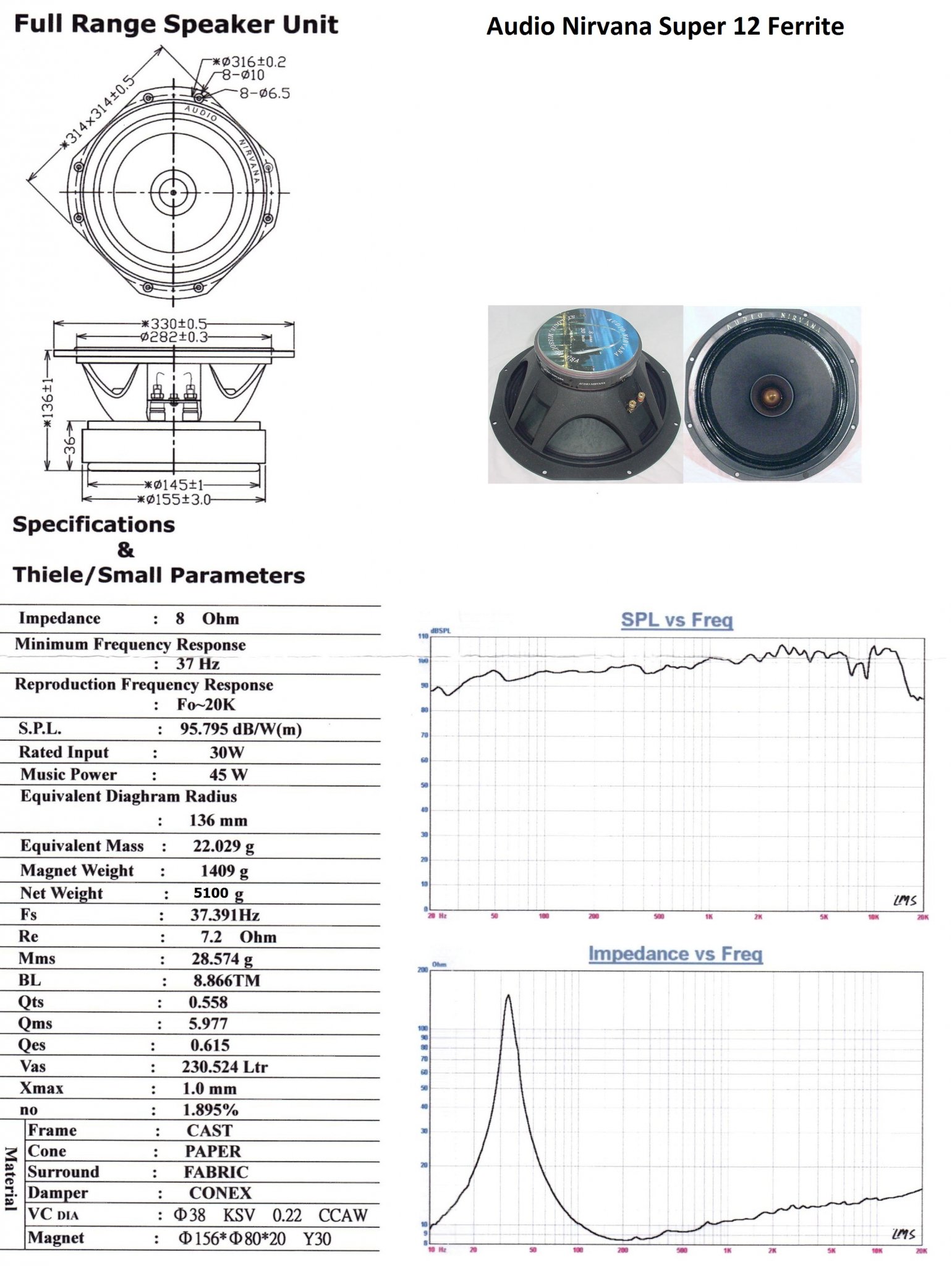

I have a pair of full range Audio Nirvana Super 12" drivers (ferrite magnets). I adore their outstanding soundstage, coherence, and vocal presence, but am not too thrilled by the sound signature of the bass output. Furthermore, some music I listen to requires powerful sub-bass, which the drivers can never reproduce with authority. And so I was thinking of using a pair of hifi bass drivers that I had laying around. I think I will run them parallel to the woofers, crossed in around 80 Hz and biamped.
Some specs of the Audio Nirvanas. I've attached the specsheet (and VituixCAD files) for your convenience.
Nom. imp: 8 Ω
Fs: 37 Hz
Re: 7.2 Ω
Qts: 0.558
Qms: 5.977
Qes 0.615
Vas: 230,5 L (0.812 ft³)

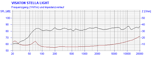

I manage to find that Visaton project with series 1st order xo, from which I made the conclusion about total impedance closer to 4ohms. Its Stella Light.
Two 8ohm drivers, but nominal impedance is given as 4ohm. If you check the impedance plot, slightly under 200Hz impedance drops to less than 5ohms. So, in real life series 1st order may give lower than usual system impedance.
Stella Light

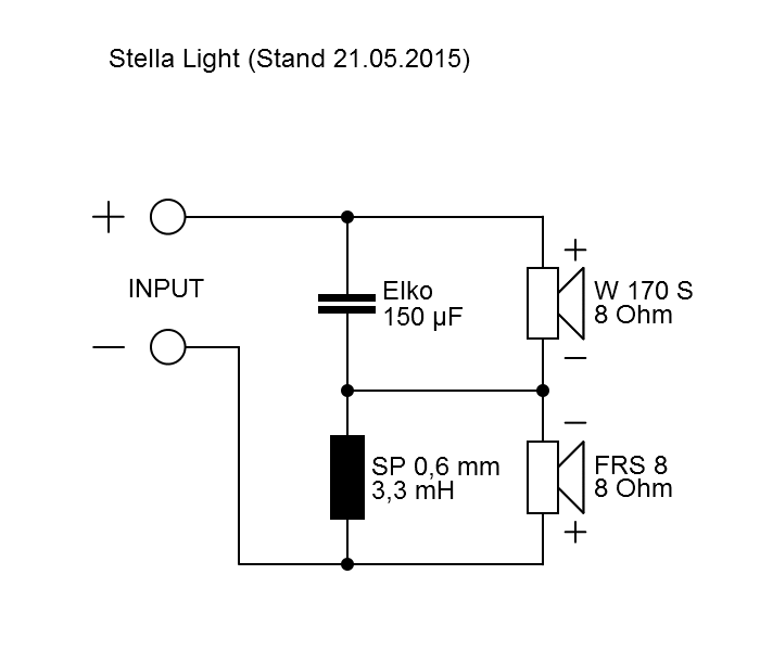

In a Series x-over an inductor is in parallel with the FR and a cap is in parallel with the woof and all of it is in series.
I needed that extra bit of information, thanks. Assumed a series crossover meant 'a cap in series with the woofer'. I will give this a try, I have some parts laying around.

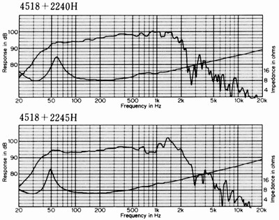

I found measured response of 2245H in a JBL 4518 enclosure
and attached PDF datasheeet

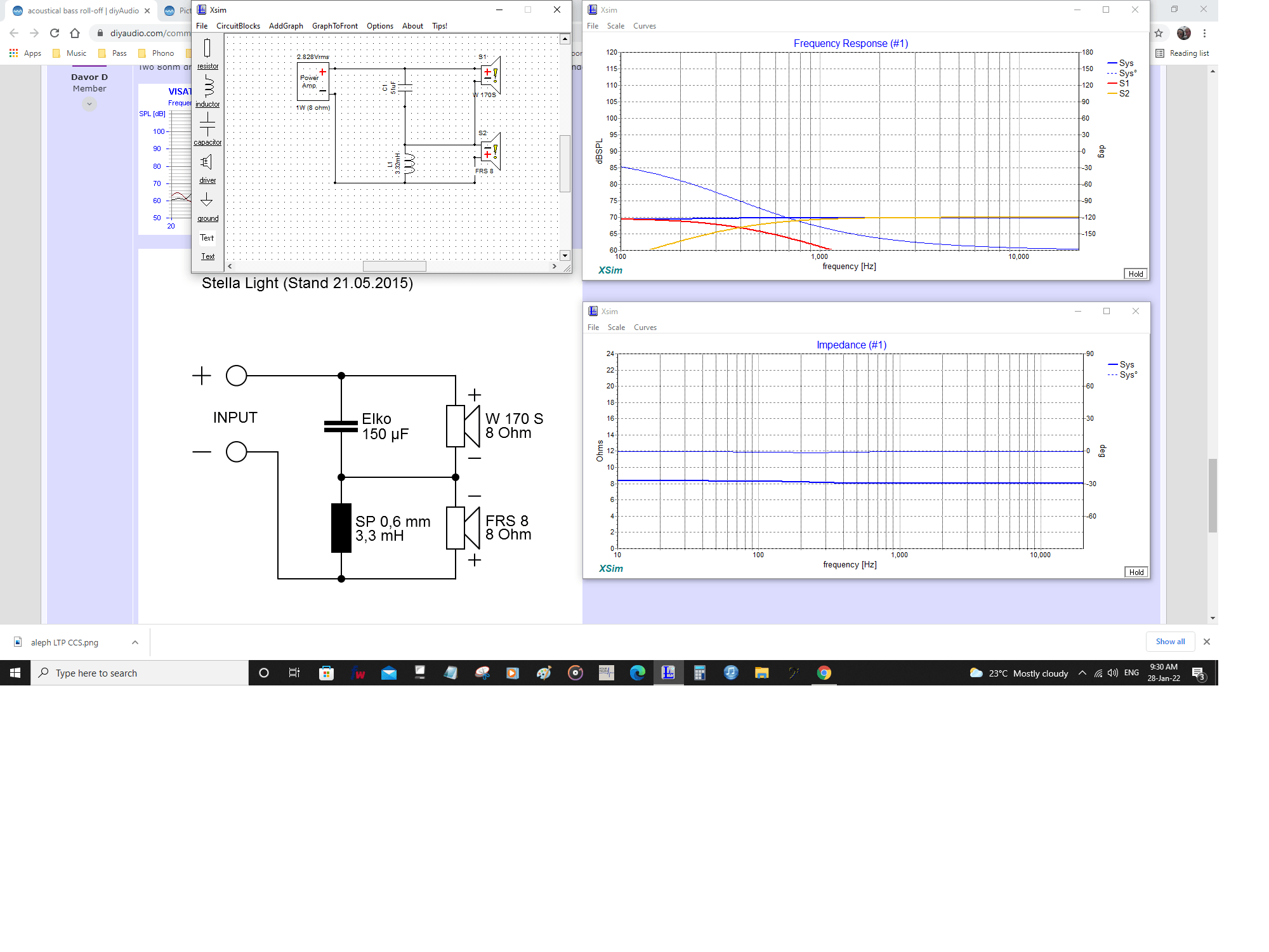

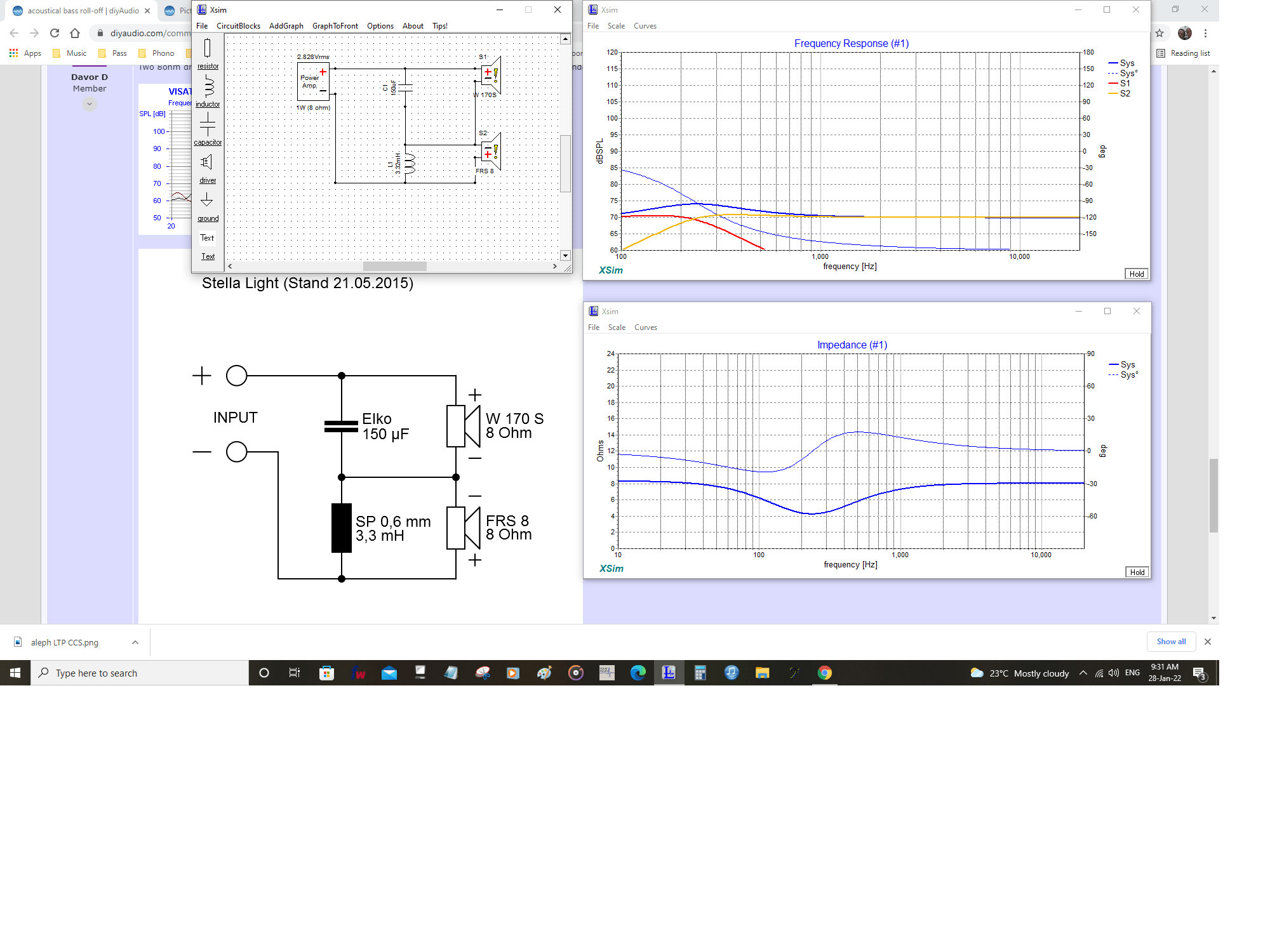

Bad example.
Stella Light has a pretty awful xo with a lot of overlap, the FR is connected with the wrong polarity and so on, see XSim simulation below, Untitled 1.
Just a minor change makes it look decent, Untitled 2.
