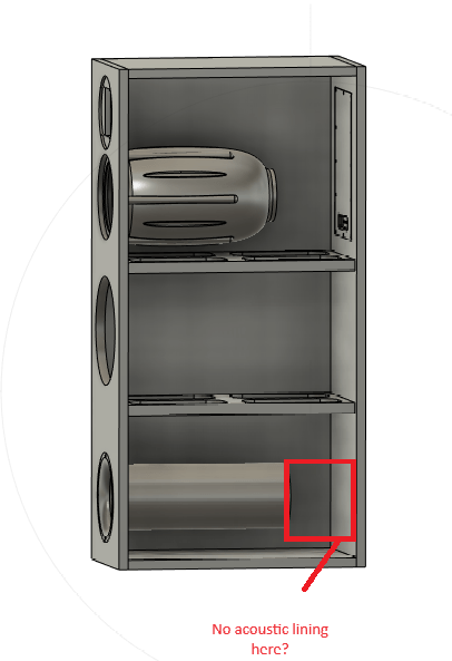

This is probably a very elementary question but I was unable to find a definitive answer so here goes......
Does the lining of the enclosure count against the enclosure space?
I know polyfill "expands" the enclosure space by making the "air denser"
One more elementary question since I probably already sound stupid......
Would it be ideal to keep any sort of lining away from the woofer port entrance on the inside of the enclosure?
I plan to use this SAFB material and it seems from the charts that the thicker, the better. I am pondering why anyone doesn't just go with the thickest material they can find. That is, unless it counts against the enclosure air space.

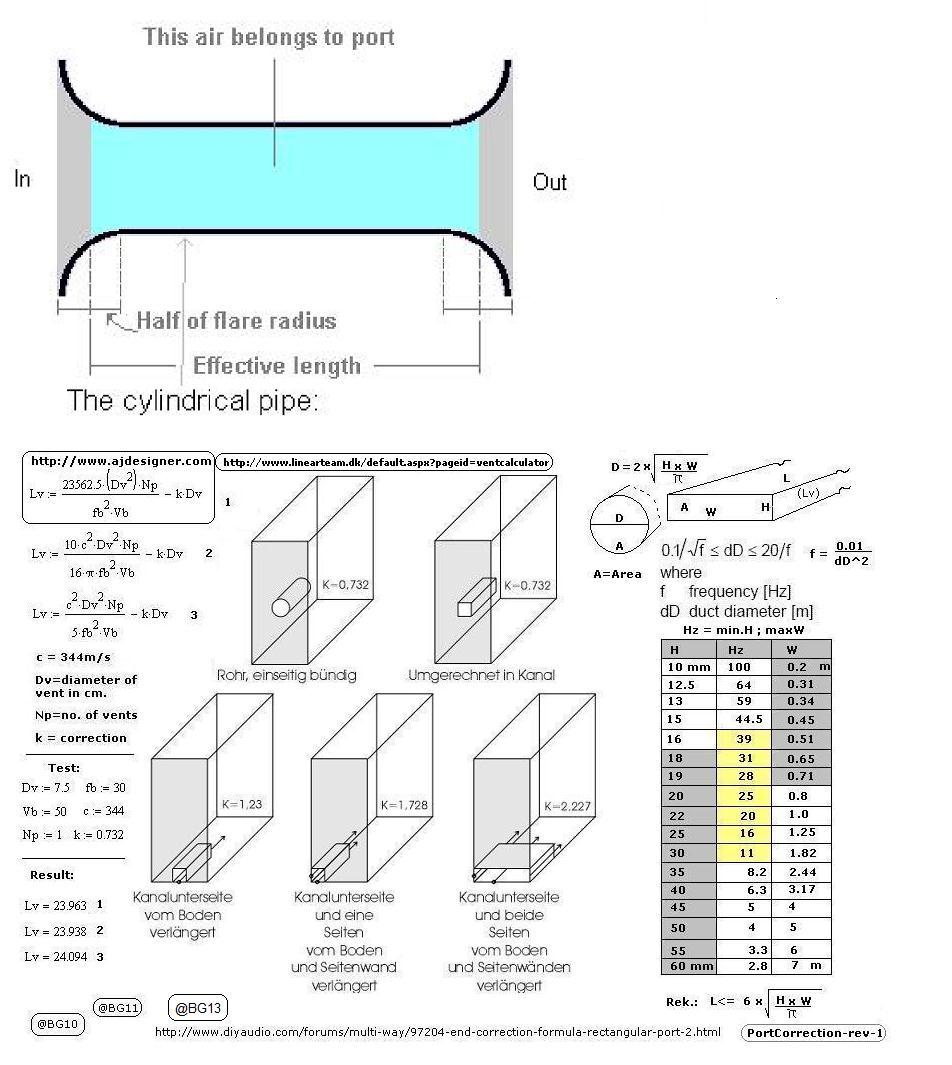

Lining, no, stuffing, your call. All acoustic openings have a pipe end correction based on its (effective) diameter (d) and any surrounding baffling, i.e. it's acoustically larger, so using the basic vent pipe k = 0.732d is good enough for a sufficient gap.

Acoustic Wool dampens the waves in the enclosure. To do so it has to be placed where the velocity is highest. And that is close to the driver.
Most useless is to place wool close to the wall! over 90% of all speakers i have seen has wool placed close to the wall where it is totally useless. Pressure maximum is close to the enclosure wall and velocity is zero. Damping maaterial works as a friction brake for the air molecules while moving. No movement = no friction. There is actually papers written about this in the 70ties. And there is some loudspeaker engineers/researcher who tied wool around the magnet covering the holes in the cage behind the mambrane, acting as a friction brake and as an early damping of the wave behind the membrane very efficient.

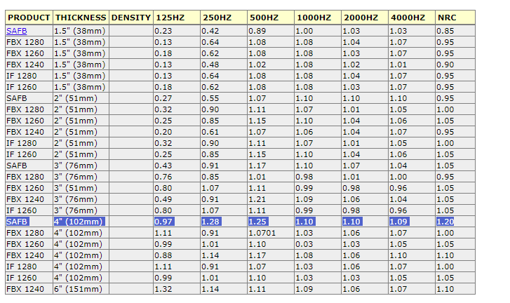

I find that hard to believe looking at this data here:
https://www.bobgolds.com/AbsorptionCoefficients.htm

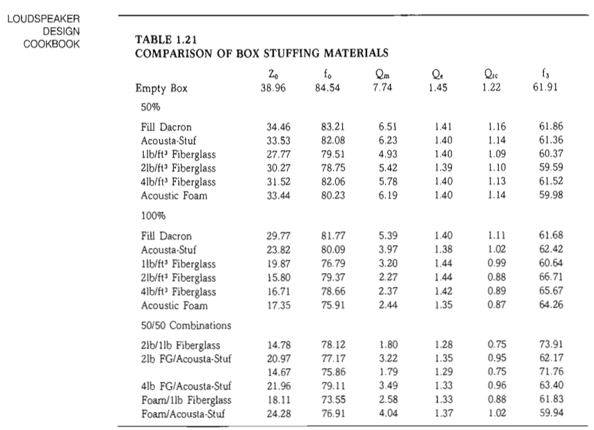

Both WinISD and Hornresp free software have inputs for box stuffing. It is very useful to just enter a design and adjust the stuffing amount and watch the response change. In Hornresp you actually see it damp out the internal acoustic box modes, which is why you put it in there. WinISD just shows the reduction in the output of the woofer as the Q goes down. Use the wizard in Hornresp to create a closed box design and go from there. On sealed designs I just fill the space with damping leaving room for the driver. On a ported design it needs more open space for the port to breath.
I hate to admit this but I have spent literally days trying to figure out Hornresp and I respect the program and all the work that was done but I am not smart enough to figure it out. I even wrote to Martin and reading the material he sent I came to the conclusion that I should not build a TL. I am concerned that I am going to screw up and create a unintentional mltl and hit the wrong quarterwave and end up with a speaker with missing bass. I am building a narrow MTM floor stander using seas w18nx001 and tc25002 millenium tweeters with a modified thor crossover. I got the combination to work very well in a small thor cabinet but need to go smaller and have a better built cabinet.
Unfortunately the user interface for Hornresp is not very intuitive. I can't find a youtube video that shows how to do the sealed box design with it. As an approximation, adding more damping causes the response to look like that of a larger box. Adding stuffing will making a sharp low frequency roll off into a more gentle rounded roll off. It will always lower the response curve, but it can push the roll off frequency a bit lower. It's hard to go wrong as you can always just remove some of it.
