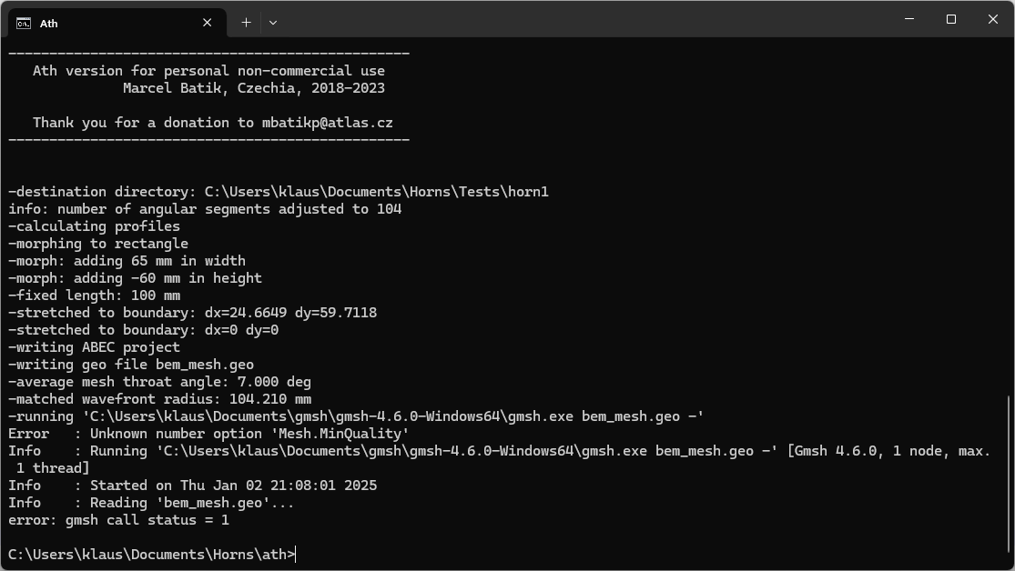

I get the same error message with your project. I would try the older Gmsh (4.6.0 is all I've ever used).

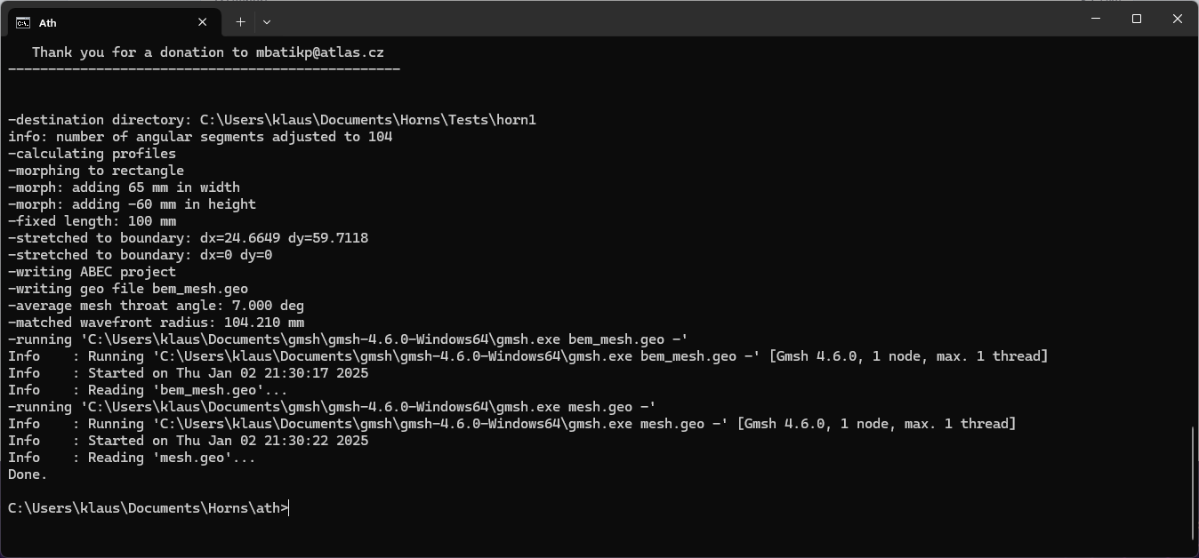

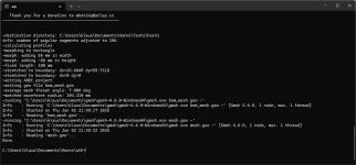

I downloaded Gmsh 4.6.0 an re-run the latest config file again. The error message changed, see attachment. ;-)

There's probably still a Gmsh config file somewhere, created by the newer Gmsh version, that the old version now tries to read and don't understand it.
Try to start Gmsh app and "Save Options as Default". The file is in C:\Users\...\AppData\Roaming\gmsh-options" in my case. Maybe you could also try to delete it first.

Thank you very much! Gmsh 4.6.0. is now working. but still the same error in ABEC3 when i try to open the .abec file. :-(
Furthermore I recognized that ath does not output the final height and width of the horn in the command line as I saw in your tutorial. Can this be a hint that something went wrong?
Can I get a newer version of a free ABEC3 version somewhere? I noticed you used ABEC 3 3.6.0 b7 in your use guide. Maybe this may help?

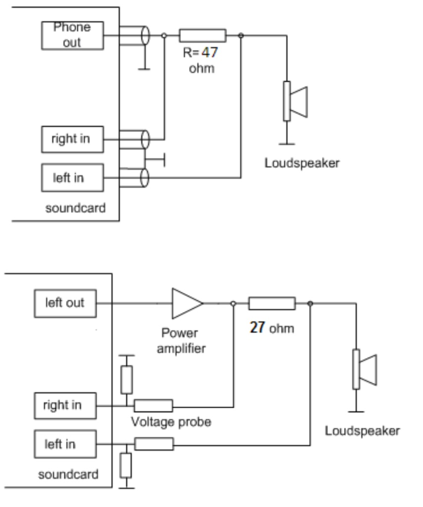

A parallel resistor can flatten the driver impedance to a large degree when using an autoformer. Also it is possible to use a tapped inductor as both a crossover component and the autoformer. For example a second order filter will have an inductor between the driver and ground. You can tap some off the shelf ferrite core inductors by unwinding some of the wire and adding a tap.
Have you also lowered the resistance in the measurement rig?

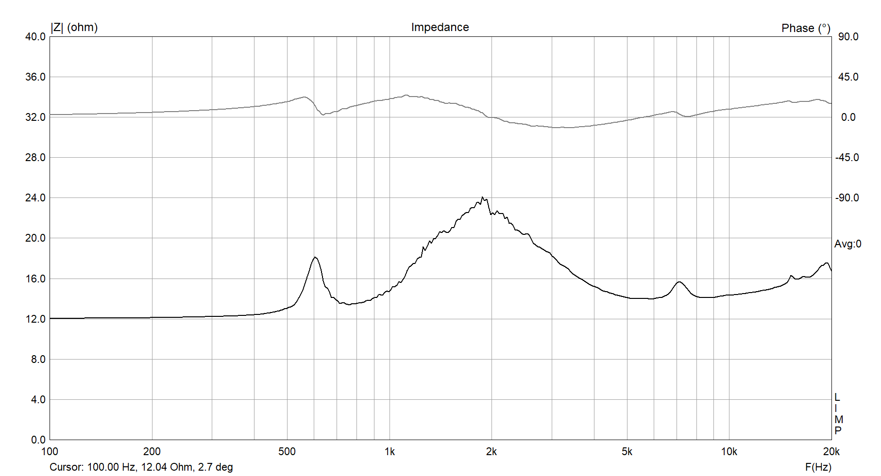

- It's an interesting topic for sure. As I understand, to eliminate the effects of driver+horn acting as a microphone, we would need as low impedance as possible connected to the driver, right? Can't think of anything lower than a directly connected solid-state amp, what always remains is the voice coil itself. Is there a way how to quantify the effect then? What does an autoformer do in this regard?
But maybe the first question should be is it actually a problem at all? I saw a lot of such "noisy" impedances of horns on the web but nobody ever paid attention to it, which I found strange but until now I had no own experience. So what's really going on?
