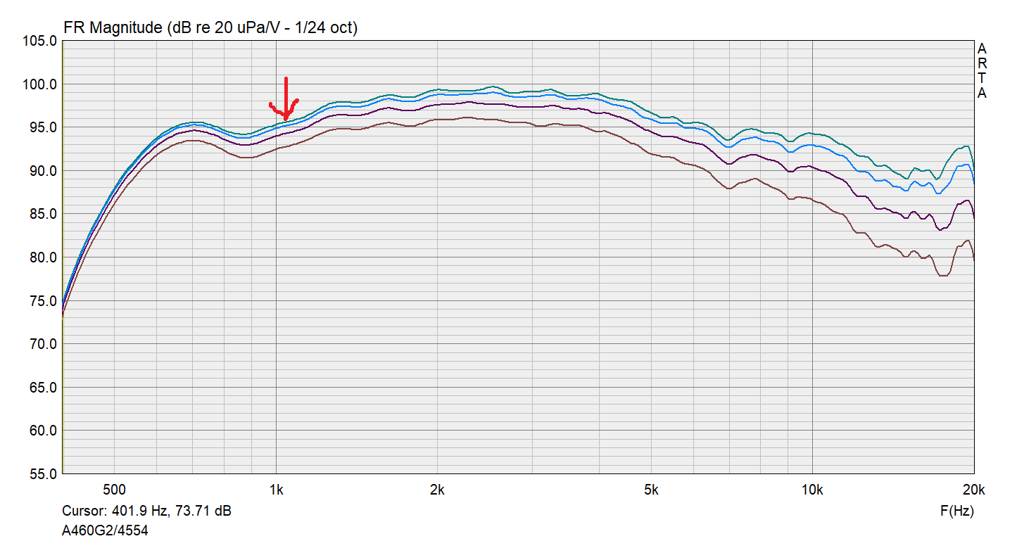

I see that now, probably was a little too tired. Just trying to discuss what the differences could be, not trying to critizise your work!:To me, smooth means simple. The less is going on regarding the radiation, the better. We're talking differences on the order of 1dB here (or even less), but it's obvious that there's something more going on in the case of 460 at least between 1 - 4 kHz; it's more complex, less smooth.
The polars shown were not taken at the exact same places, I just don't bother at this point. Actually, the radiation patterns of both should be virtually identical (i.e. including SPDI) down to 600 Hz or so.
The aspect ratio of the screenshots is a little different, the A460G2 being taller, that will not change a lot but will make small difference, the ripple will seem bigger in comparision.
I have found that a little different microphone positions and/or different windowsizes can have quiet an influence on smoothness. I do not know your process of measuring the DUTs but that might have intoduced the ripple.
I am not sure maybe it is due to the different aspect ratio or different mic positions but the A460 seems to be a little wider...

What I think: the wiggles start after a depression of the response compared to the 520 at just above 1 kHz. This extra energy causes the ripples. Whatever causes the depression of the frequency response, it kind of 'squeezes' this energy up into the midrange. Maybe it is just diffraction hitting there, idk.

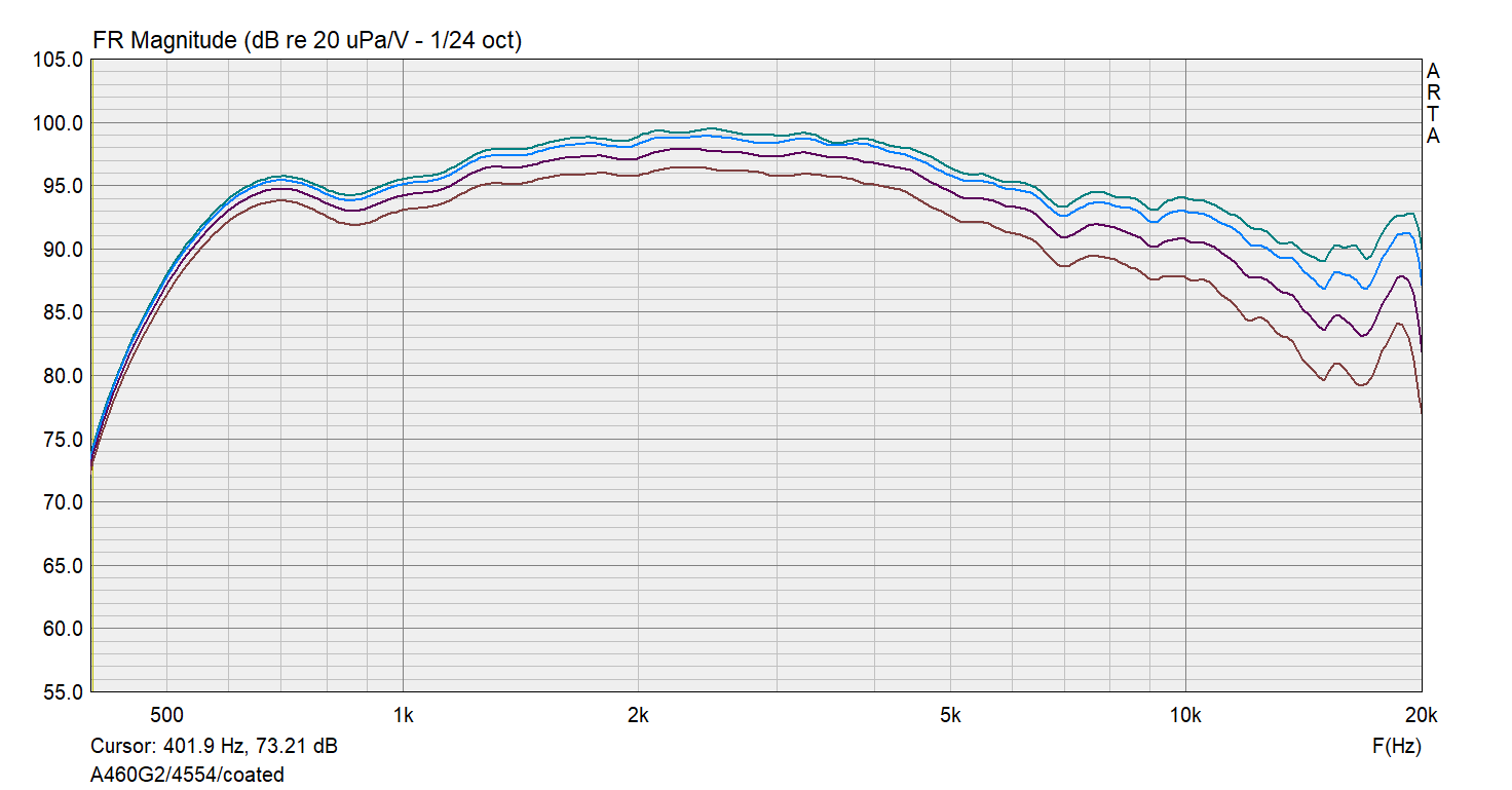

Epoxy coating anyway. Since I measured a big increase of nonlinear distortion of a non-sealed printed adapter, I don't trust anything.

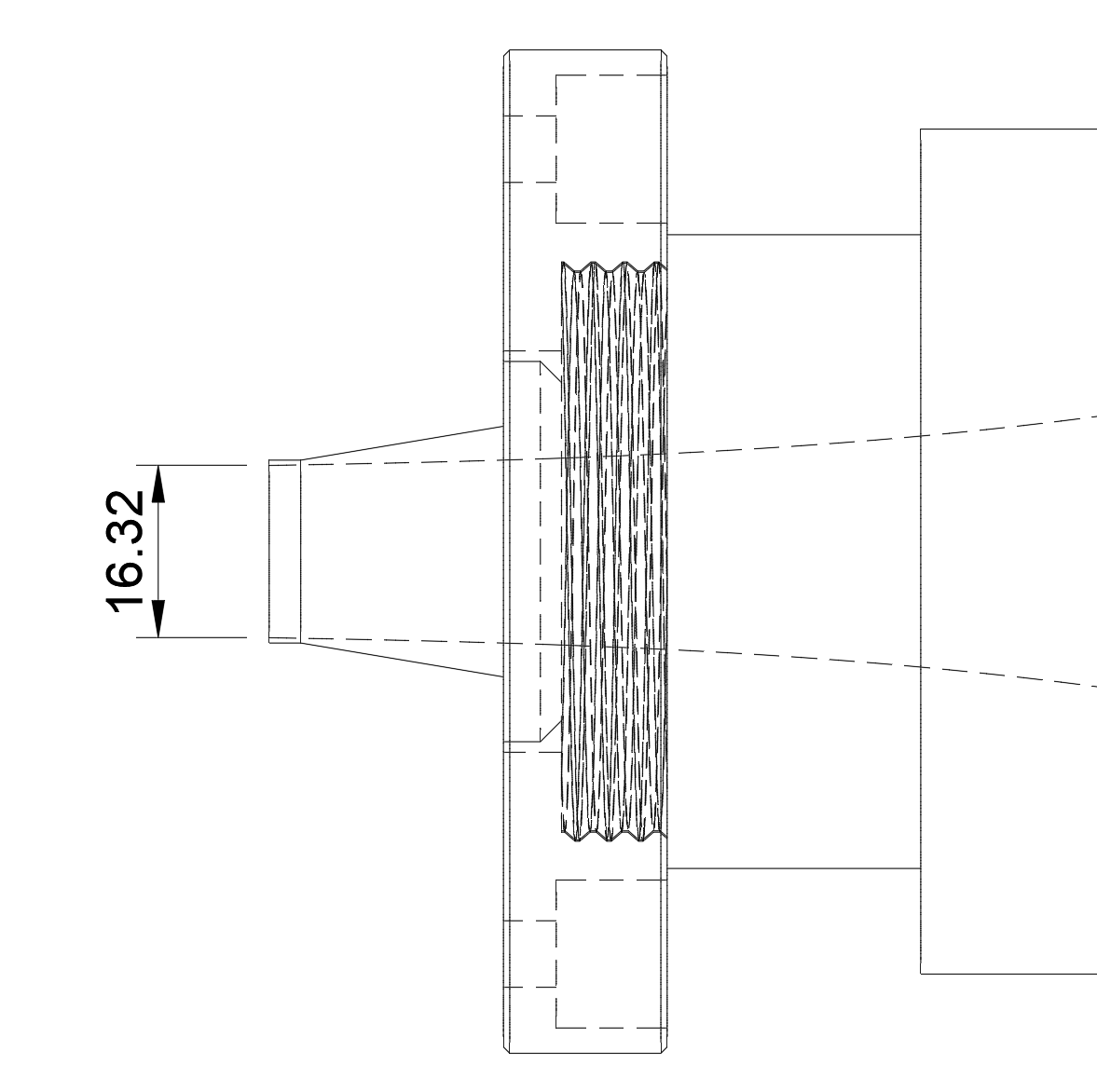

alex6679 and me had some discussions. Basically we have an idea how to let a adapter start in the DCX464 closely after the HF diaphragm without mechanically destroying anythin in the dcx (just an insert in the end). As first fit we tool the s140 BMS4552 profile adapter mabat posted. However the initial surface area is even less than at this adapter.
@mabat : is it possible to get a even more extended version of the bms4552 adapter drawing? Initial surface area is around 200mm^2.

It's not so easy for me to change it. The current extension is already ~208 mm^2. Should it make a difference?@mabat : is it possible to get a even more extended version of the bms4552 adapter drawing? Initial surface area is around 200mm^2.

Forget my request. I misunderstood something. Maybe next week a custom adapter in print. Will share details asap
I'm curious about this as well - given that the exit angle of the DCX464 is essentially 0 degrees, how are you planning on making a smooth adaption inside the throat?

Basically it is inside just a solid tube which contacts the outer surface of the wave-forming tube. So we keep the thorn and shape the cross section surface right after the HF diaphragm according to marcels adapter parameters. In front of the DCX we will make some connection for the rest of the adapter.

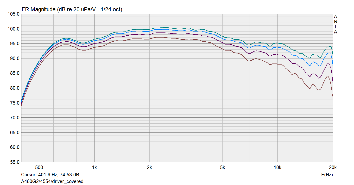

The adapter+driver covered with a blanket:
It's also possible that the bigger horn simply shields better from the sounds reflected from the things at the back.
This was not included in the BEM models.
I suppose it is not only the surface texture that becomes more smooth after an epoxy layer but also the whole structure changes it mechanical properties moving low Q / level resonances around... perhaps?
So the rough version is a bit more directional?A460G2

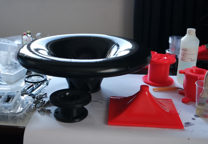

Epoxy coating (a single layer, no sanding yet):

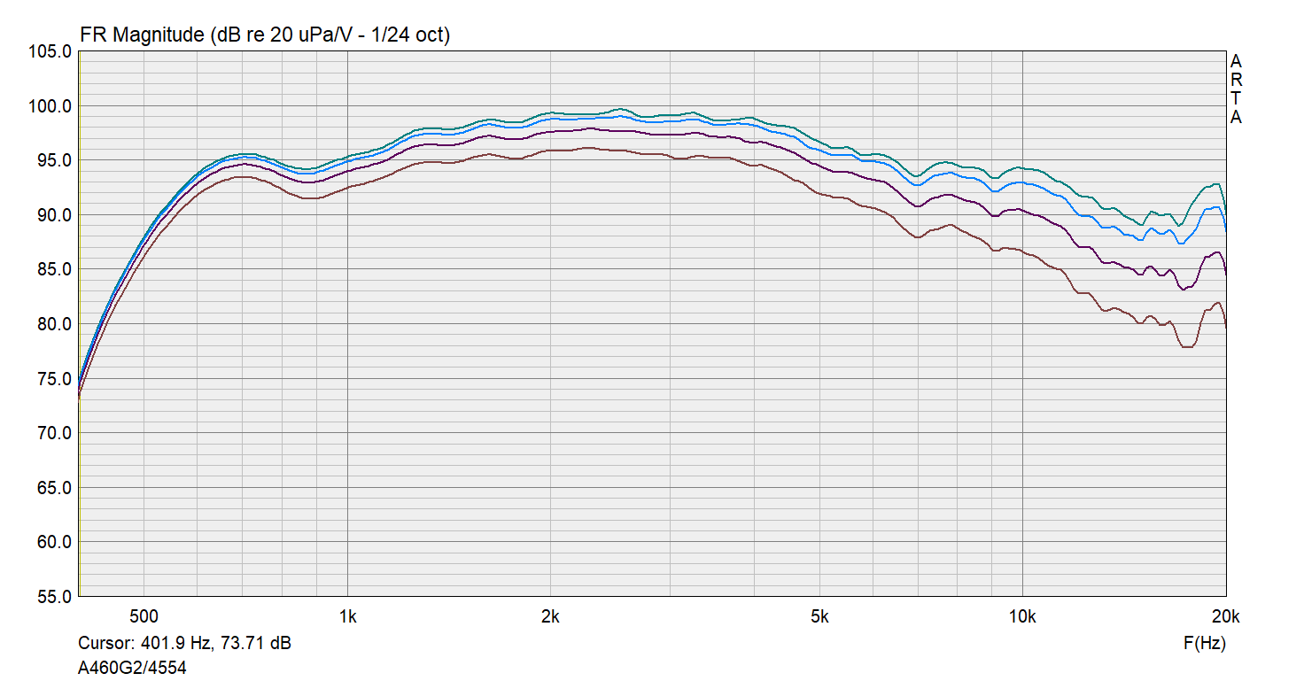

Raw surfaces as printed/assembled:
