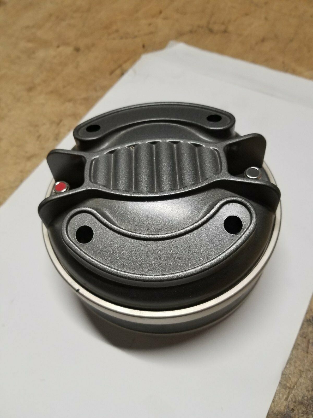

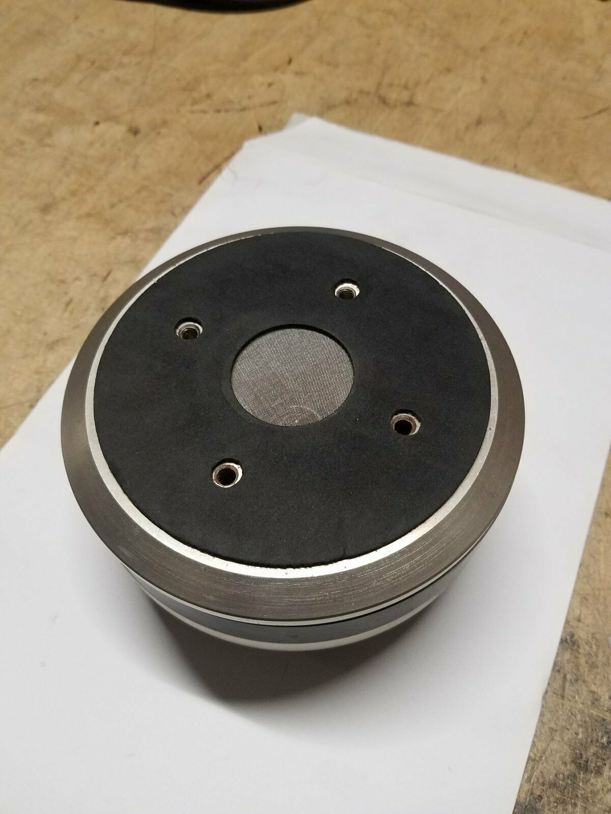

Looks like I just scored a pair of BA-750 drivers, except it's the version with 1.4" exit.

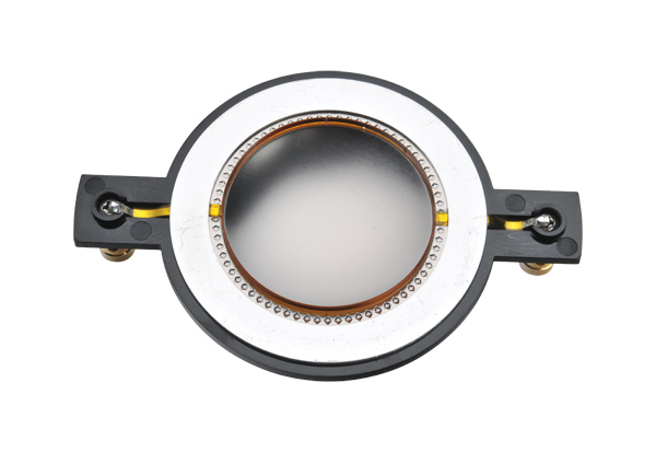

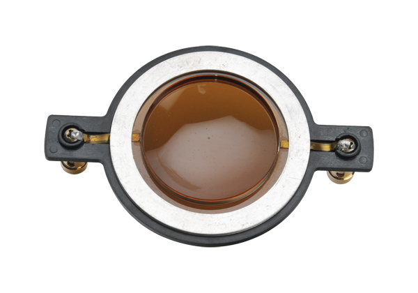

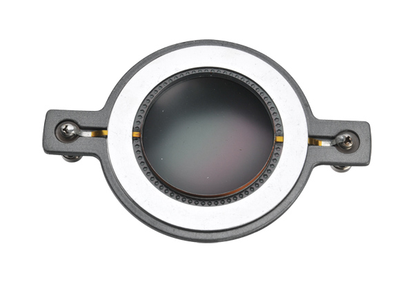

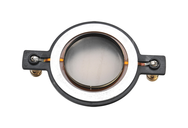

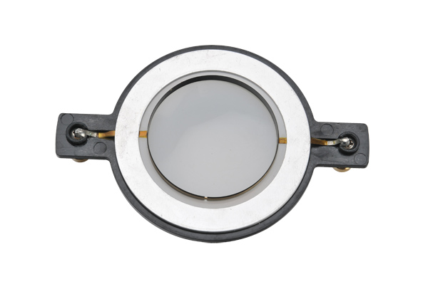

At least 6 different diaphragm kits are available for this driver.
For the price of a single dome tweeter, there is not much to lose.

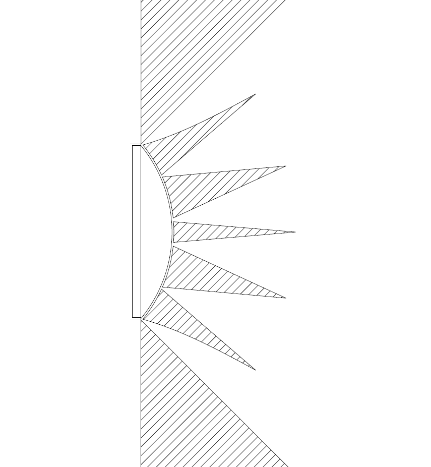

OK, I think I get it now. So this would be better I suppose...? (Just a quick sketch.)... Well, the further parts of the diaphragm will be out of phase with the center since the sound has further to travel. You'll get cancellation as wavelengths get shorter and more out of phase.

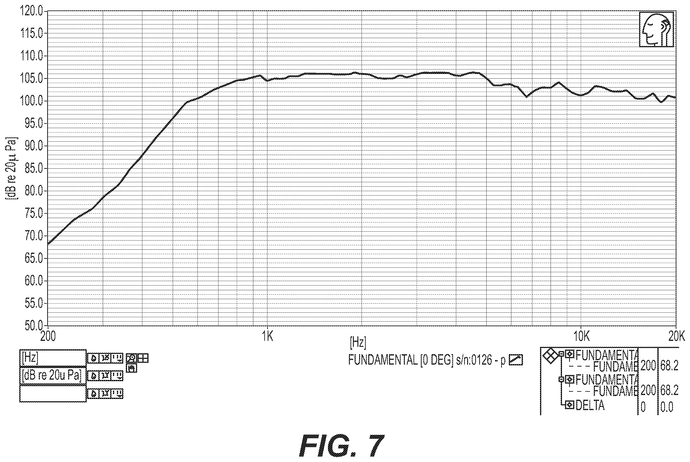

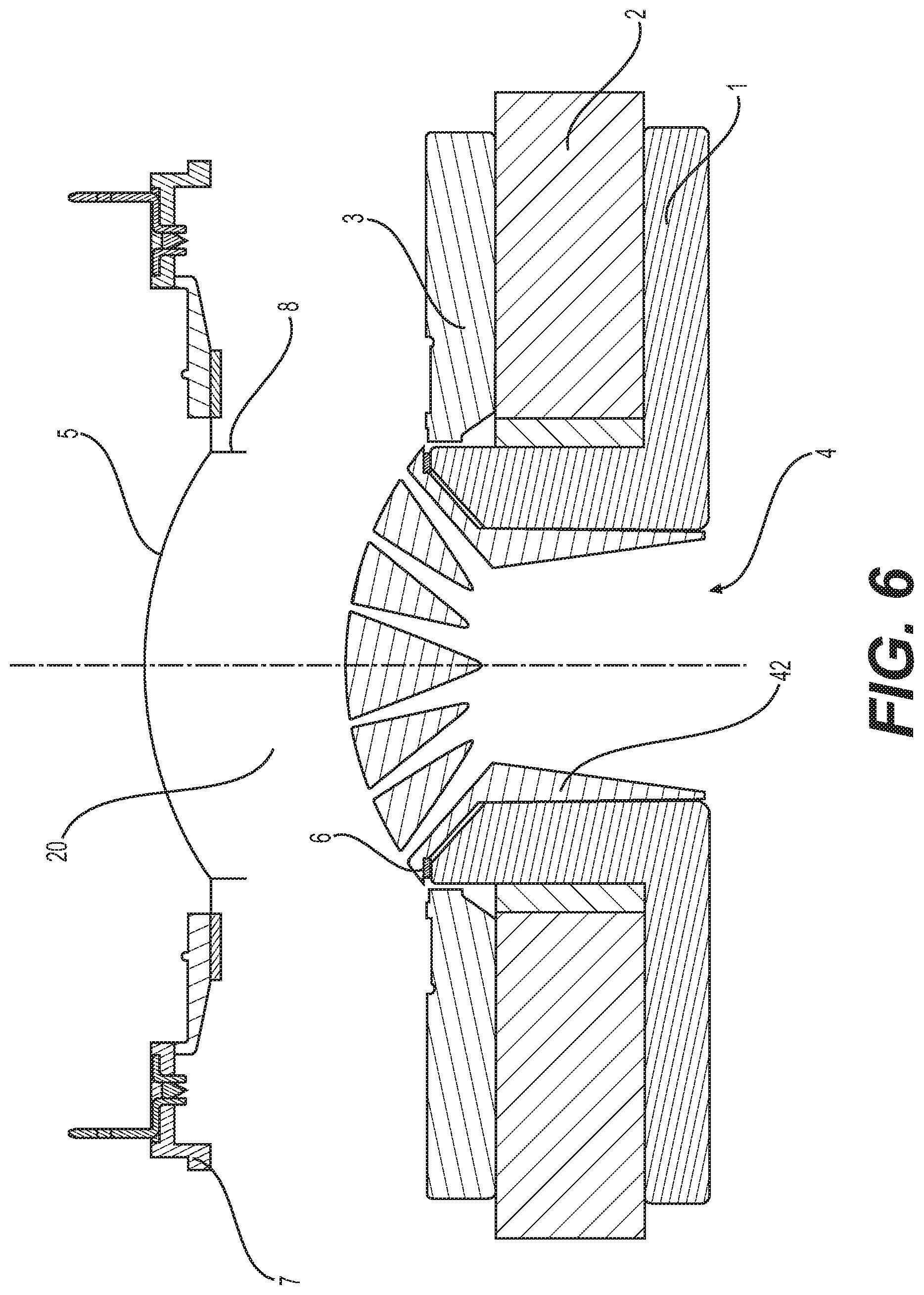

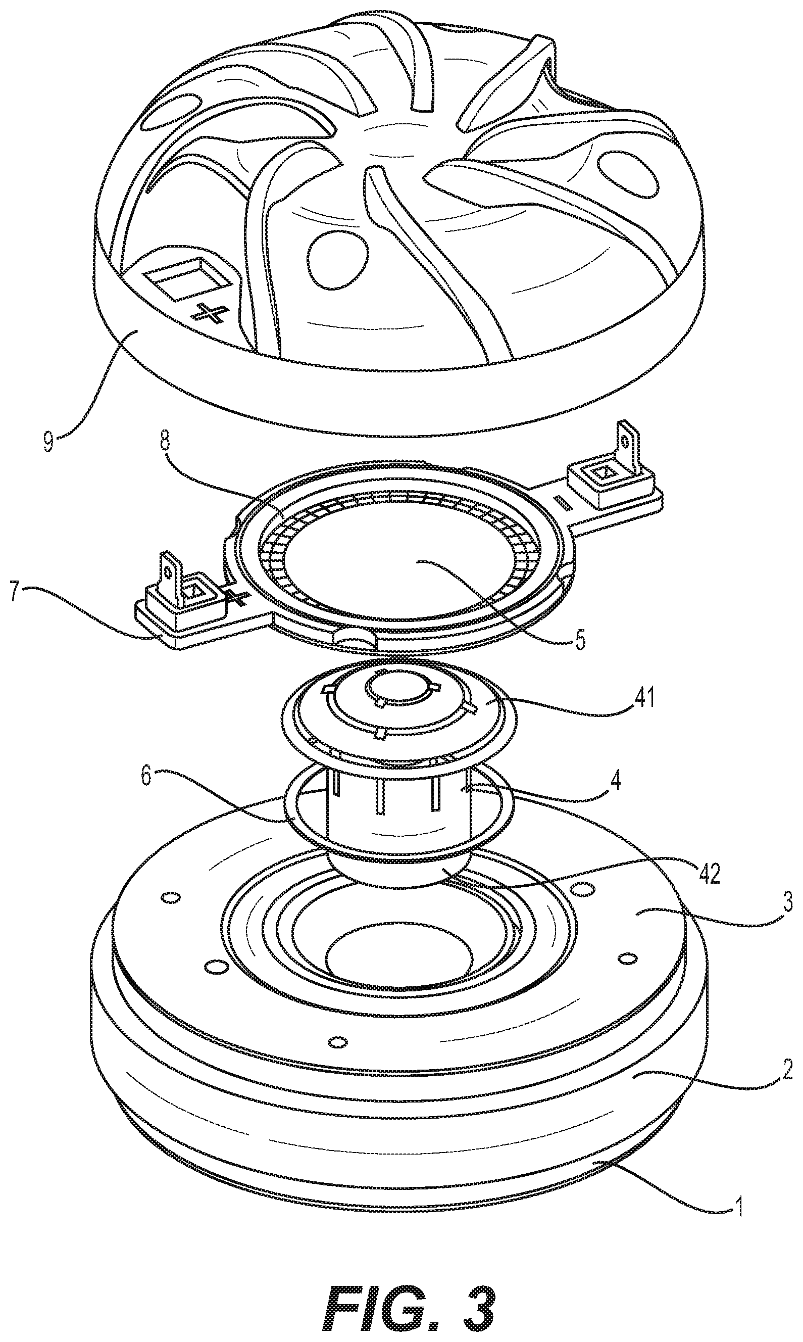

Here's Tymphany's patent, fwiw.
Nah, it doesn't work. I would have to contact administrator... Can't touch the attachments anymore.Oh, now the "Edit" button appeared. I sware it was not there before.
I know. It's funny, it lets you edit the first post for 30 minutes after you posted somewhere else. You can't modify the attachments however.
You can put a link in the OP (as you already did..)to the new attachment, and edit your misspelling of "design" ;^).I know. It's funny, it lets you edit the first post for 30 minutes after you posted somewhere else. You can't modify the attachments however.
If I'm reading that correctly, they're patenting a method for the alignment of the phase plug during assembly?Here's Tymphany's patent, fwiw.
Possibly, I haven't read it thoroughly yet. The phase plug channels - though nothing special wrt the design - grabbed my attention.
The phase plug itself looks to be of a conventional circumferential slot design.Possibly, I haven't read it thoroughly yet. The phase plug channels - though nothing special wrt the design - grabbed my attention.
